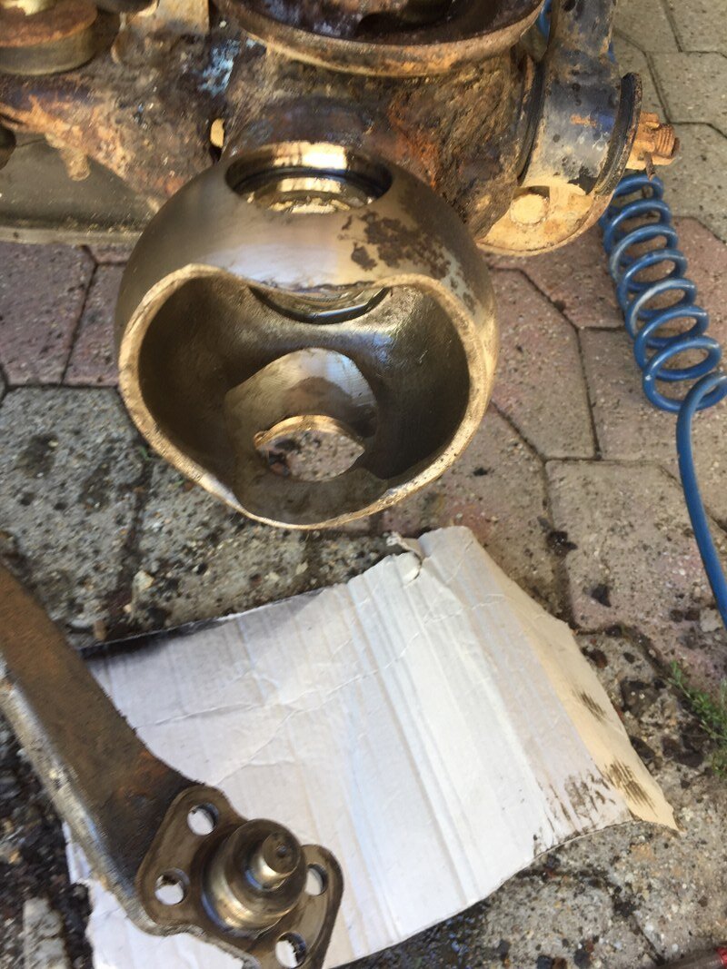

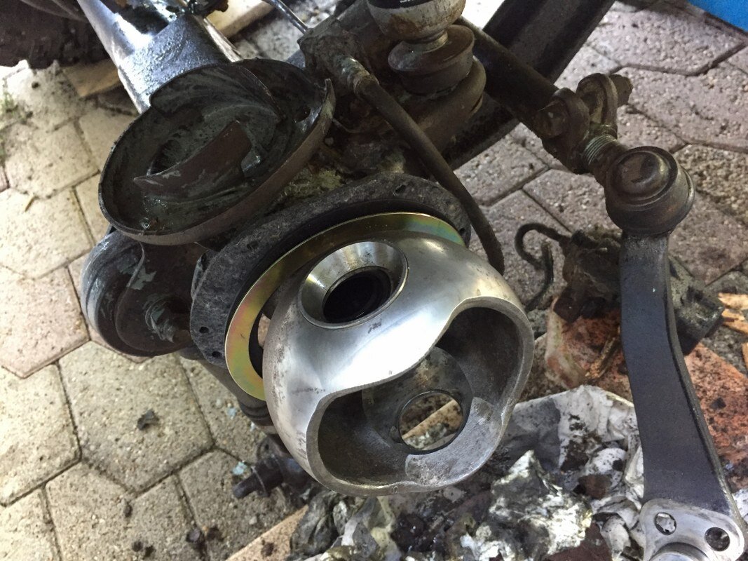

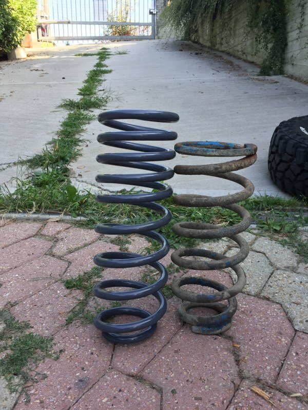

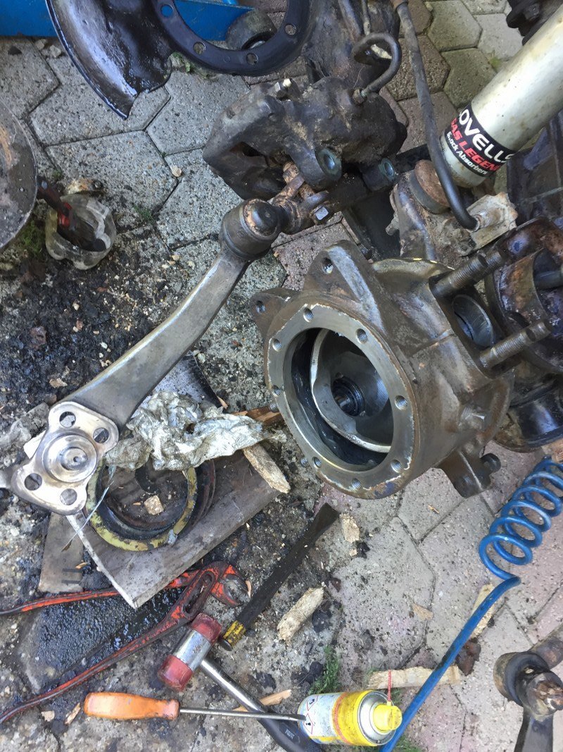

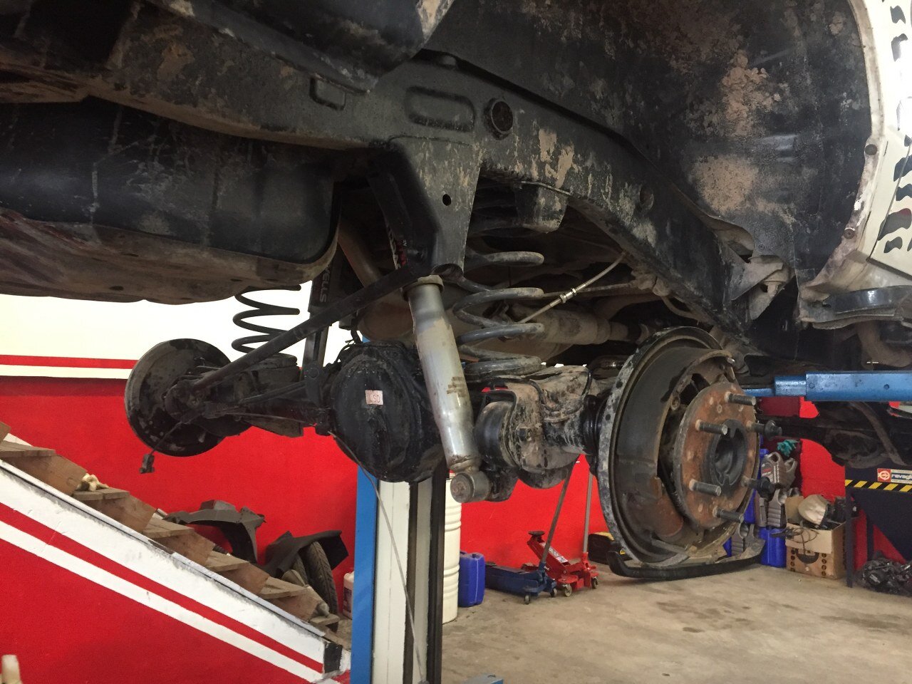

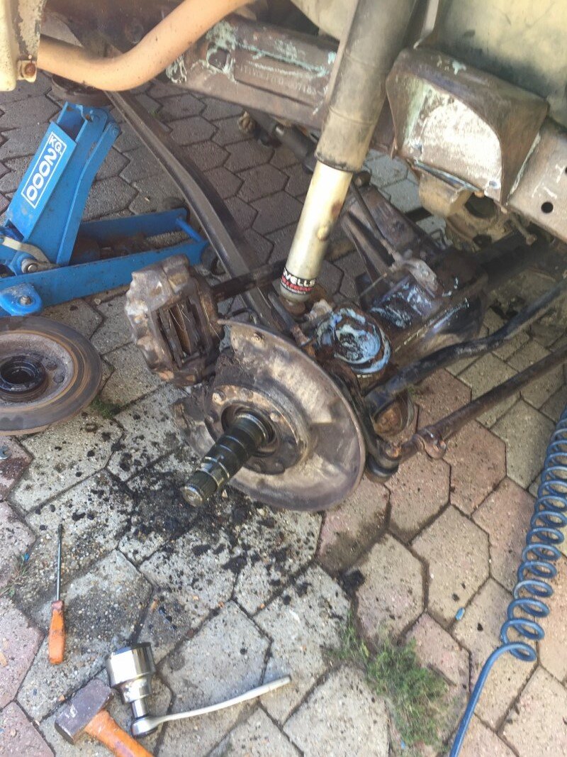

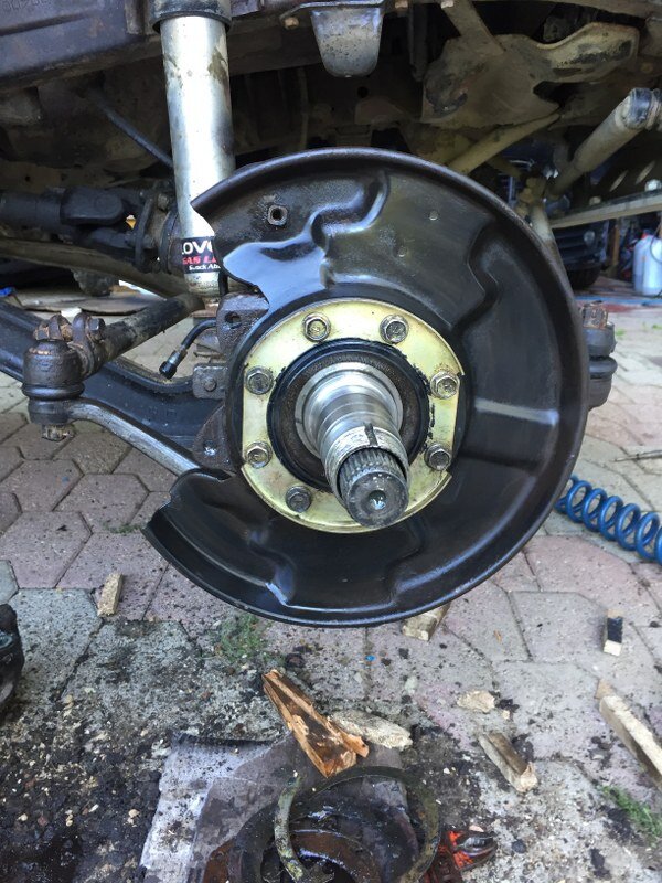

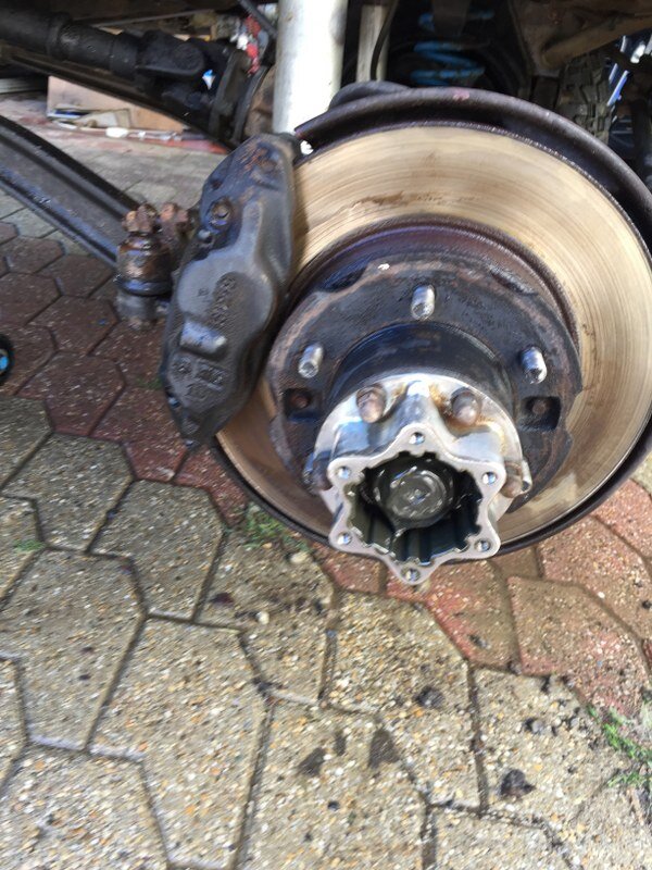

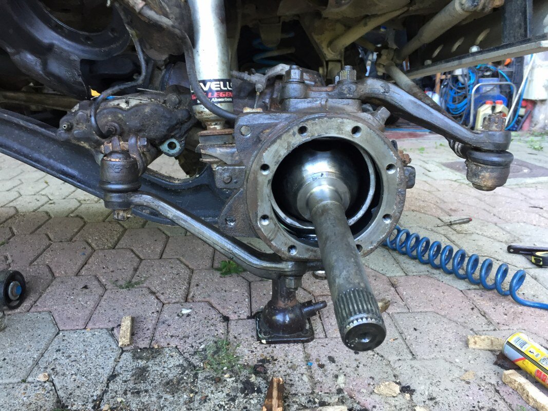

    New springs from HM4x4 +6cm and front axle rebuild
    IMG_8603_1067x800.JPG IMG_8606_600x800.JPG IMG_8609_1067x800.JPG IMG_8617_1067x800.JPG IMG_8618_1067x800.JPG IMG_8620_1067x800.JPG IMG_8624_1067x800.JPG IMG_8626_600x800.JPG IMG_8643_1067x800.JPG
    IMG_8652_600x800.JPG IMG_8657_1067x800.JPG IMG_8659_1067x800.JPG IMG_8662_1067x800.JPG IMG_8667_600x800.JPG
    It was a long work (2 days) but now i'm very happy
    No more leaks and now with the new springs car is more comfortable.

    How does it handle on such huge springs?
    I imagine the castor must be affected quite a bit. :think:
    Please, please, please invest in a pair of axle stands before you do a big job like an axle rebuild again. working under a trolley jack (even with the standard jack there as well) is bloody dangerous and I'd hate for you to get seriously injured or killed by your 70. :shifty:

    Yes, you are right...I have it, but are too low for my lj...I have to buy a new set of stands!
    New springs are incredible, because are high like the old one (+5cm vs +6cm) but they are progressive: the first part of the spring is really soft, and the second part is more hard... So during the driving car is confortable but don't roll too much, and copy the terrain very well during off road.
    About the caster my front axle is different from the square headlight: with round headlight, with 2'' lift you don't have to modify your caster angle, My problem now are the panhards, I have to change or modify it...

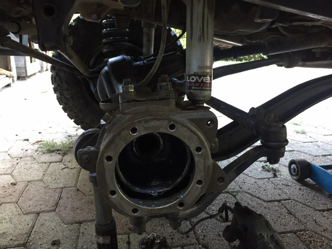

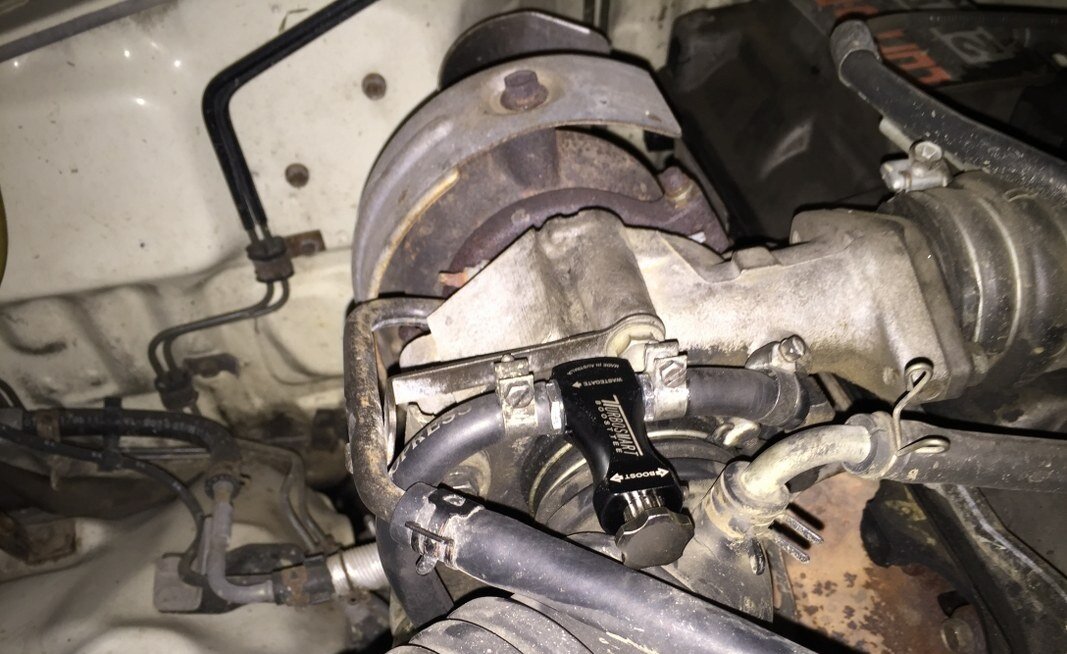

    Last saturday, I went at work with my lj and at the end of the day I changed my front diff oil (last part of my axle rebuild :) ) and installed a little boost controller on wastegate and turned my lda to the max...now turbo runs with 0.8 Bar boost only at high rpm (stock was 0,6 bar)
    Then I tried the mobility with new springs and I see a good difference from old ones
    Today I'm still awaiting the documents from MTO after my new homologations, and tomorrow is the last day of my "permission to use it" and the 20th of october I have a 4x4 meeting, I hope to solve this situation!
    At the same time I'm working about VGT turbo, I found a intecooler the could fit in front of water radiator...I'll work about it after the meeting, because surelly I must stop my car.

    Can you tell me about boost controler on wastegate, do make a good job on turbo performance? And where you bought it?
    Best Regards
    Saluti da Montenegro!

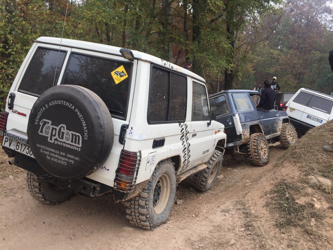

    I have been 2 days in Maggiora, one of biggest 4x4 meeting in North Italy, more than 5 Km of off road street with different difficulty.
    There was a lot of cars and people! Some trucks was really wonderful!
    IMG_9265_1067x800.JPG IMG_9273_1067x800.JPG IMG_9274_1067x800.JPG IMG_9288_1067x800.JPG IMG_9290_1067x800.JPG IMG_9293_600x800.JPG
    Here some repairs at my friend's suzuki. IMG_9312_1067x800.JPG IMG_9314_1067x800.JPG IMG_9315_1067x800.JPG
    This is the end of two days of off road, I'm very happy of new springs, they work very good, car have a really good mobility and traction! I have done a lot of difficult pass, that I can't image. I have only took a tree during a "hard pass"....nothing important, only a good souvenir :)

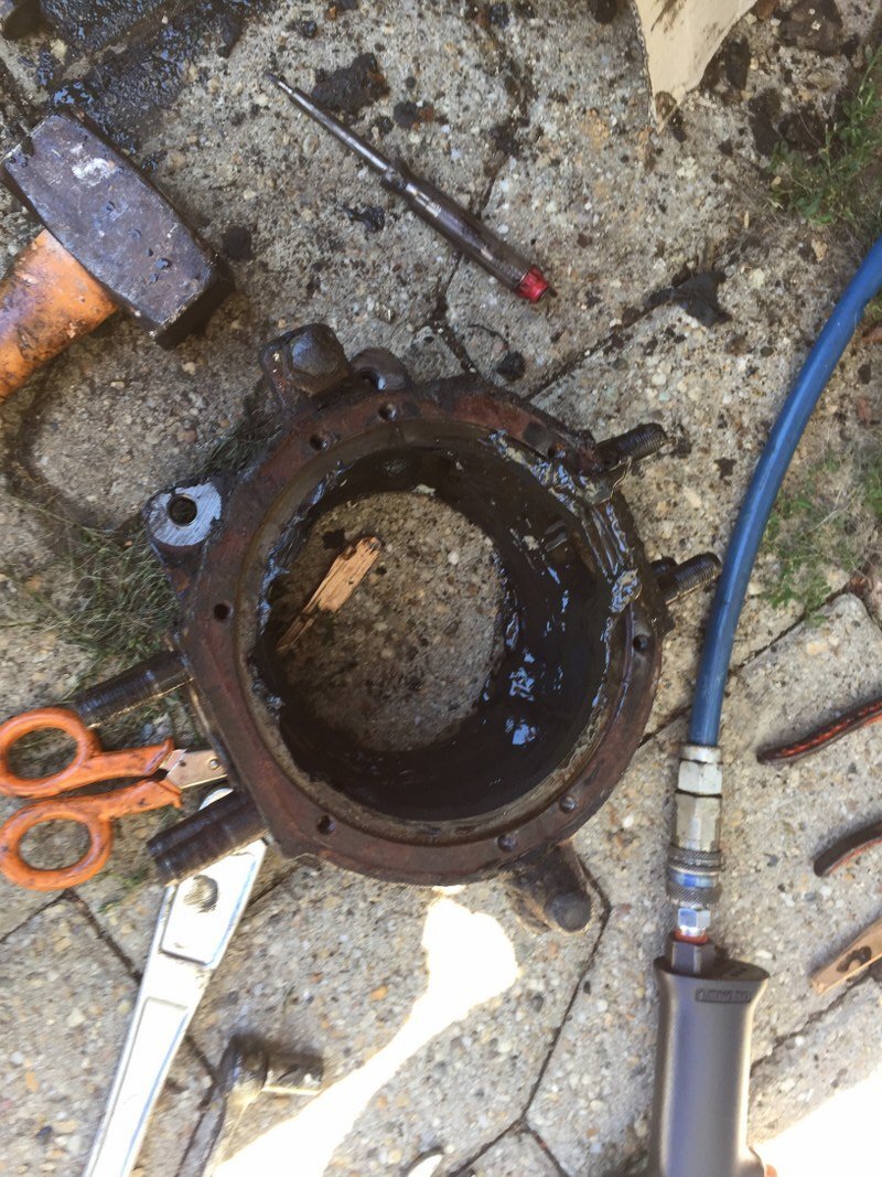

    I started removing rear diff for ARB install
    IMG_9452_1280x960.JPG IMG_9453_1280x960.JPG IMG_9458_1280x960.JPG IMG_9461_1280x960.JPG IMG_9462_1280x960.JPG
    It look really good...but oil was a little bit dirty, I think that water or mud could pass from axle shafts...I need to change seals.

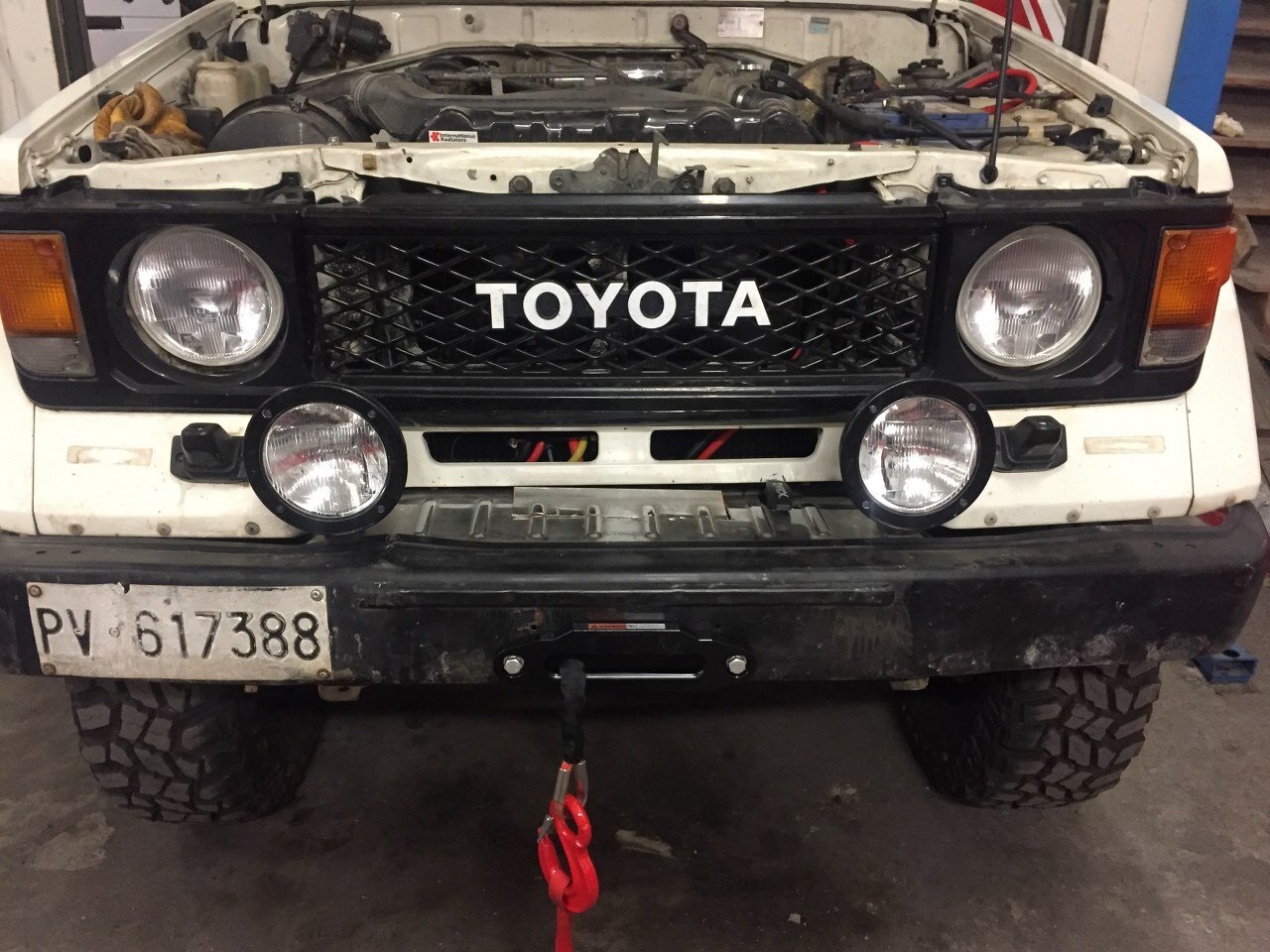

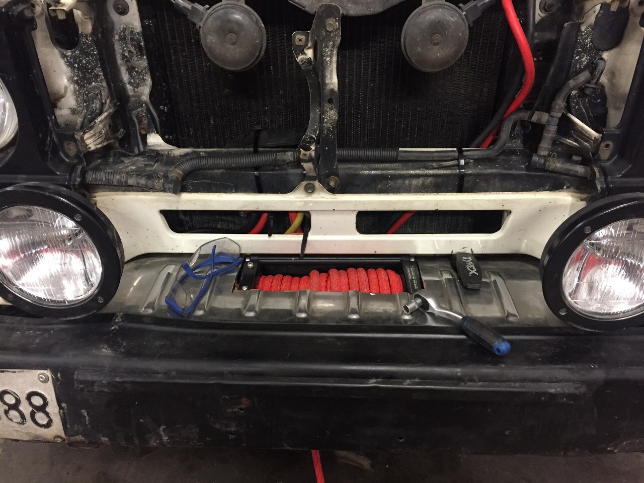

    After that I worked about winch installation... I have not Ben ability with iron and welding so it was a hard job for me :D :D
    But at the end I was very happy for me result:
    Now I have only to fix cables position, insert new hooks and work about front bumper position...because now is a little bit higher and is too near at fenders...
    But I like the result:
