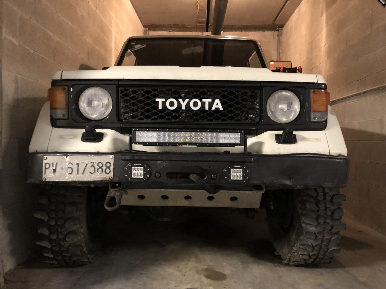

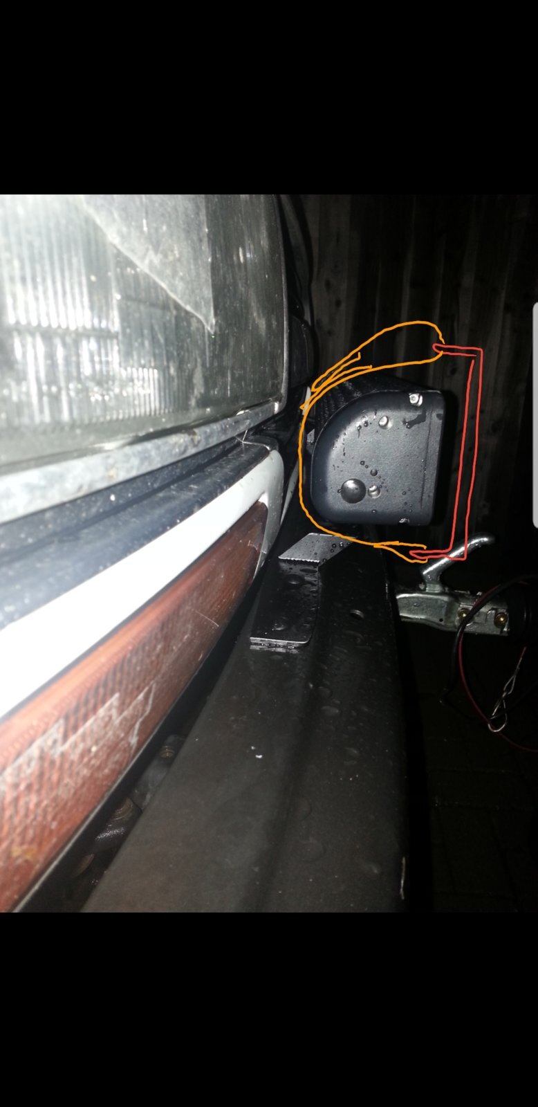

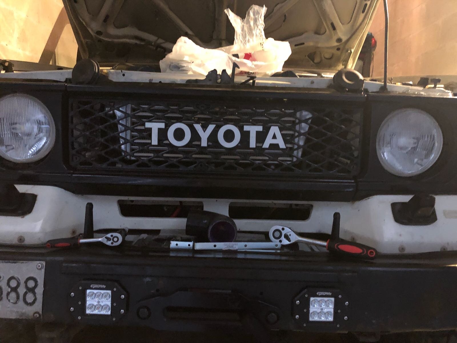

Now I would like to test this chinese led bar...but I thinking about where to install it...sure I'll install it "removable", because in Italy is not allowed goes on the road with it...
See you soon me friend ;)
I installed mine in the same place of your picture and I'm happy with that!
You haven't annoying bright on the bonnet and the access is great.
You can probably cover it instead of remove it every time!
Thanks for the photos ;)
Cover it is a good solution but how?
Furthermore removing it, I preserve it from damage when is not in use...
My idea is to fit an alloy cover with carpet inside and retaine it with two Velcro latch.
In alternative you can make a leather cover,but it is less protective.
You need imagination but.... something like this with carpet inside
If the dimensions are suitable for you,it could be alright!
I think it's more practical than remove and install the bar every time :thumbup:

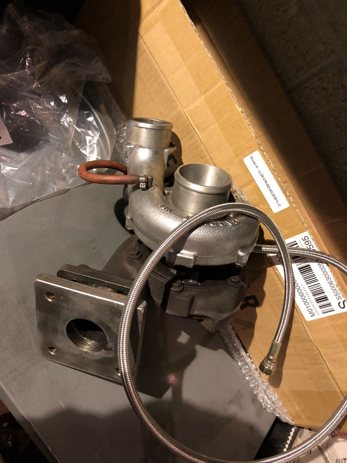

This is the turbo (I've bought it more than one year ago!! :D :D)
With all the parts to fit...

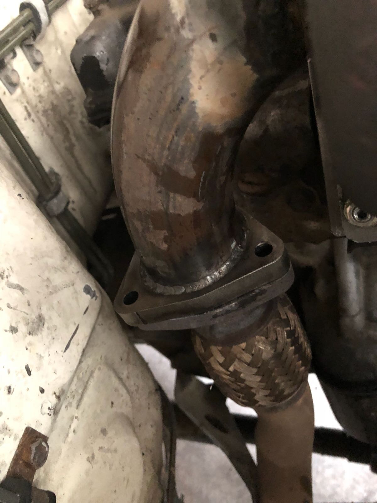

I have asked help for downpipe at one of my friends, so he welded for me a new downpipe with TIG
Now I'm only waiting for new oil line for turbo return and I will have all the parts...

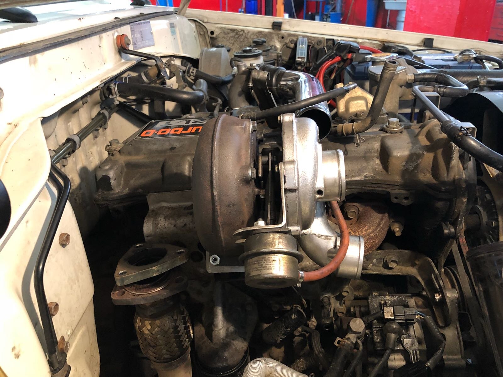

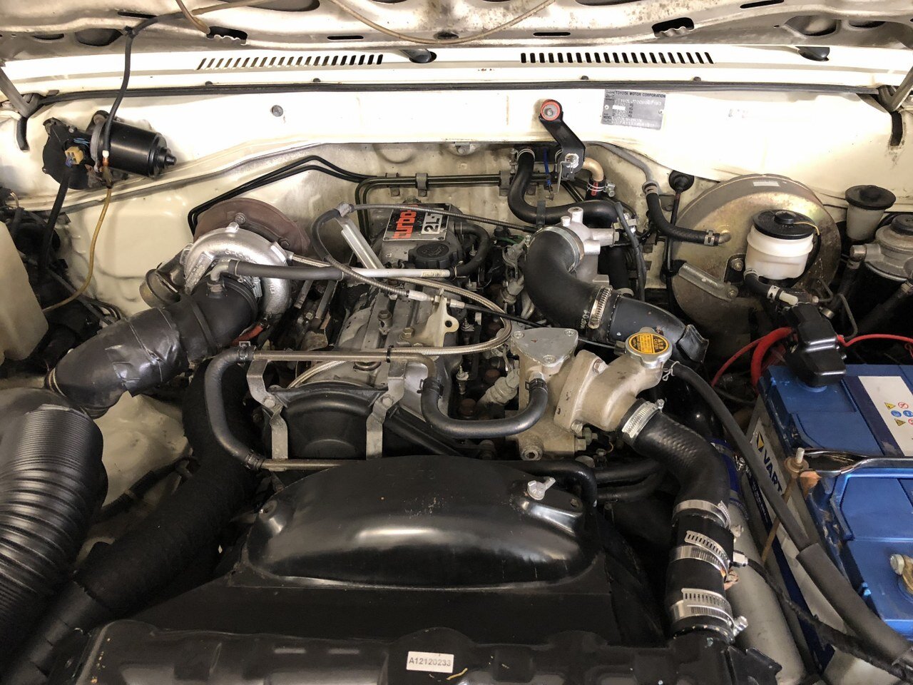

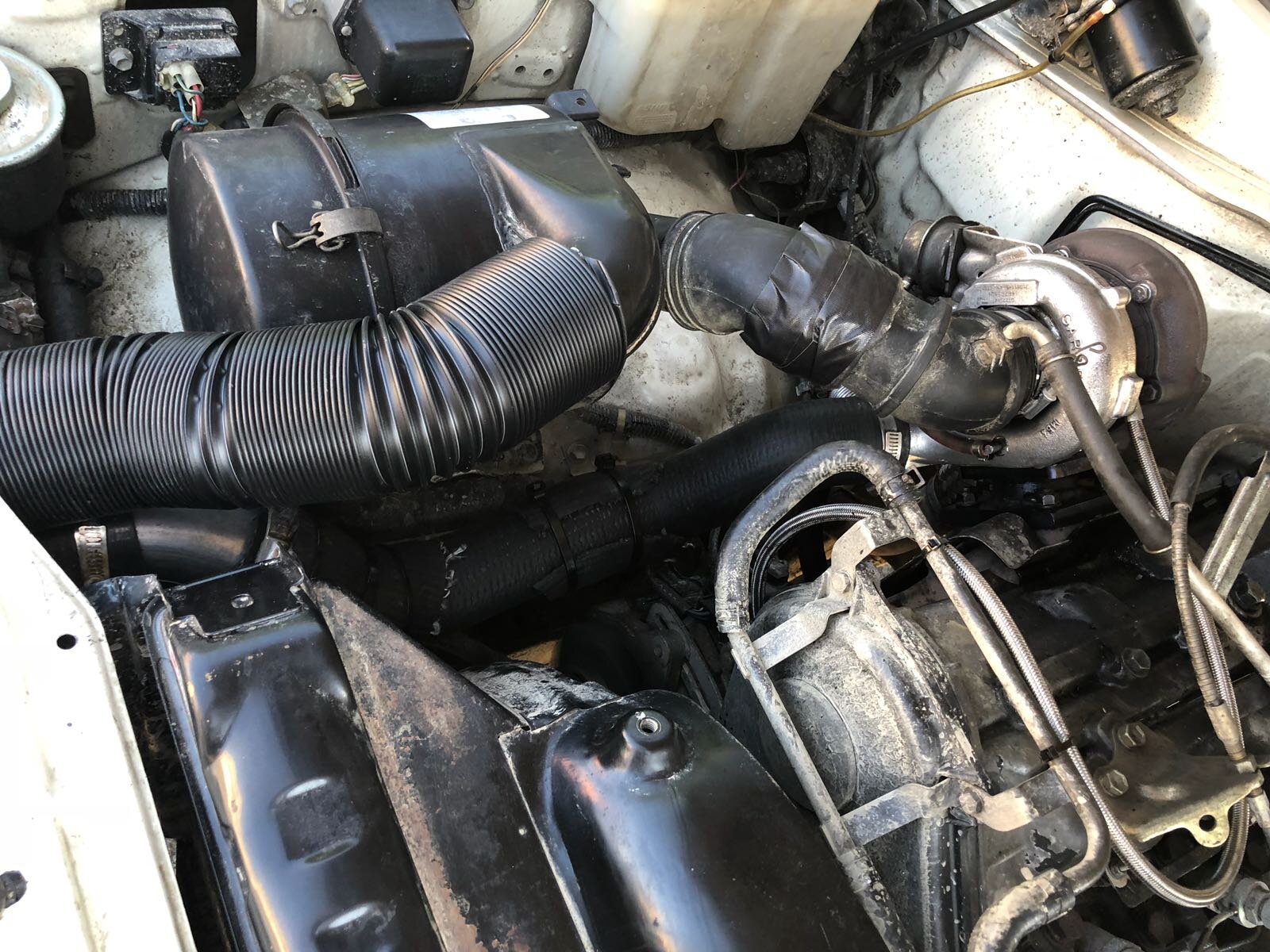

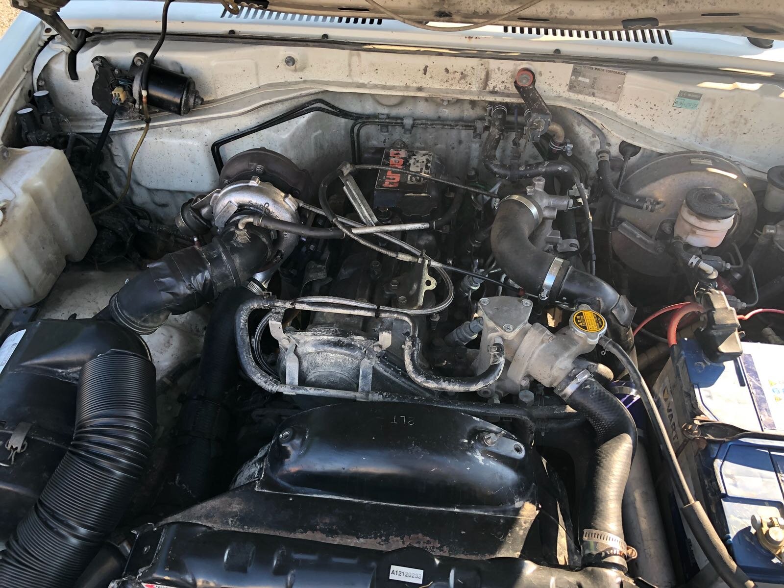

And the NEW turbo is FITTED!!

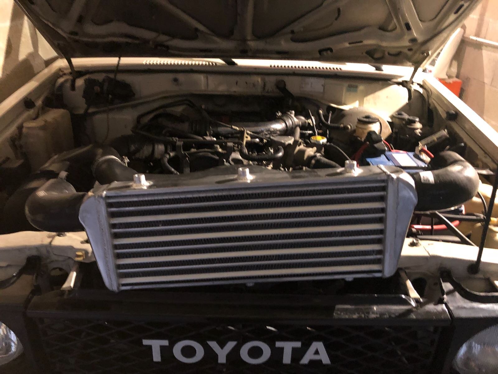

I started installing new intercooler in front of the vehicle:

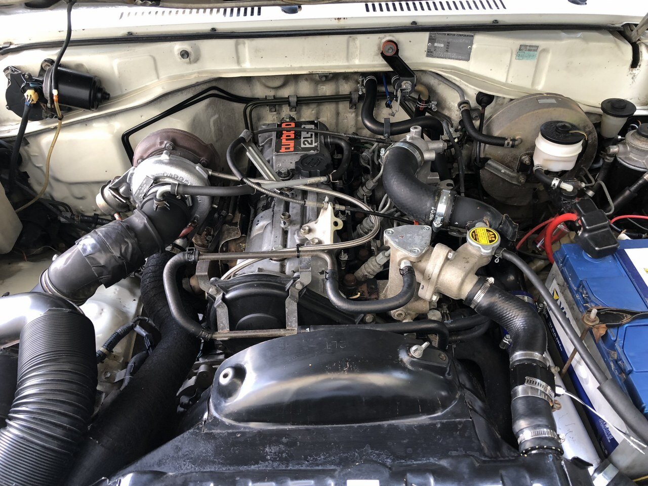

And next week i've installed new turbo (2256v VGT) :D :D
Now I'm running at 0,7 bar pressure ( wastegate is 0.9 pressure but I think that air line + intercooler make it lower)
But now I have first pressure at 1700-1800 rpm and full boost al 2000 rpm....
Now I'll test it for some trips with this configuration, than I'll try to adjust diesel and pressure to find best match

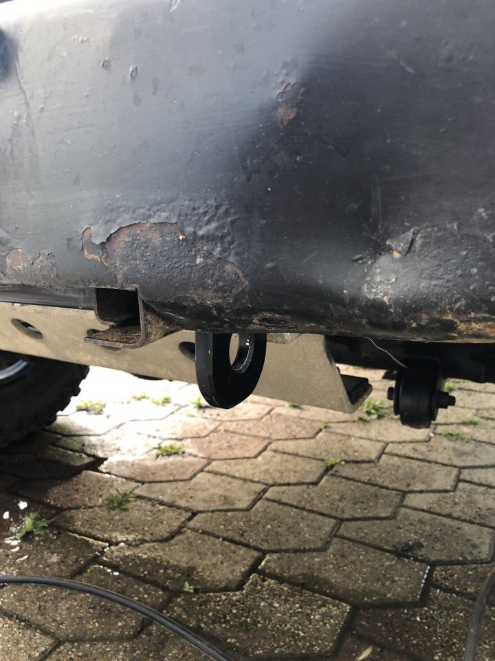

Installed also a new tow hook, realised on my specified
and worked with my friend on new custom rear bumper
