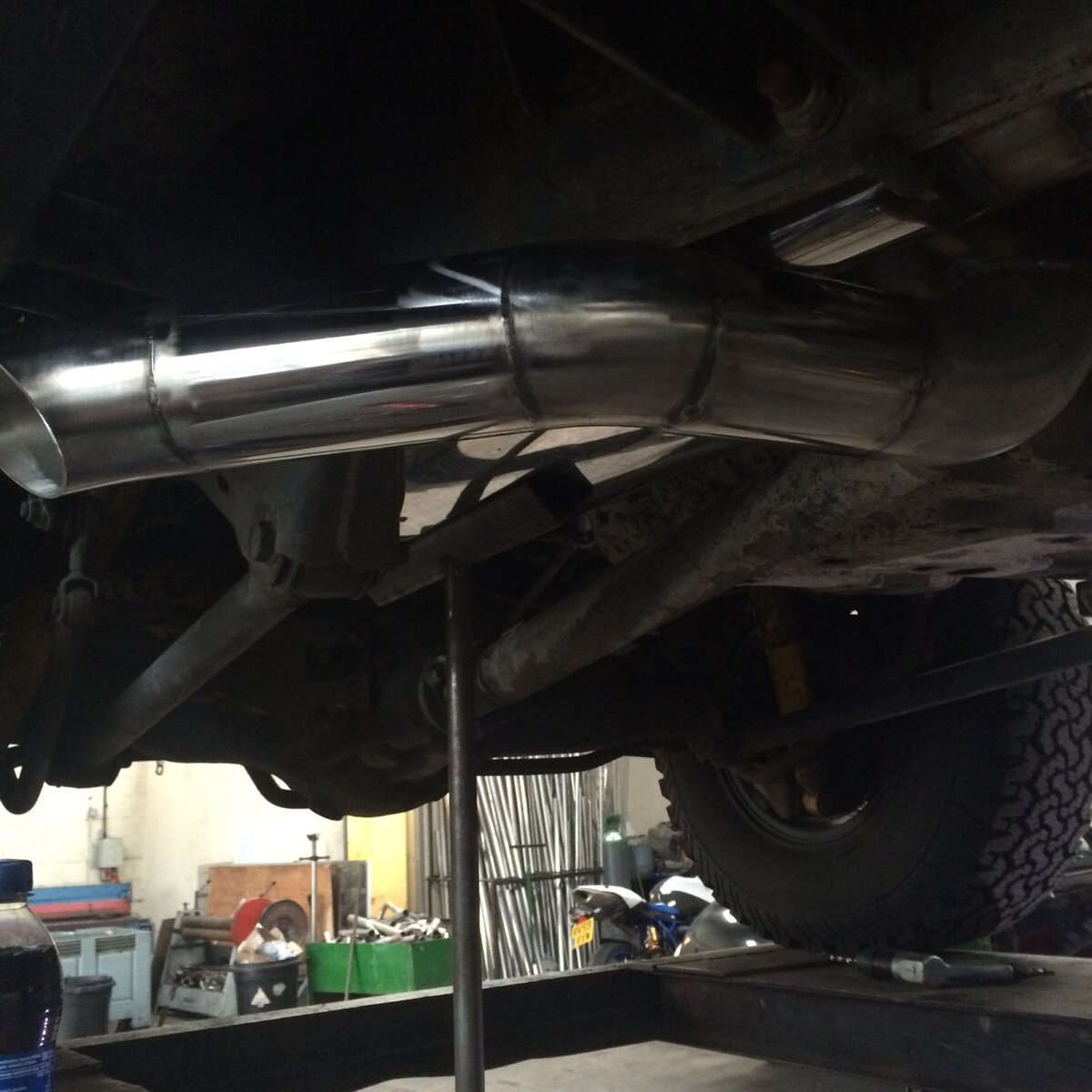

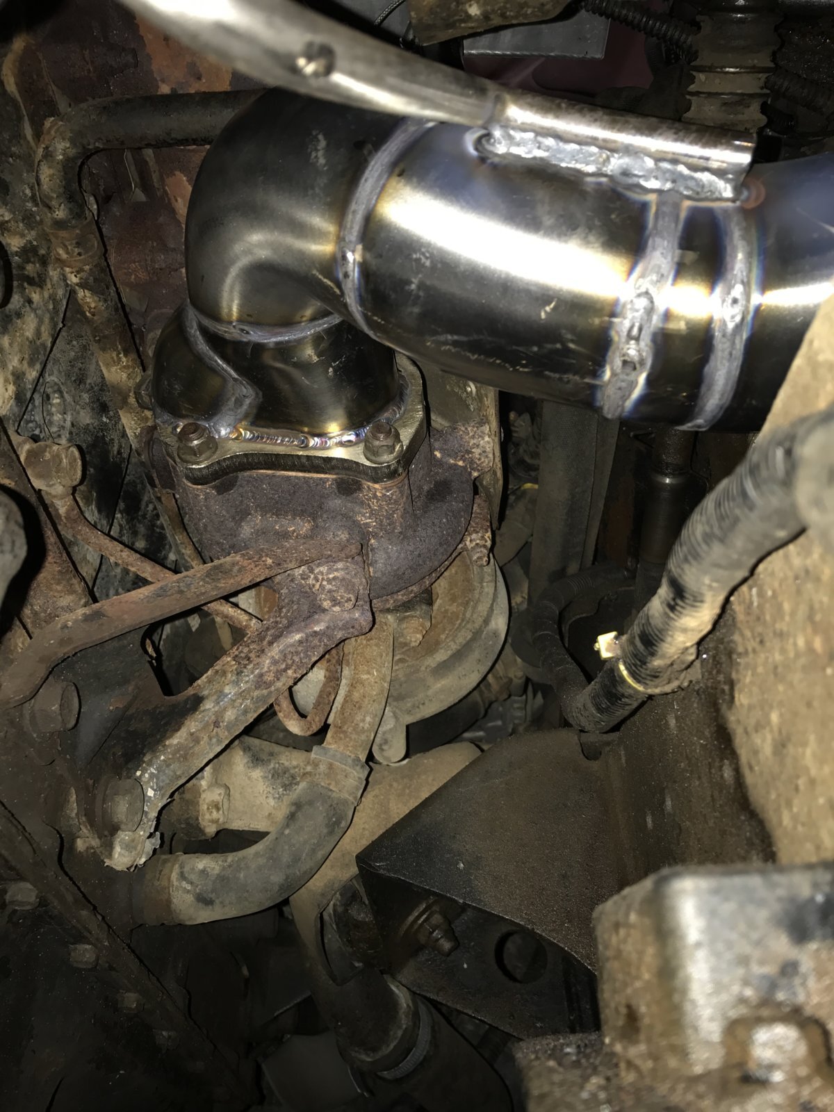

You guys with Prospeed exhausts made by Charlie, does it have the bracket that that bolts to the bell housing to support the downpipe?
I have no idea. These are the only photos I have of it
Sorry, just looked through the thread again. Pictures are a bit of a repost!
May be going there on Wednesday with Sam when he gets his done, 3" from the turbo, will check then, I'll try & have a look at mine before if u need it
I just had a crawl underneath in the dark...
No idea if that answers your question or not but there's a bracket connected to something.
Cheers Nick most appreciated.... I think I can see it there in the vid.

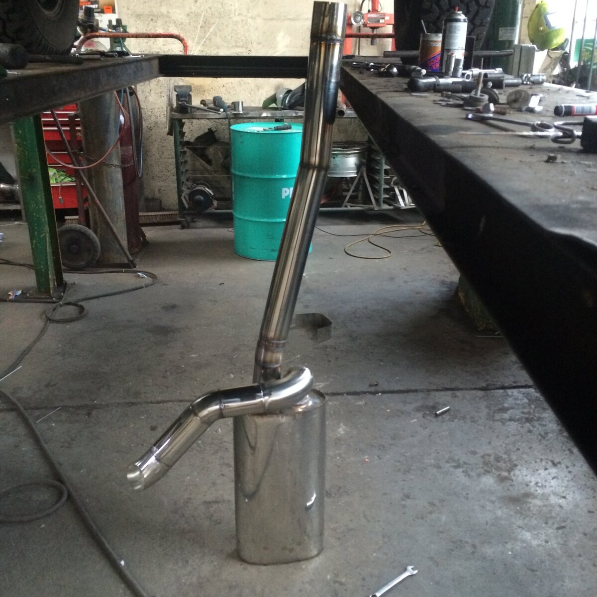

I made a 3" down pipe today what a faff. need to get a welder again. makes life a lot easier melting metal together.

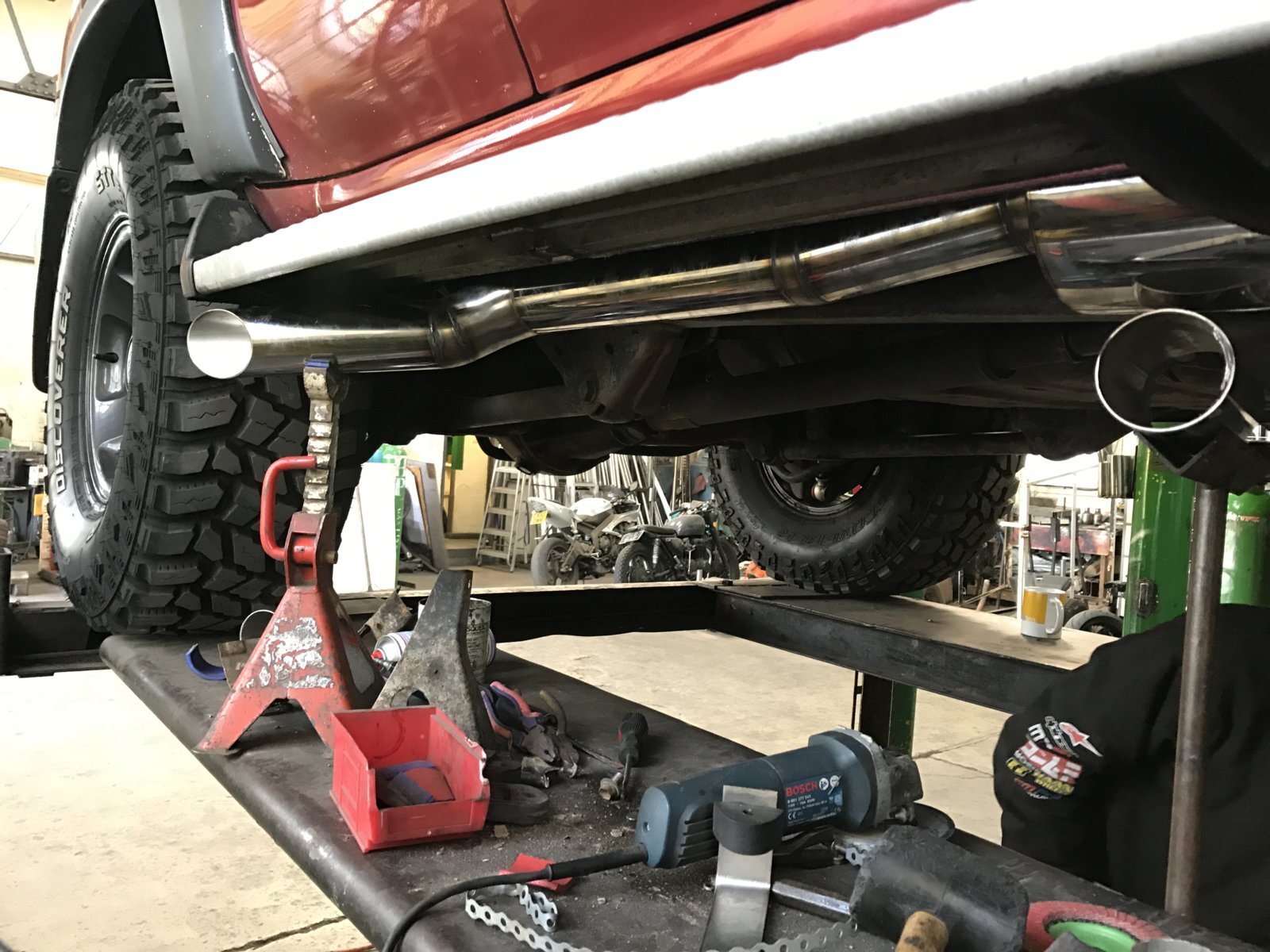

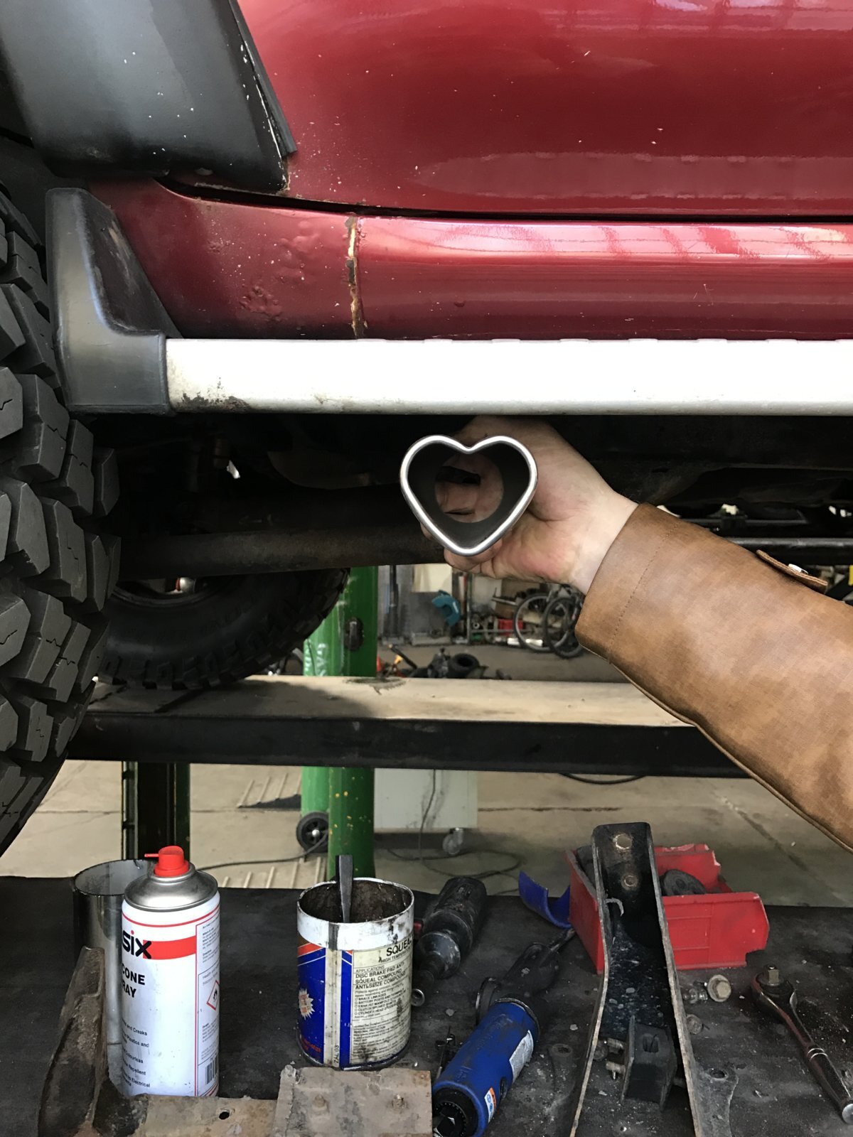

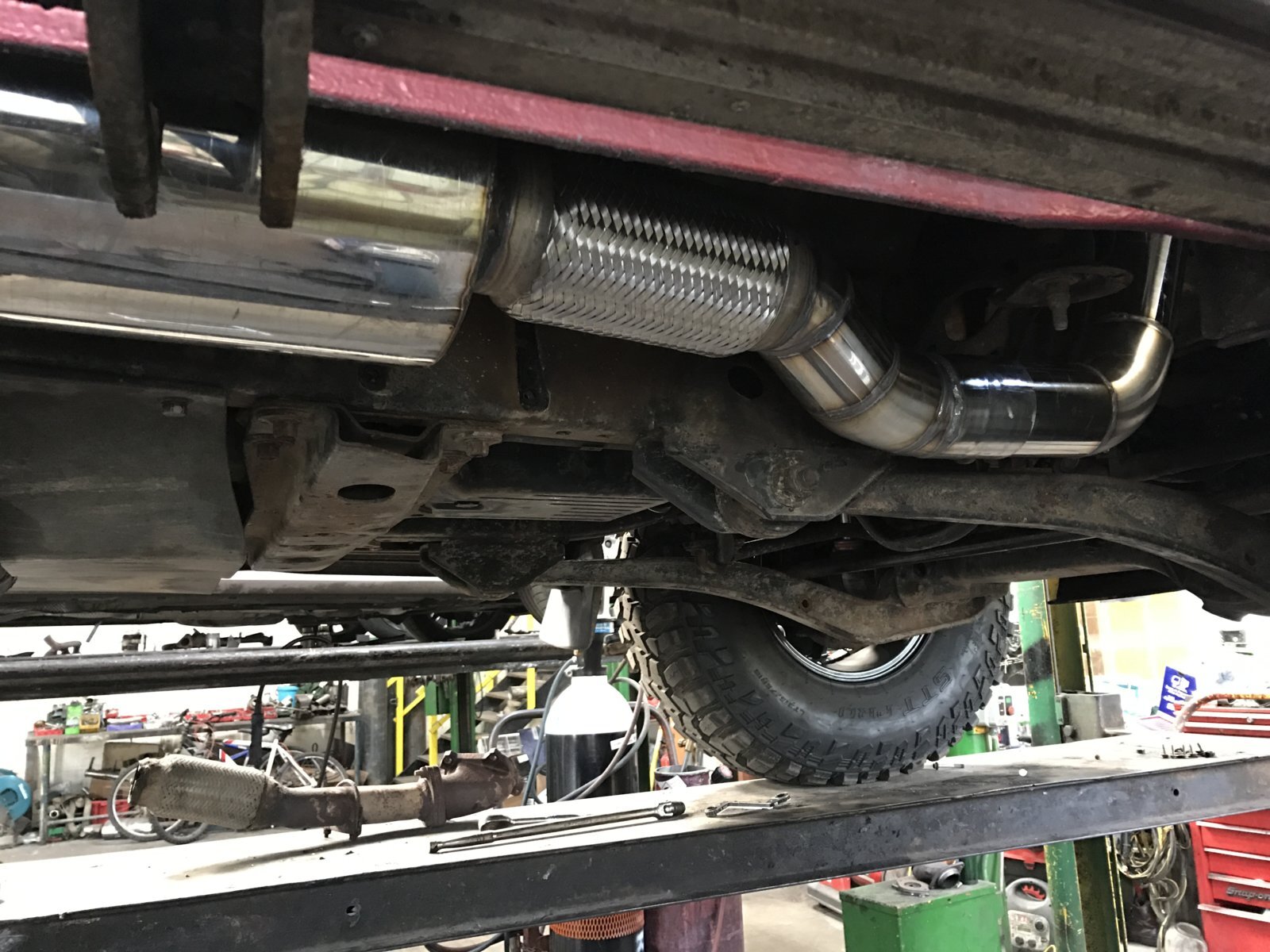

Got my exhaust done there yesterday and yes it does have a bracket on the down pipe
I'm really happy with it and is it from the same people
It is 3" from down pipe to tail pipe and single box, just a little louder than standard but with a lovely deep sound, here's a closer look at the exit.....

The down pipe change I did recently has made a big difference again.
Looked down the other day on a duel carriage way and I was up around 90 with still more to go.
Turbo spools up a bit faster, can hear it too..:sunglasses:
