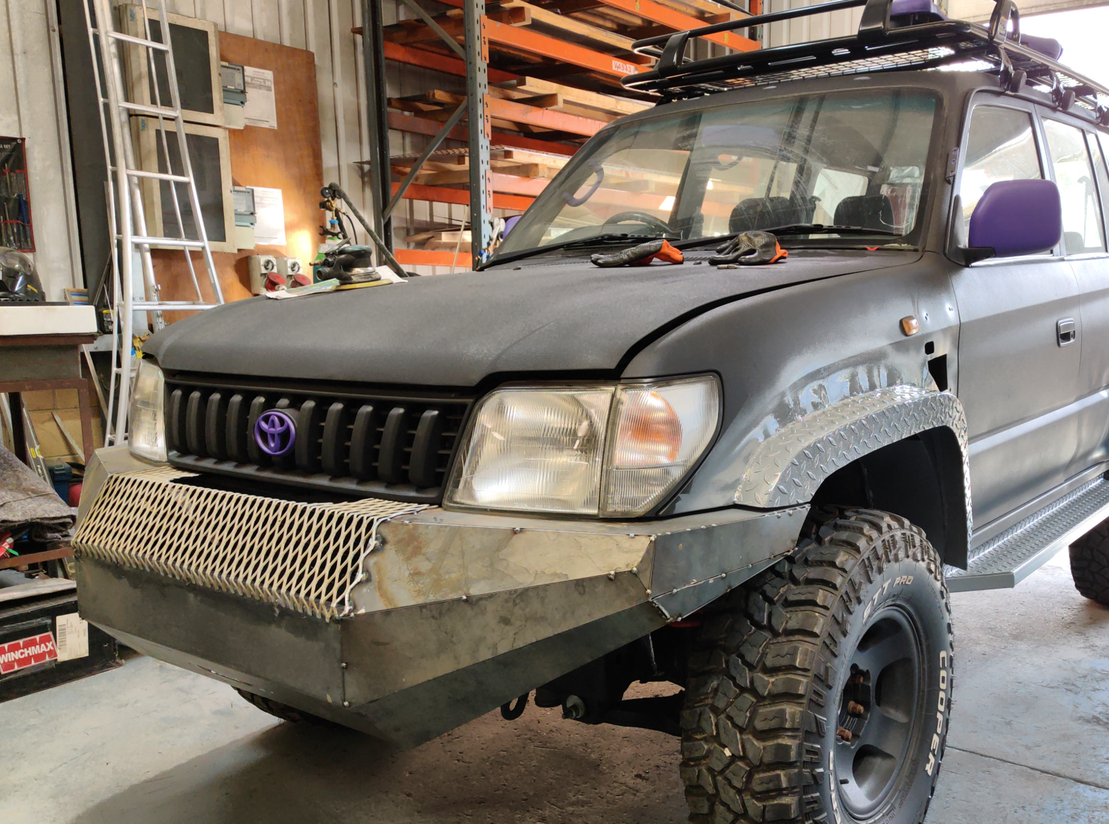

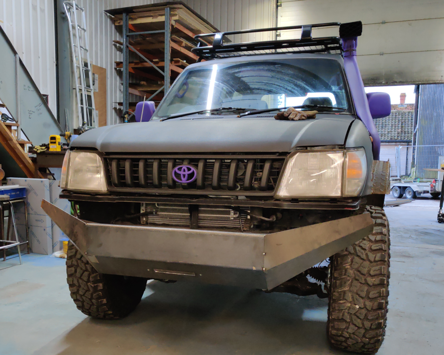

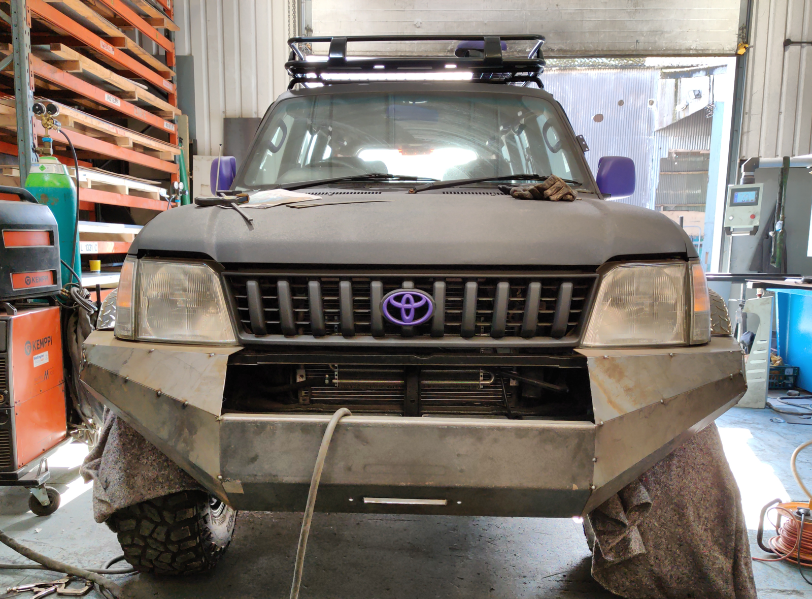

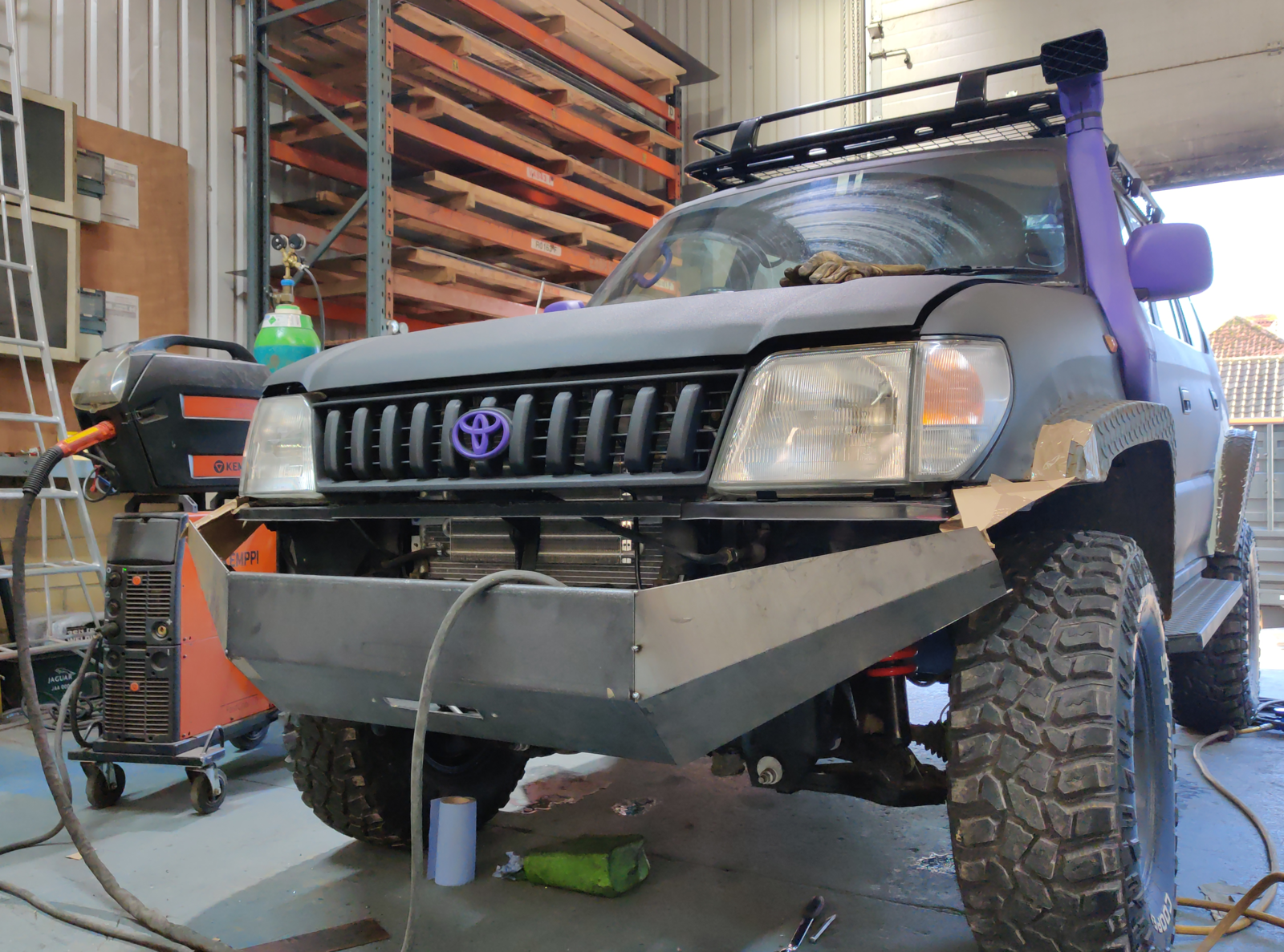

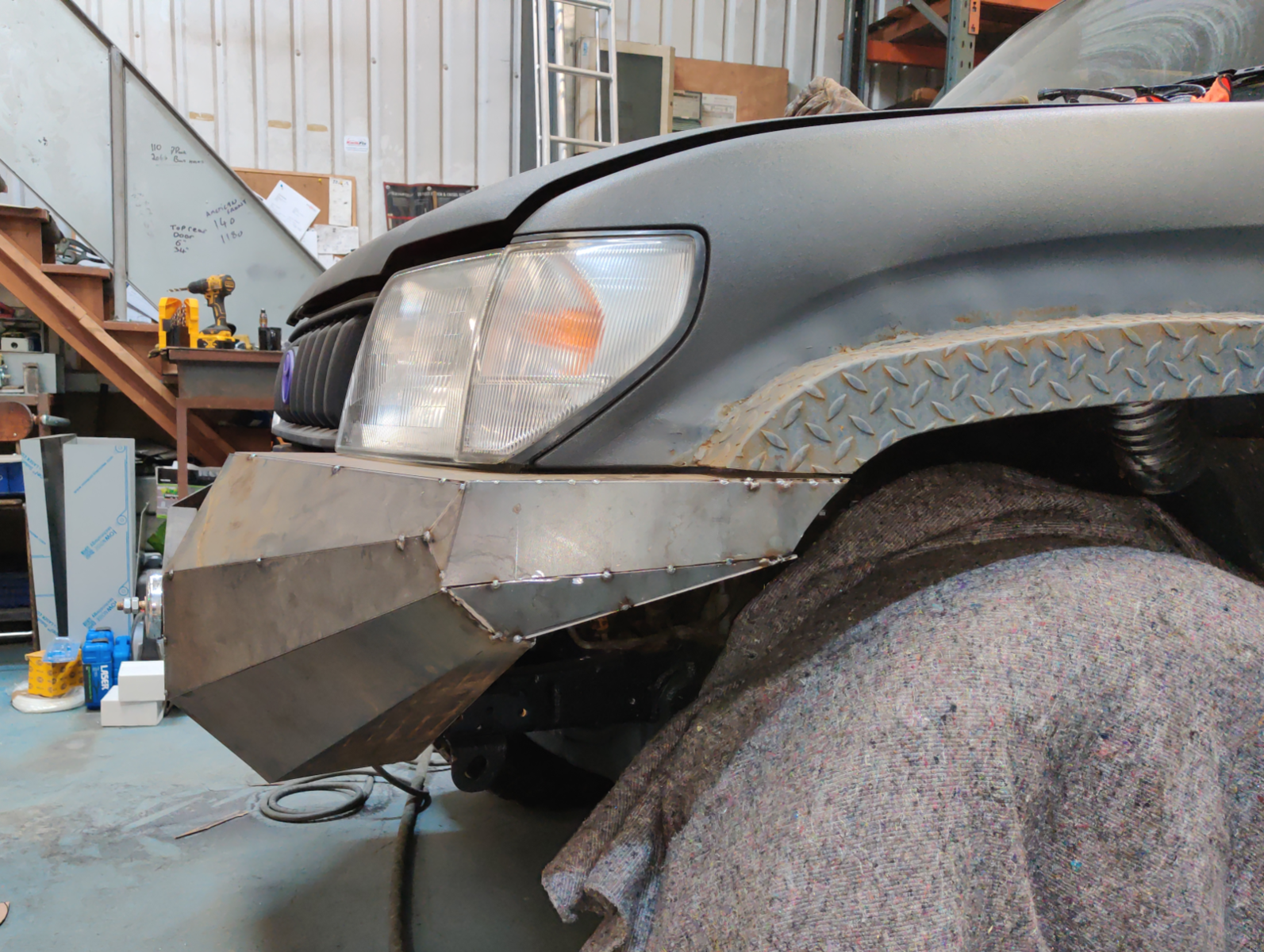

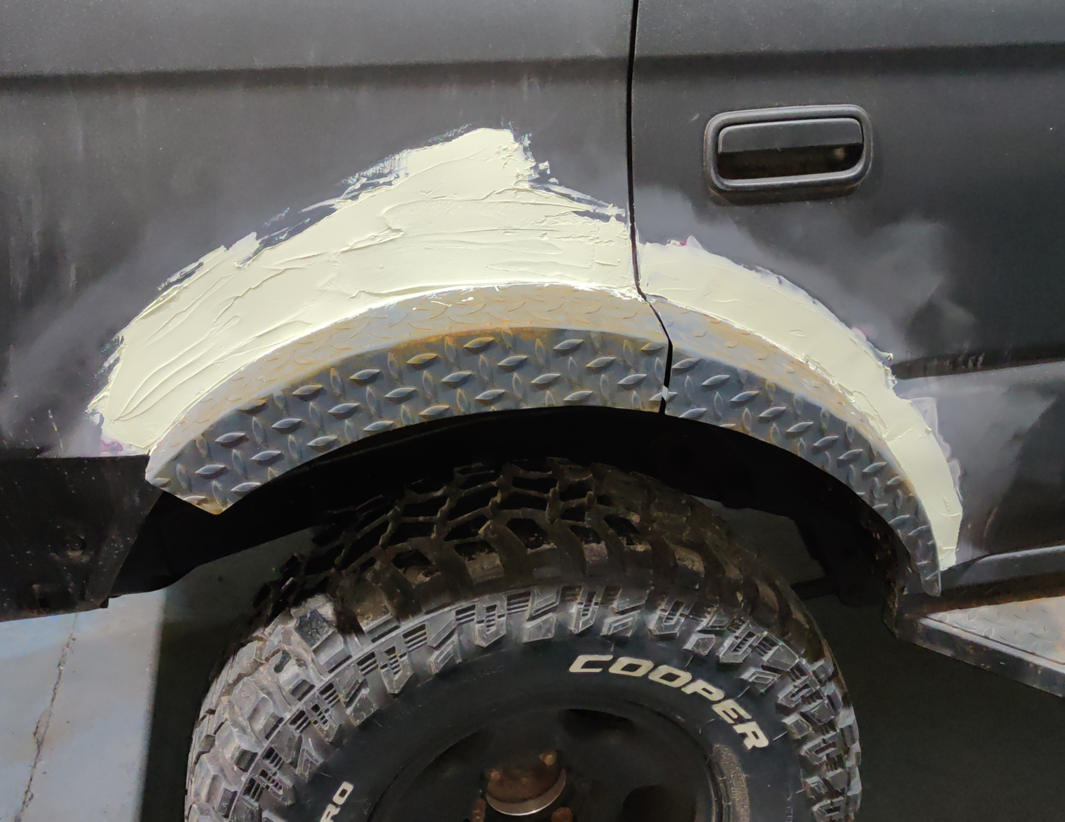

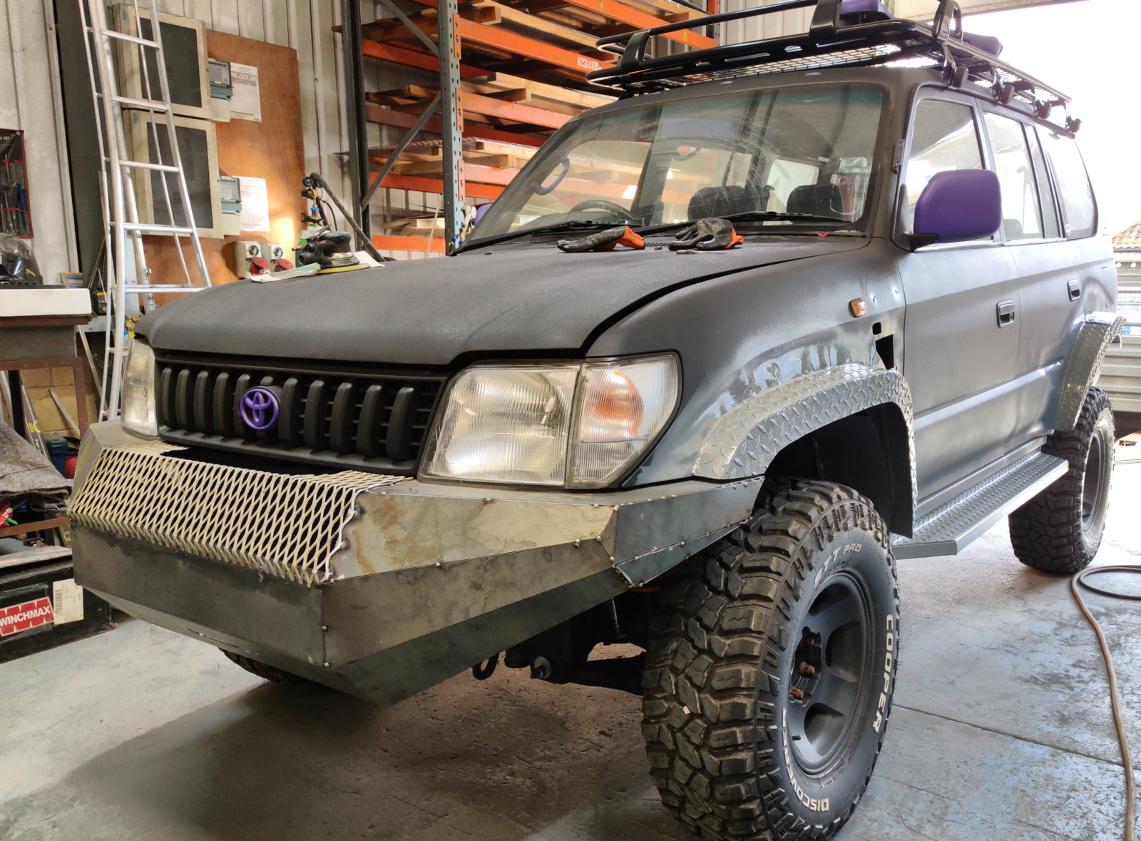

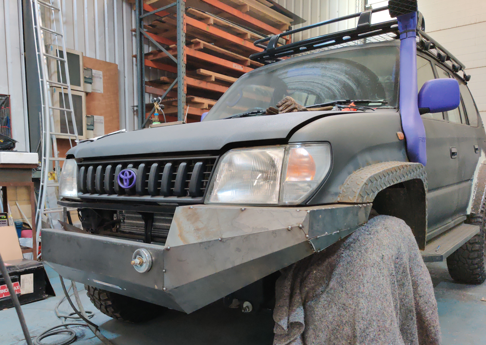

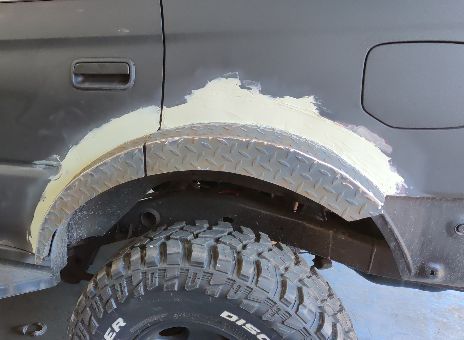

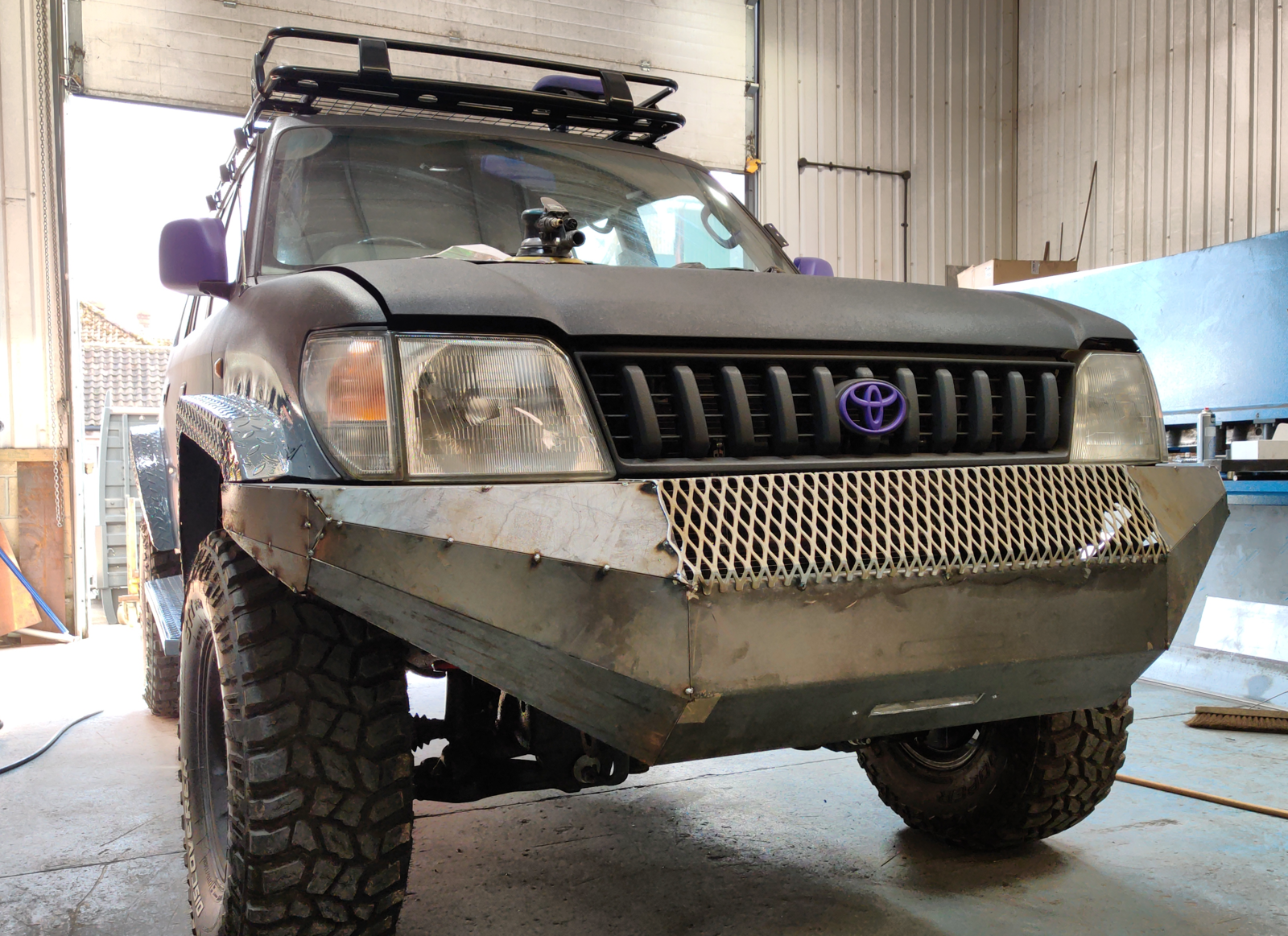

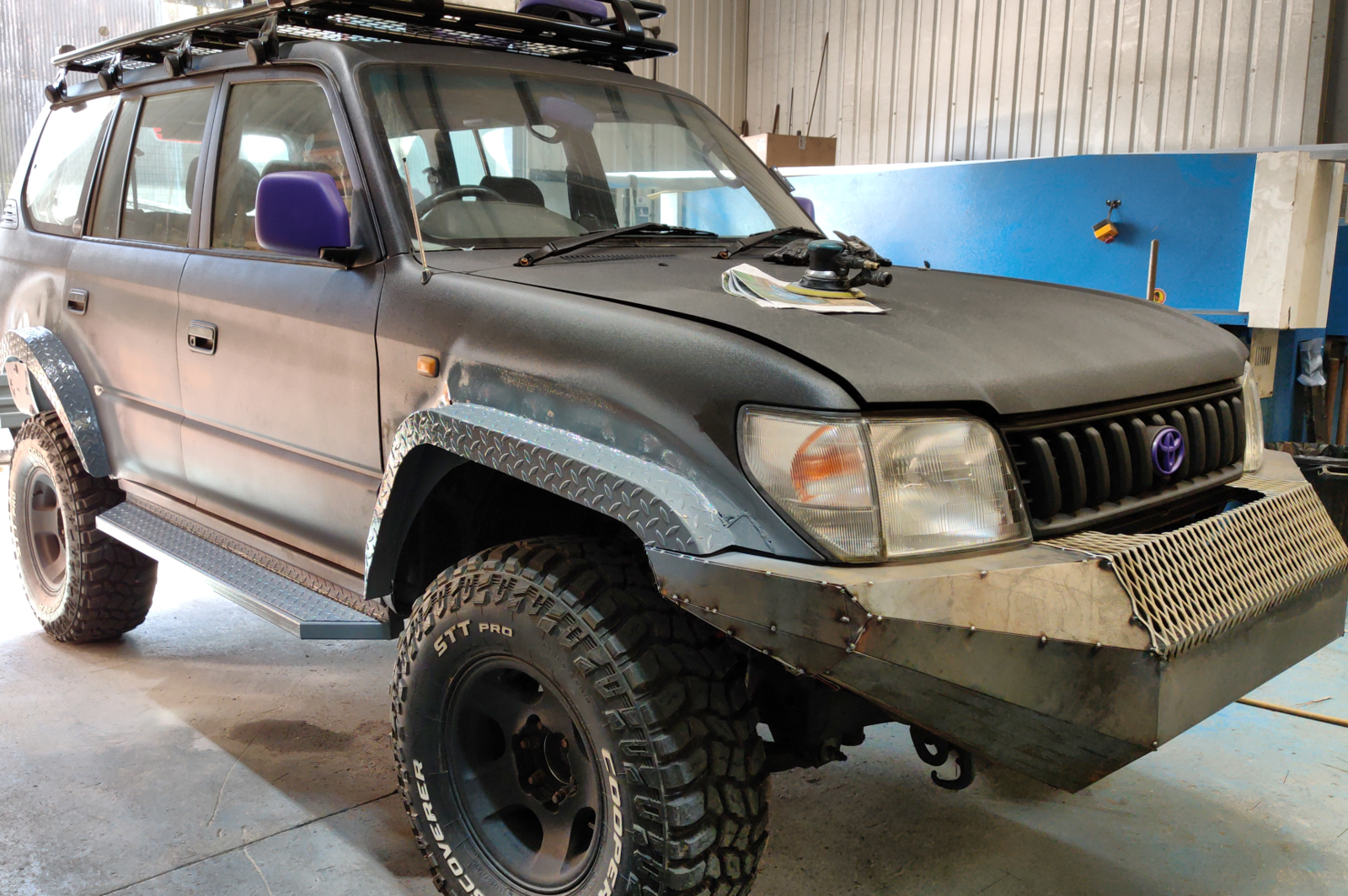

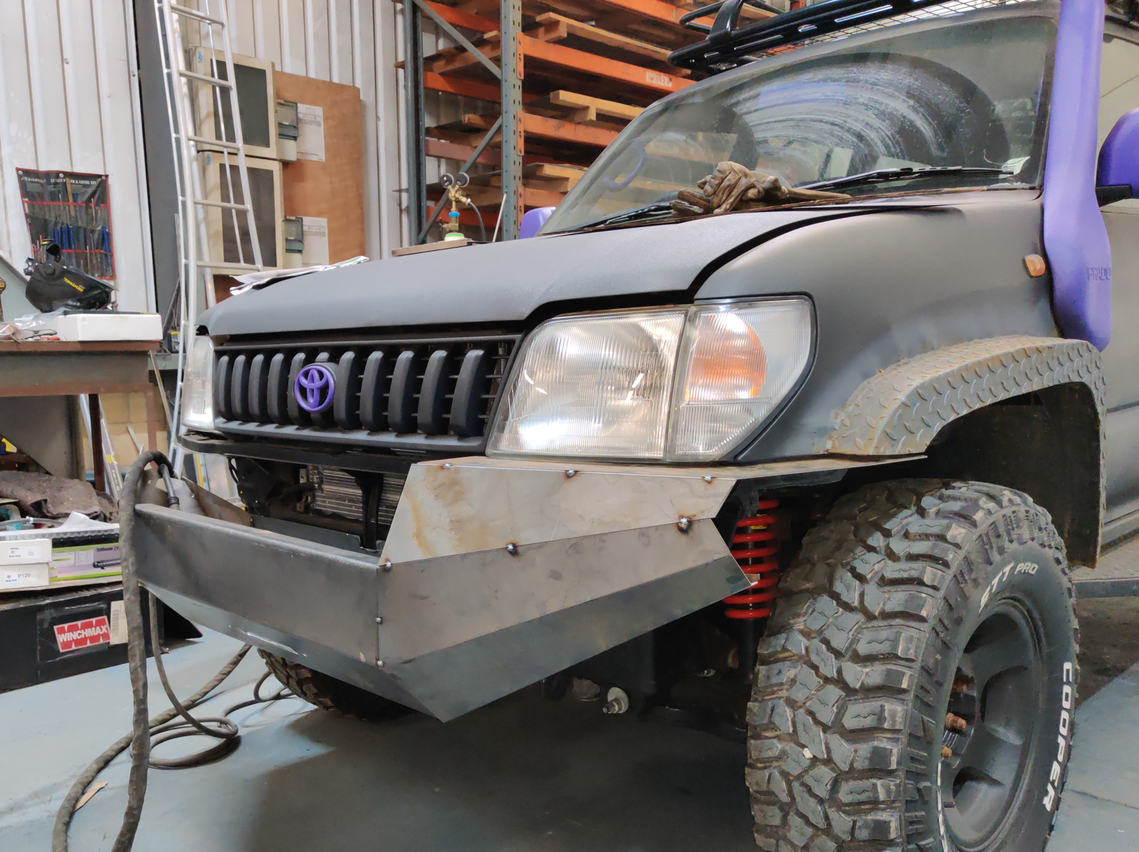

Hey guys... Finally got some time on the truck... Rear arches in final stages and front bumper started.
IMG_20200229_170117__01.png IMG_20200229_162141__01.png IMG_20200229_165719__01.png IMG_20200229_162101__01.png
Looking like a zombie apocalypse survival truck with all the new metal fab work.
So what which bank are you thinking of ram raiding :shifty:
I'm looking forward to seeing it in the flesh someday - its a tank :thumbup:
hahaha
The wife's first comment was "it's like something out of mad max"
