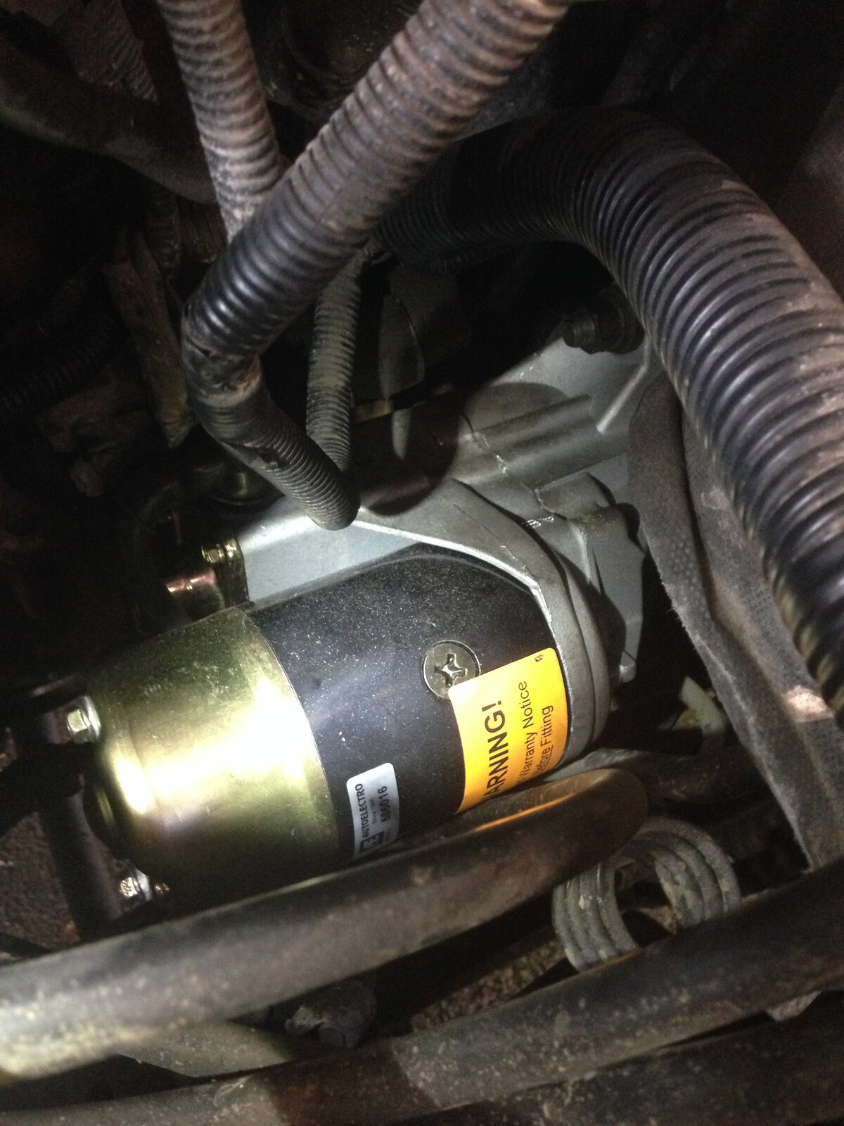

    Took it down to my local garage and they replaced the starter for a shiny new one (will get some pics and details of it later).

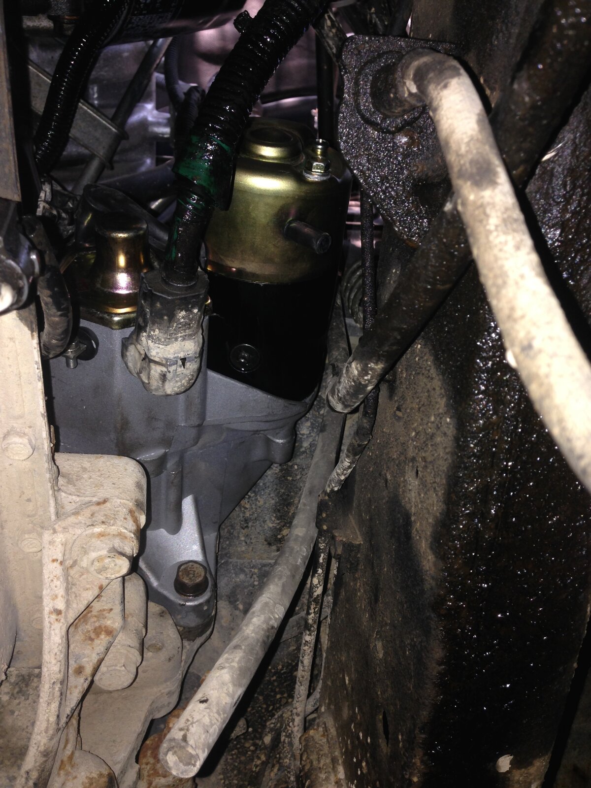

    New Starter below:

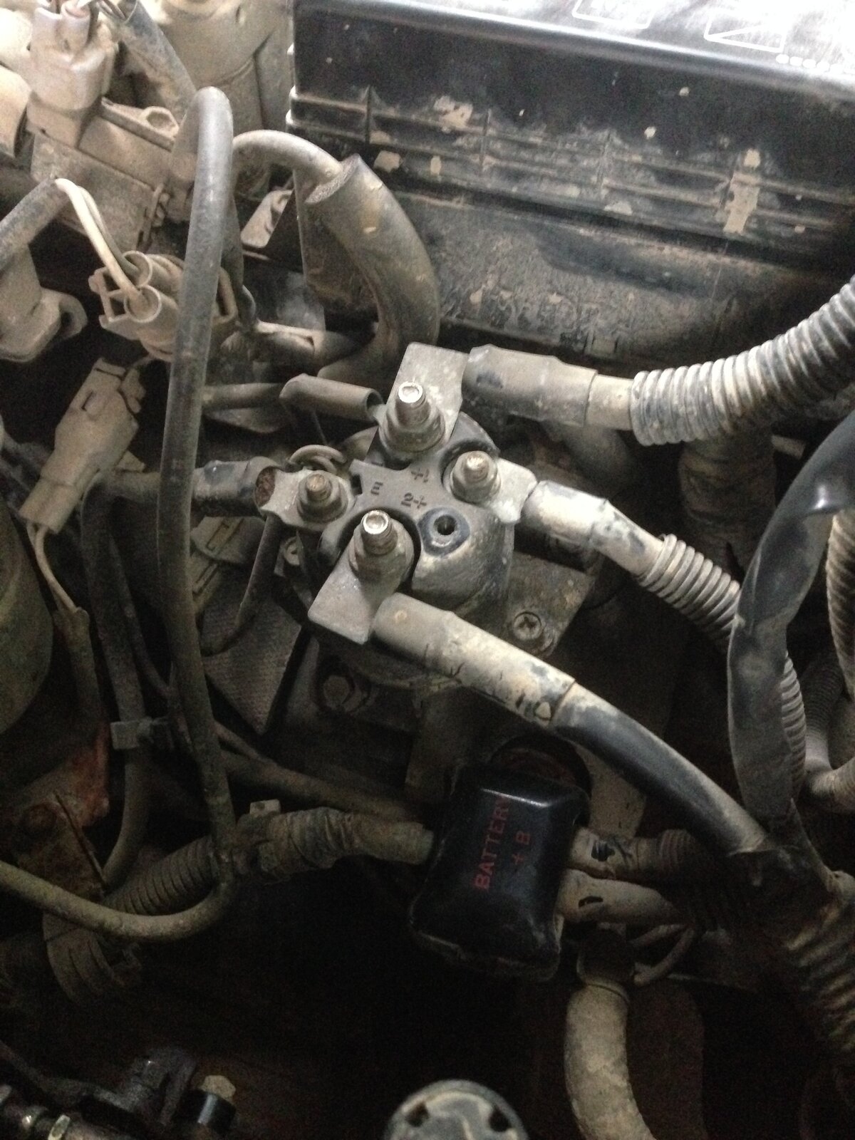

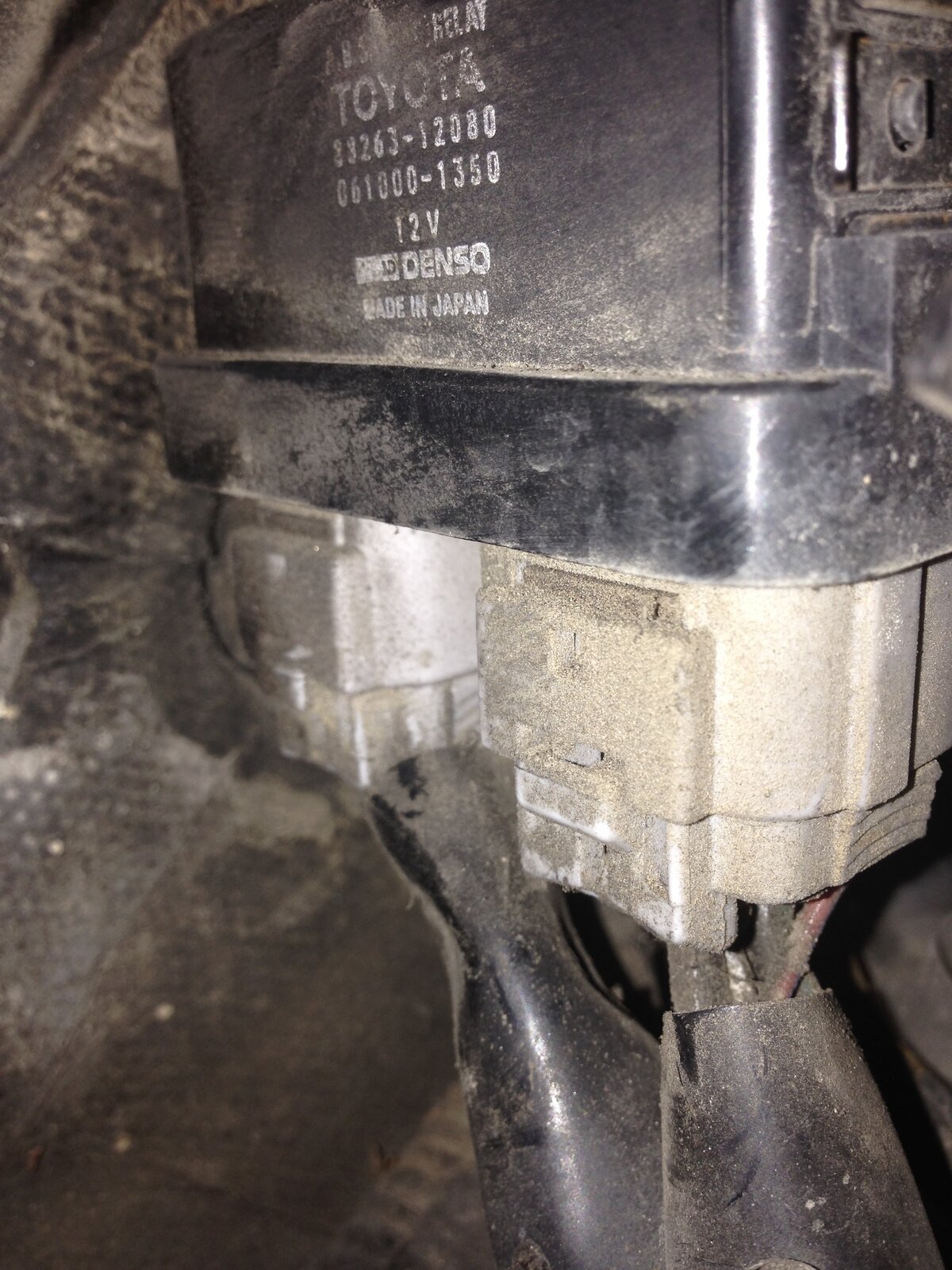

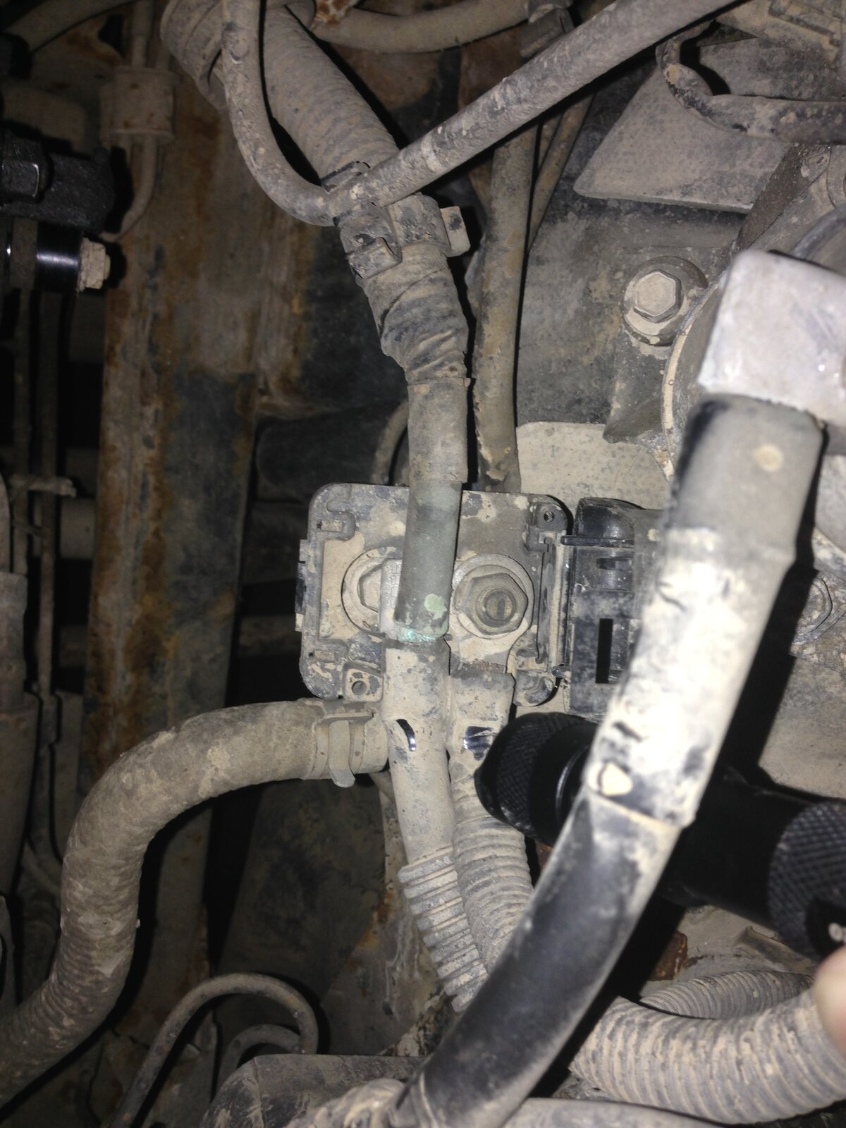

    So, the following are,
    12/24V Solenoid?:
    Battery + B (Not sure what this is):
    Starter Relay?:
    So I will check and clean up all these contacts and try to get their readings.
    Which parts of the battery should I disconnect before working on the electrical system? Normally I would just disconnect all the cables.
    Thanks

    The 'Battery + B" terminal connects the starter to the battery(s). There will be +12v present at this terminal except during cranking when it's 24v. To work on the electrics I just disconnect the earth terminal of both batts.
