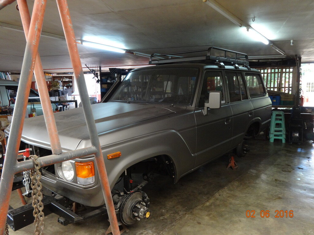

TLC HJ61 total reconditioning

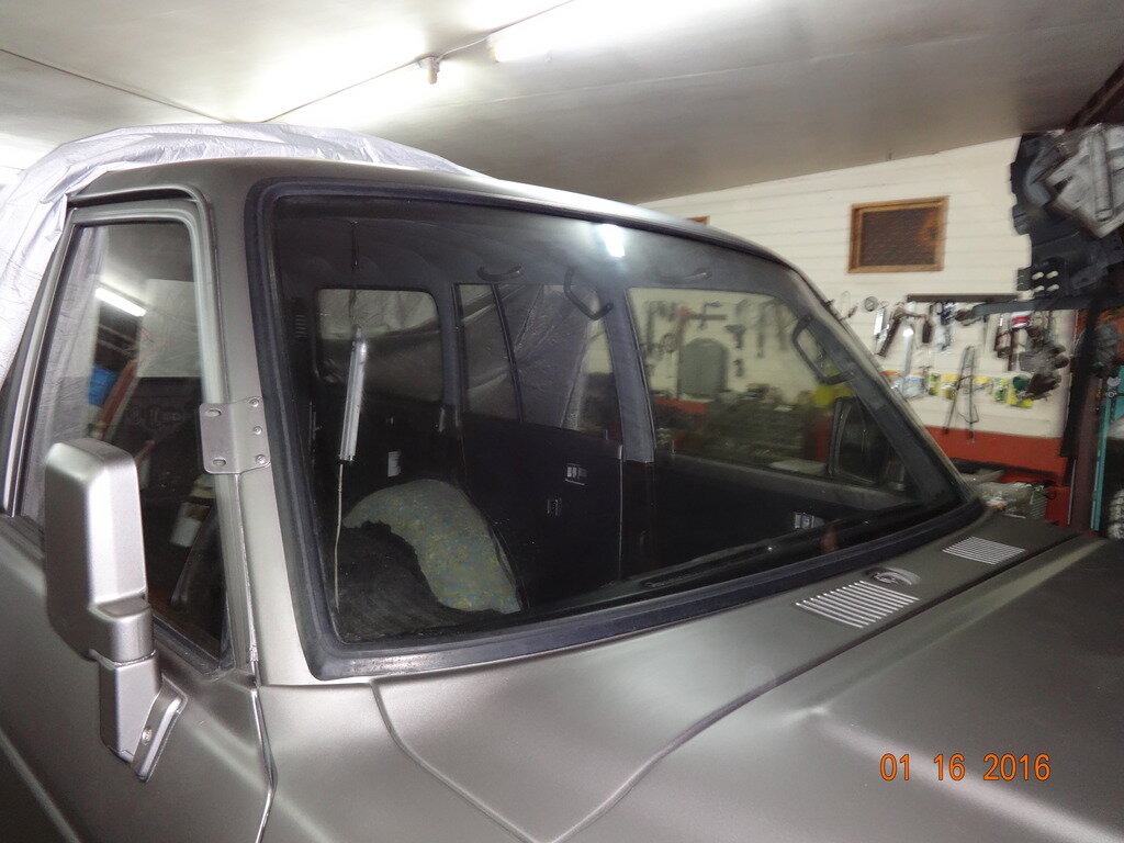

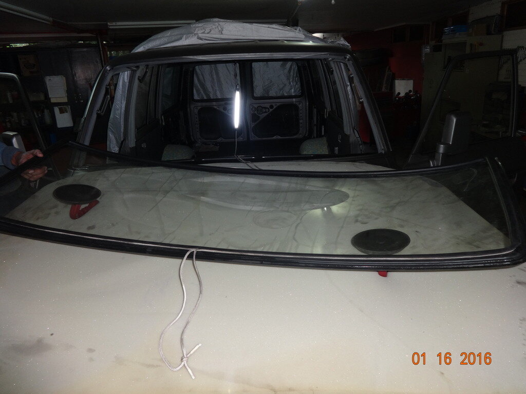

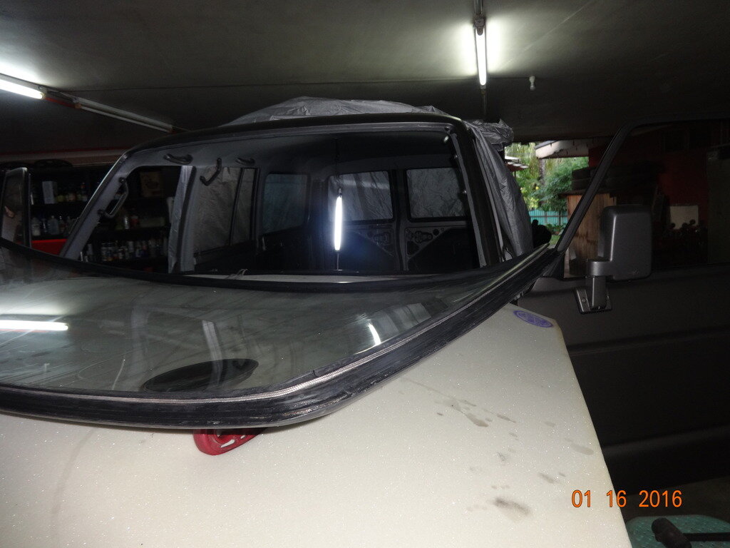

Windshield installation was a challenge. Took me 5 tries before I finally got it right.

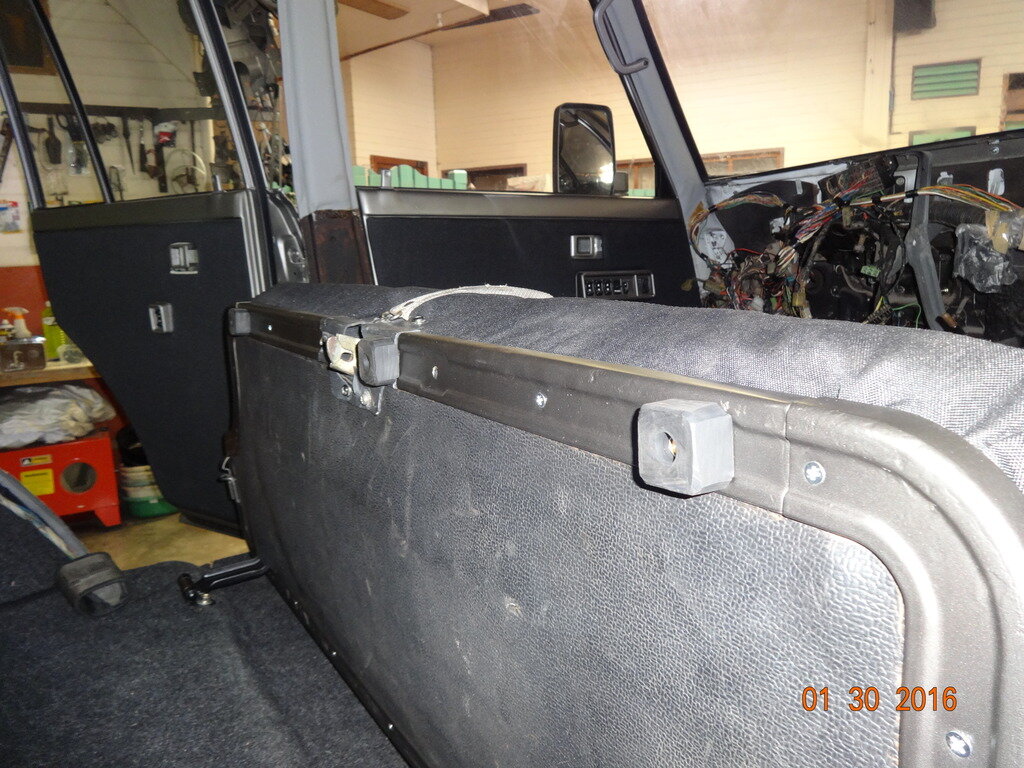

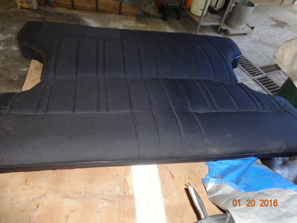

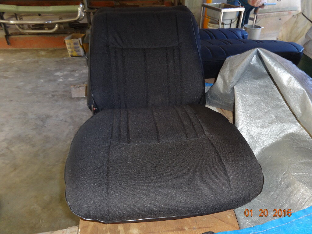

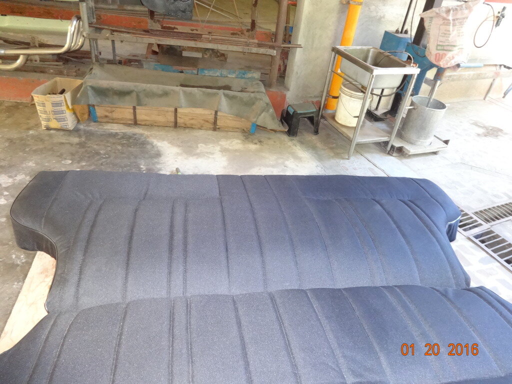

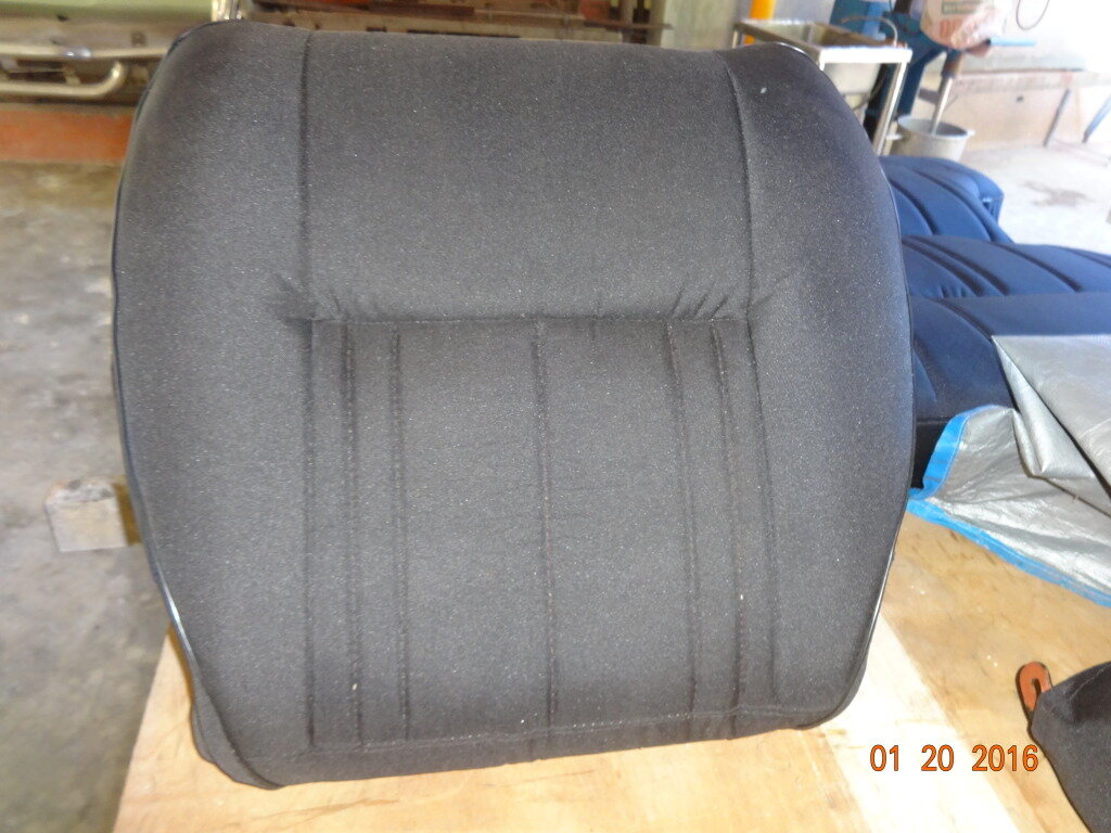

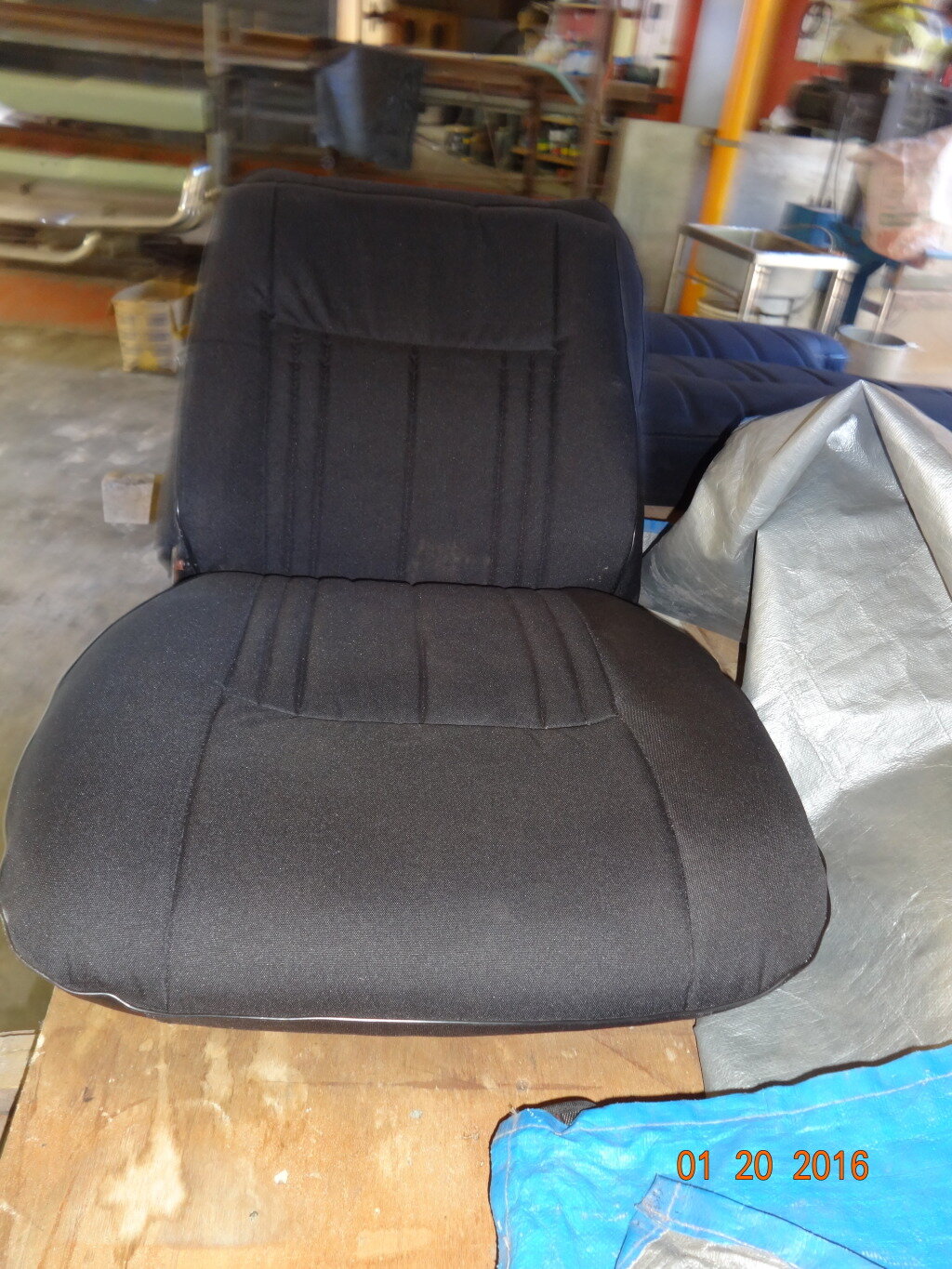

My seats just got in from the upholstery shop. Nice huh?
A nice coat of this product.

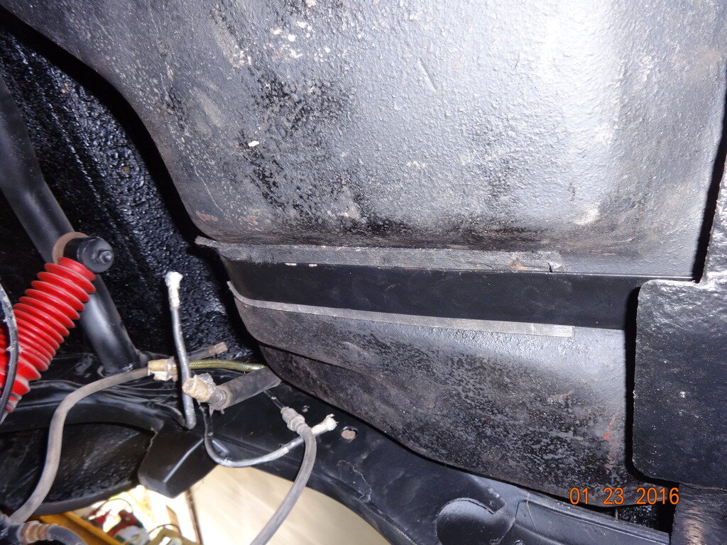

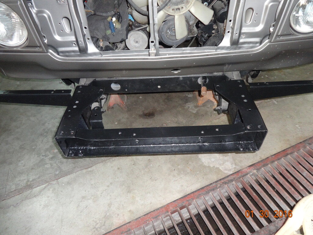

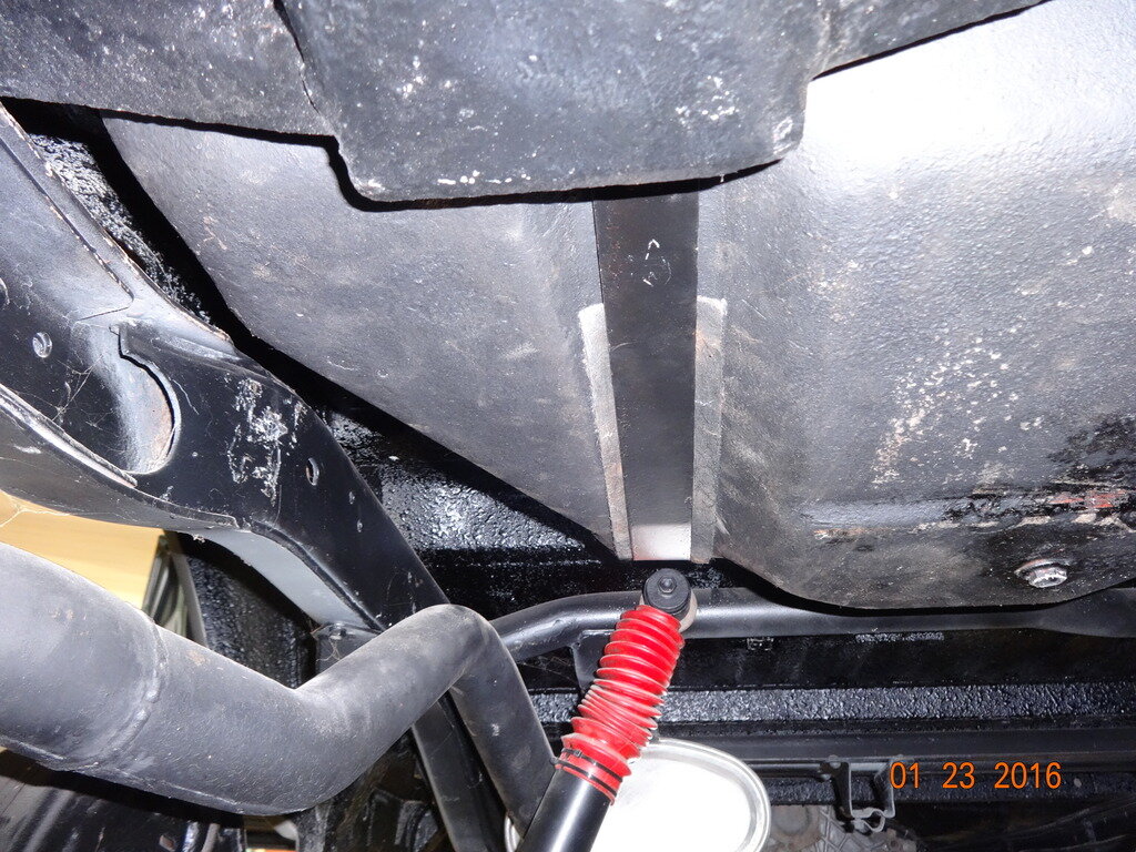

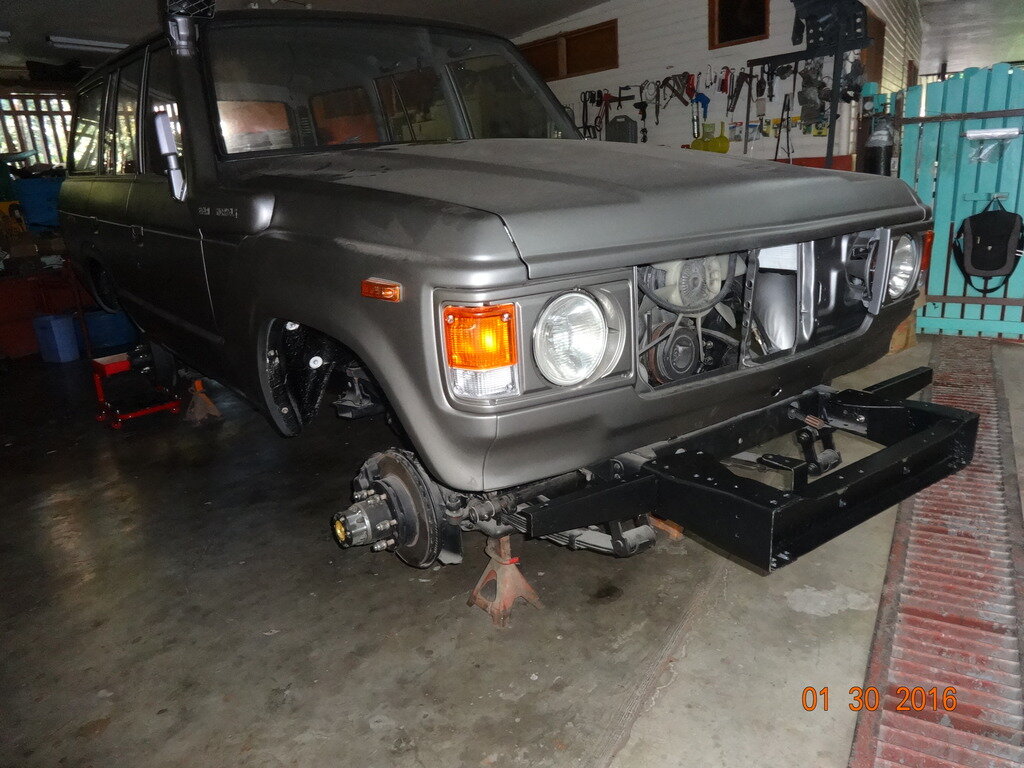

Installed gas tank and so with the underneath spare tire carrier.
Got the fuel tank done with the straps secured.

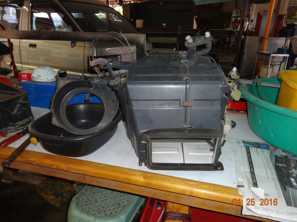

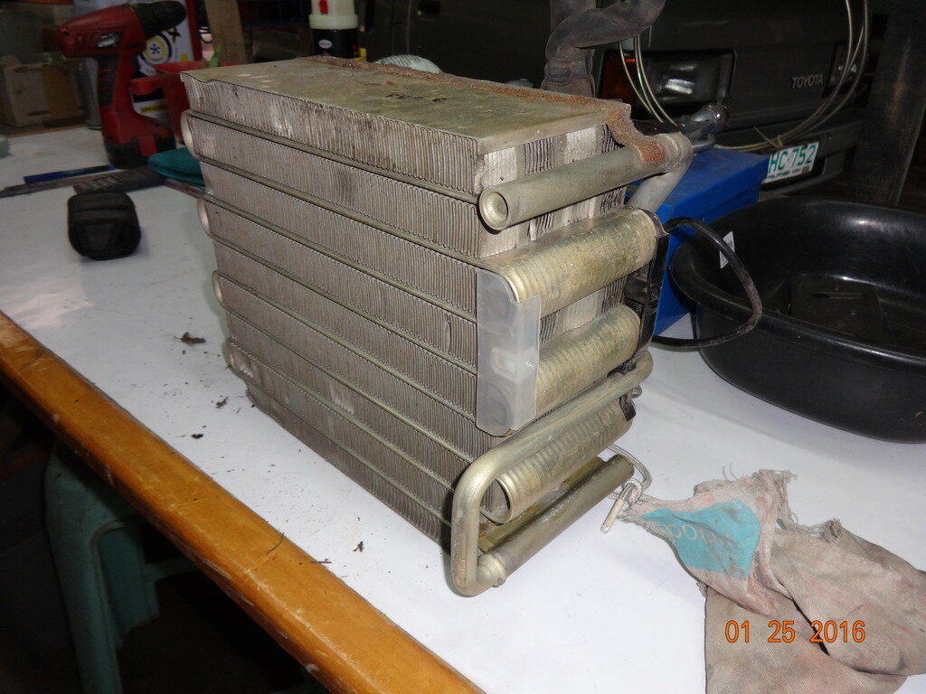

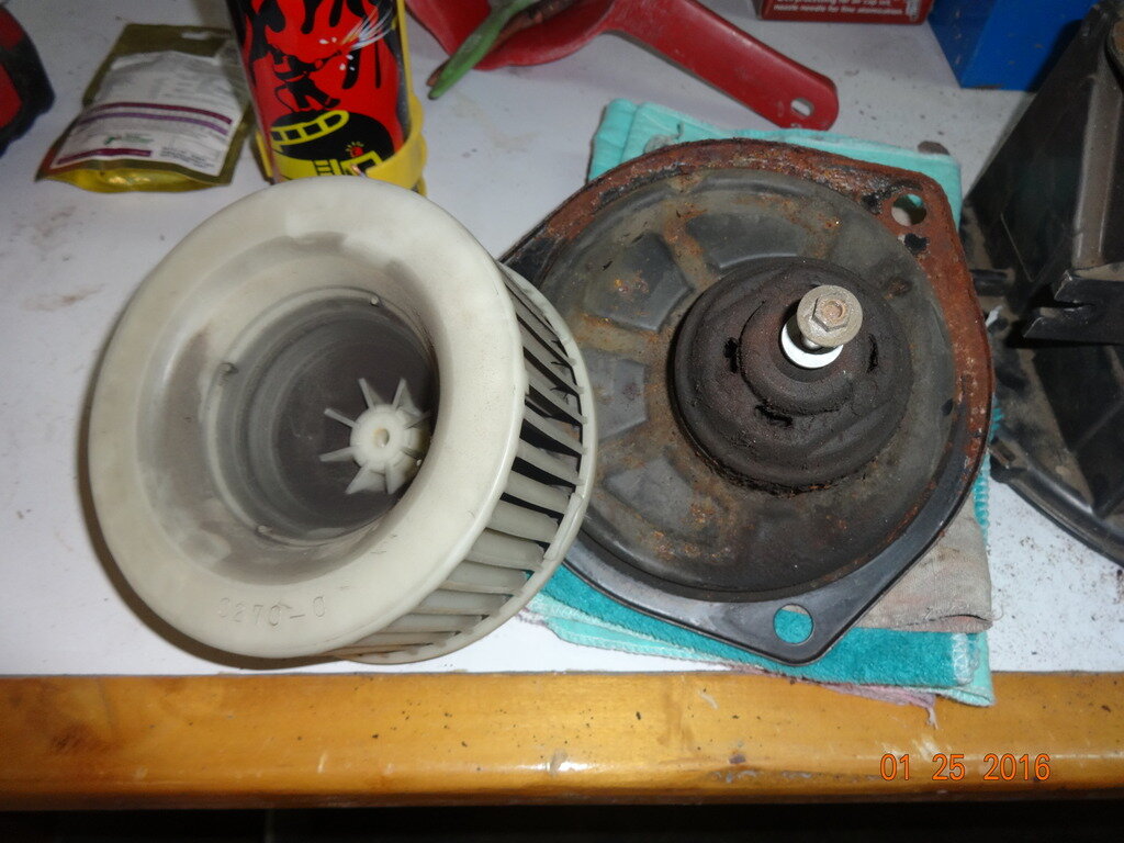

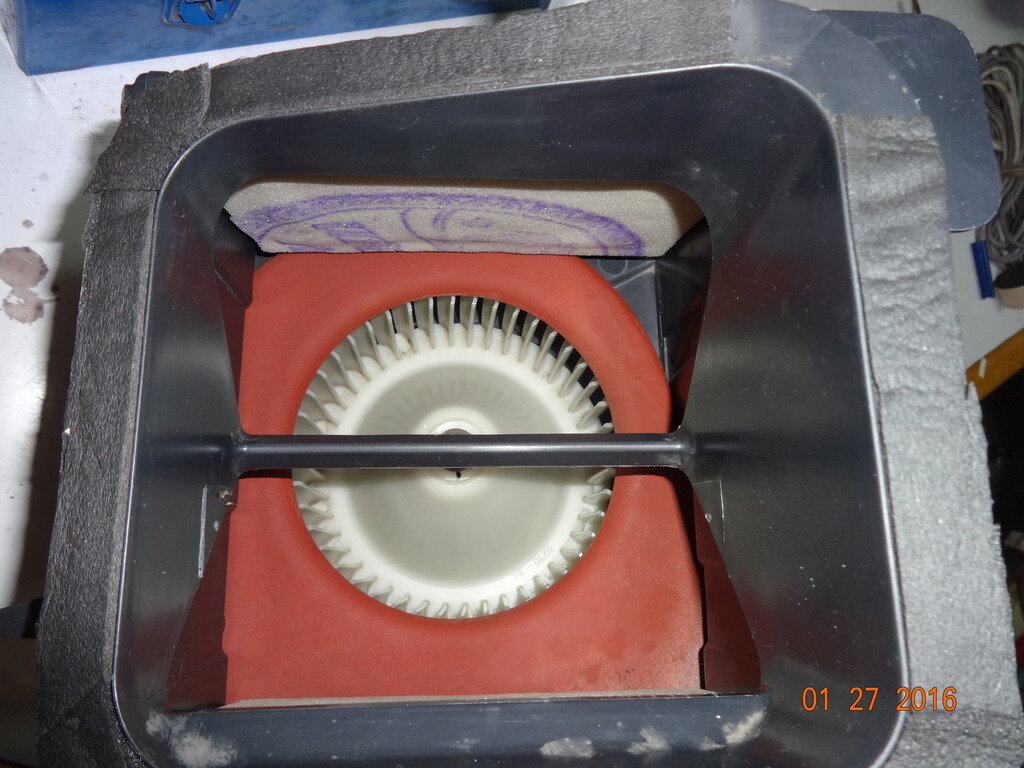

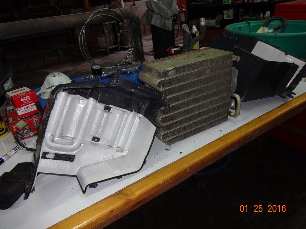

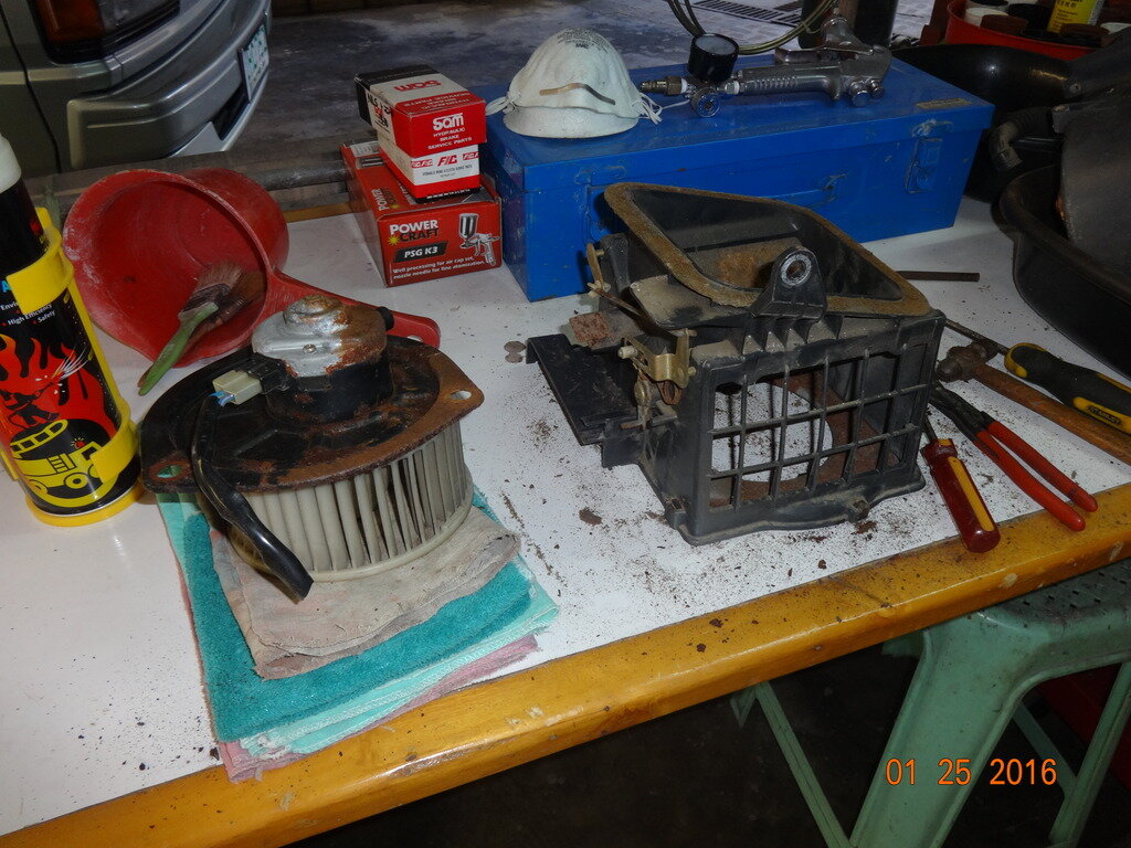

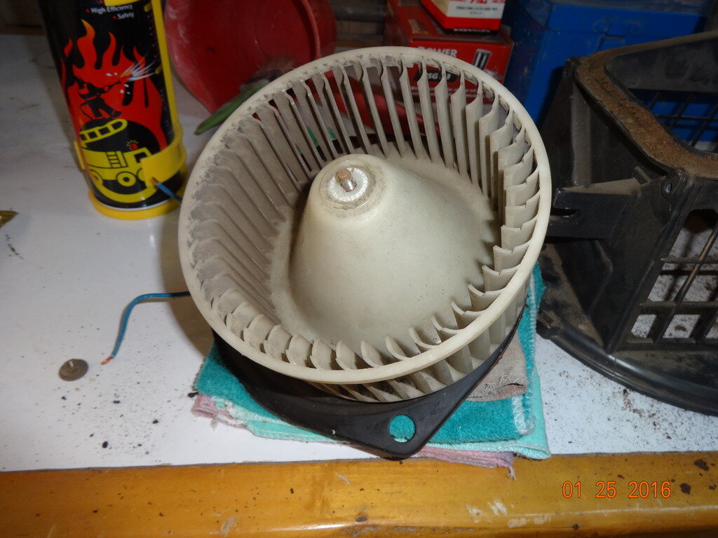

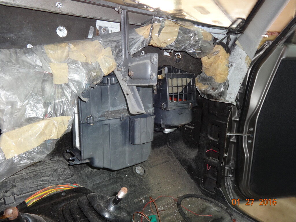

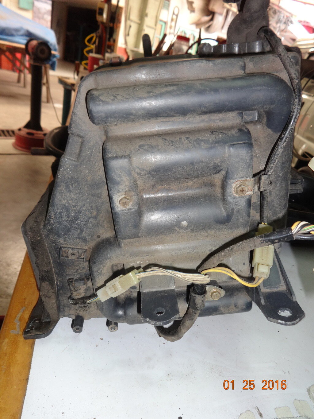

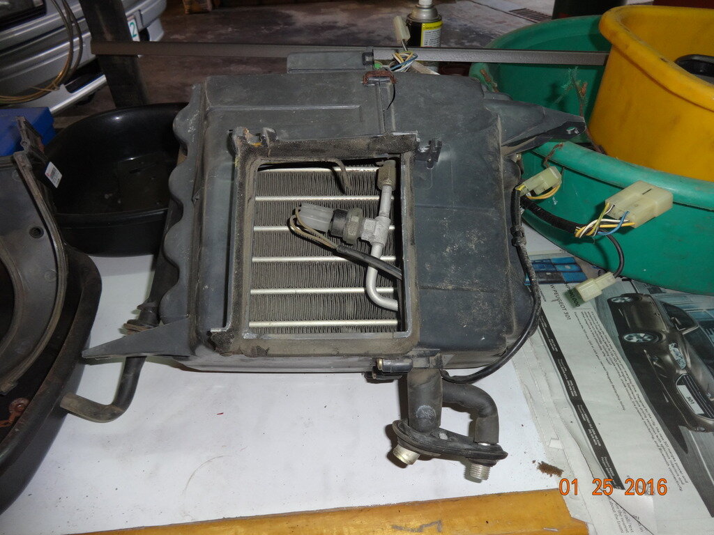

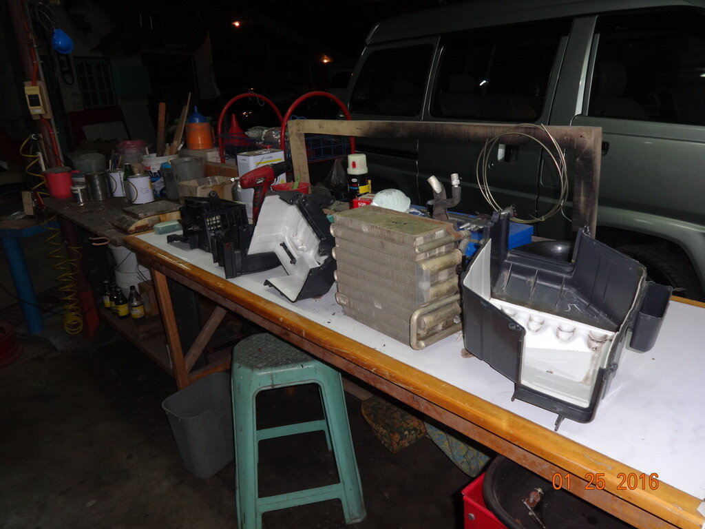

The A/C evaporator and blower arrived from the US. It is a used one and hopefully everything turns well. The blower still works. I still have to do a leak test on the evaporator.

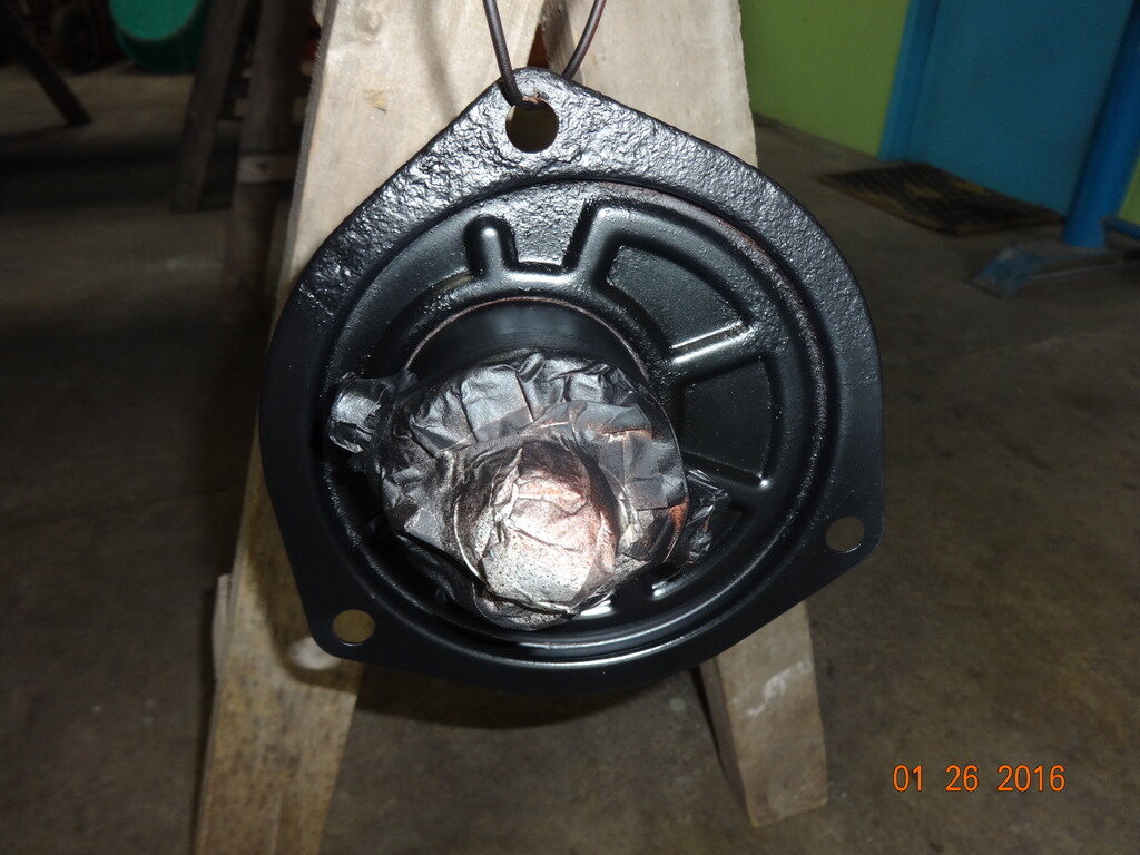

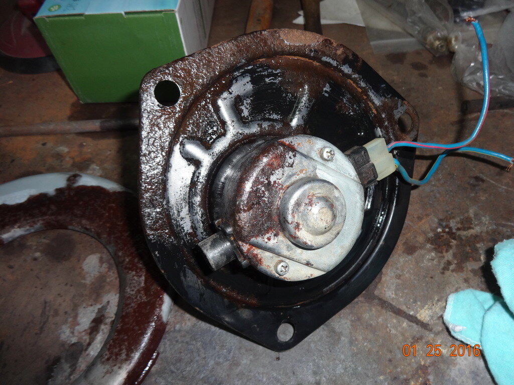

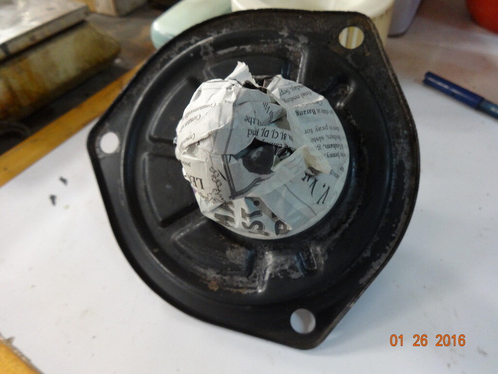

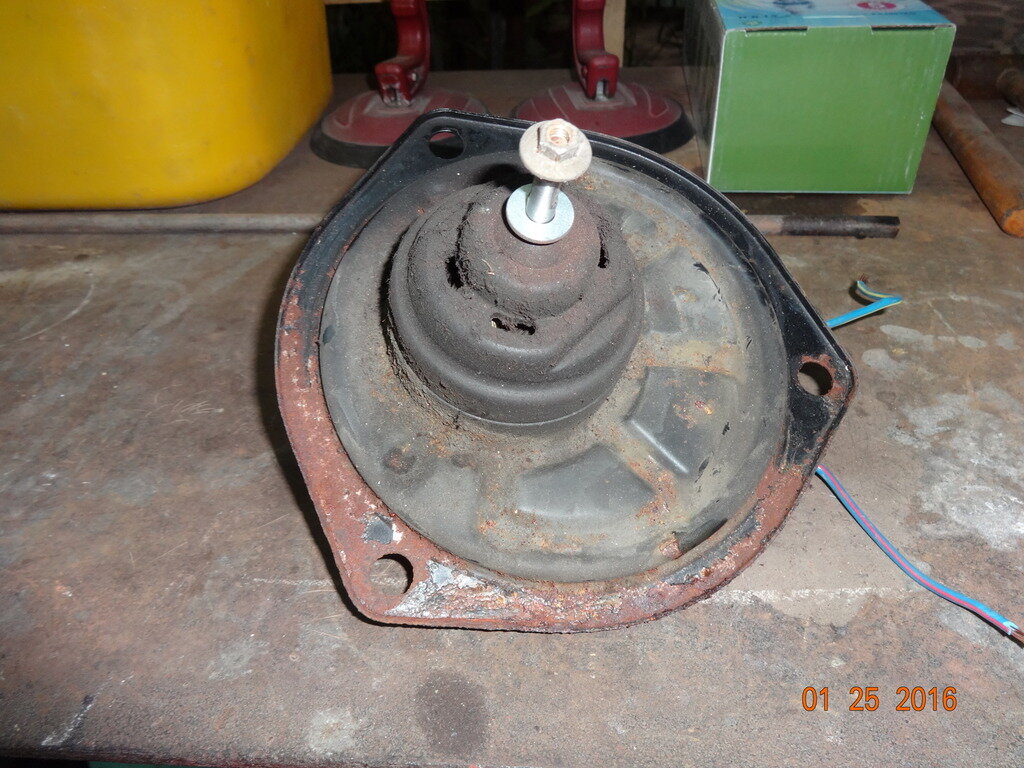

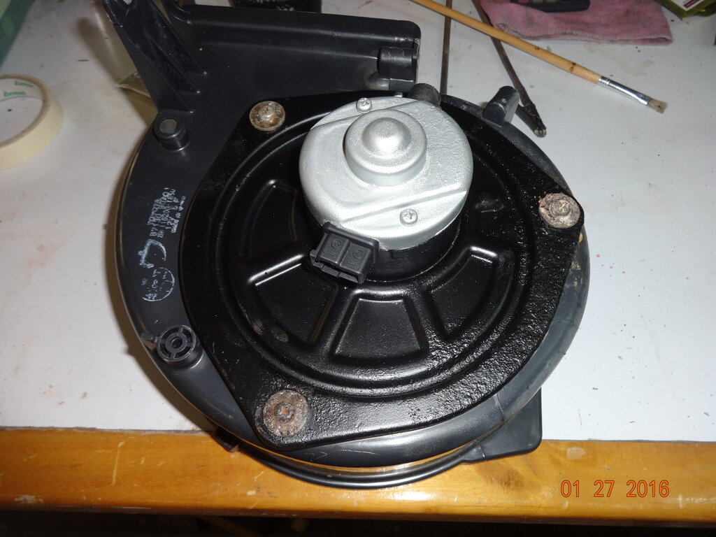

The blower motor needs a little cleaning and painting.

I remember getting my fuel tank in, after the body was installed, and the stabilizer brackets were welded to the chassis...... that was a challenge, and made me end up repainting a lot of scratches :icon-biggrin:

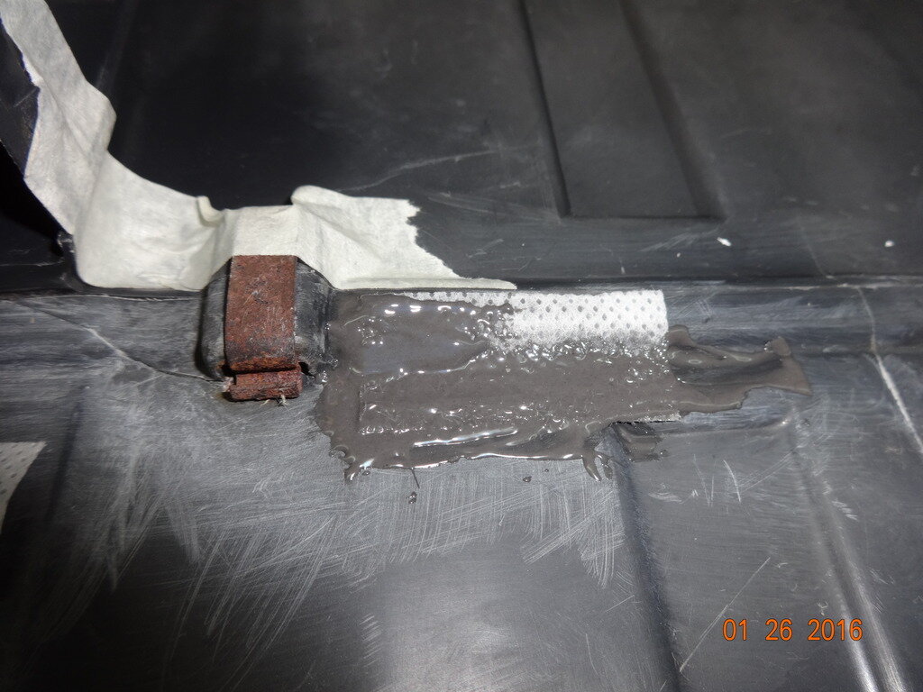

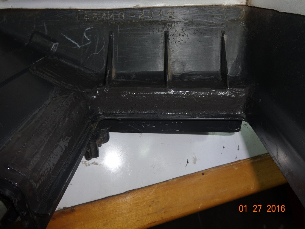

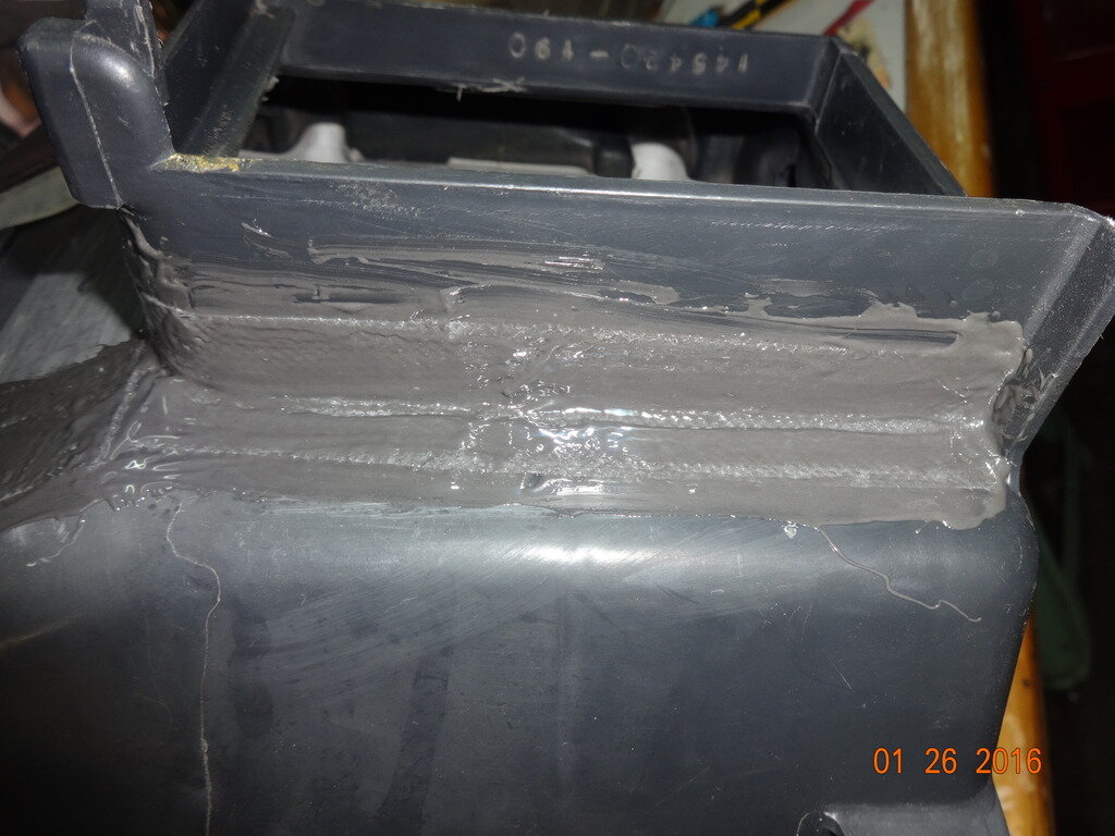

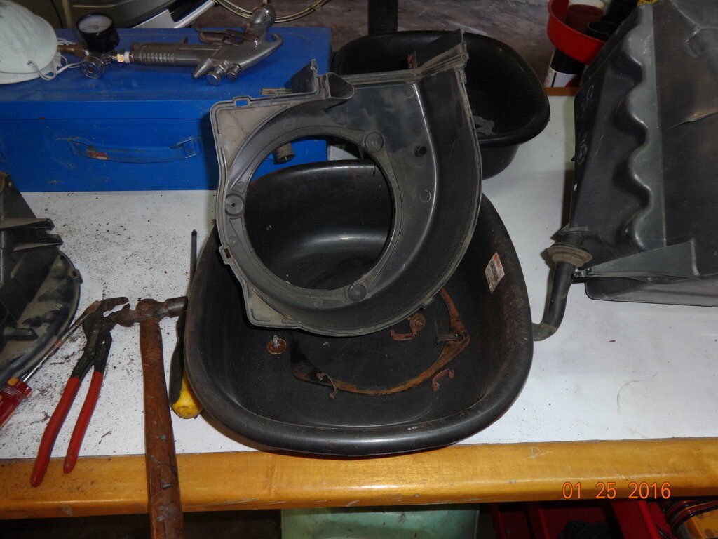

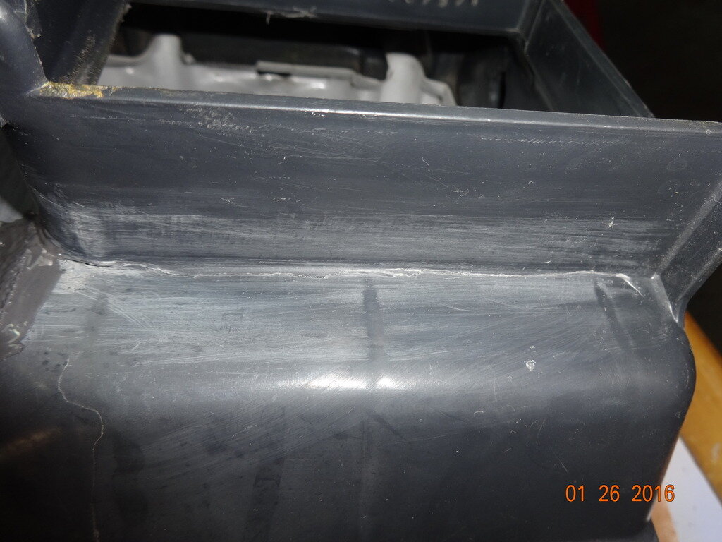

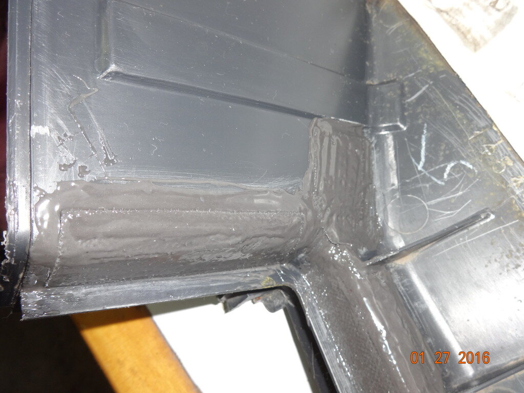

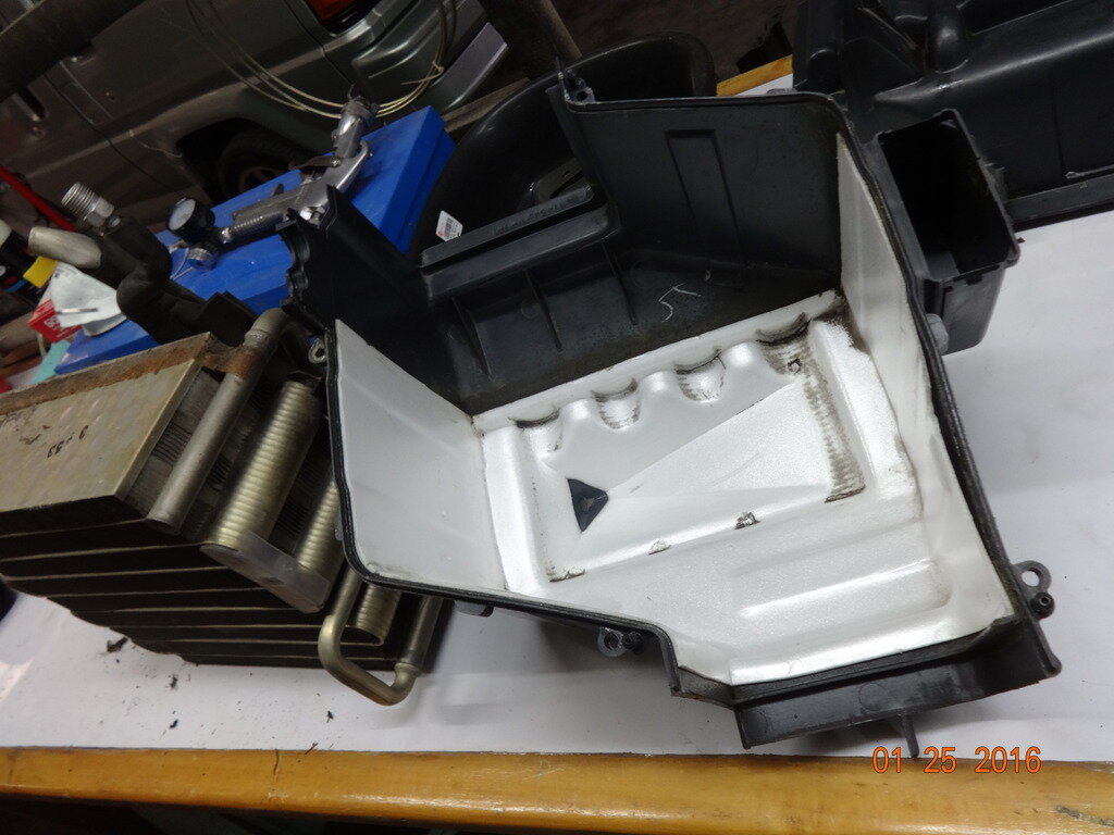

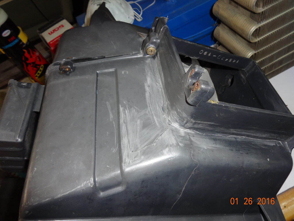

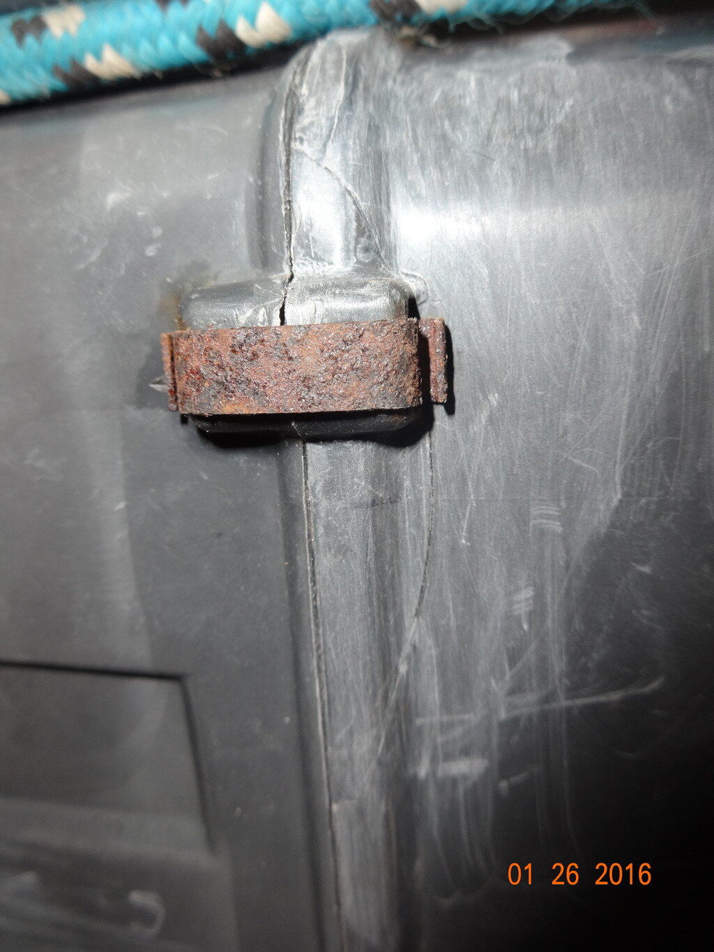

Took the evaporator housing apart for cleaning. It does have a few cracks.

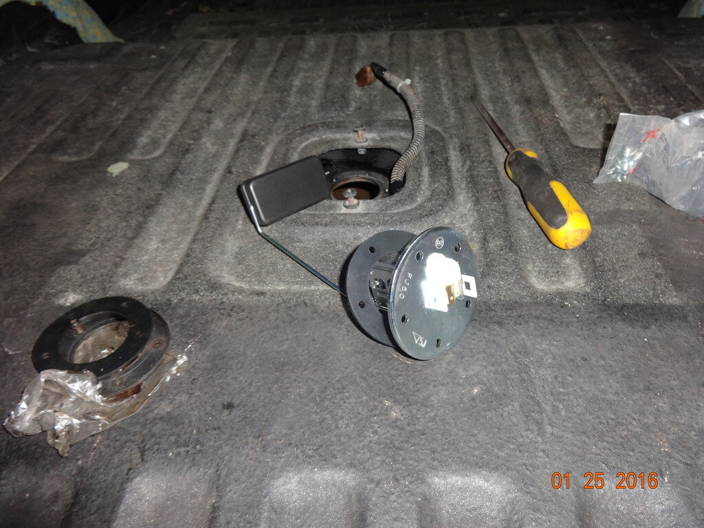

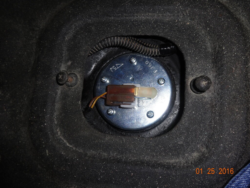

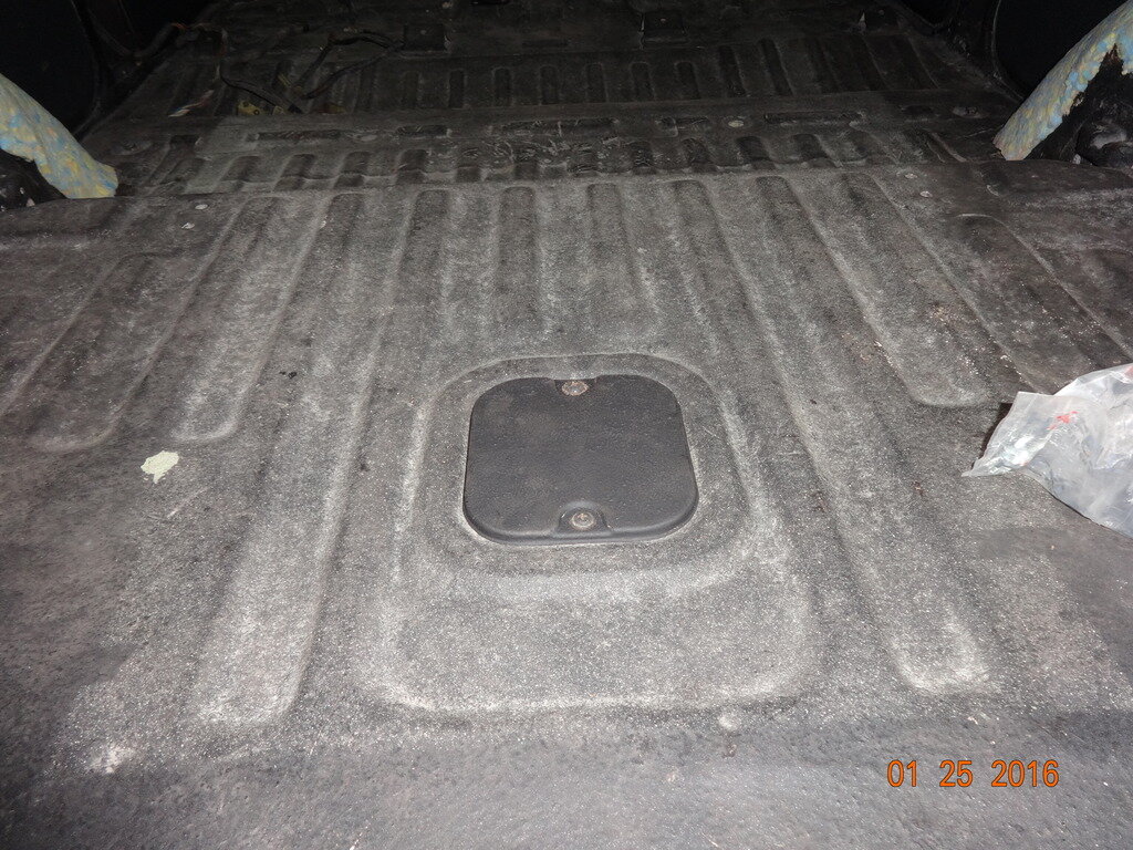

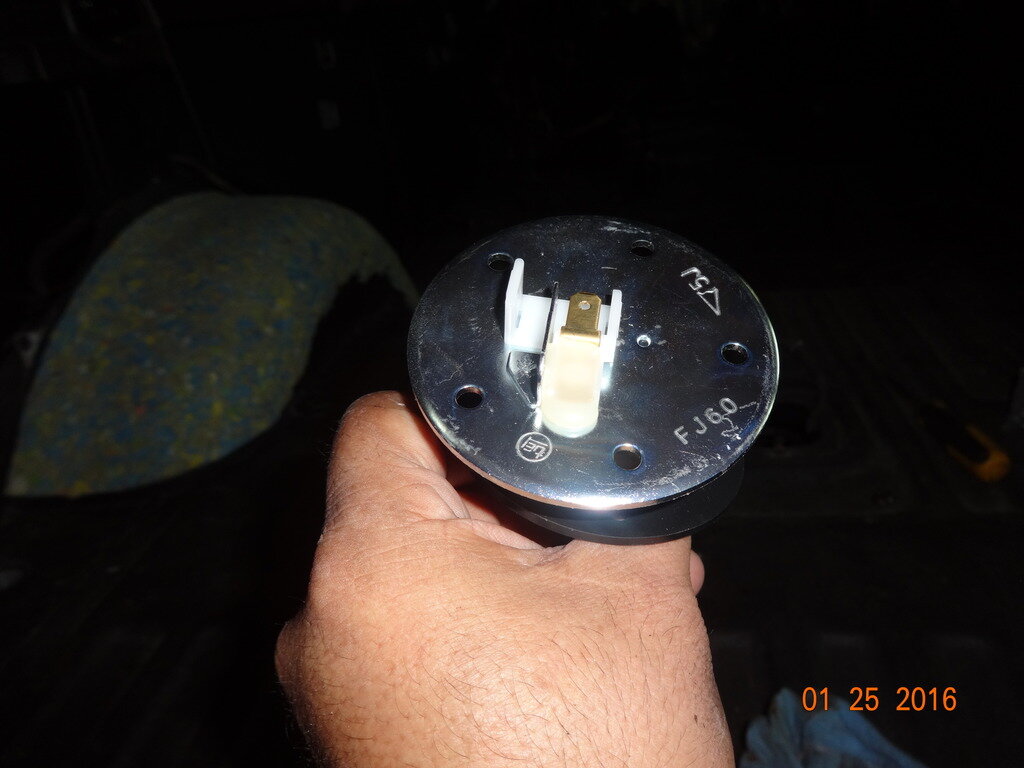

The fuel gauge sender unit is installed.

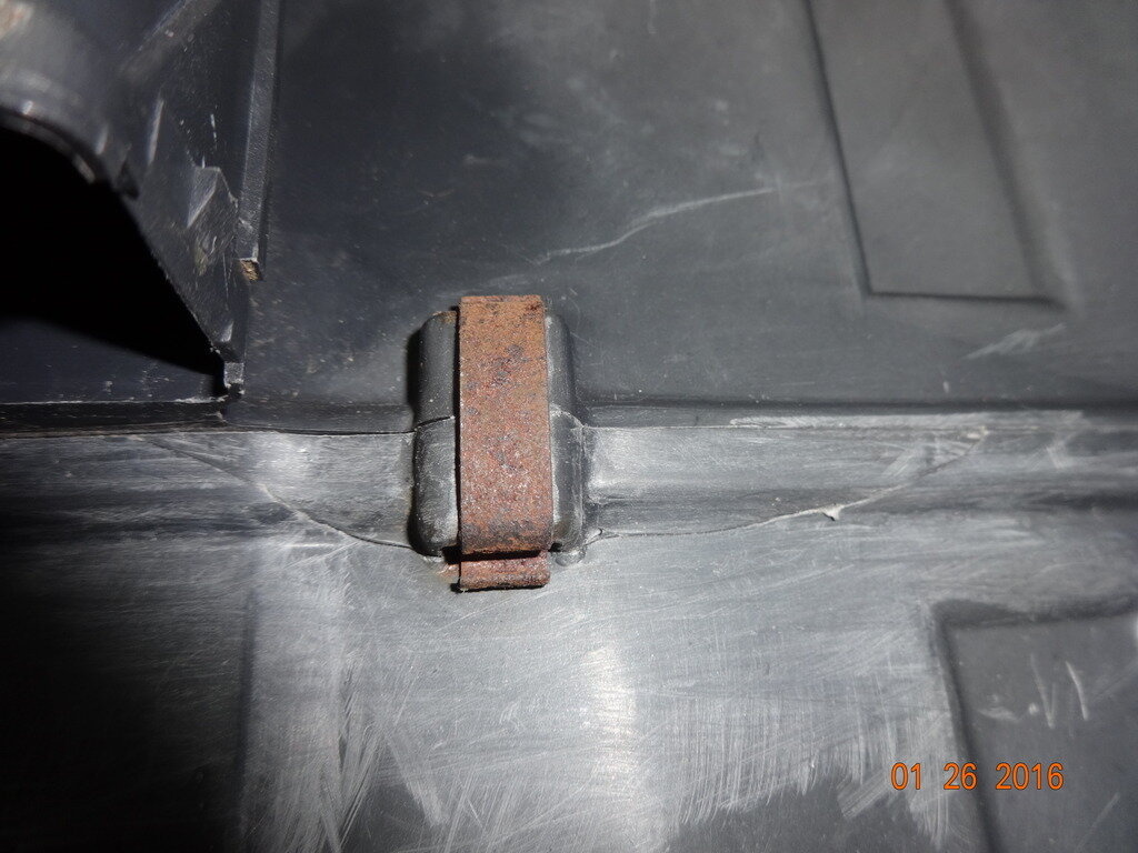

I have patched the cracks on the housing of the A/C evaporator.

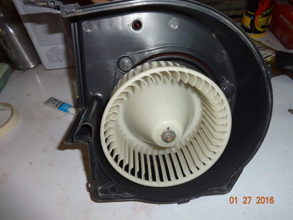

The blower motor before and after painting.

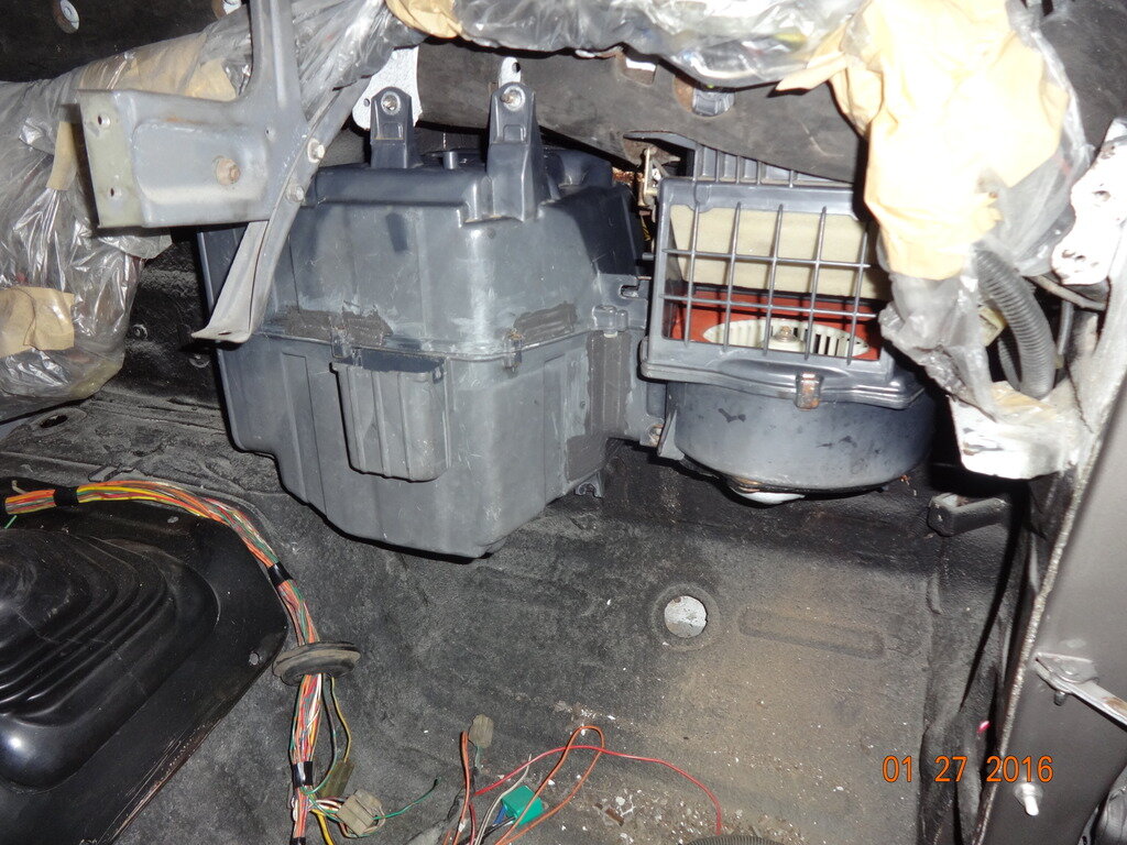

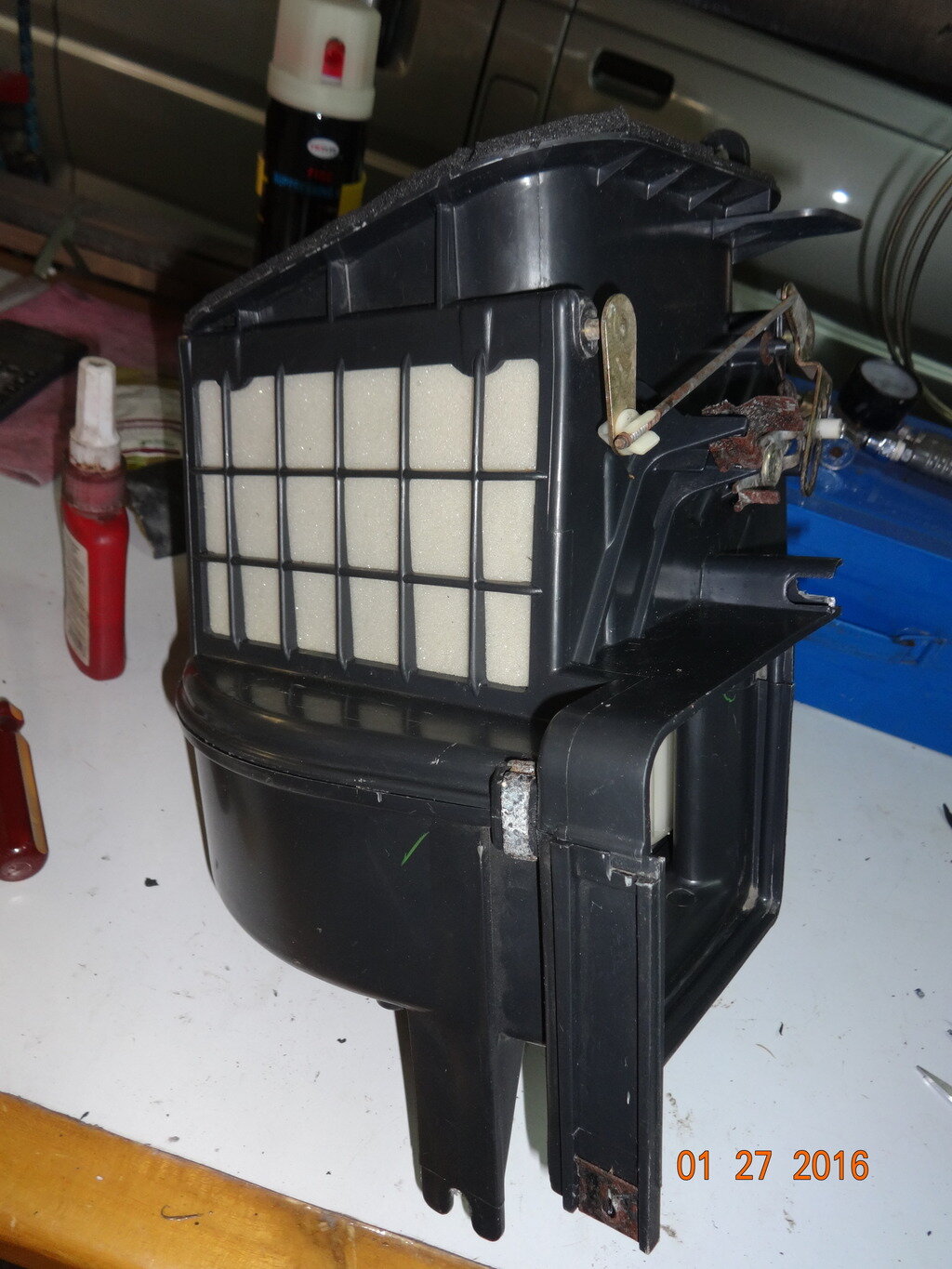

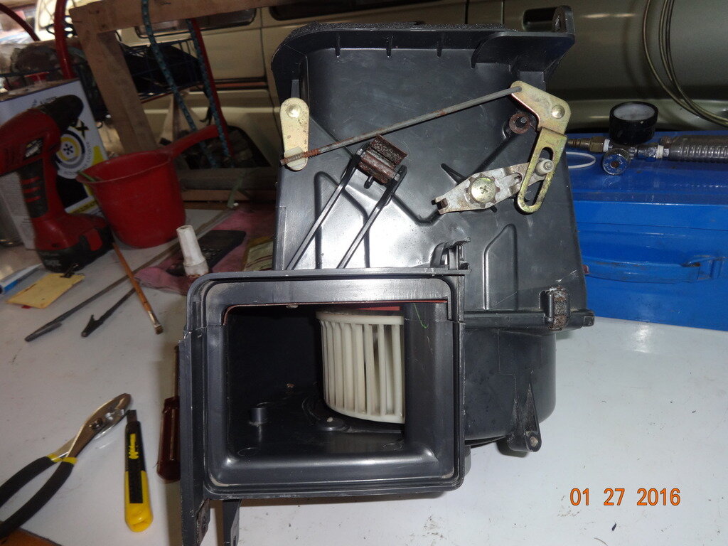

The A/C blower is installed in its housing.
The A/C evaporator housing is repaired of cracks and assembles for fitting.

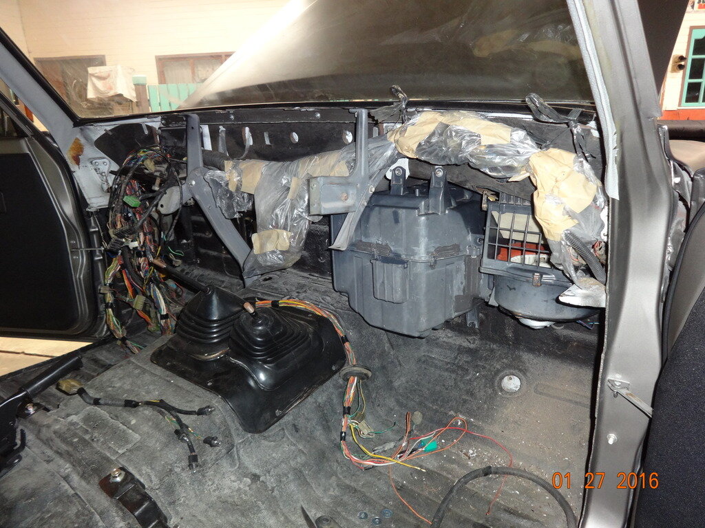

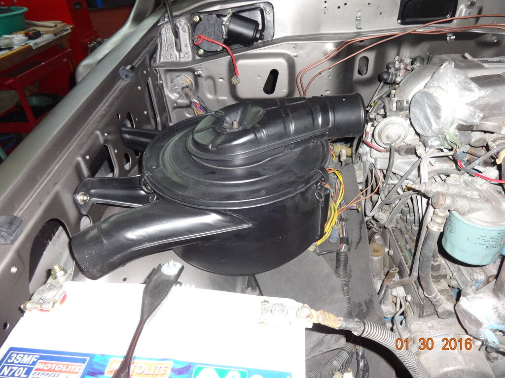

Tried to mount the A/C unit on the Willie and it fits perfectly. I got lucky.

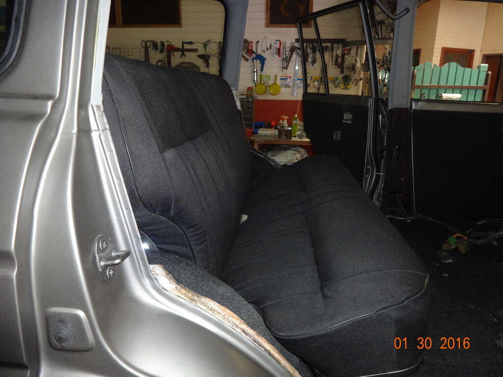

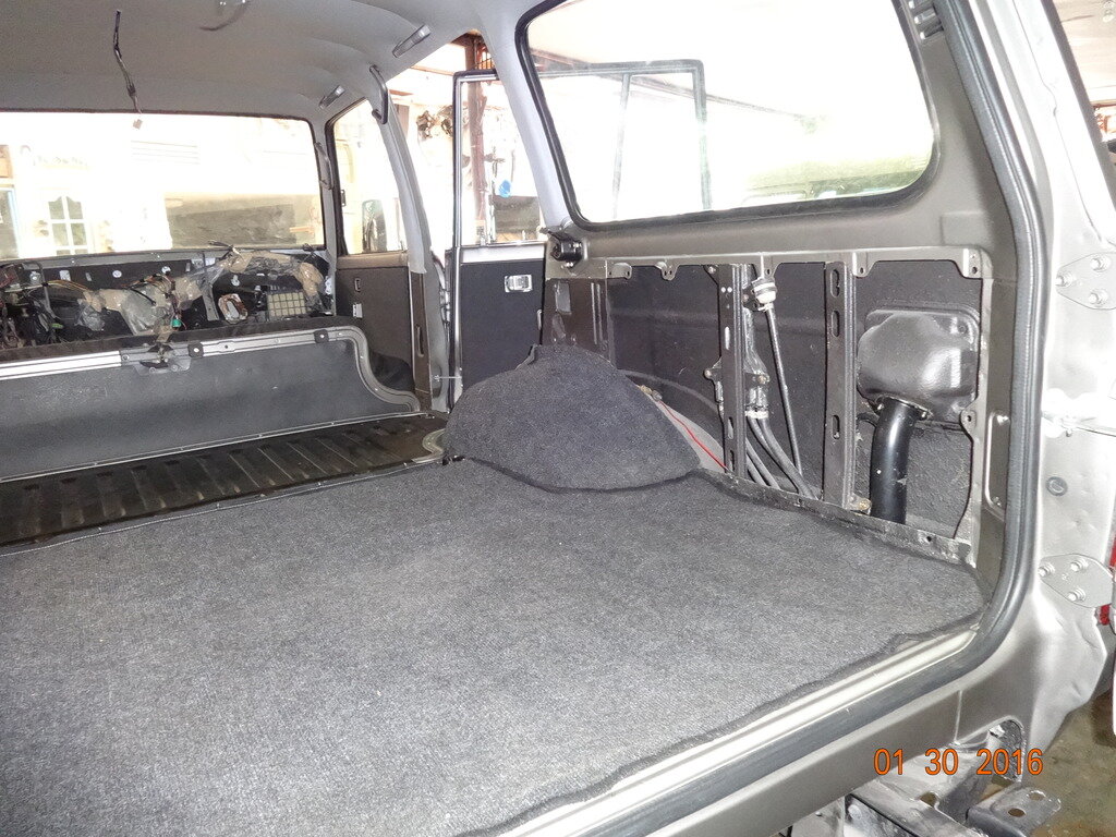

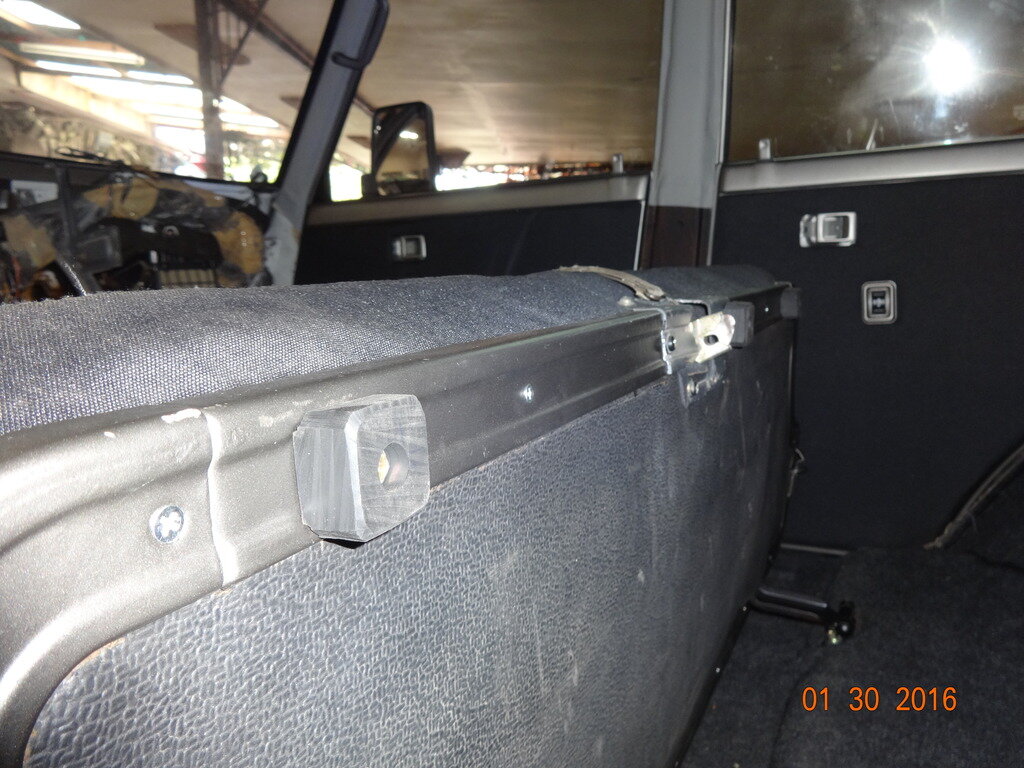

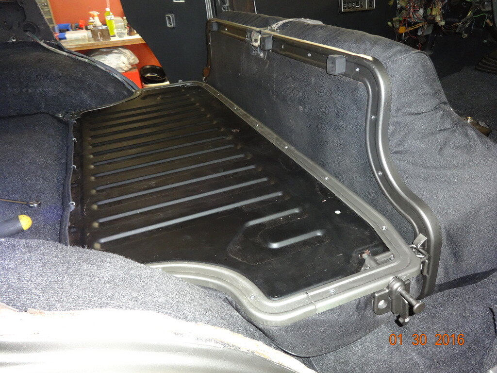

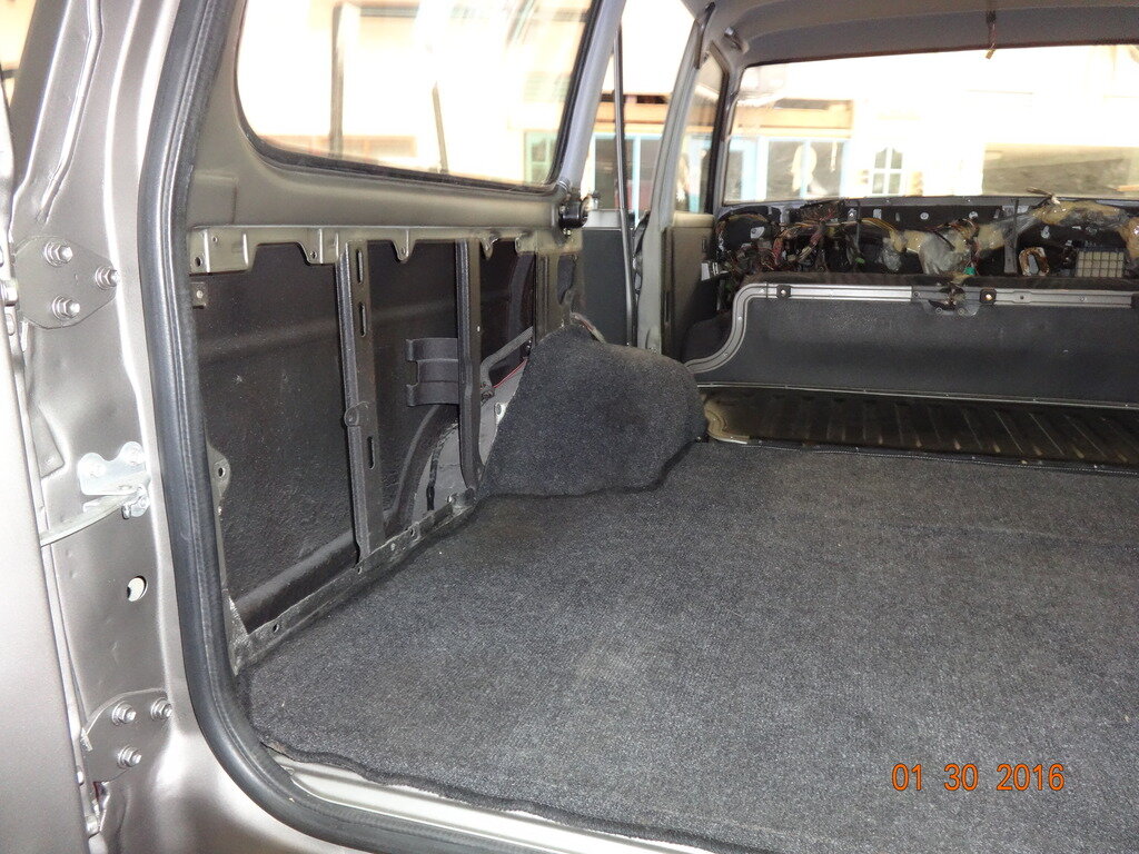

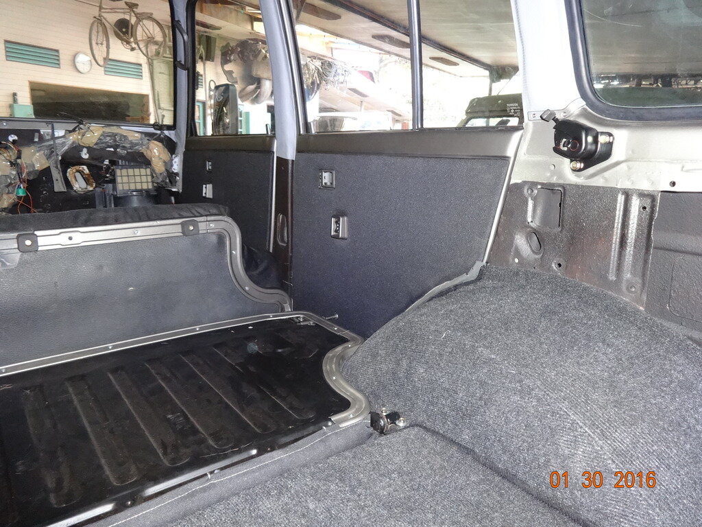

Got the rear seat installed.

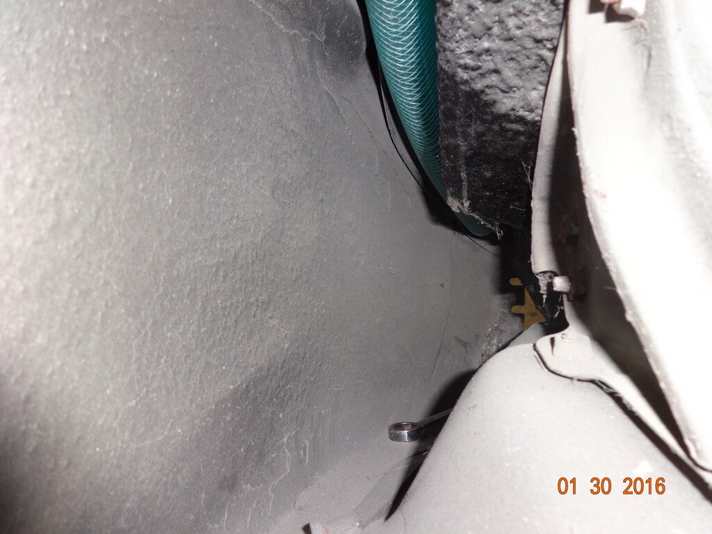

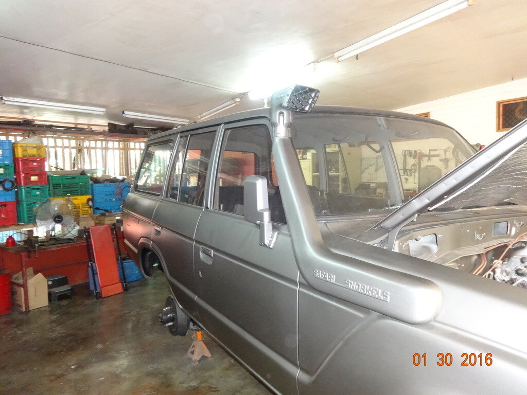

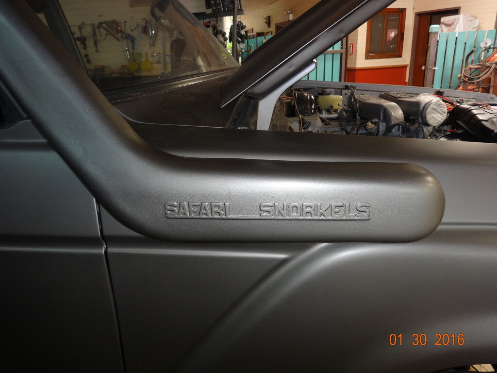

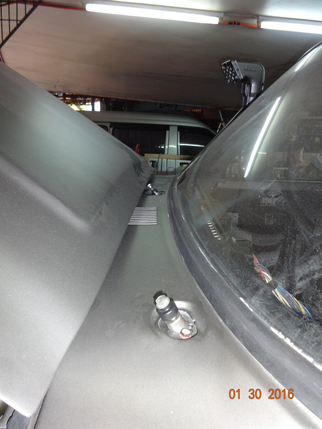

Dropped a wrench inside the fender wall while installing the snorkel. I could not see from the outside so I took a picture. Gotcha.

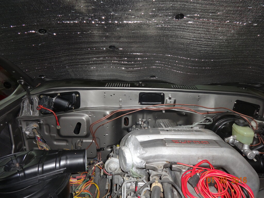

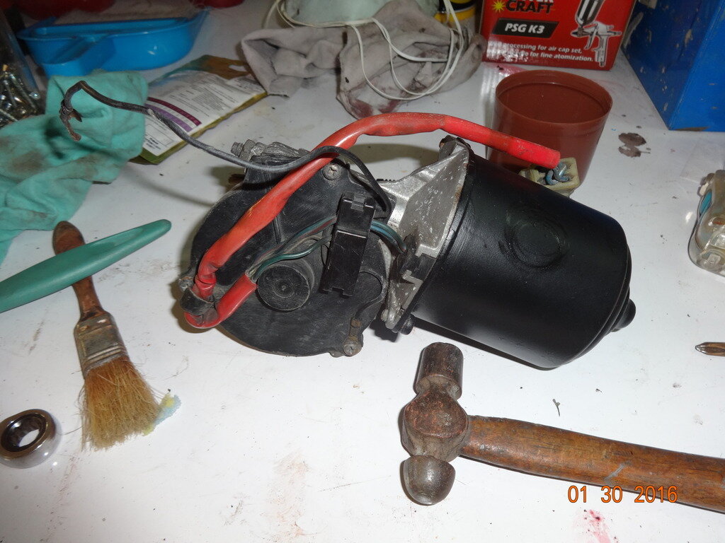

Wiper motor and linkages have been installed. A little tricky but not that bad.

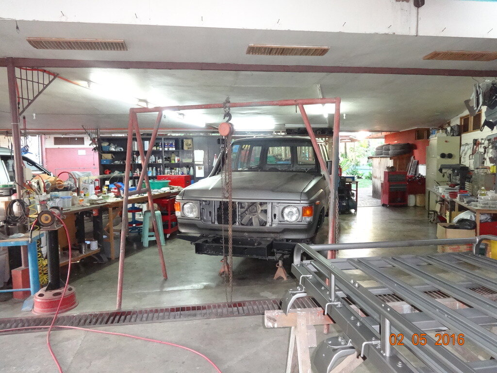

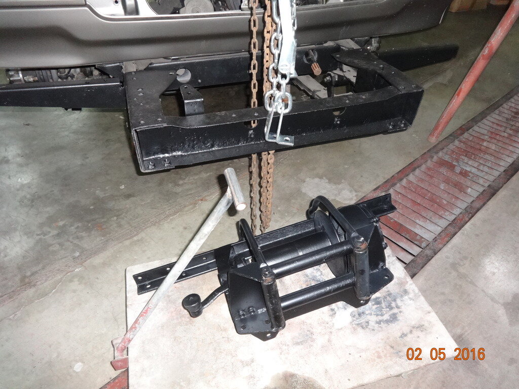

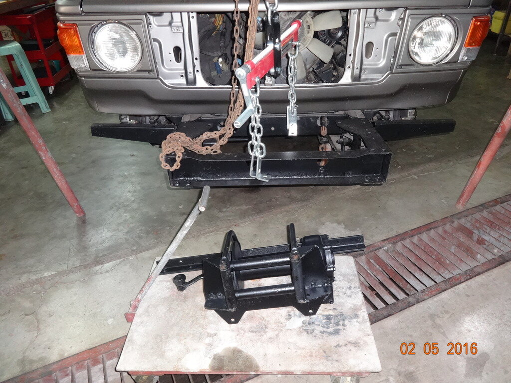

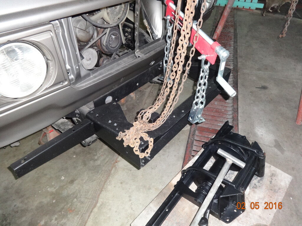

I started work on installation of the winch.
I will be using an engine leveler so I can install the winch with ease.

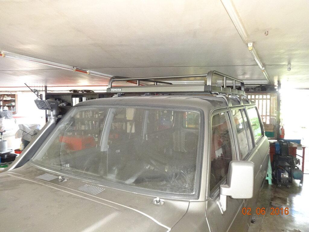

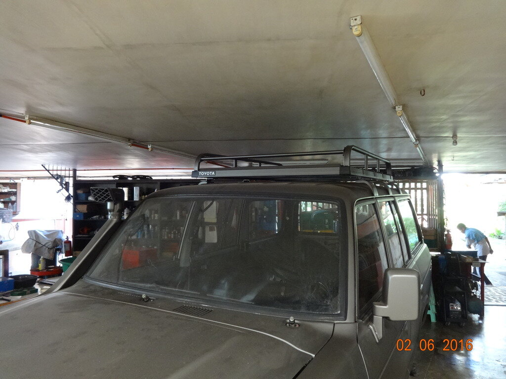

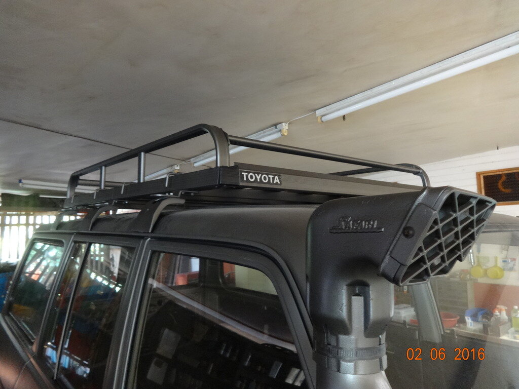

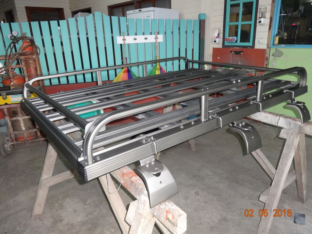

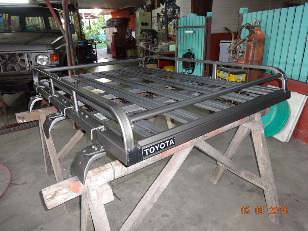

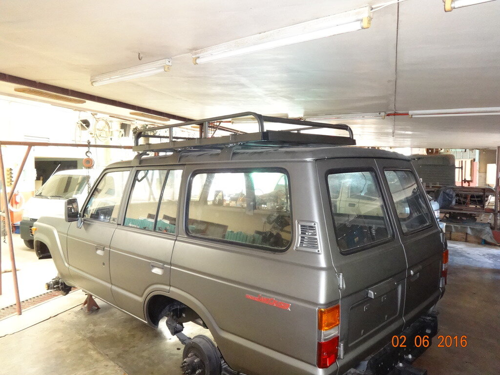

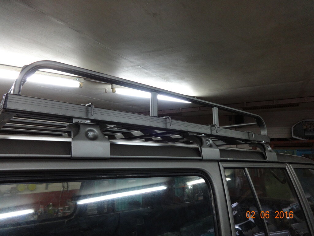

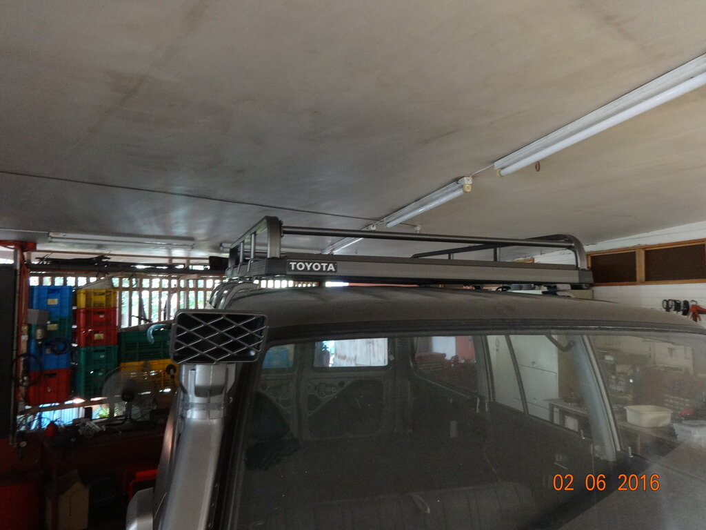

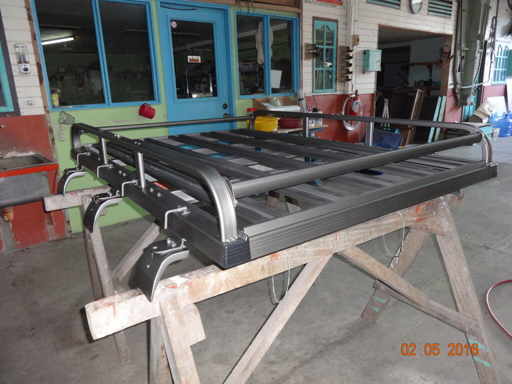

The roof rack is also ready for installation.

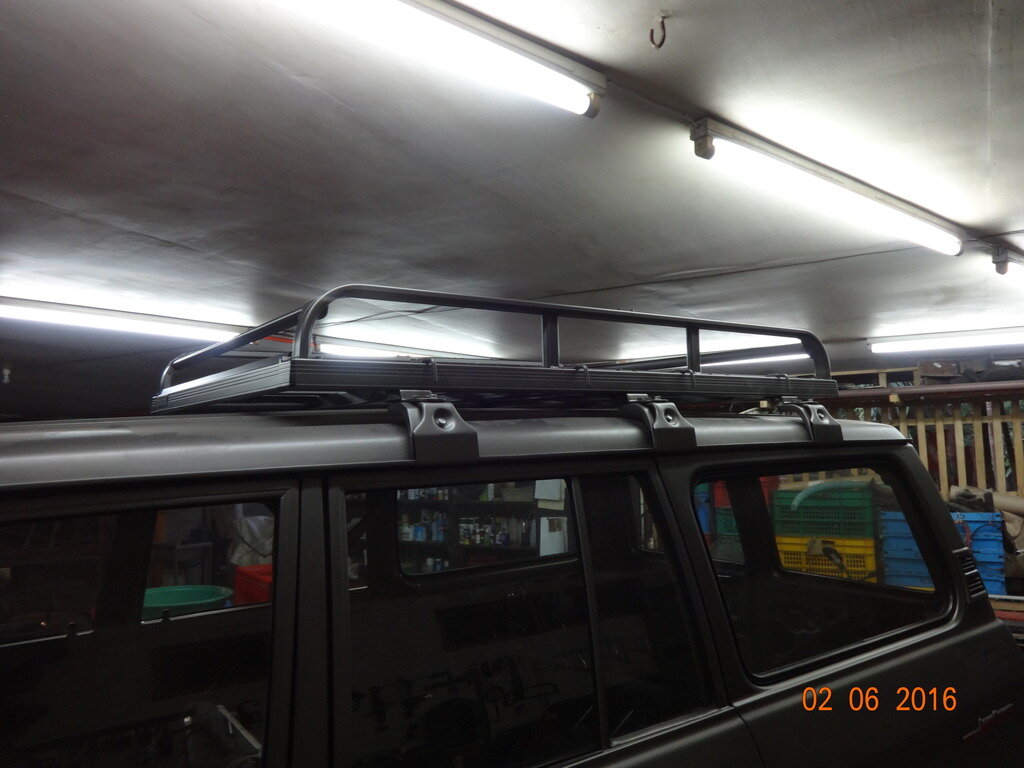

I got the roof rack in position but deferred the lock until I am sure it is in the right position.
And the final position ...
