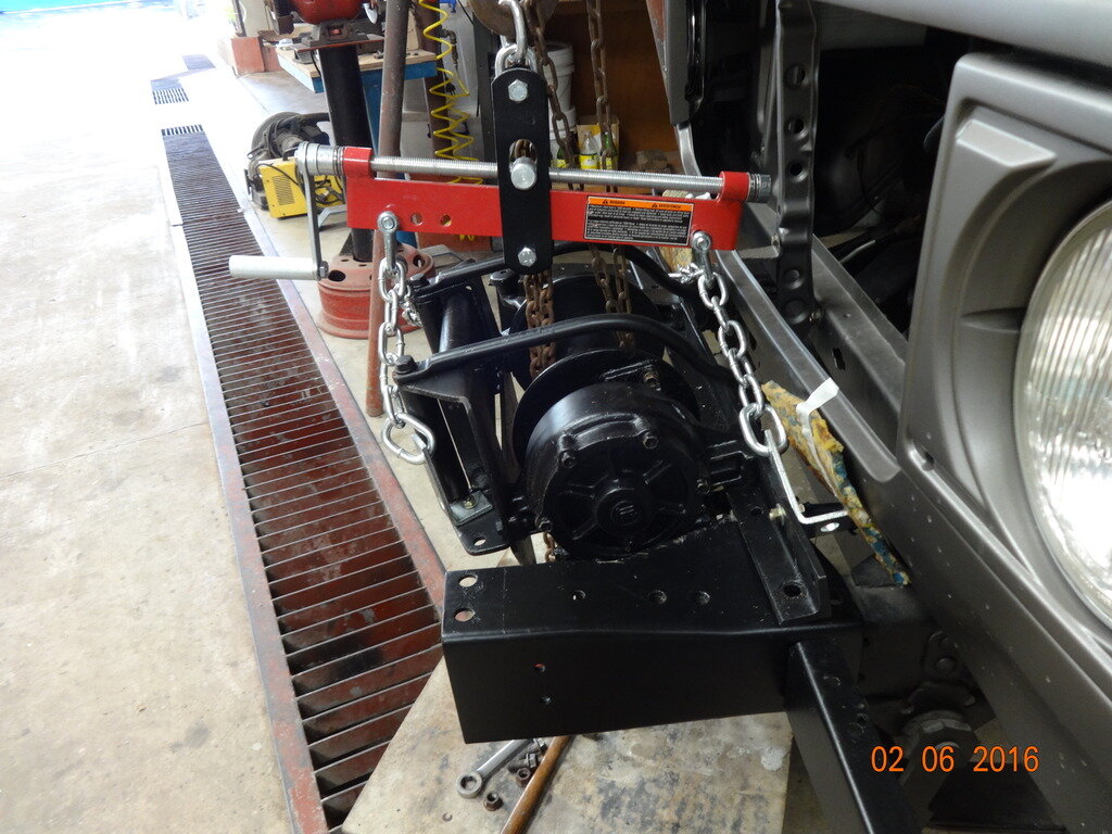

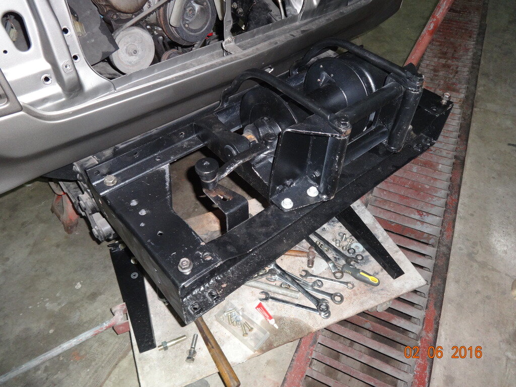

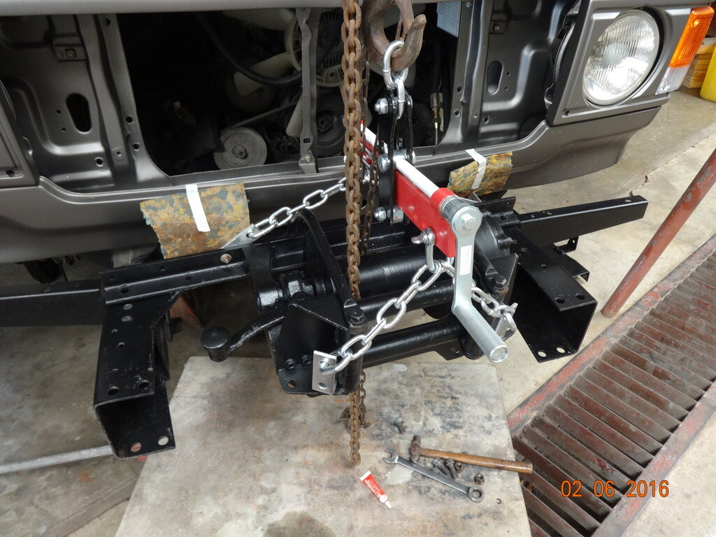

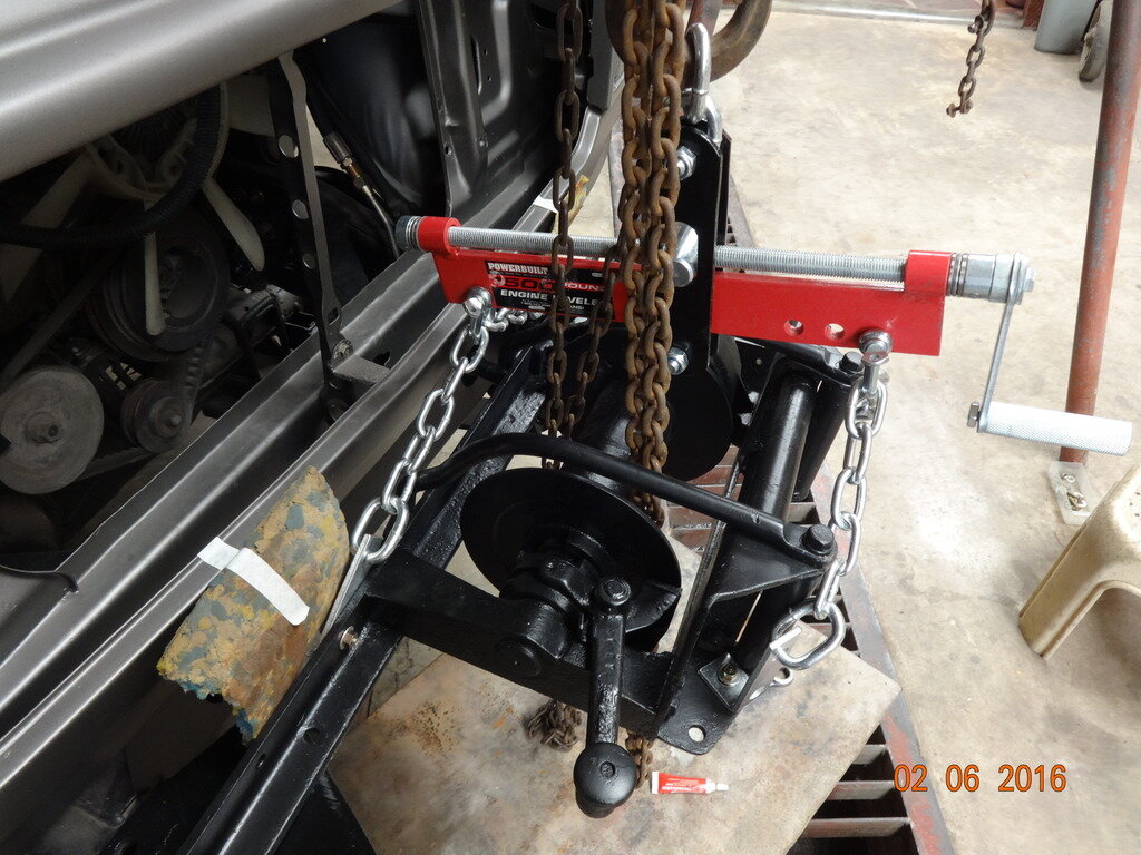

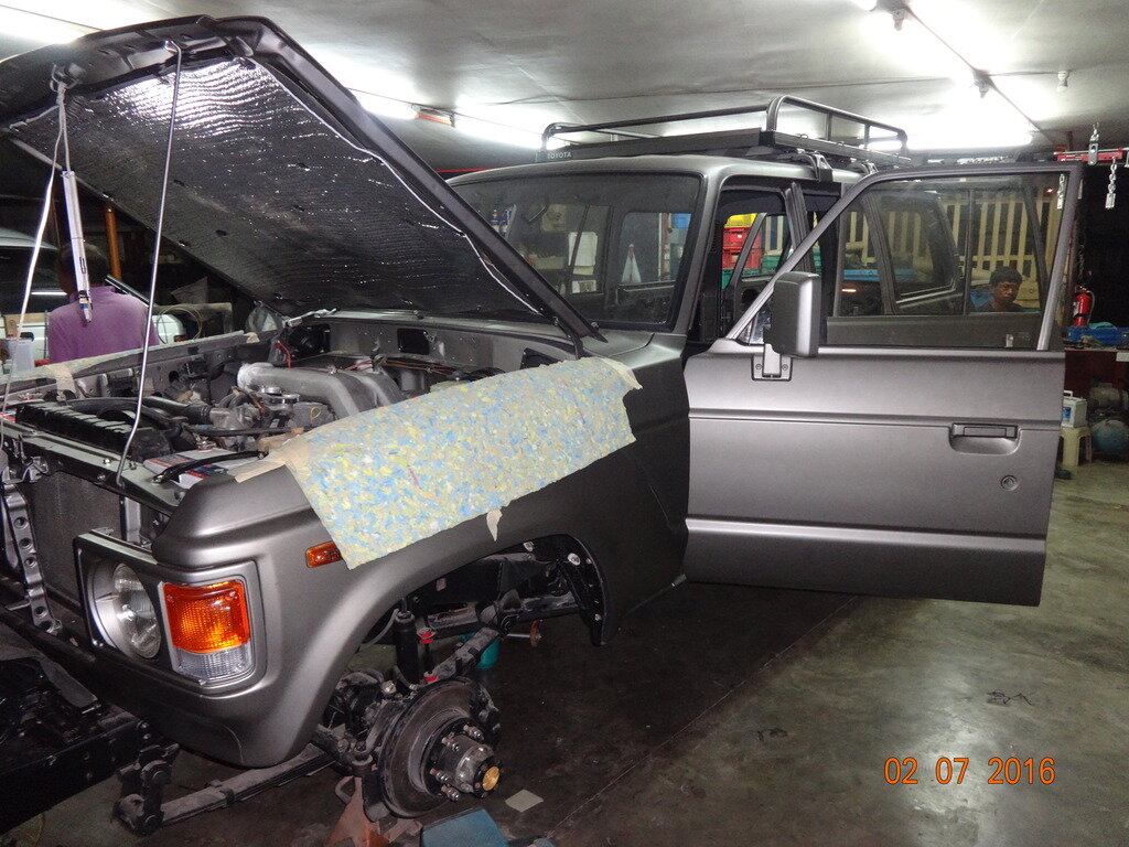

This is a try out before I do the final installation. I thought it was difficult. Not really bad. Reason I had to use the chain block and the engine leveler is I suffer from back pains and should not carry any load. Sign of old age.

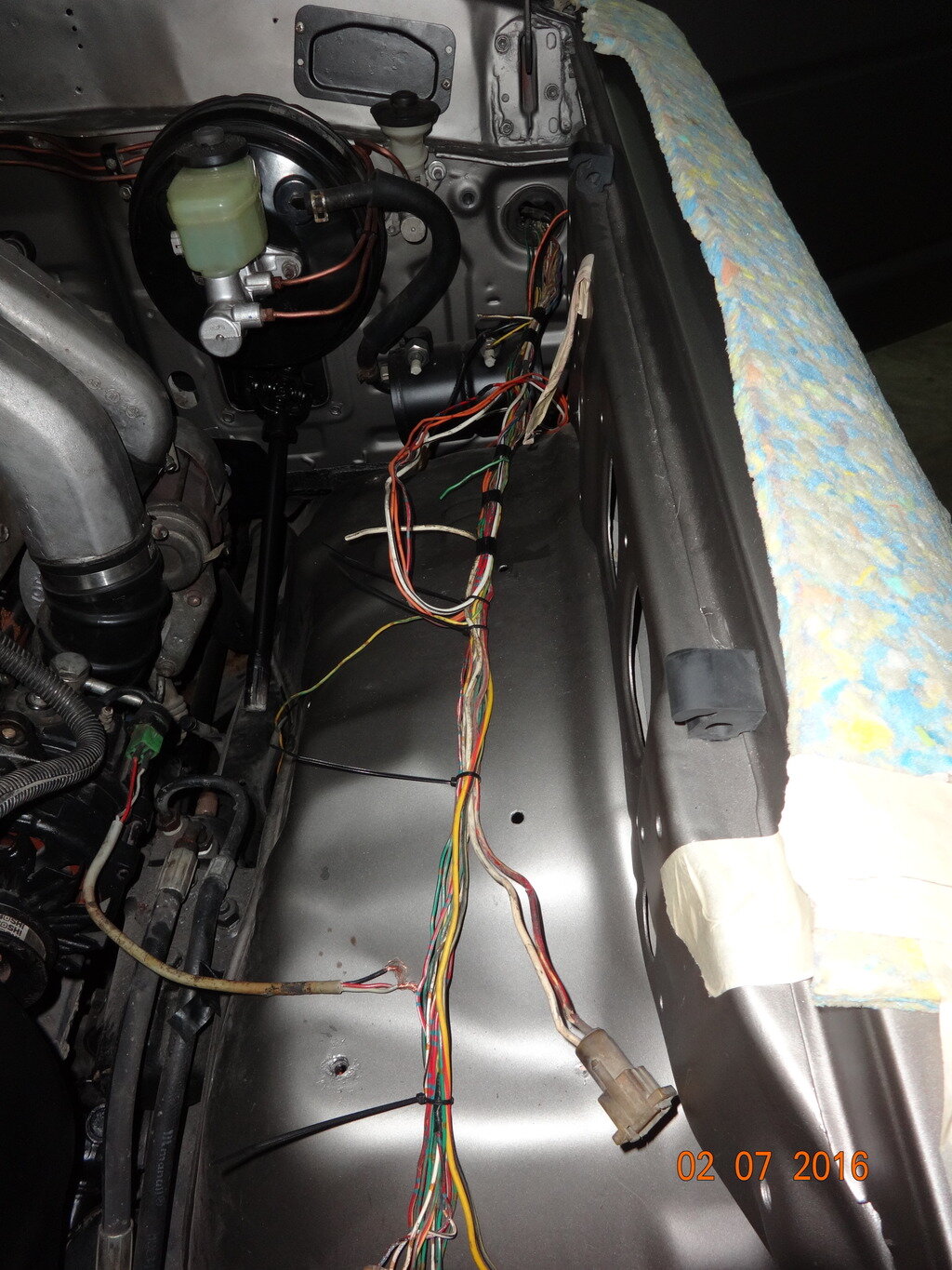

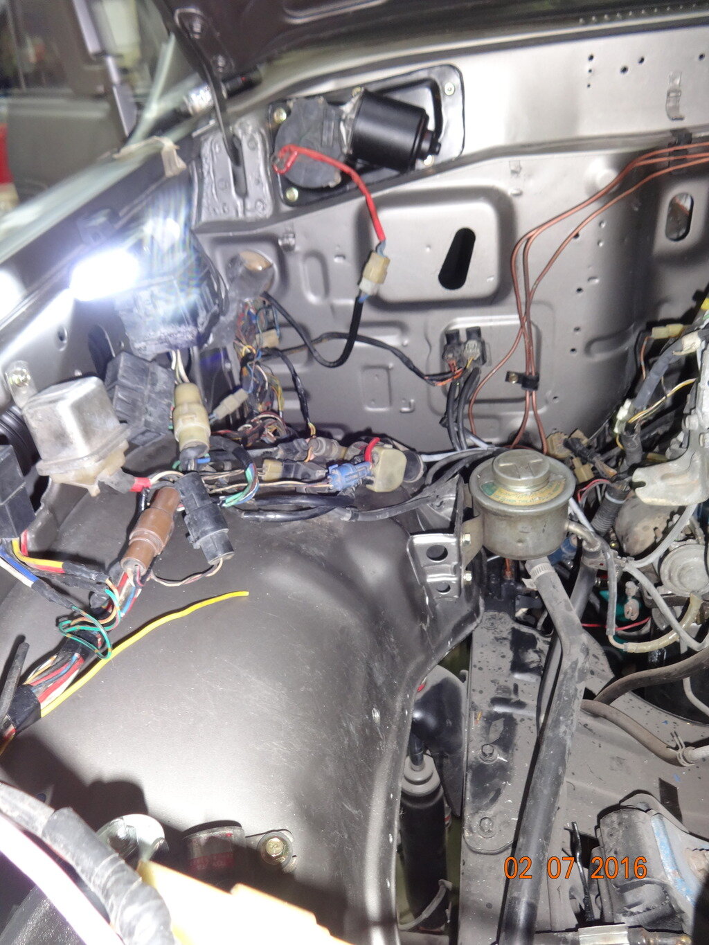

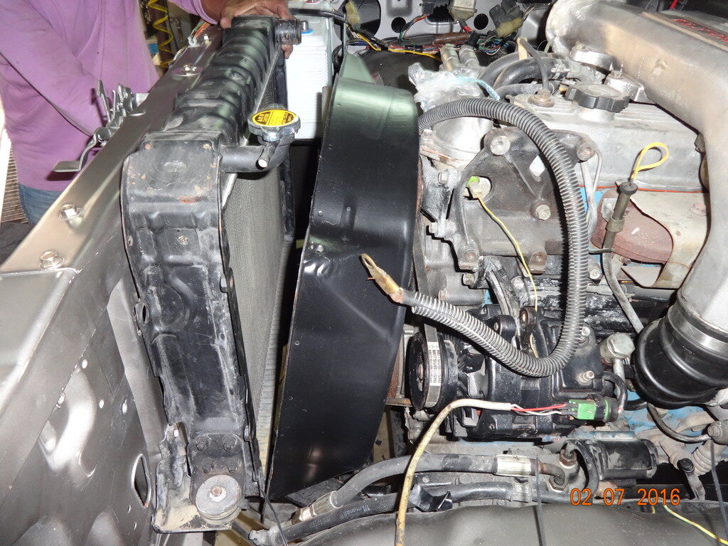

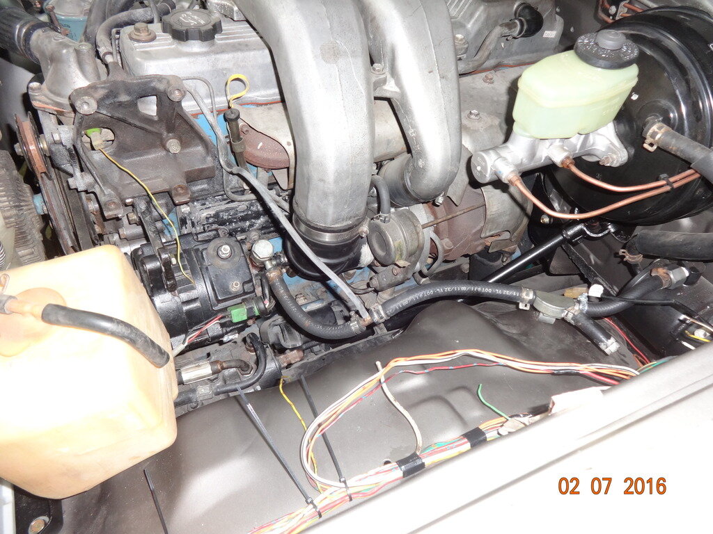

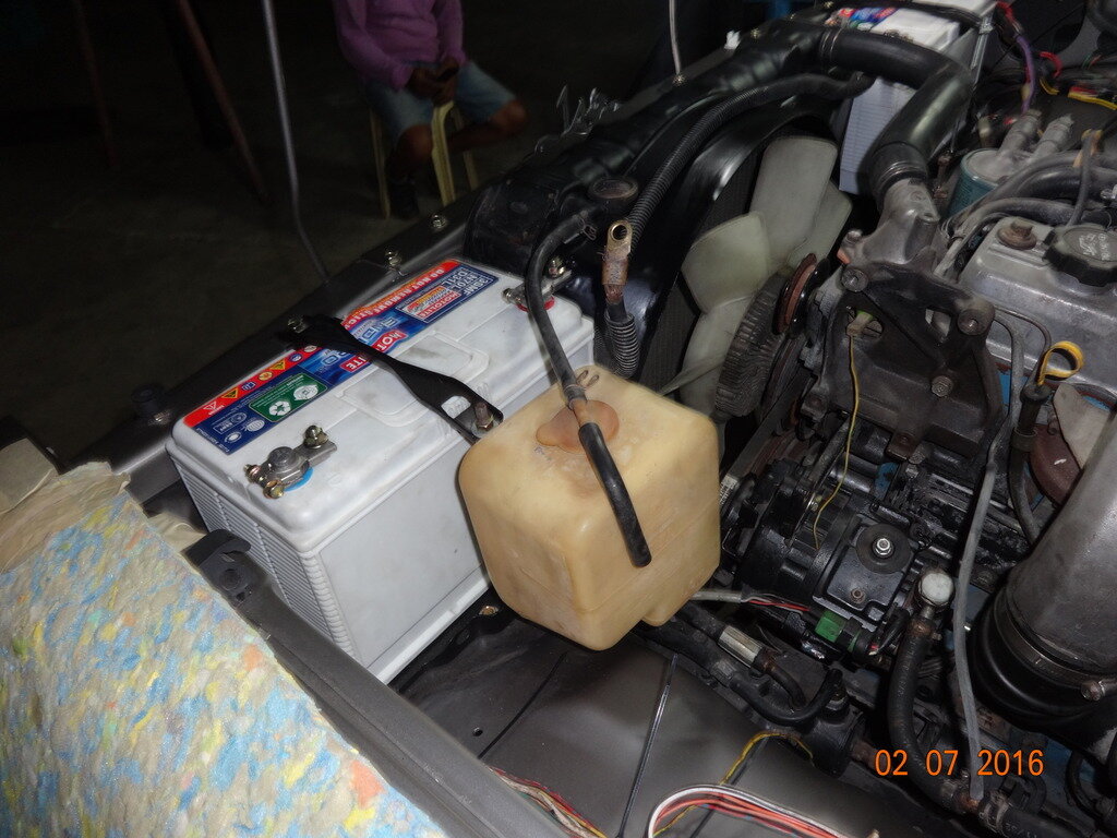

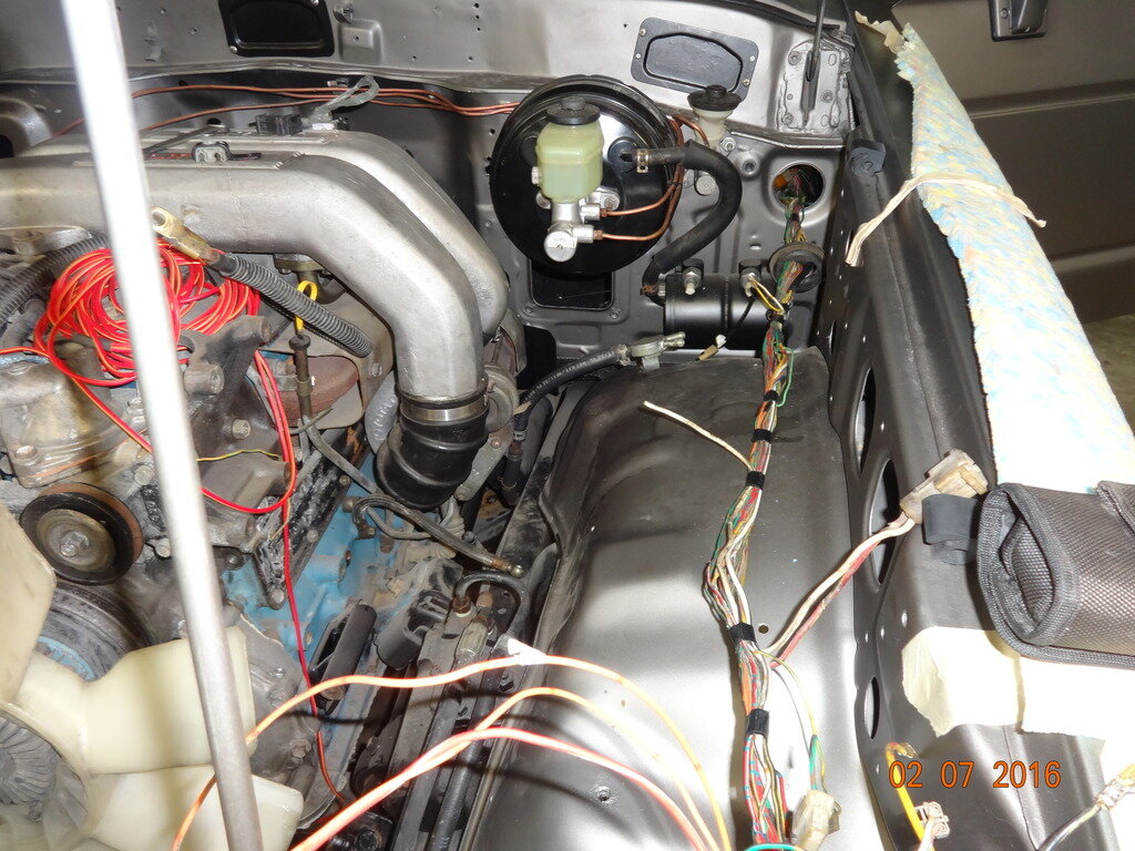

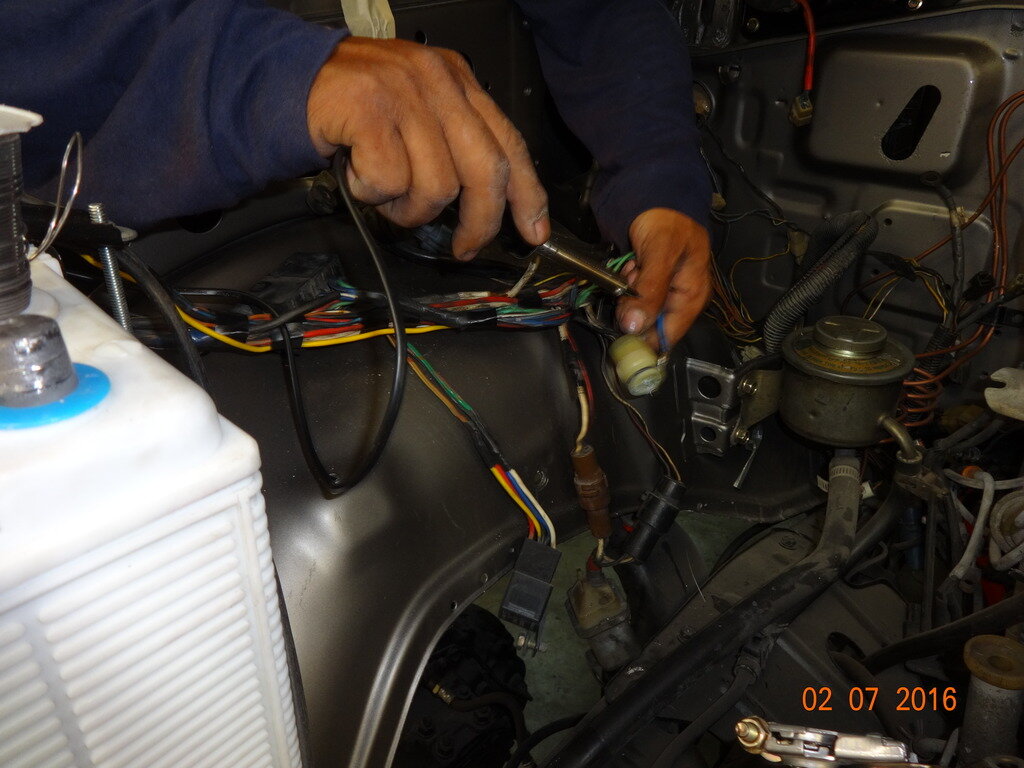

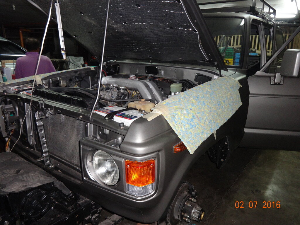

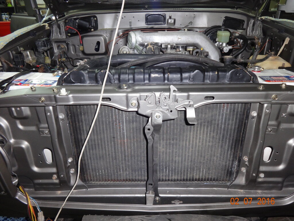

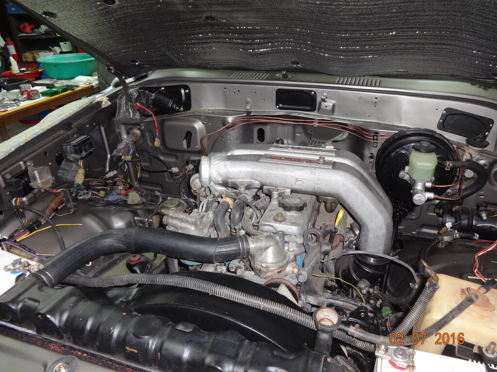

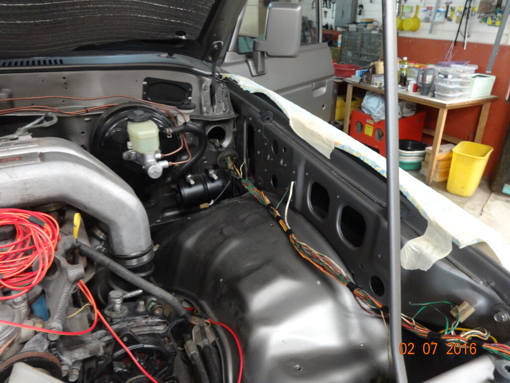

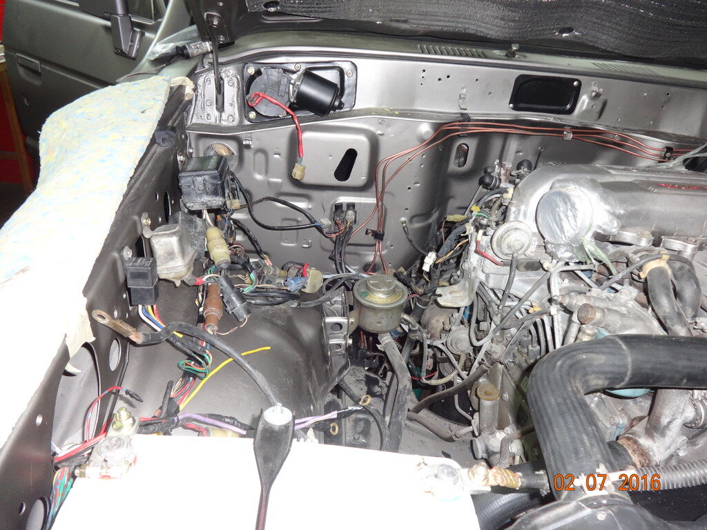

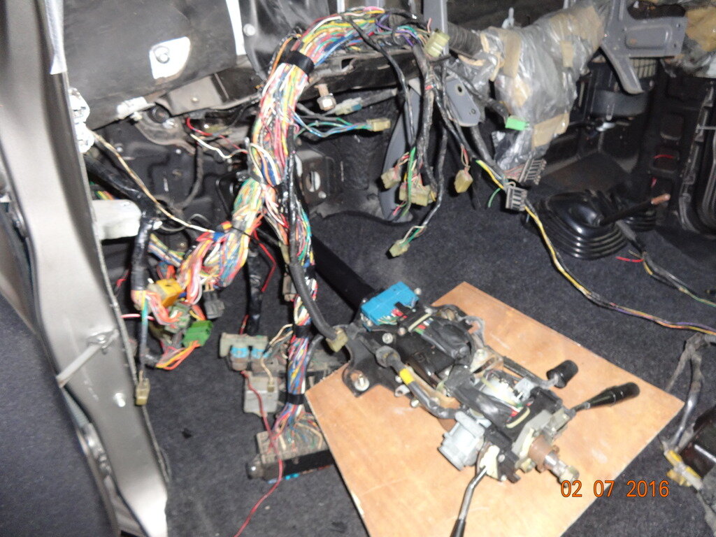

What was accomplished today. A final check through the wiring harness in preparation for the engine start.. Installed the cooling components and will have the engine rev up by tomorrow.

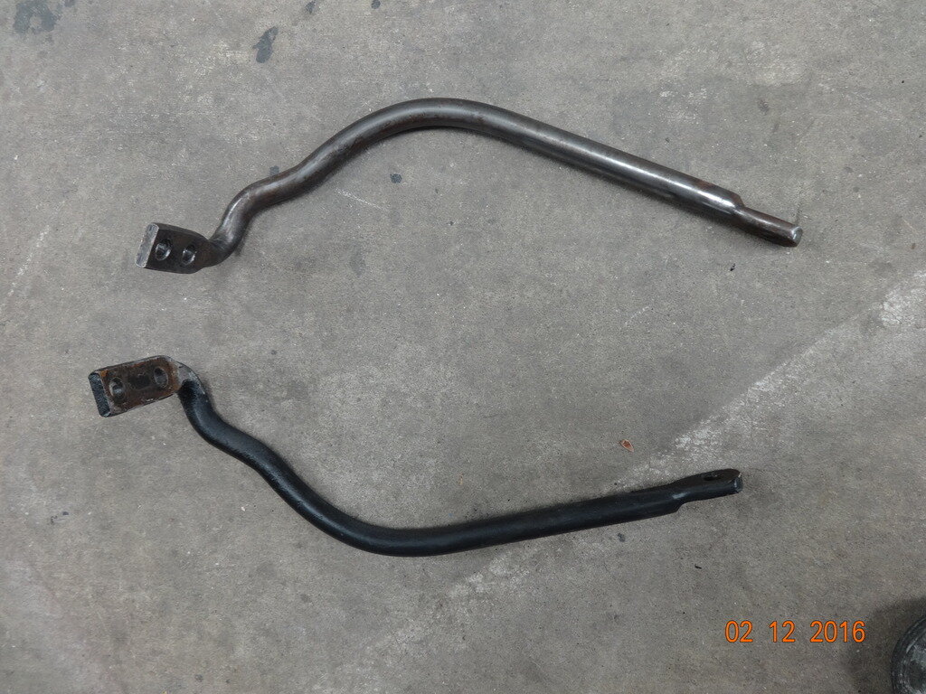

Brale and clutch lines were positioned into place. Looks neater.

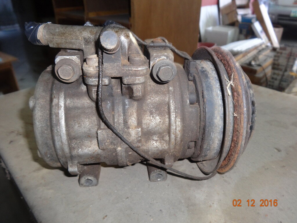

The alternator was removed and went through a bench test. A 26 volt reading was achieved. Vacuum lines were also installed.
Yup, all system go for a rev up.

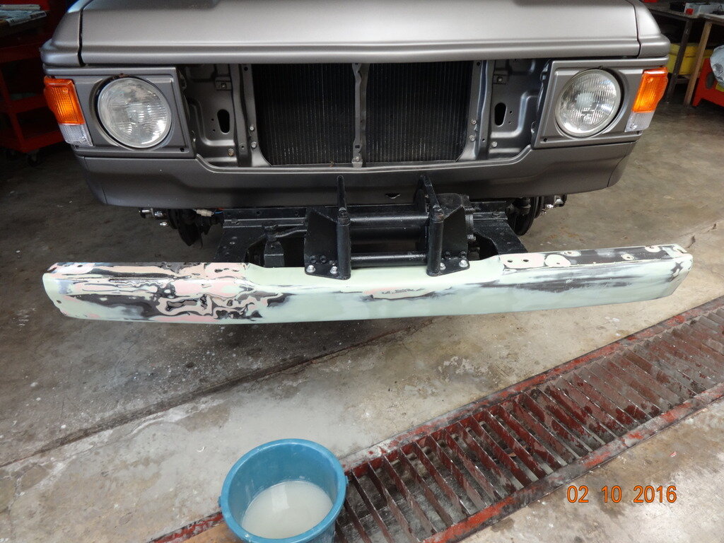

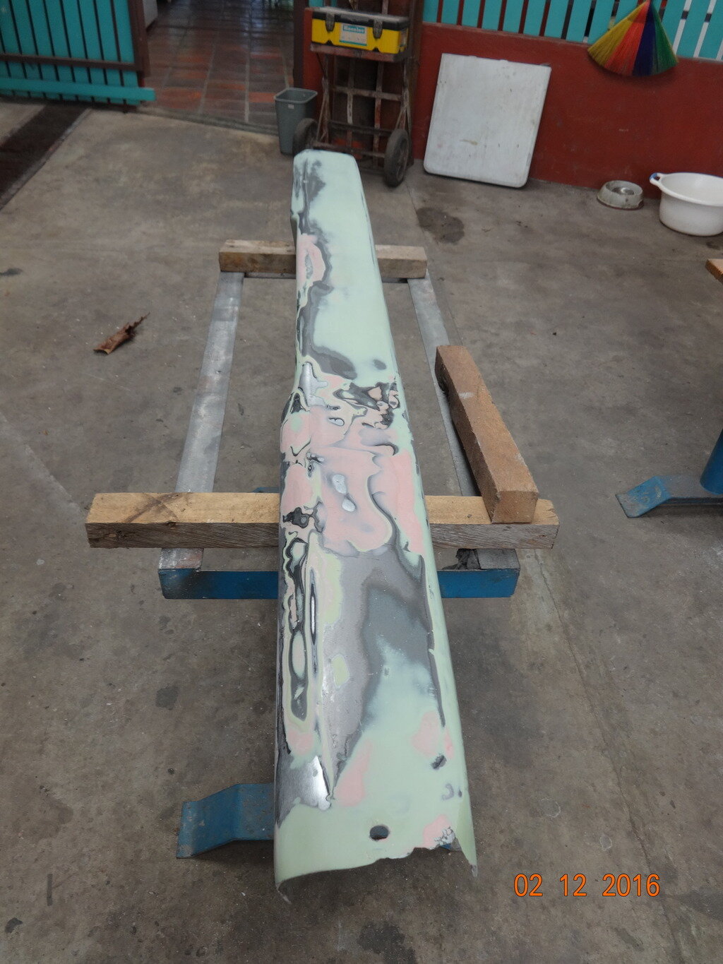

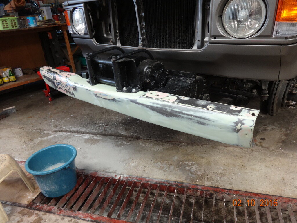

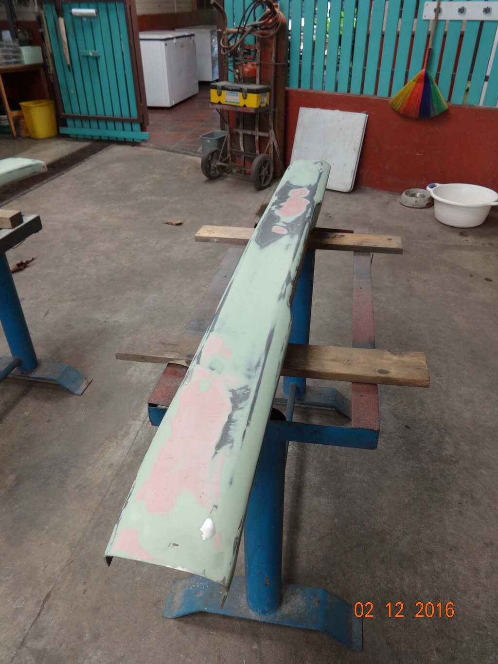

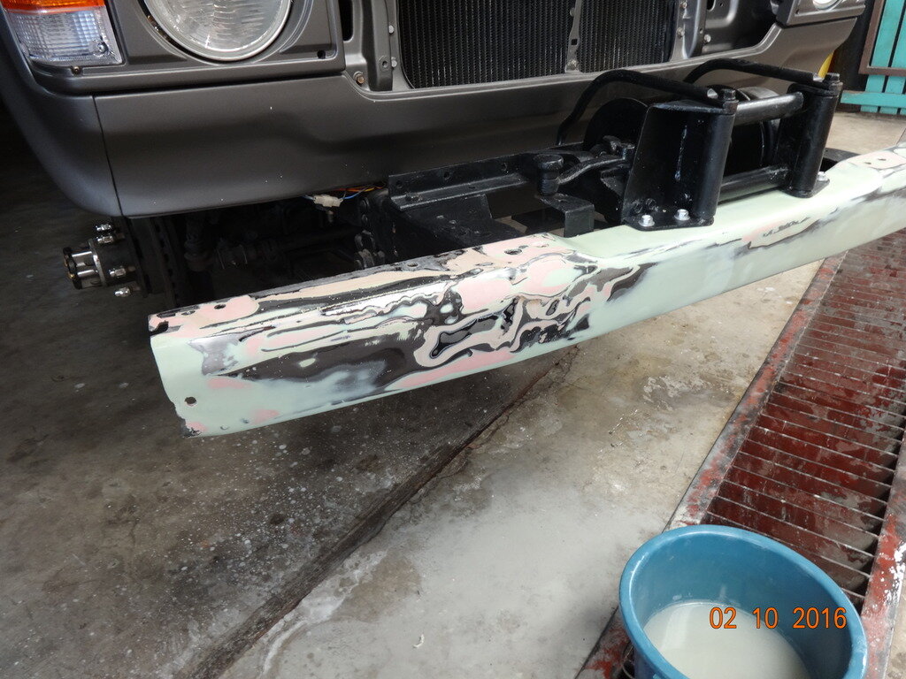

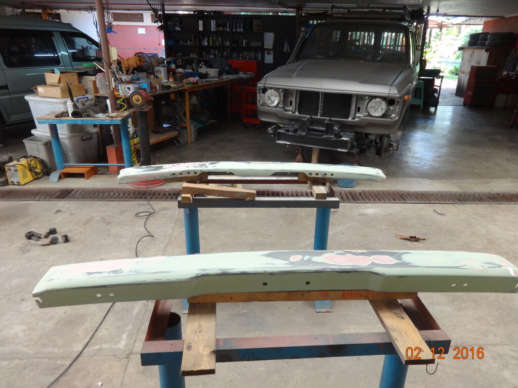

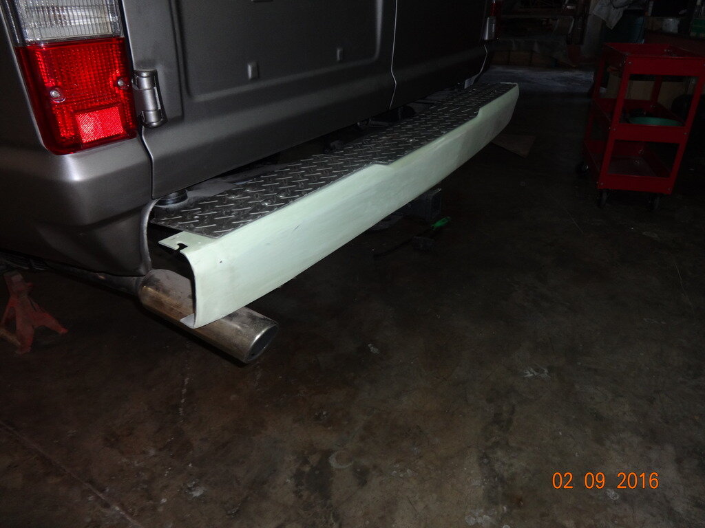

The front bumper is temporarily installed for alignment. Then will apply some body filler to correct some irregularities on the surface.

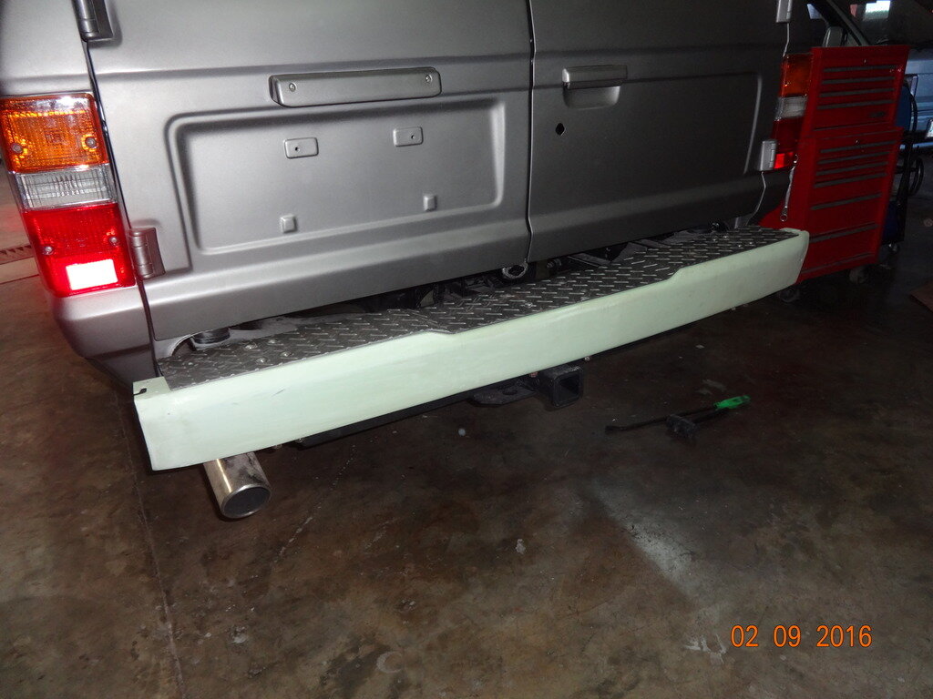

The rear bumper is much better than the front.

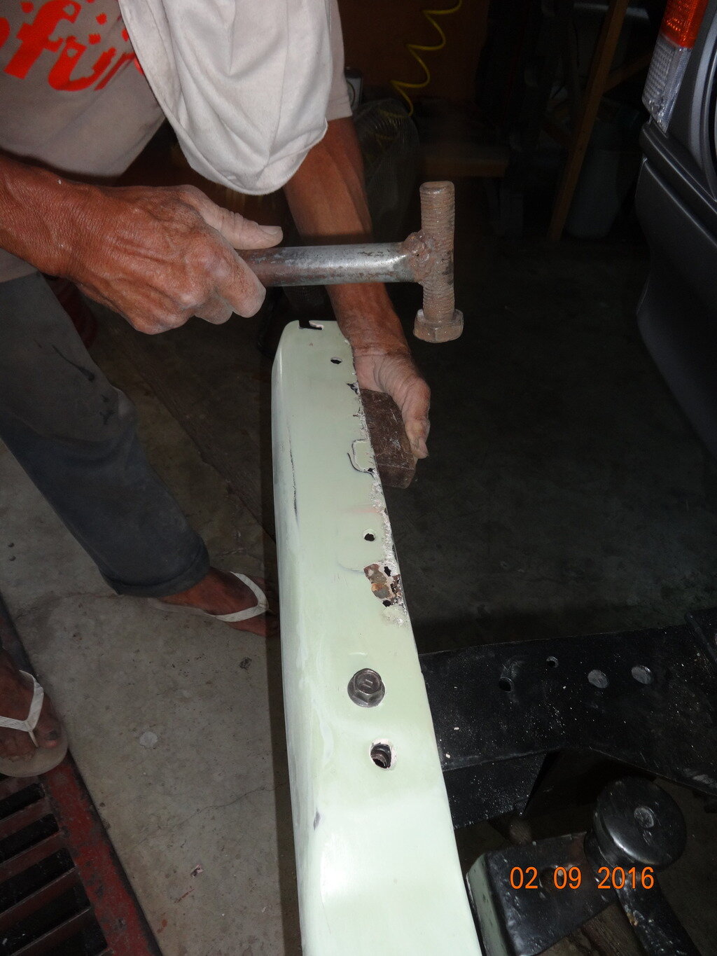

Fantastic work and I especially love the hammer.
You have noticed. Good observation including detail on tools. I've had so many metal tools including hammers and all broke because it just isn't made to last. So my guy welded this huge bolt and pipe together and works well. At least it will last forever. Thanks for your comment.

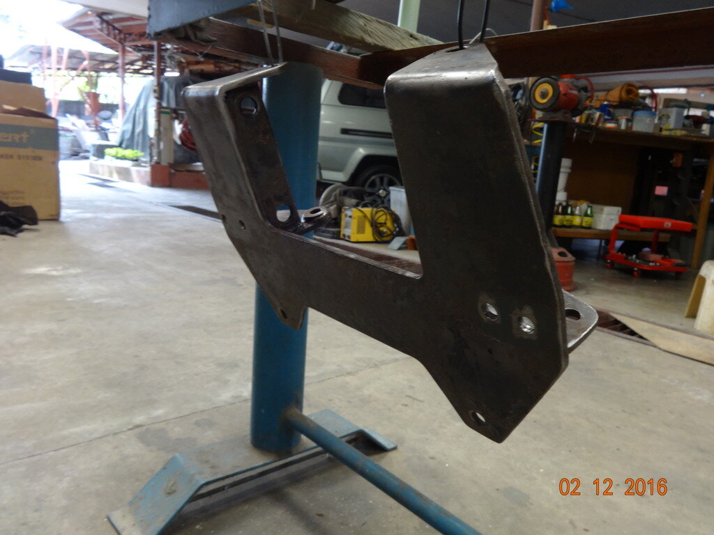

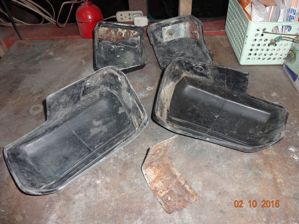

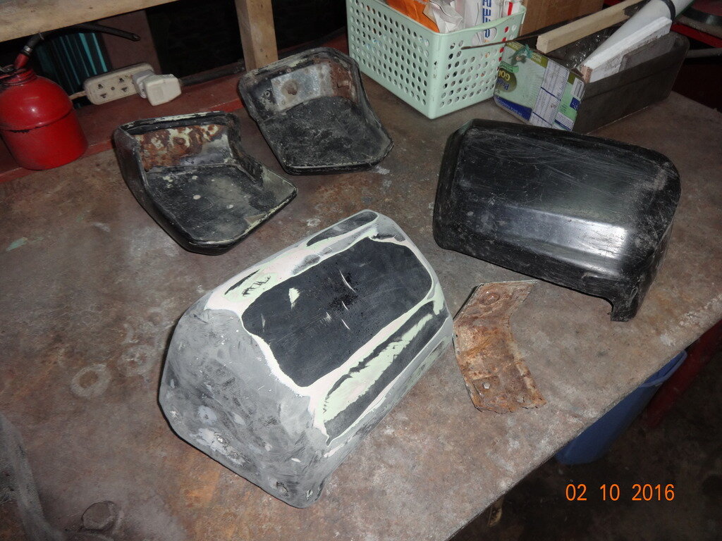

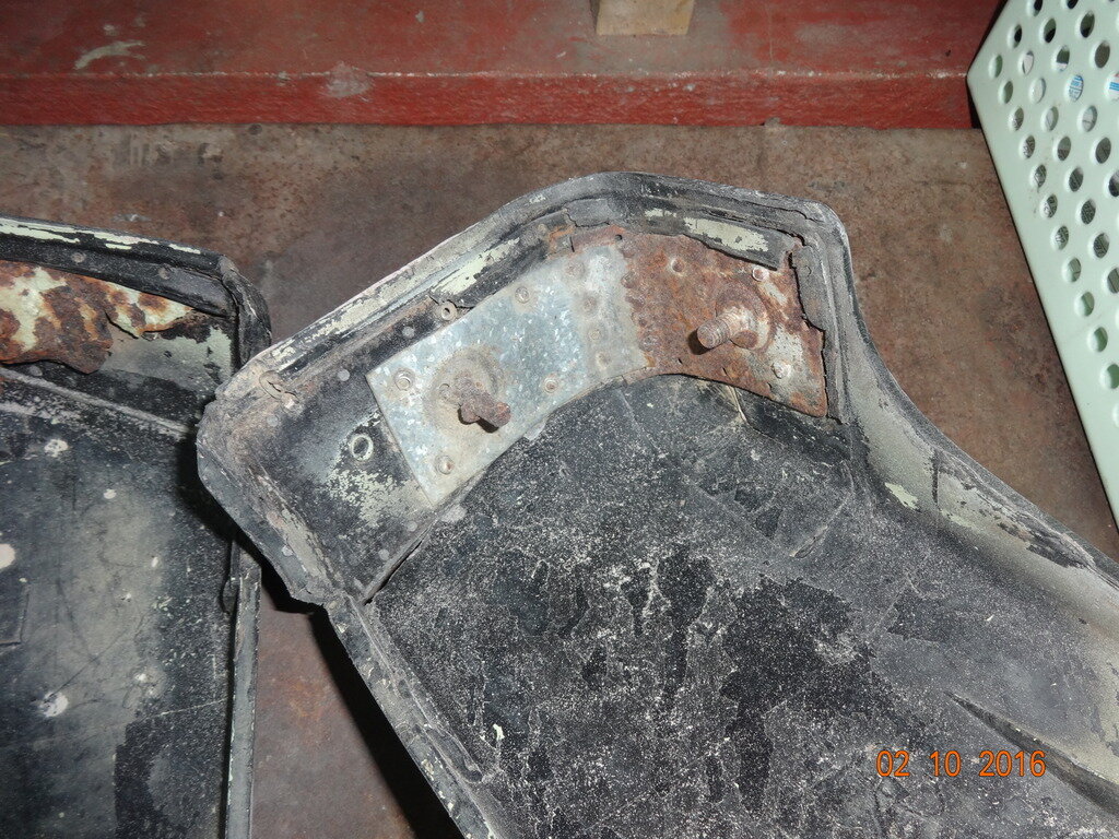

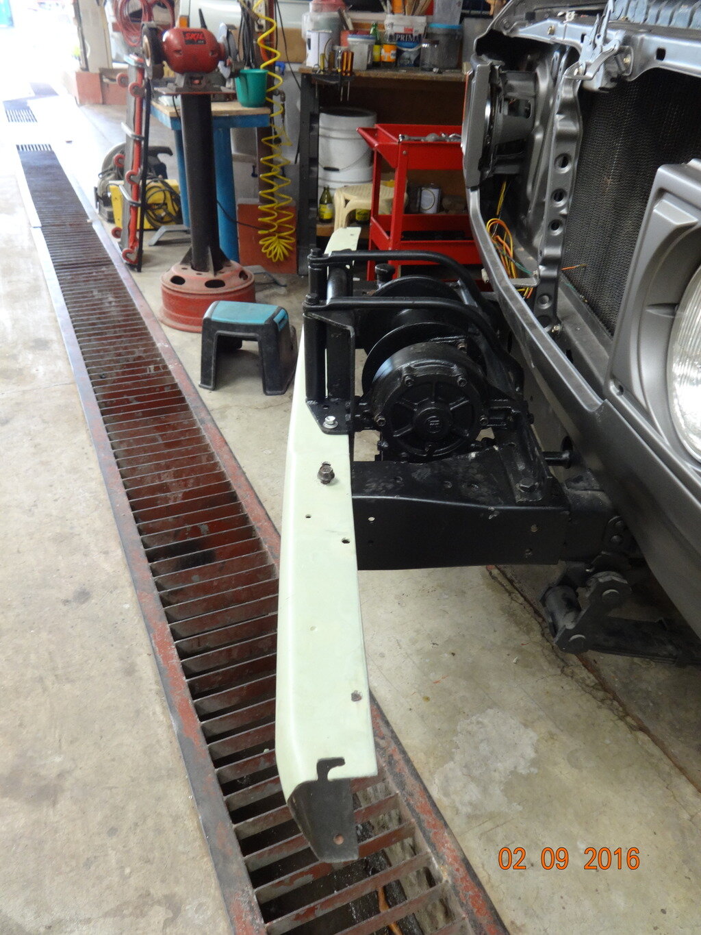

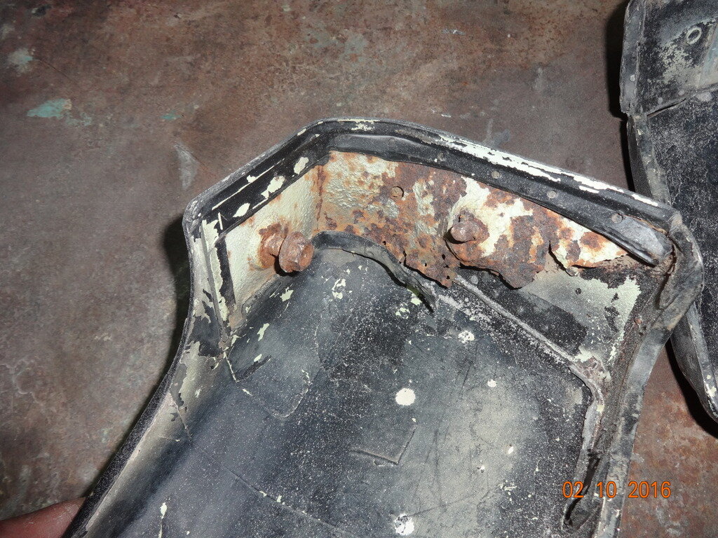

Got to work on the bumper. The price of the bumper extesnions really got me going. I will repair and make this look new so I can save.

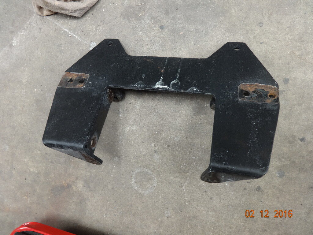

Bumper extensions are deformed because of rust. I will replace the steel plate and bolt this to the bumper using rounded stainless steel bolts.

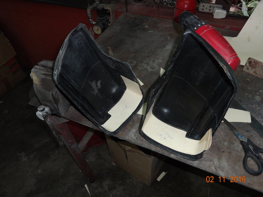

I did some pattern for the new steel bracket that will be installed on the bumper extensions.

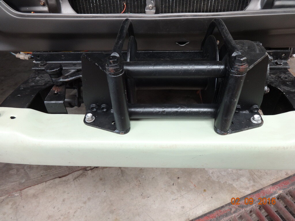

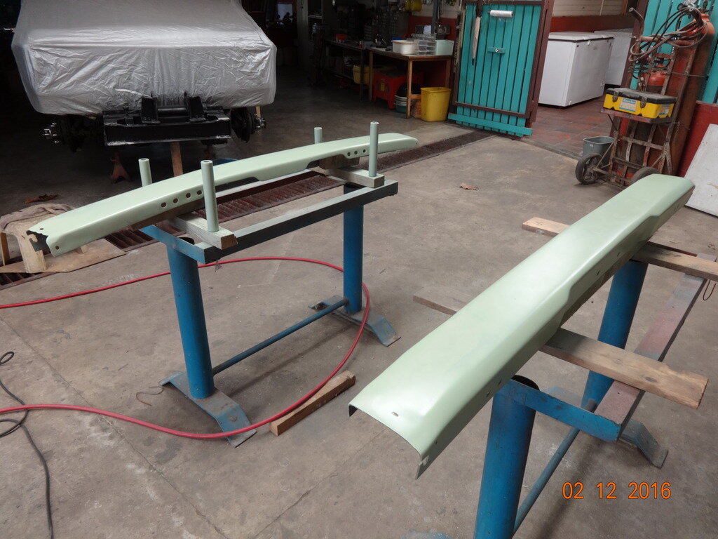

Got the bumpers ready for the first coat of epoxy primer.

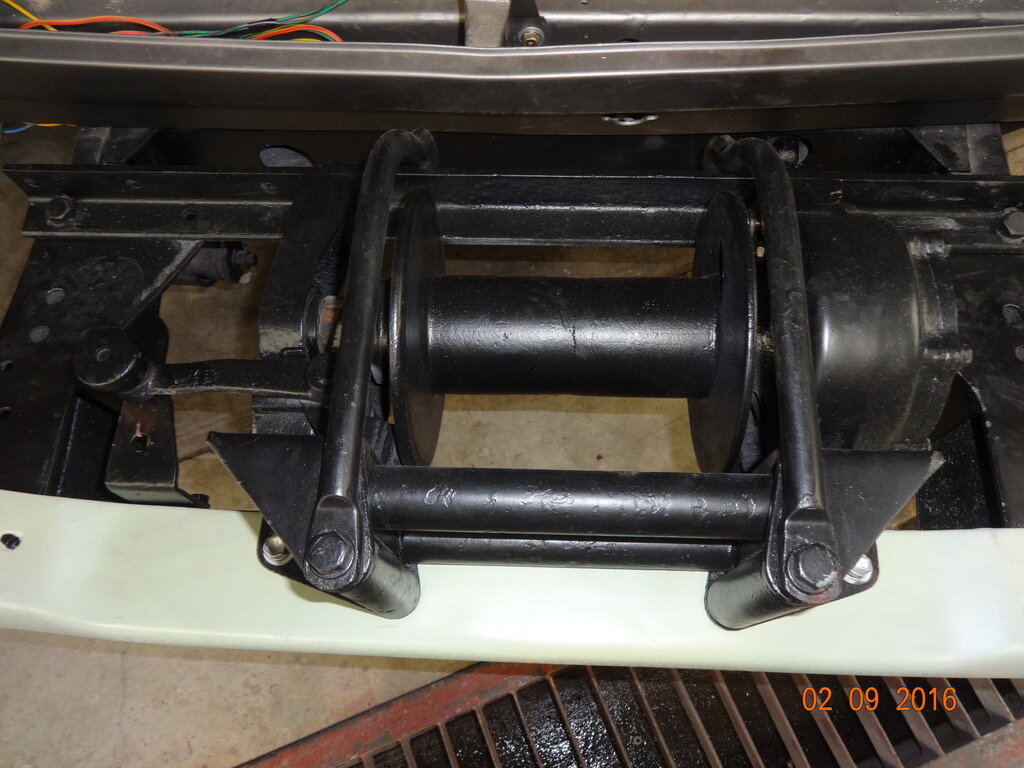

also scraped off the paint from some parts of the winch.

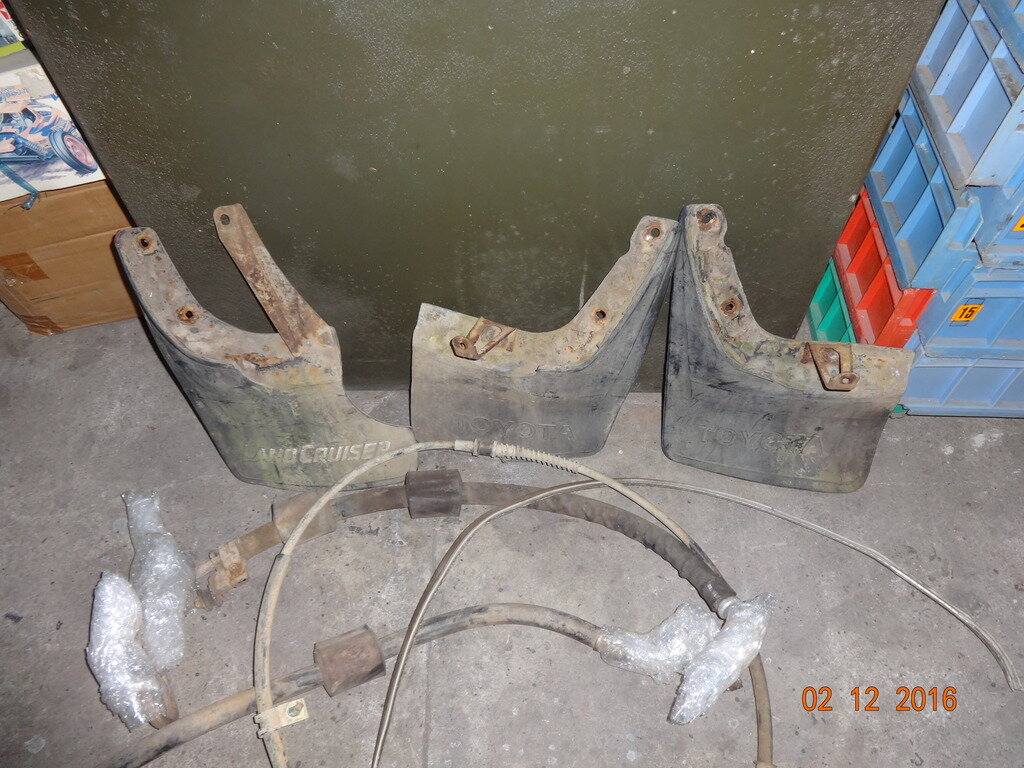

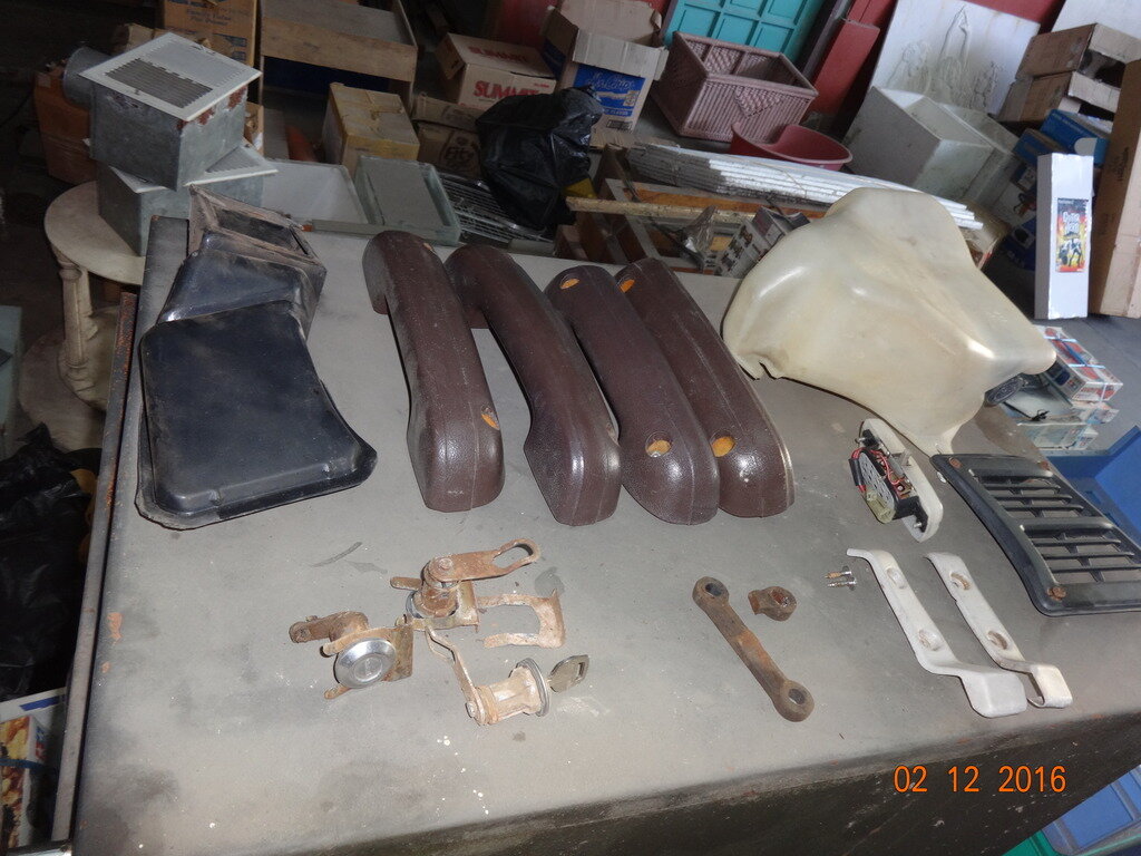

Some parts I ordered from Australia came in.
Got my door handles, door locks, windshield washer tank...
3 pieces of mud flaps, set of emergency brake cables.

:dance: I would go for a different color other than plain black. This is a mixture of 60% jet black, 40% metallic silver and 30% flattening paste. If everything goes as what I hope to achieve, then the color will stay. If not, black it is. Any suggestion on the bullbar color? Or should I leave it as it is, stainless steel look?

I like the way you use paint mixes, I'd try to match the bull bar with the bumpers, JMO.

I am not a pro when it comes to painting but I did research on the basic. I mix paint with the use of a digital scale. In this way, I can accurately mix colors with almost perfect consistency.
The bullbar is stainless steel. It would only be the glossy part if left as is.

Not sure what to say then Oding, painting stainless is difficult. It's very hard to get a good primer key.
I guess there's a suitable etch primer for stainless but I can't recommend anything.

For simplicity, I always mix paint by weight. 60 grams of black, 40 grams of metalic silver and 30 grams of flattening paste. This includes thinner by multiplying 130 grams by 2, which total to 260 grams. I can now have an accurate mix of 390 grams, more or less .40 of a liter. I do it this way so I can mix any amount only when I need them. This is very helpful especially when I do touch ups.
