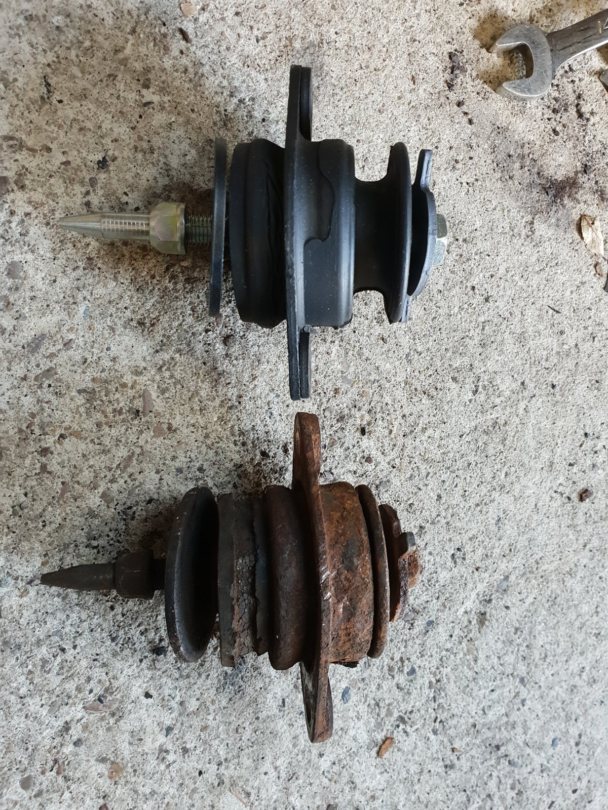

Replaced the rear body mount on the colorado. Had to undo both sides to get enough space between body and chassis to get the old 1 out. So my advice is, replace both sides at the same time.
Its cured the banging thats been bugging me for the past few weeks so im a happy chappy
