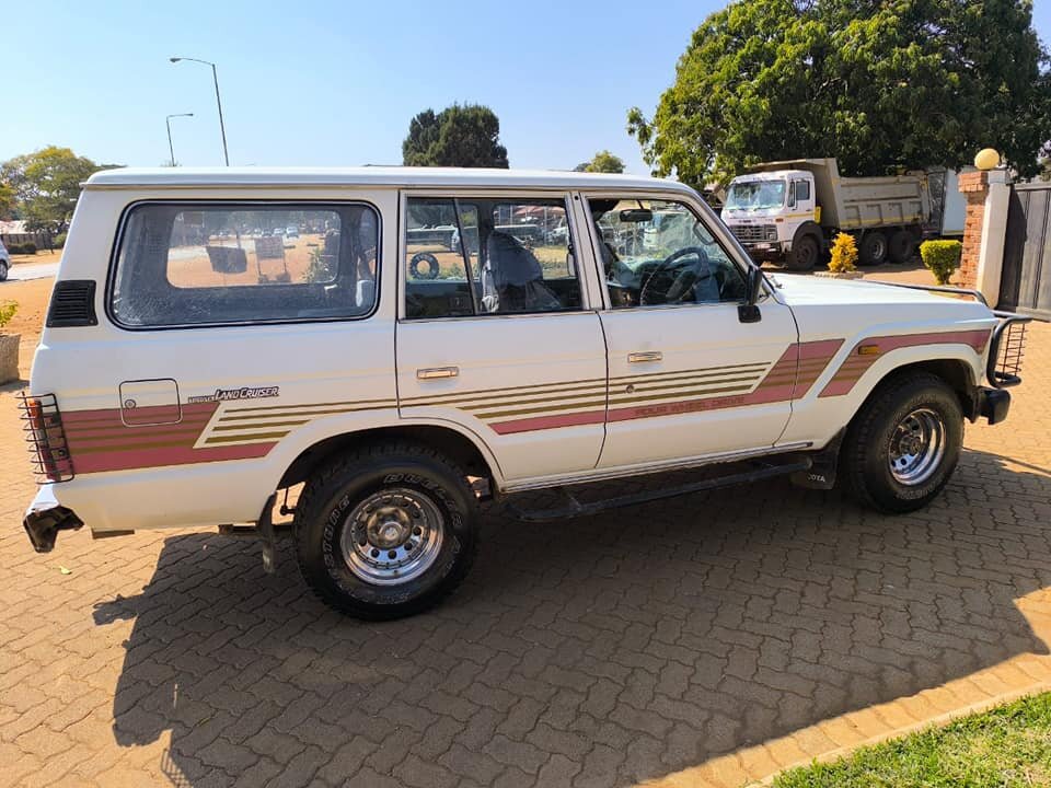

Rear diff drained and opened and N/s rear half shaft removed and off to be resurfaced for new bearing and seal
Rear Brakes striped, new shoes to be fitted and new brake cylinder dust covers to be replaced
Front axle inspected new seals needed.. steering joints all need replacing. Brakes good
Gearbox seems fine but transfer box has an oil leak.
Radiator needs reconditioning
Rocker cover gasket needs replacing
All fluids and filters to be done
Then possibly some new suspension, any recommendations was thinking Terrain Tamer parabolic kit. Seems to be good value although by the time I get 1 in Zim it may well be a lot more than in the UK..
Chassis is solid and the body is in pretty good nick with only a little bit of rust along the N/S gutter and a couple of small holes where the mud flaps attach although it has been resprayed at some point so we'll see what's been hidden when we get the paint done..
The interior is in a horrible state but mainly complete which is good
The engine sounds good and pulls well so I'm considering adding a turbo and intercooler I have a good CT26 left over from my 100 series which now has a GTurbo, be a shame to waste it..
All in I'm very happy with my £6k purchase
