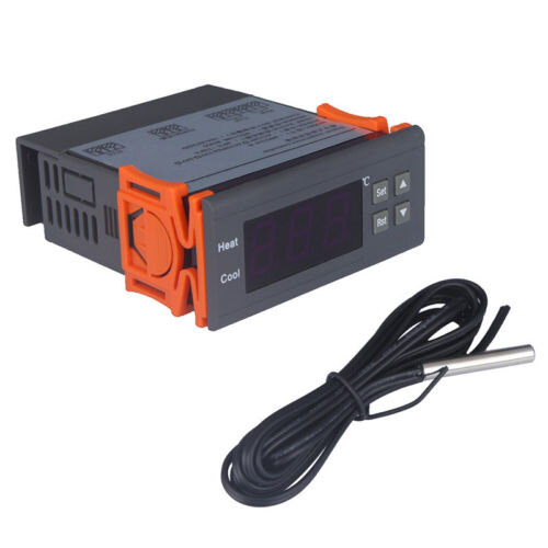

I just bought one for myself this morning, can't imagine it's going to be any good as it was only £8.78 delivered!!! :shock:
I have the same one, instructions are pants but below is what you need to do.
Pins 1 and 2 are for the relay and I intend to have a 12v feed into pin 1, the output of pin 2 will be connected to a 2 wire 12v buzzer of some description with the 2nd wire of the buzzer connected to earth.
I might put a switch between pin 2 and the buzzer so it can be silenced.
To program the gauge just follow these steps.
Press SET for 3 seconds - HC should now be displayed
Press SET then the UP or DOWN arrow until display changes to C (this puts it into cooling mode - i.e. will close the relay when the desired temp is reached)
Now to setup your desired trigger temp
Press the UP or DOWN arrow until LS is displayed
Press SET
Press UP or DOWN arrows to set your trigger temperature like 80 degrees or whatever.
I've been using mine for a couple of years now and its bloody awesome! :clap:
Amazing for the price! I'm tempted to buy another encase mine ever does stop working. :icon-biggrin:
