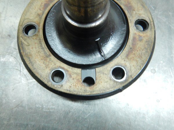

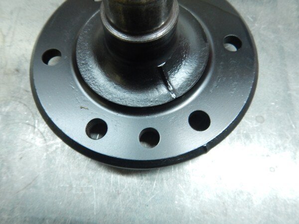

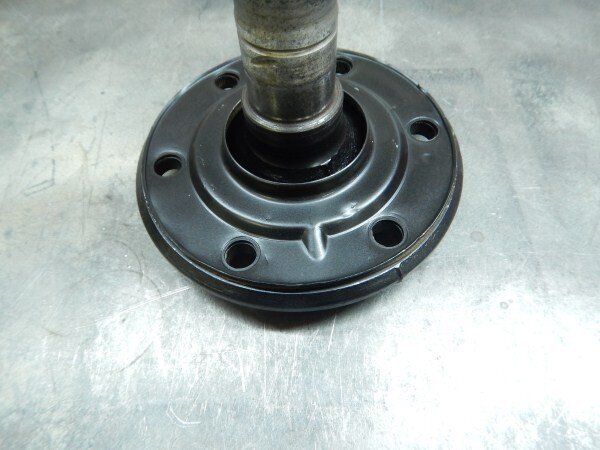

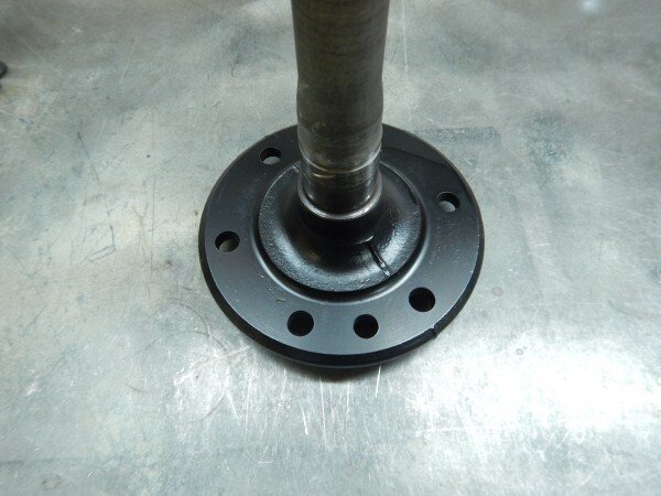

I couldn't work out why there is an extra hole on the hub! Doesn't make sense? :?
Paper gasket even has a cut out for it.
And the backing plate has a raised area for it.
The extra hole on the hub allows oil from inside the axle to leak out outside the break drum (vs. having it inside the drum which would be stupid) when the simring in the axel (around the half-shaft) fails and no longer keeps the oil on the inside.
LJ.

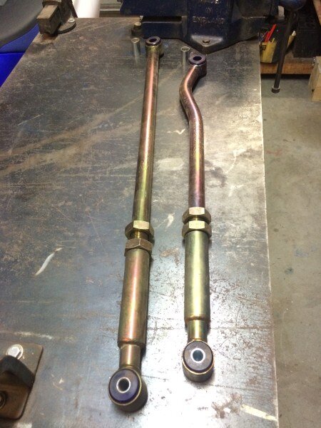

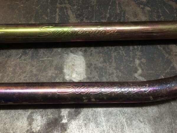

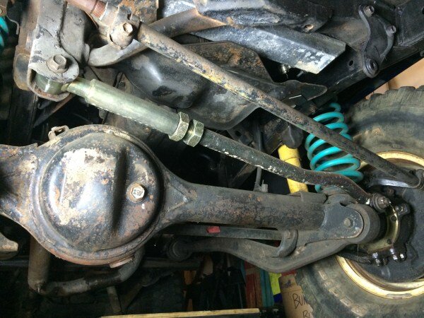

I removed the Superior Engineering adjustable panhardrods off RJ as I want to try and fit them to LJ when the new springs go on.

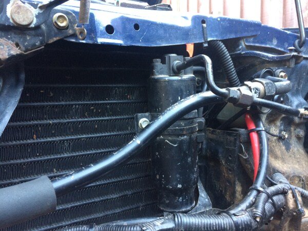

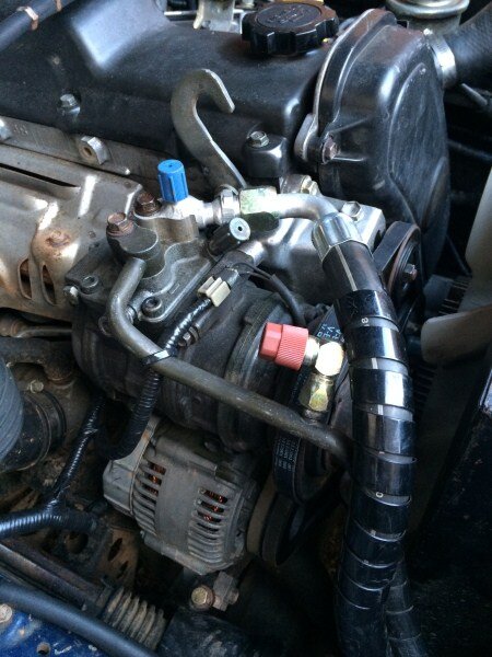

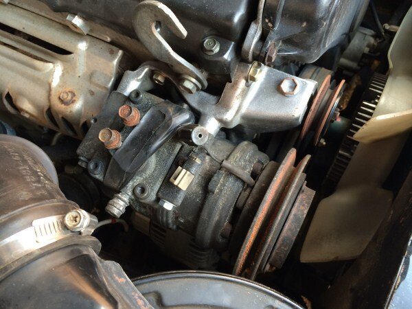

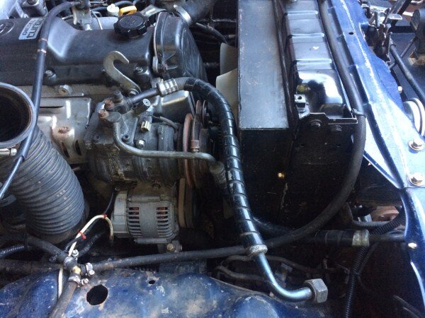

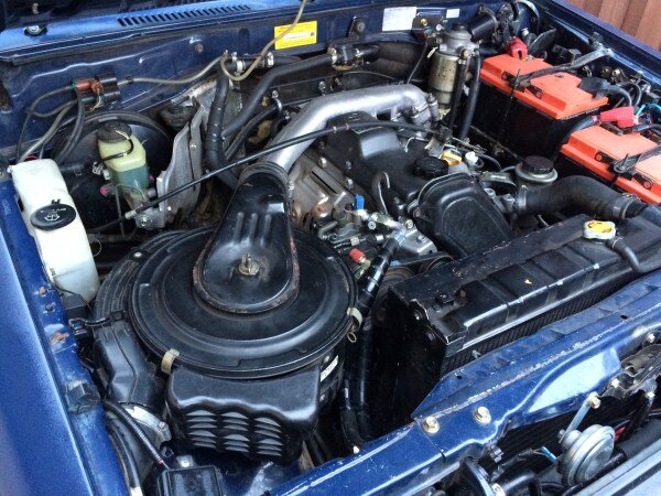

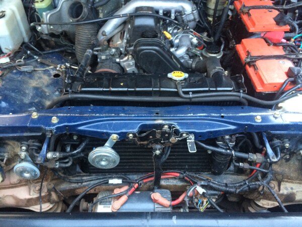

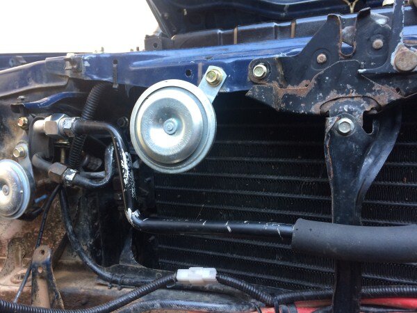

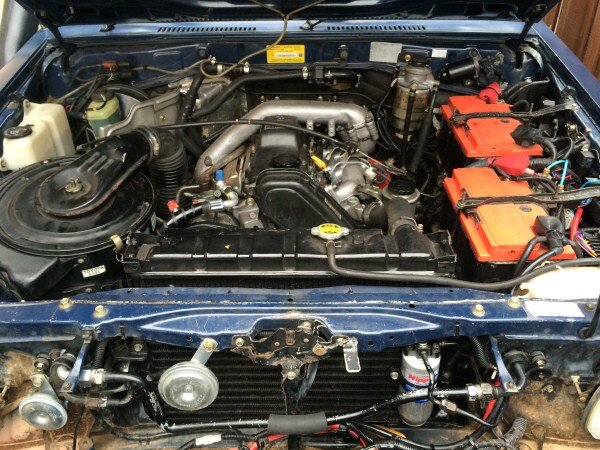

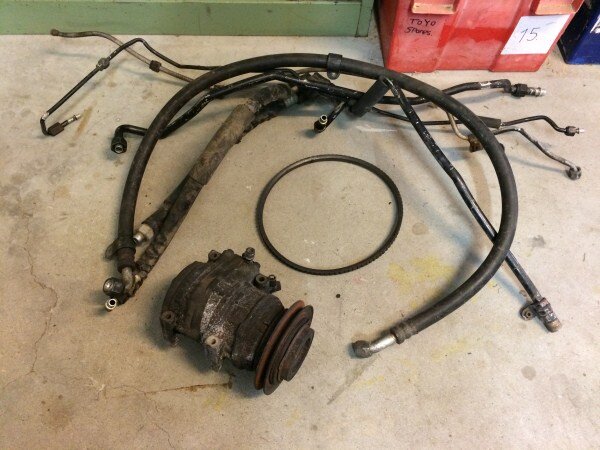

Next job was the aircon install. :icon-cool:
Its now over a year since I got back from Europe with suitcases full of aircon parts, so it was about time I got it finished. :shifty:

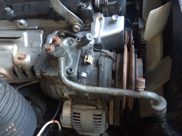

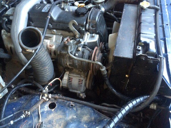

RJ had aircon when it left the factory, most of it is still fitted apart from the engine bay components. But I did get a pump and a load of bits of pipe with it.

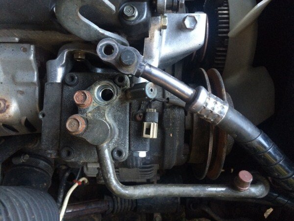

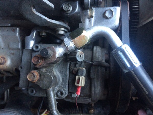

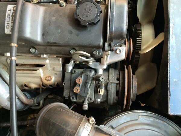

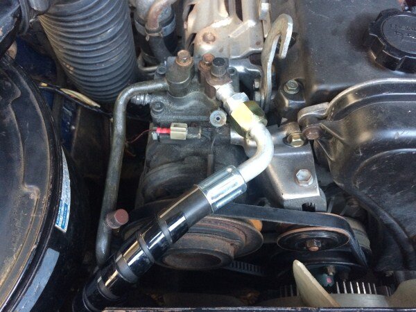

Which got me thinking, I wonder if this old pump would bolt onto my 1KZ engine. :think:
Amazingly it did and it looked like it would work. :dance:

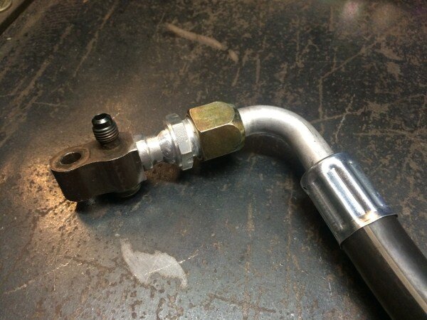

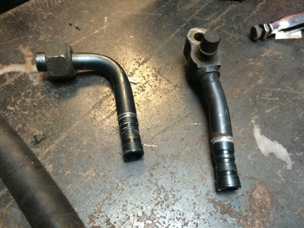

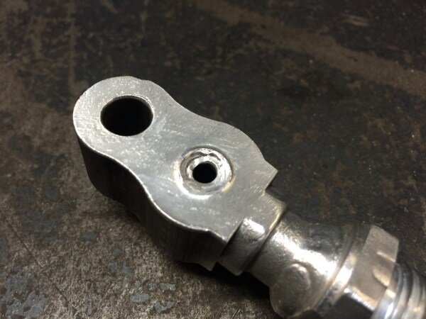

The only issue was connecting the pipes.
The one pipe bolted up perfectly.

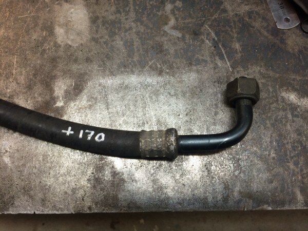

But the other was going to need some work as not only did it not have the correct angle on the fitting, the hose wasnt long enough. :doh:
The angle on the fitting could be made to work, just, but it wasnt ideal.
It was far too short though.

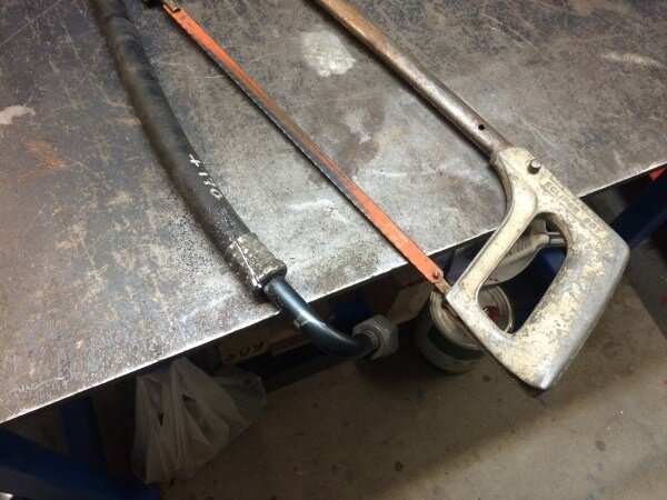

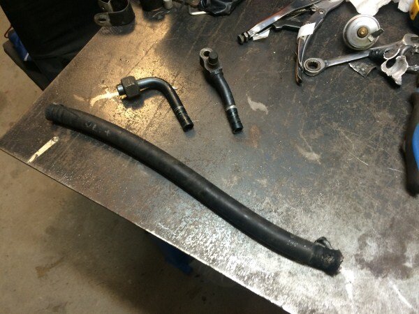

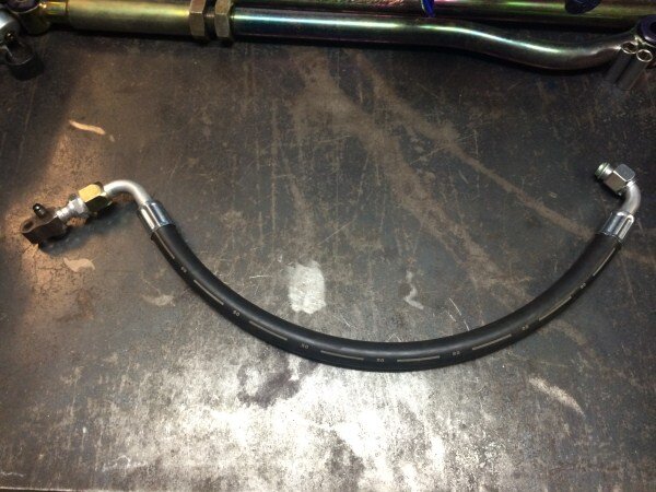

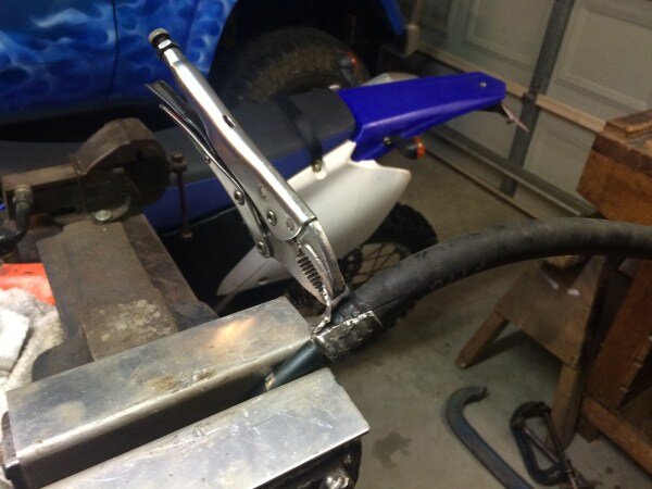

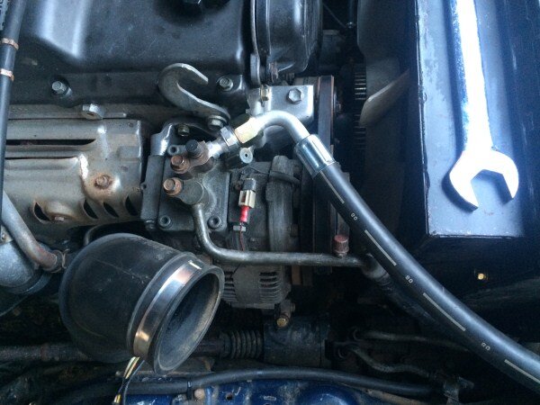

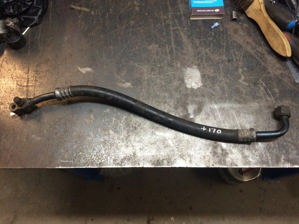

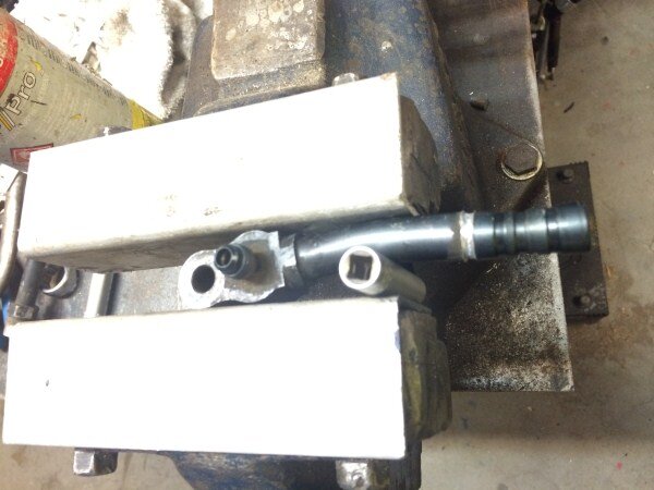

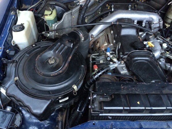

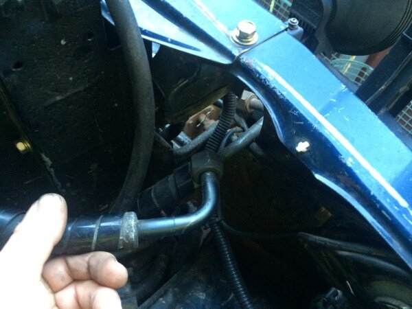

I decided to do the job properly I would have to get a hose made and I thought the cheapest and easiest thing would be to just get a new piece of hose crimped onto my fittings. :think:
So I worked out how much longer it needed be.

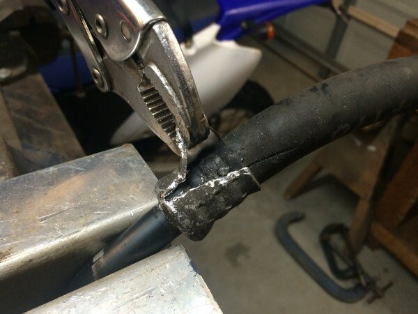

Carefully removed the old crimps.

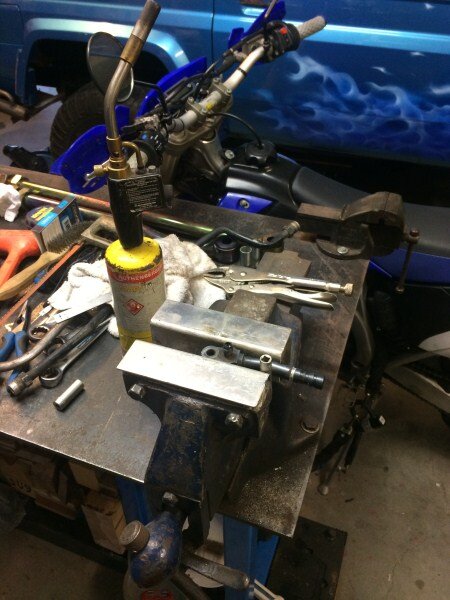

Decided to bend the one fitting slightly to angle the hose away from the rad.
So I heated it up and bent it around a socket very gently.
I went to 2 local hose makers and neither of them had the correct crimping tool or crimps to use my fittings. :doh:
So I had to get a new hose made.

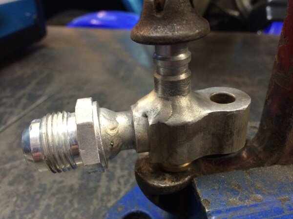

They had to get a local TIG welder to weld a new threaded male end to the fitting that bolts to my pump.

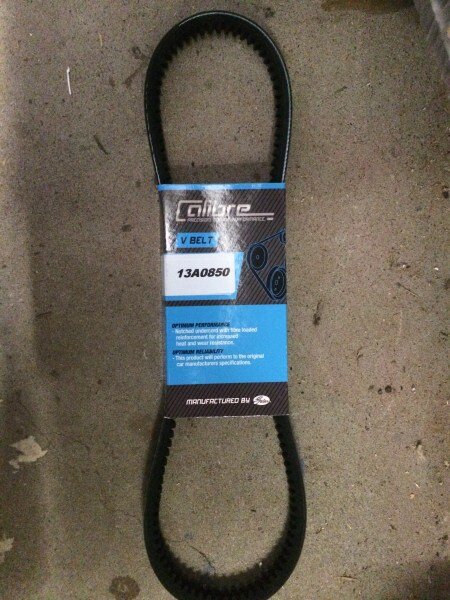

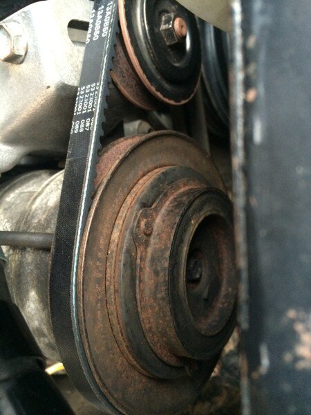

I picked up a new belt, well actually I picked up 4 in total and the first 3 were all the wrong length. :oops:
The joys of fitting a pump to an engine it was never designed to fit onto. :shifty:
This was the 4th and final one.

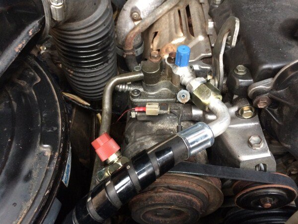

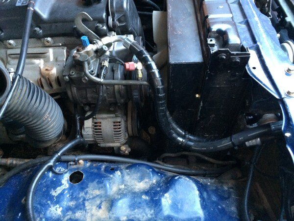

I tested the pump using a battery to see if the magnetic clutch was engaging when it got power, which it was.
And then I bolted it all up ready to get it gassed up.
The drier would be getting replaced, but apart from that it was all good to go.
An hour or 2 after dropping it off at my local aircon place they called me to say that they needed to convert the system from R32 to R34 (I think thats the correct numbers) as they couldnt get their equipment onto my fittings.
There was a small cost increase, but it had to be done so I told them to proceed. :icon-smile:

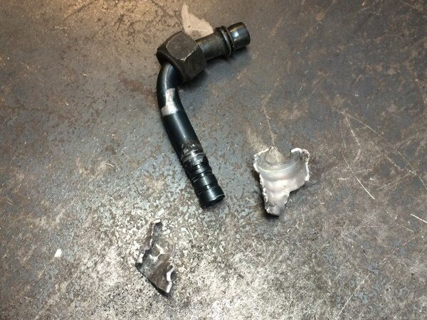

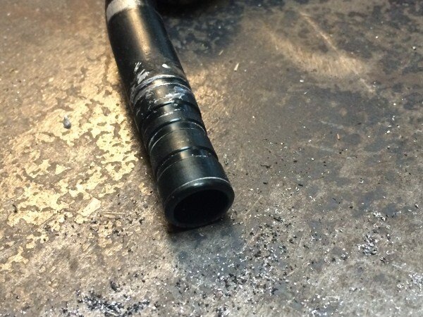

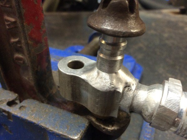

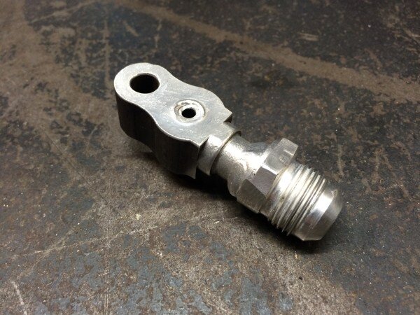

Then an hour later they call me with some bad news. They have snapped off one of the fittings and stuffed my fitting that I had welded up and that was the only pipe/hose I didnt have a spare of. :doh:
I went down and saw them and they were saying I should go to a wreckers yard and try and find another fitting, or go and get another hose made up.

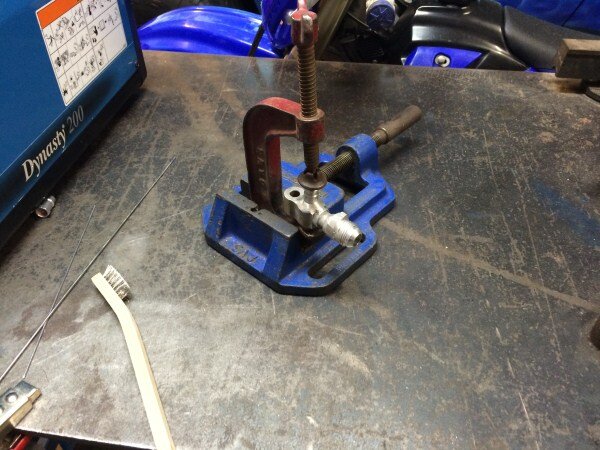

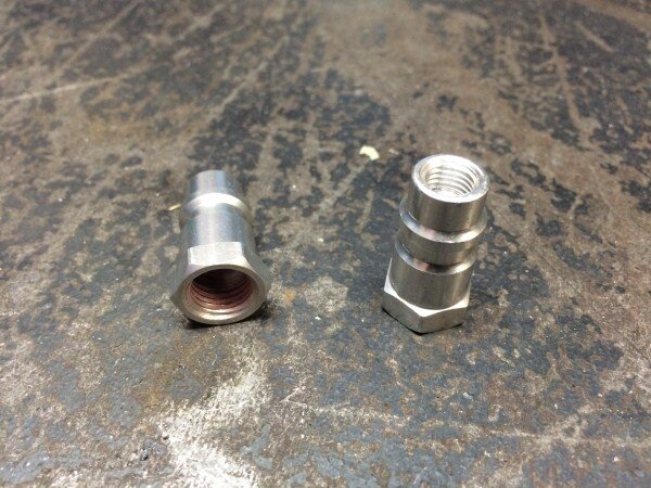

So I suggested why not weld a new fitting over the hole where they had sheared off the old fitting. :think:
I got a fitting off them and raced down to BOC and got a bottle of argon for my TIG.
Because alluminium is such an amazing conductor of heat, its vital to have components really well clamped to avoid distortion. :icon-ugeek:
I shot back down and gave them the fitting and waited patiently for news of how they got on with it.
I was worried about the pump as I knew it had been off of a vehicle for many months and thats not good for pumps. It even states in the FSM that if you intend to store a pump for a while you should seal some gas in it. :icon-ugeek:
Anyway......................

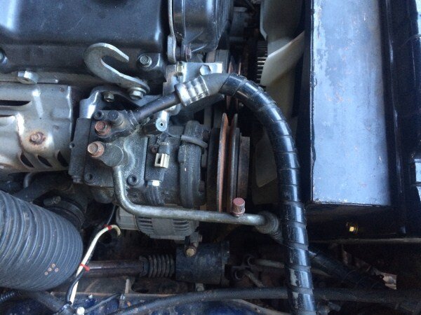

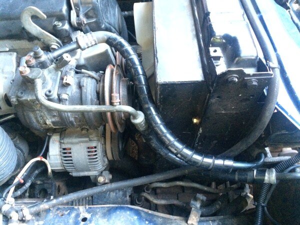

An hour later I got a phone call to say it was all finished and working like a dream! :dance:

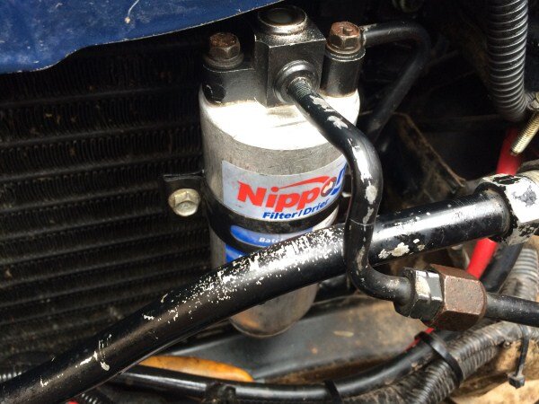

New drier.
New fittings.

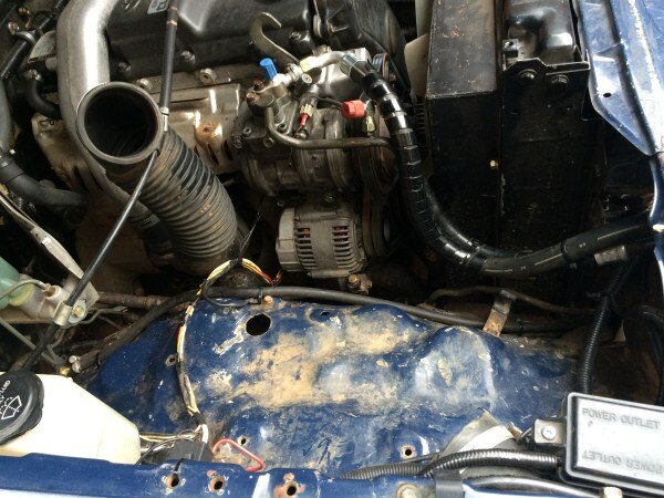

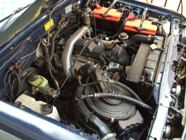

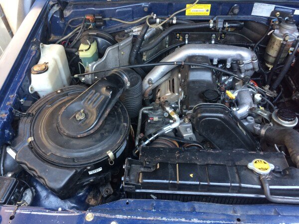

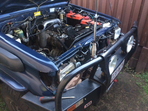

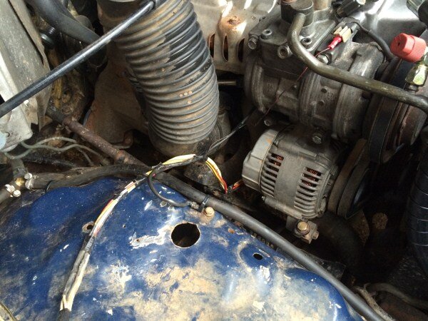

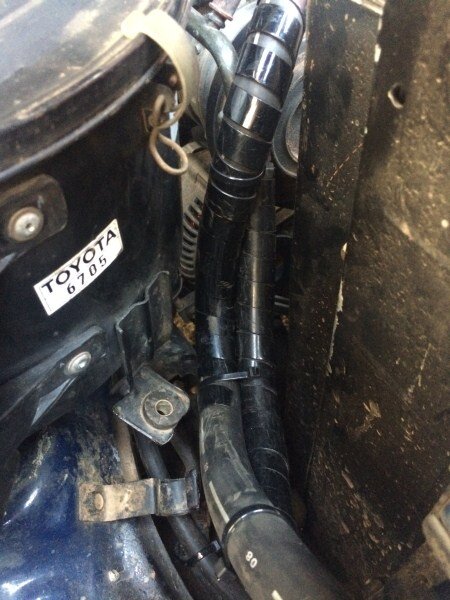

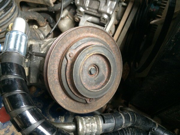

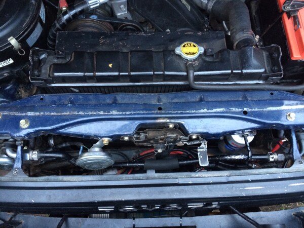

I pulled the airbox out as now it was all working I could tidy up all the wiring and change the pulley bearings.

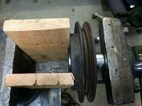

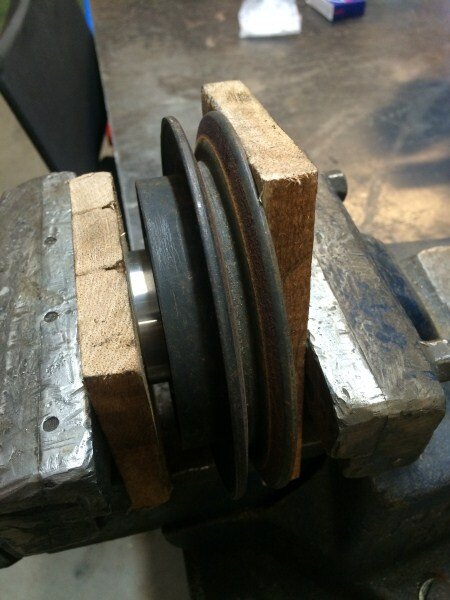

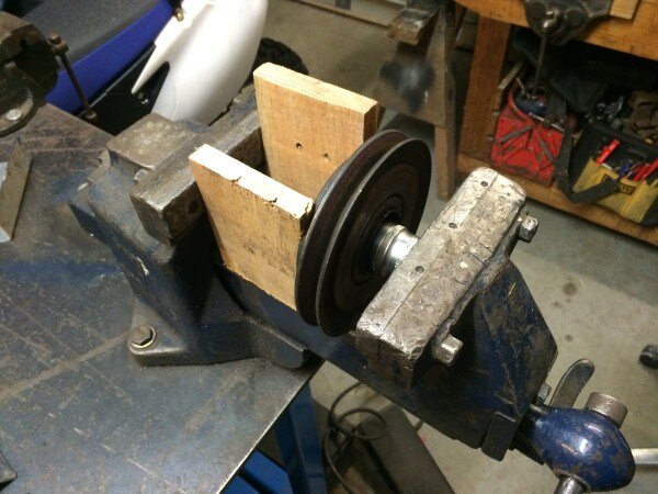

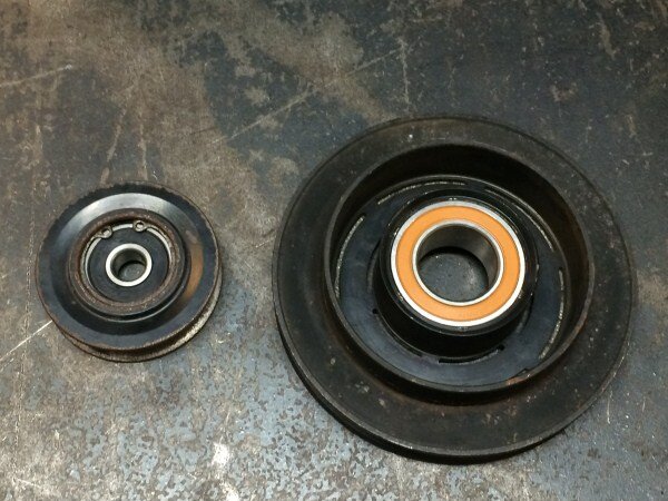

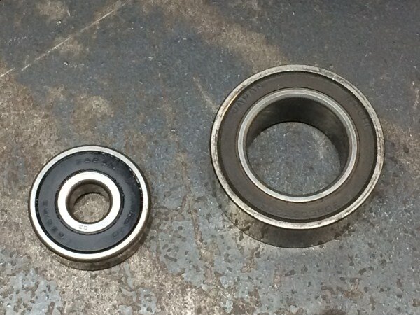

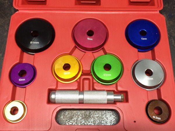

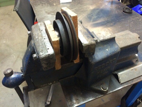

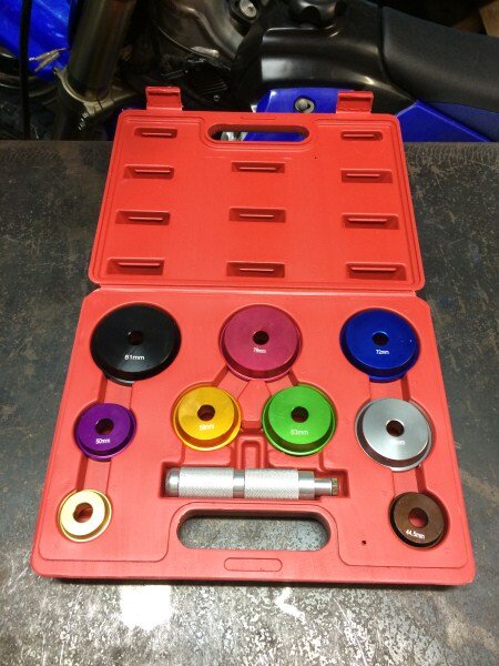

Removed the pulleys from the pump and belt tensioner.

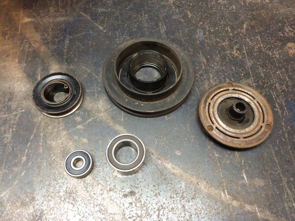

Pressed the old bearings off.

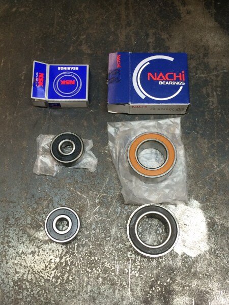

Took the old bearings to my local bearing shop.
Fitted the new bearings.
I could then bolt it all back together.
And thats the aircon install complete! :dance:

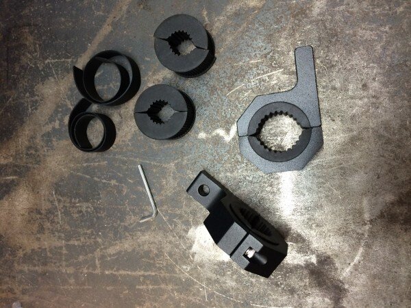

I've got some service work to do before the trip so I finally treated myself to a proper seal driver kit, I thought for the sake of $30/£15 delivered, off ebay, why the hell not! :icon-biggrin:

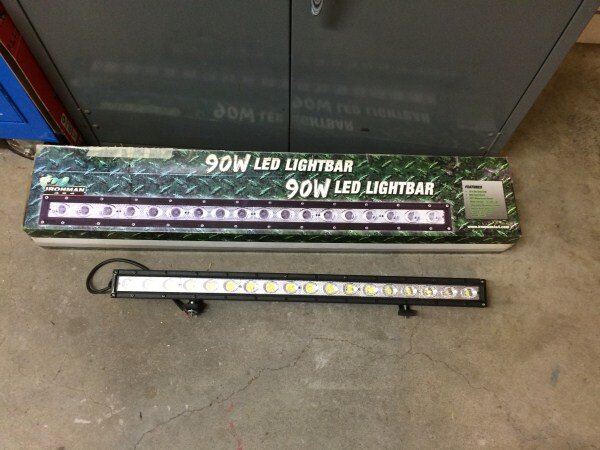

I also picked up some light bar mounts that were on sale and very cheap.
Nice chunky billet alluminium ones.
As I'm thinking of putting the light bar that came with RJ on LJ. :think:

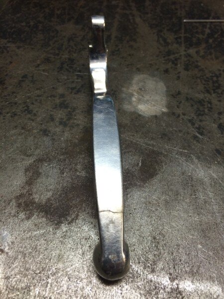

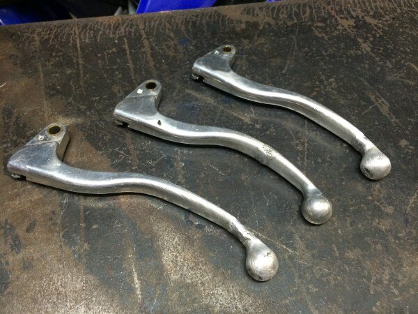

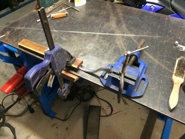

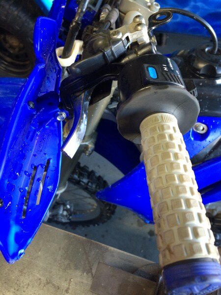

Did break another clutch lever early on in the day, but just carried on with the broken lever.

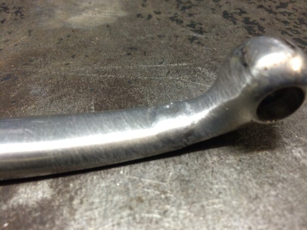

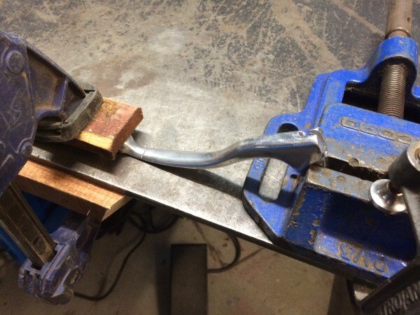

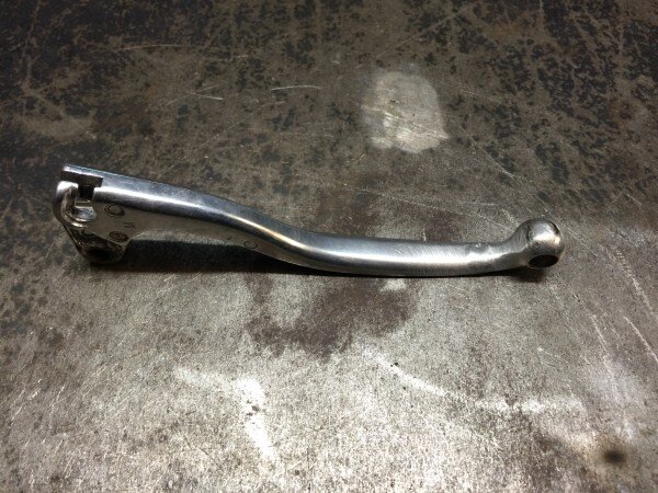

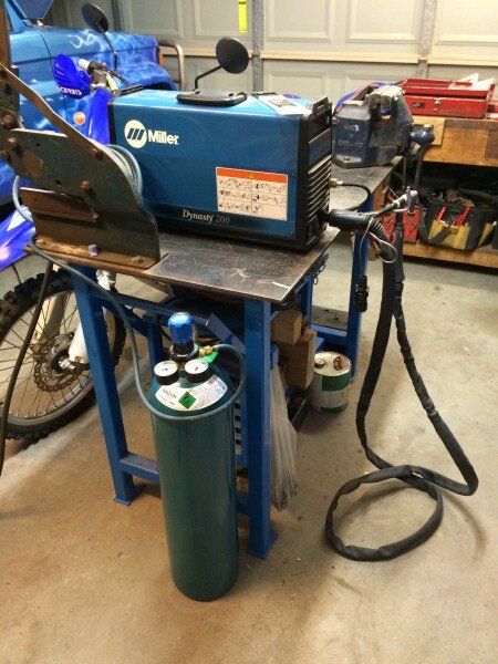

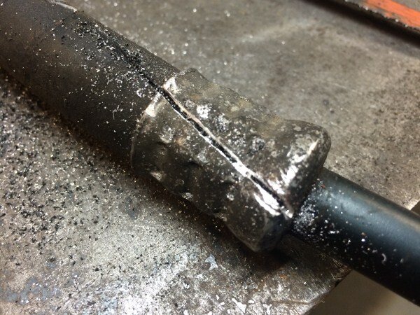

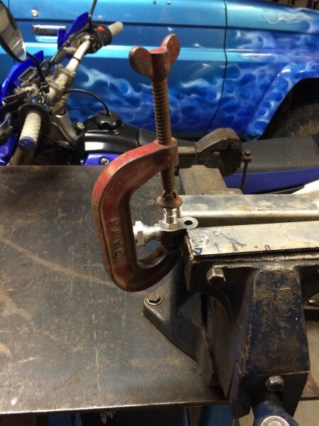

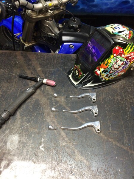

So last nights job, now I have TIG gas, was to repair some clutch levers.
One side done.
Then flip it over to do the other side.
I'm going to get a little bag to bolt to my rear fender and I will carry spare levers and some tools in it. :icon-cool:

Regarding the AC install, Did you or the AC guys add any oil to the compressor? It's often overlooked...

Yes they added oil as I wasnt sure how much was left in the compressor as I never opened it up. They also added green dye in with the gas to show up any leaks if/when they occur. :icon-ugeek:

After the truck has stood in 36C all day, it cools the hot air from the vents down in just a few seconds, and stays cool, but not cold.
Take a torch and have a look in the sight glass on the inner wing just above the left side battery. If there's bubbles going through then the system is short of gas.
I can see fluid rushing past the sight glass Rich. I can't say it looks like bubbles, but I suppose if I can see it (it fills about half of the glass) then it's low. Should that look like 'solid' fluid?
If yes, it means I must have a leak somewhere then. I'll have to get a UV torch and try to locate it.
I've checked the pipe along the bulkhead that so many have found leaks, but it looks ok.
Maybe an 'O' ring is weeping somewhere.
Yes Clive, that should be a solid slug of liquid. You either have a leak or the last person to fill it didn't fill it properly. Leaks usually show up by a patch of oil around them. It's worth spacing the bulkhead pipe away and sticking some tape around it to prevent moisture sitting on it. Other than there, check the blow off valve at the side of the smaller pipe on the compressor, it should be bone dry. Then most likely places are forward of there on the small pipework back round through condenser, drier, sight glass and back to the bulkhead.
