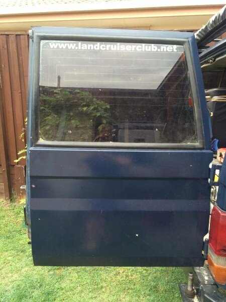

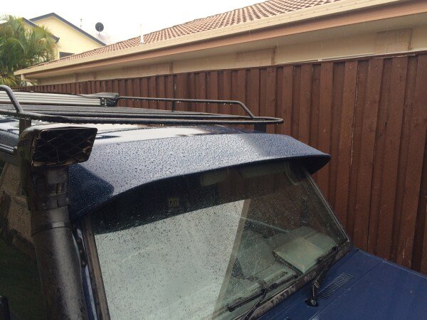

I got a bit of work done on LJ over the last couple of days. :icon-biggrin:

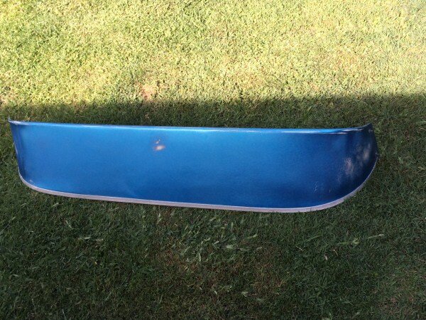

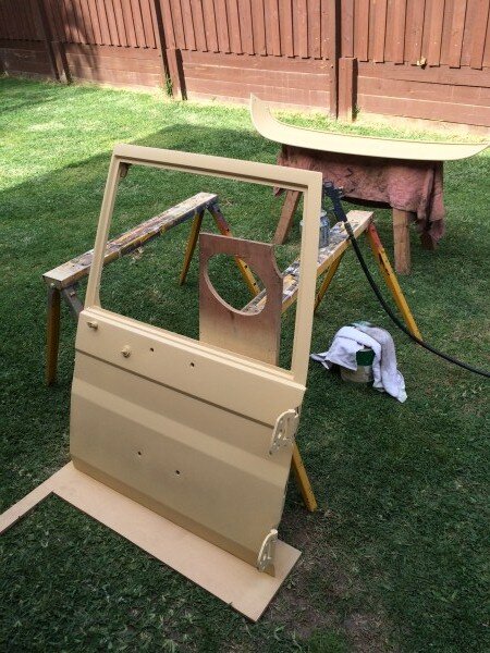

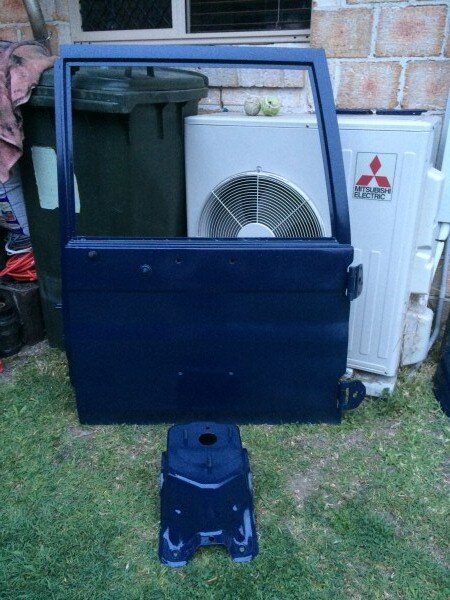

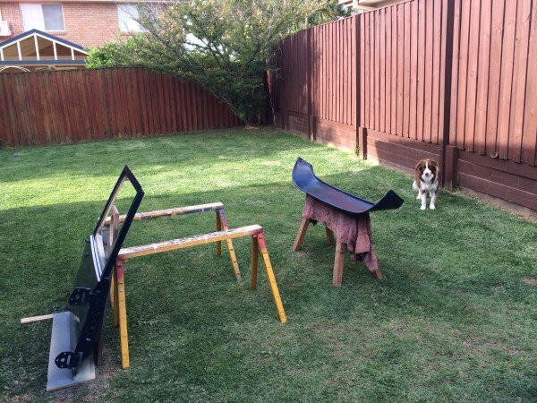

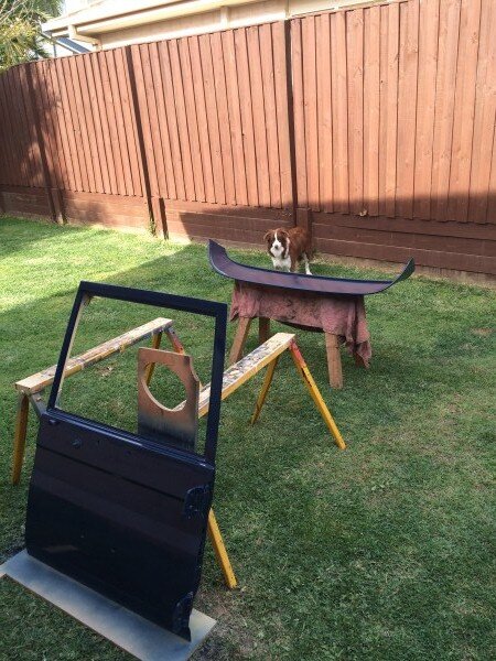

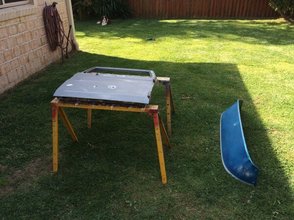

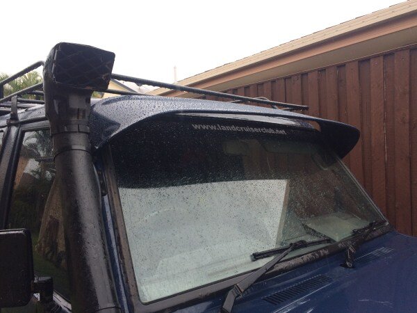

I got the new rear door and sun shade outside yesterday and sanded and cleaned them ready for paint.
The sun shade came fitted to RJ when I bought it, but it had to go as it prevents the screen from being folded down.

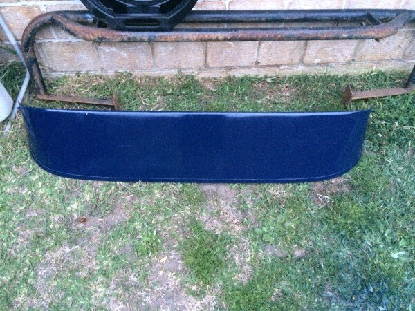

I wasnt sure whether I liked it or not, but decided I'd get it painted and see what it looks like on LJ. :think:

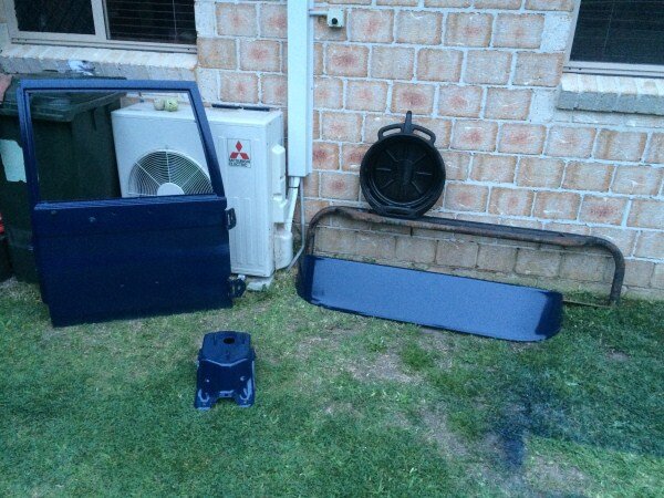

Got them both in primer.
Followed by a few coats of Midnight Blue. :icon-cool:
This morning they were nice and dry.
Not a perfect paint finish but at least they will match the rest of the car! :shifty:
Removed the swing away wheel carrier arm.
I will loose my gas stove storage but I think thats a fair trade off for how much more practical the car will be with the spare back on the door.

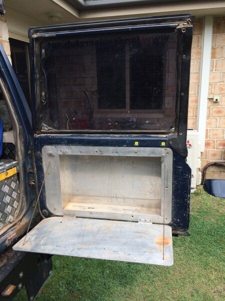

I started removing the old door.
It hadnt rained for a few weeks but was scheduled to today, but at least the next week looks perfect! :dance:
Thankfully I had the rear awning or I dont think I would have been able to get much done today as it rained from 11am onwards.

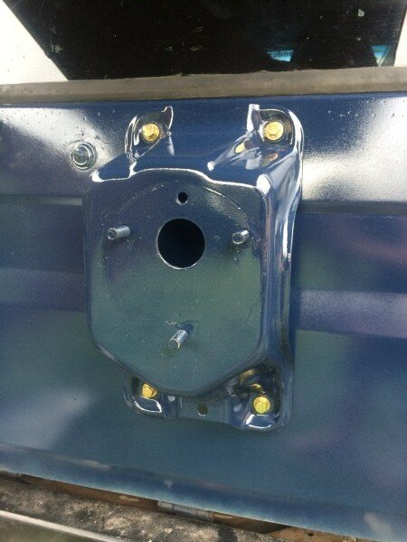

New door bolted on.
Fitted my old window.
Bolted on the spare wheel bracket.
And got the spare mounted.

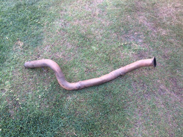

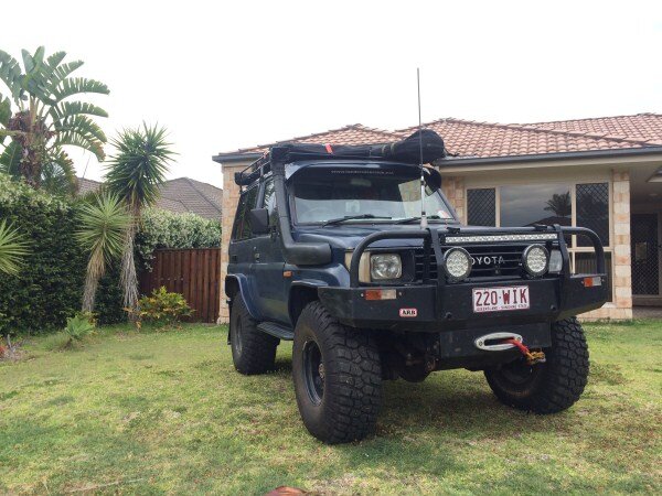

Had to remove the last section of exhaust so I could get the new bumper on. It needs some work doing to it as I need to add a towbar/receiver hitch to it and I want to add my lights and trailer socket, then I want to get it shot blasted and powder coated. :think:
And finally I got the sun shade bolted on. Found standing up through the open sun roof was the easiest way, even though it was raining quite heavy.
Will get some better pics of the sun shade next time the sun is out. But I think I like it. :icon-biggrin:
So the big job now is to modify the rear bumper and exhaust. :think:
I'm hoping the new bumper will improve LJ and make it more practical for the sort of family camping trips/light off roading I'm doing. :icon-cool:

I hope you find the sunshade a practical solution, Ben.
Here the lanes/tracks that I run on are very overgrown and I think low branches would soon have that off. Your tracks, from what I've seen, are more open and less prone to damaging it.
Nice work anyway, the new bumper looks good :thumbup:
We've just come back from out west (SW of Nyngan) and a lot of stuff out that way runs a shade strip like that; they're also often seen on old peoples cars... now that sounds negative, but you only get old by doing things right on the whole... so they must be doing something right! I reckon as well that it'll cut down glare onto the dashboard.

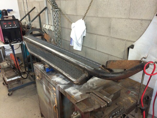

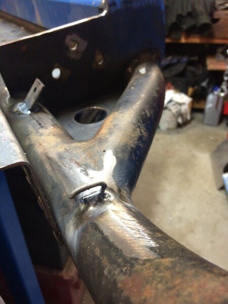

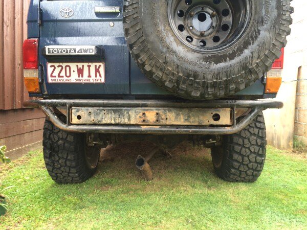

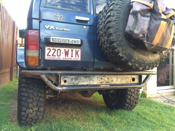

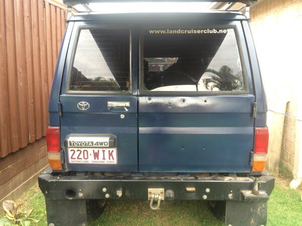

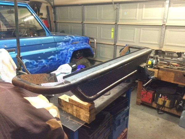

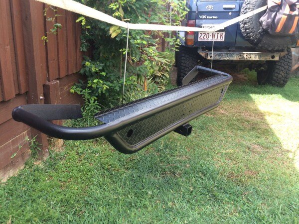

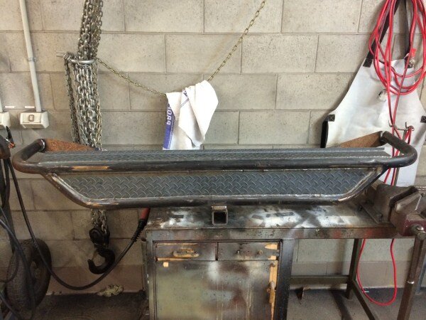

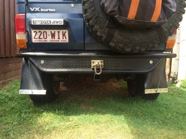

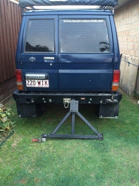

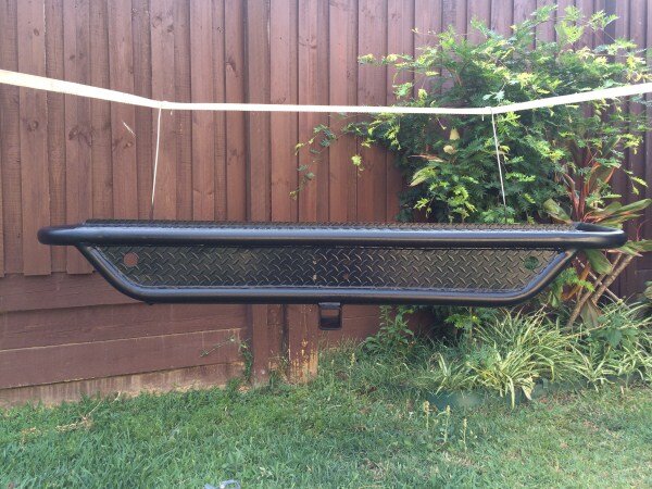

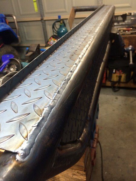

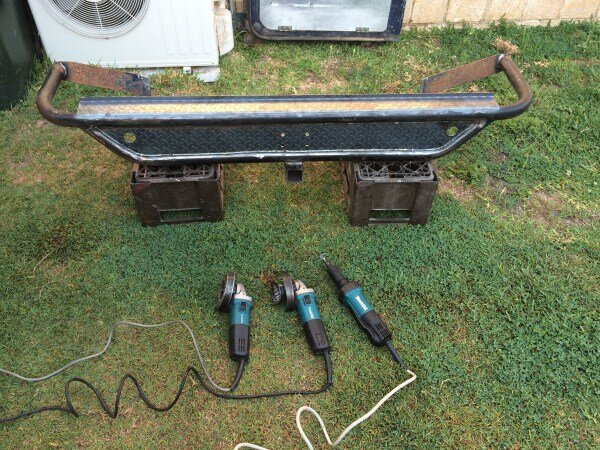

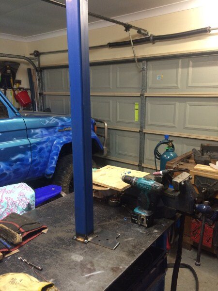

I've been doing lots of work on the rear bumper/bar.

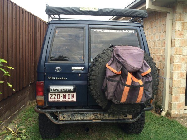

So this is where we were up to at the last update, with the second hand rear bar.

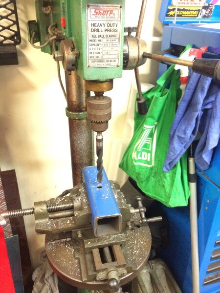

I picked up some steel for the towbar I nedeed to add to it.
And some 2mm checker plate that I had cut and folded.

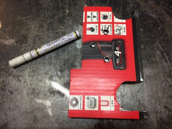

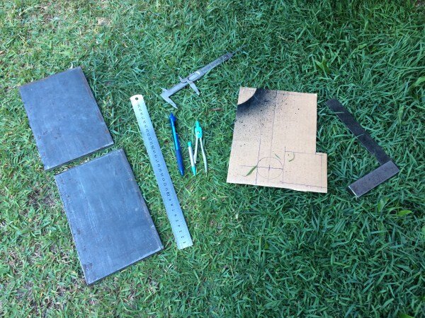

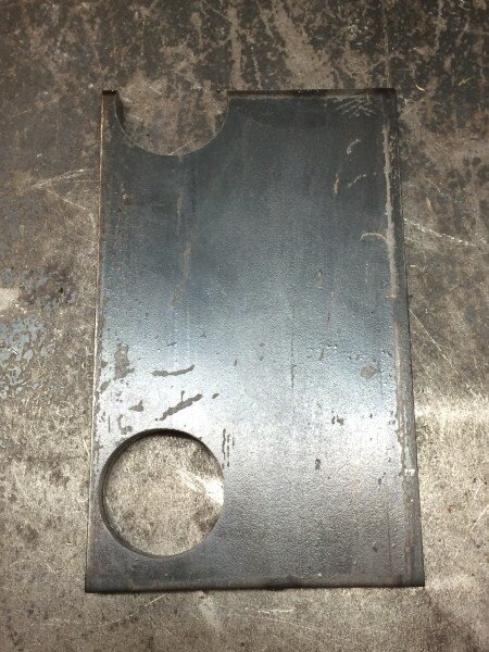

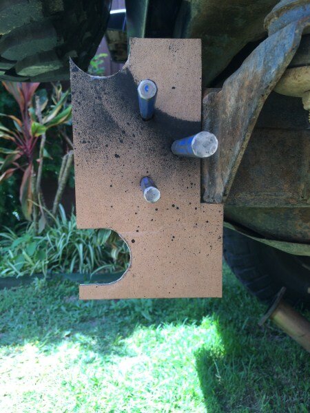

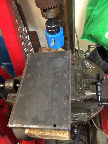

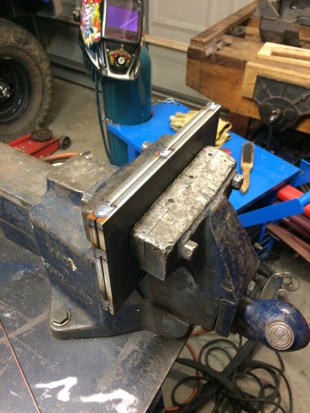

Designed the plates that would bolt the whole thing to the chassis.
Tack welded the 2 8mm thick plates together.
Got them on the drill press and put a 48mm hole saw through them.
Used some punches to work out where my mounting holes needed to be on my cardboard templates.
Transferred those marks onto my steel.
Center punched and drilled them.
Bolted them on.
Cut the old brackets off the rear bar.

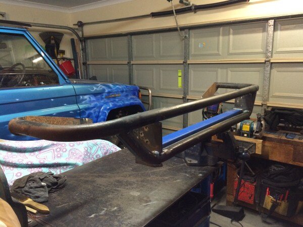

Tack welded the piece of 65mm box section, tow bar steel between my chassis plates.
Bolted that back onto the chassis and brought LJ round to the garage to tack weld the rear bar onto the chassis plates.

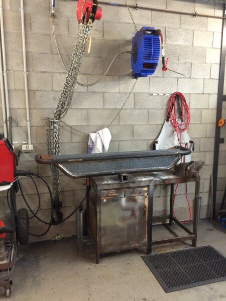

Got it on the bench to full weld it.
Test fitting back on the car.

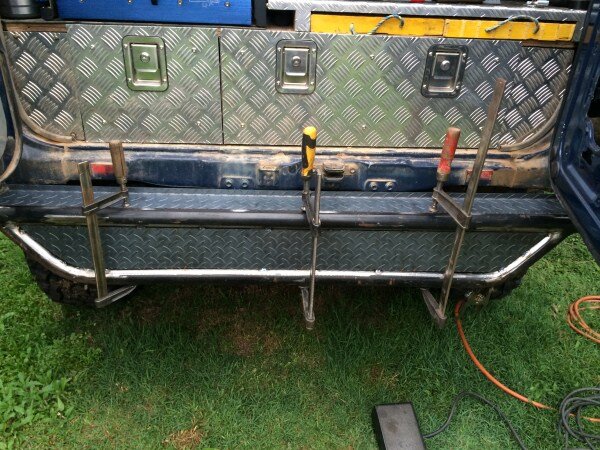

Decided the bar would look better filled in with checker plate and it would also tie in with my rock sliders that have checker plate on the top.
The piece I ordered was too wide so had to cut it down.
Cut it to fit inside the tube work.

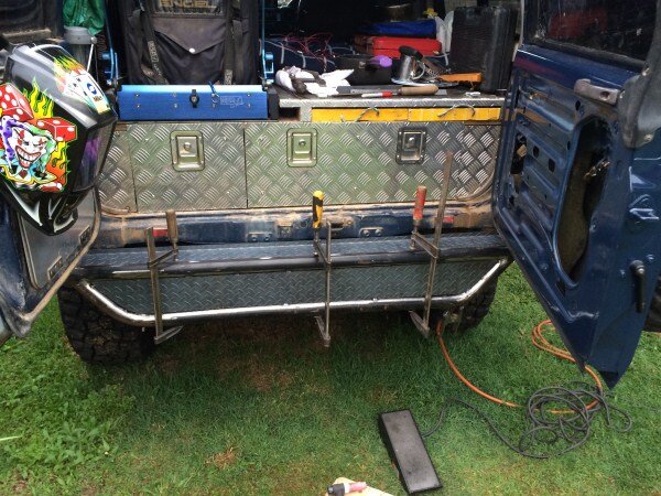

Clamped and it in position.
Dragged the welder outside.
And tack welded it in position.

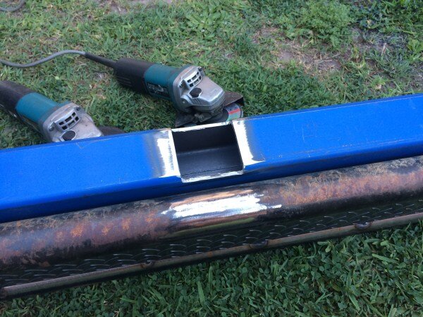

Pulled the bar off, flipped it over and started cutting in the receiver hitch for the towbar.
Drilled a 16mm hole through the receiver section.
Cut it to length on my cold cut saw.

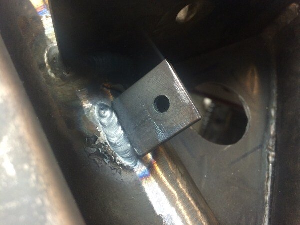

Decided to fully TIG weld the top piece of checker as I knew it would be far neater than using a MIG as I could just fusion weld the checker to the tube without needing to even add any filler rod.
We have a huge workshop at work for woodwork and metal work with every machine imaginable and my boss said I can come in and use what I like, when I like! :dance:
So I took the bar in to use the MIG.
Brought it home and drilled some holes through with a hole saw for the rear LED lights.
Cut, drilled and welded on some mounting tabs for them.
Welded on some cut chain links for the mudflaps.

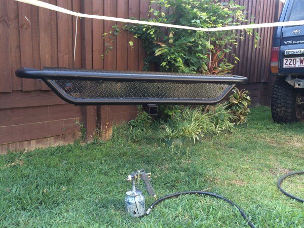

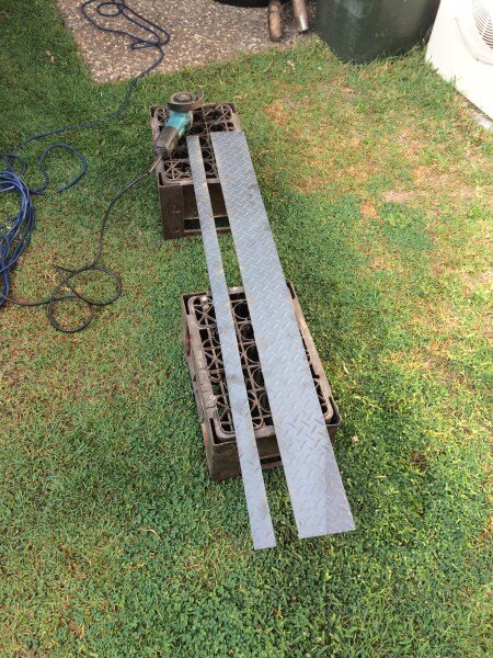

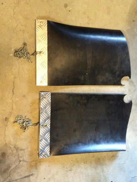

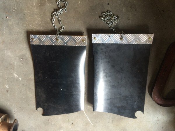

Cut some strips of alluminium checker plate.
Bolted them to some thick rubber I cut for the mudflaps along with some chain.

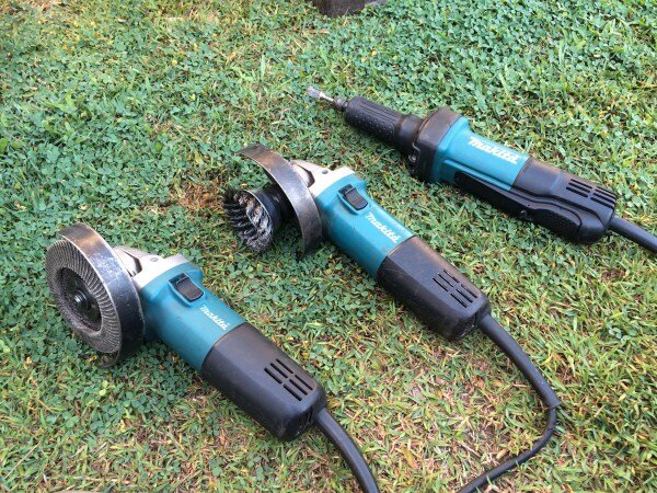

Needed to clean the bar up and get it ready for paint next, using the 3 Makita's.
Hung the bar up on a ratchet strap between LJ and the fence.

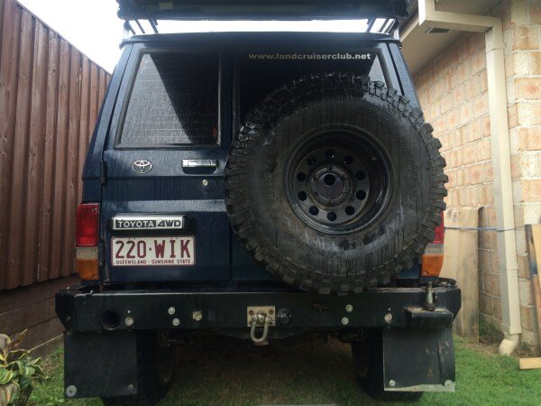

Found some black paint.

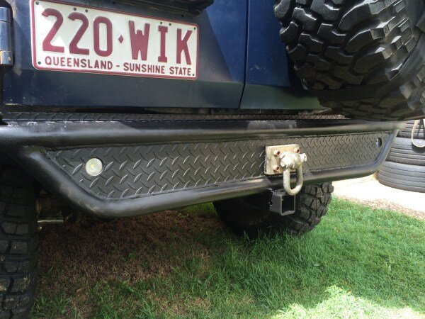

Sprayed it.

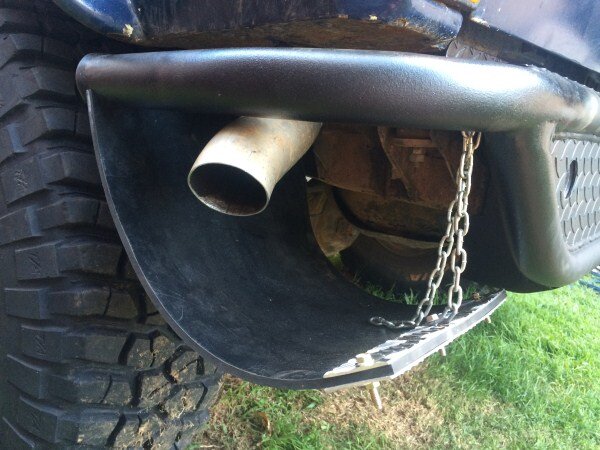

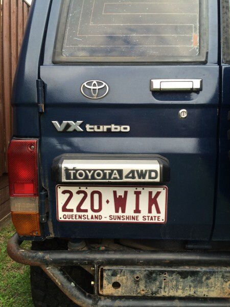

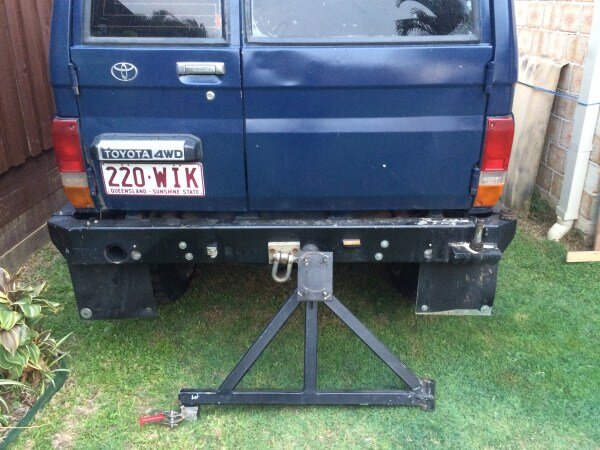

Bolted it on along with my rear swivel recovery point and LED lights.

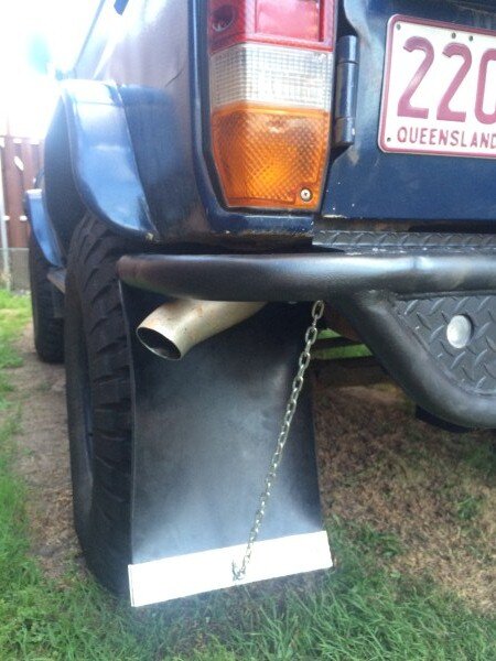

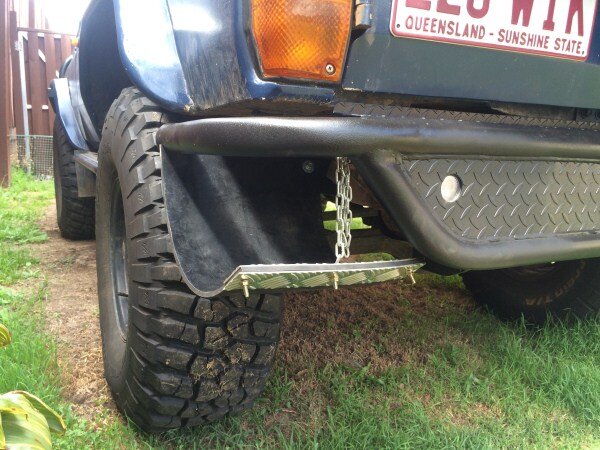

Mudflaps next.
Chains keep them away from the tyres.
Then when we go off road they simply get clipped up higher out of the way.
The rear bar isnt finished, I need to add more steel to brace the towbar and side wings back to the chassis, then I want it shot blasting and powder coating. :think:
So why paint it and fit it I hear you ask...................
Well the wedding is now less than 2 weeks away and as we wont be going on a honey moon till next year as we have lots of international friends and family over for the wedding, it wont be practical to go away straight afterwards.
So were going on a mini pre-moon! :dance:
Going to jump on a ferry and take LJ to one of the islands for a few days of beach camping and relaxing! :cool:
So I had to get the rear bar fitted so we could have those all important mudflaps fitted to avoid any hassle from the boys in blue! :icon-biggrin:

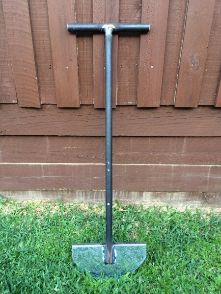

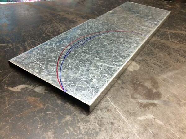

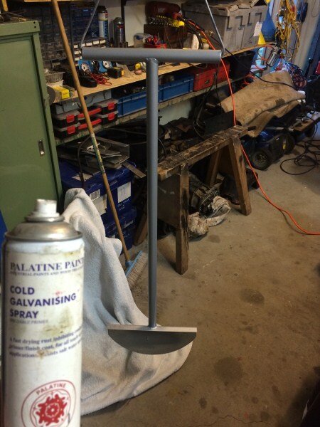

I wanted an edging tool to neaten up the edges of my lawns where it meets the concrete. :icon-biggrin:
But I couldnt justify paying the stupid prices for the proper tool, when they were selling them for 2-3 times the price of a spade. :icon-rolleyes:

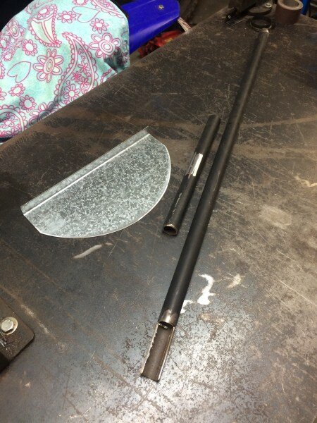

So I decided to knock one up out of some scrap I had in the garage.
Found and marked a piece of folded galvanized sheet steel.
Cut it out and cut and notched some 25mm tube.
Welded all the bits together.
A quick spray silver and it was done! :icon-cool:

your welds are bloody lovely Ben,I've worked with a lot of top gun welders over the years and you are one of the best.
Nice work as usual Ben.
I started wondering if you intended some braces for the receiver, till you mentioned it toward the end of that part of the post.
As the receiver is the lowest point on the bumper, it's likely to get some hits on drop-offs and the occasional rock.
Mine does anyway and on a flat and level surface, unloaded, mine stands at 550mm off the ground, so it's surprising how it gets hits at all!
You likely know ARB products better than me but the rear carrier bumper for the 80 is a great example of ARB getting it right.
From underneath, you can see the shape of the brace, nice and wide, and thick steel, which makes for good protection from rocks.
Side on, you can see how it protects the receiver.
The drillings make it an ideal platform for safety chains and whatever else you may want to attach or mount.
Receivers are great, out can switch from tow ball to sankey, bike racks or other mountings. If the receiver is well braced, you can have up to a meter of protrusion, for bike racks holding 5 bikes on the horizontal (how many kids do you intend on having?:whistle: :lol: )
Thanks guys. :thumbup:
Clive, that looks nice and solid, thanks. Might brace mine in a similar way. :icon-biggrin:

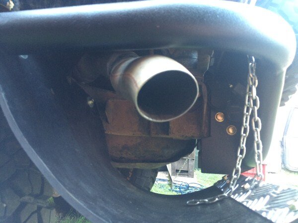

Before the trip I had to alter the very end section of exhaust as with the old rear bumper the exhaust came straight through it, but with the new one this wasnt possible. :think:
A bit of cutting and welding later and it was done.
