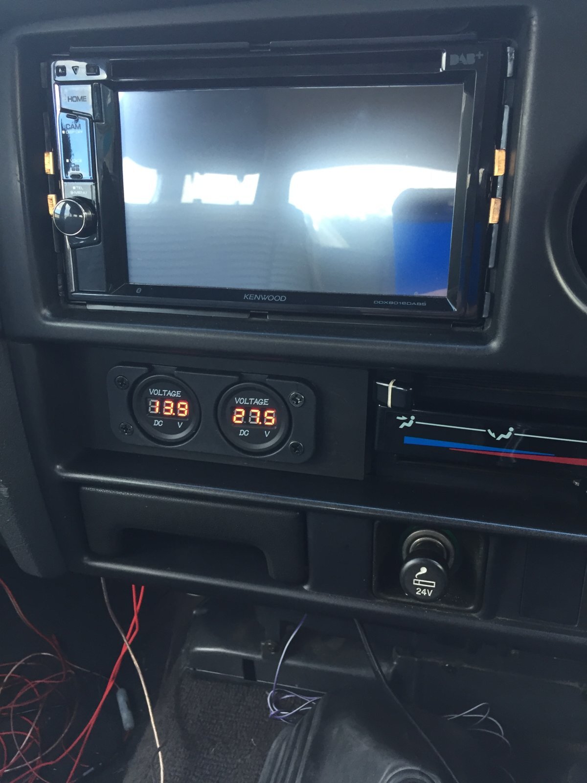

Having said that, i have installed a pair of volt meters so i can see whats going on. The left meter is the left battery, the right is the combined circuit at the right hand battery +Ve terminal.
With the new voltage regulator fitted the alternator output seems steady at 27.6v regardless of revs.
Will report any relevant observations of the meter values in use.

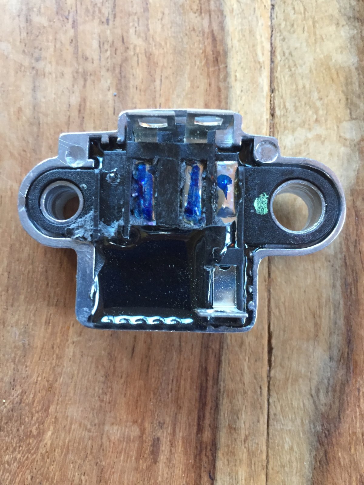

image.jpg An early start today and changed the voltage regulator. No visible signs of any issue in the old one but all is now back to normal.
Need to get another spare VR now.

Nice easy fix. Good job you had the spare regulator. Might be worth testing battery voltages again just out of curiosity.
If it was a short overcharge it might have given the batteries a bit of an uncontrolled equalising charge. :lol: Hopefully it wasn’t long enough to do damage, they don’t like it up ‘em as someone used to say.
I do that more often these days Rich as my wife likes to ignore what I say coz im always talking about the effing cruiser!
Yes the overcharge was about 2 mins and the internal voltmeter went up to 17.6v fir the left battery and over 32 combined.
Will keep measuring every saturday morning an logging the history.
That shouldn’t have done too much harm Ben. It may have done some good but your logs will show.

Teeing into the cigar lighter may be suitable Andy, thats what I did to add the dropper for various needs so I could remove all the wiring from the near side battery.
Since this was done the batteries are much happier and havent needed charging for 4 weeks now which is promising

Fairly easy for mine as there is a lower central dash panel held on with 4 screws that reveals the cigar lighter wiring. Presumably you have the earlier dash andy?
