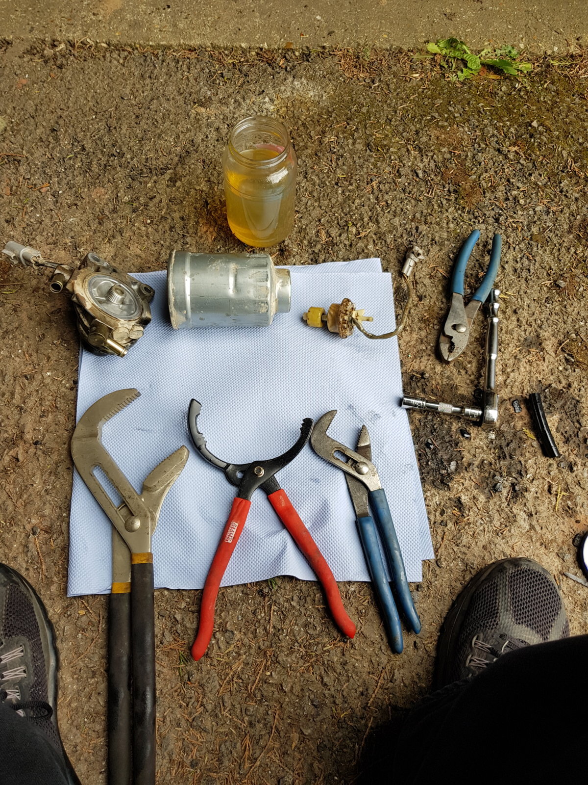

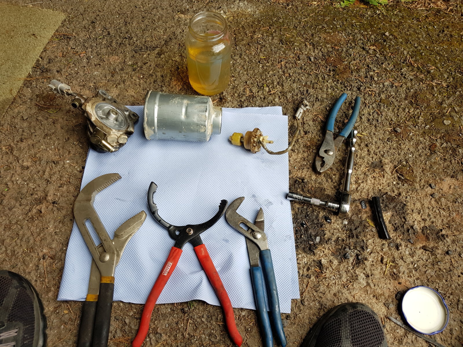

Changed the oil and all the filters today. Used genuine ones instead of the one from roughtrax after recent discussions. ( not that there is anything wrong with them)
For those like me who have searched for changing the fuel filter but found no piccys. It is as easy as the search results tell you. Undo the two nuts and unclip the two electrical connections, remove the pipes and take it somewhere with more room.
Drain it using the little wing nut thing on the bottom, unscrew it all and you'll end up with this
@Rosy a selection of grippy plier type things is useful to have...
Screw it all back together and replace. Remember to do up the wing nut at the bottom tightly as it would be REALLY annoying to put it back on, prime the pump and then have it dripping. (I couldn't get enough grip on it in situ)

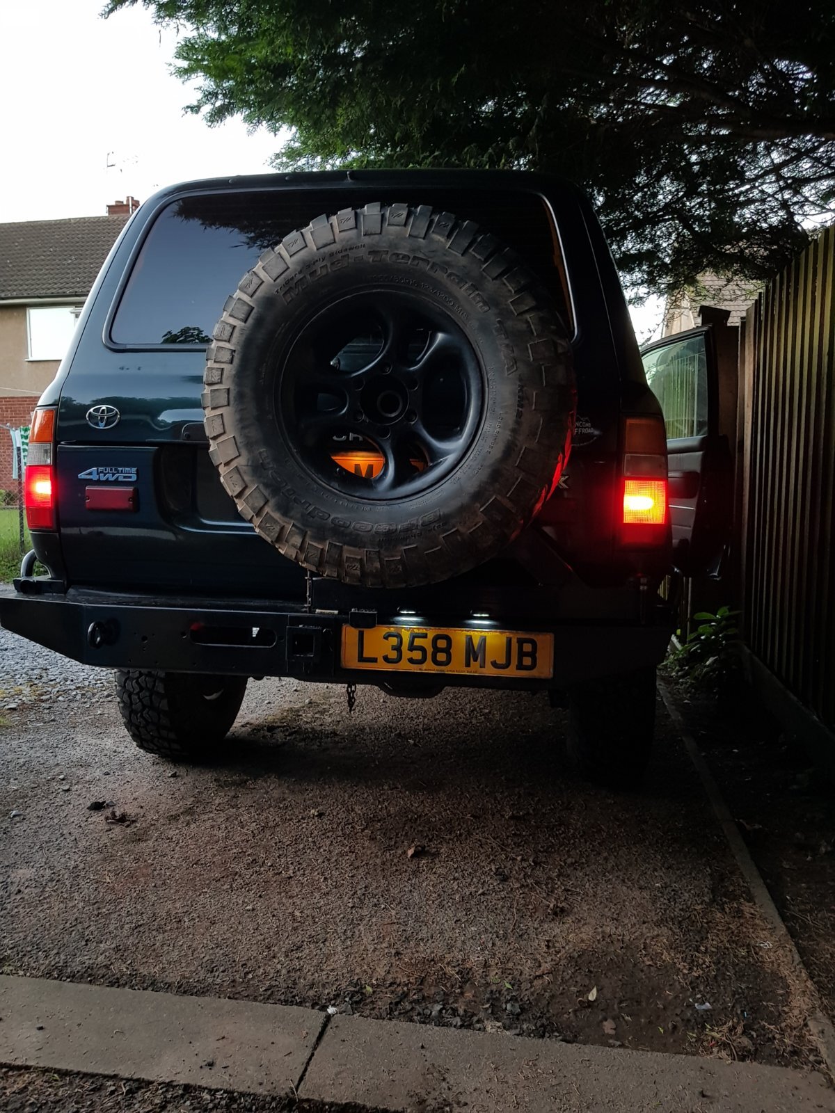

Had a look at the wiring for the lights under the back of the truck and decided, nope, auto electrician! Hes had it all day and apparently replaced all the crustiness but more importantly fiund me the feed for the lights and the fog lights. So I have spent the evening with the soldering iron and.....
Tada!
Still need to find a fog light and where to put it but the weather looks nice for a bit. :)

Im missing something, whats wrong with the foglight youve already got?
