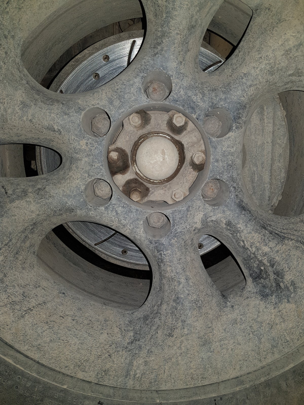

Morning chaps, not washed my truck yet after Salisbury and noticed this
Nsf wheel. Does it look like normal moistness or something I should investigate further? Cheers.
Ps. There's one damp looking bolt on the passenger side too.
It could be anything Nick. I think that the dust and dirt is acting a bit like developer, so where there is residual oil and grease on the stub, the dust is sticking to it and soaking up the moisture. OK so where did the oil and grease come from in the first place? Yes it could be leaking or might just be left over from when the hub was built up. I'd check the other side of the swivel to see what that's looking like. Bearing grease gets hot and can wick out of small cracks like that. On its own I'd say it's nothing to worry about. Taken as an early indicator, it's worth just looking around to see if there are any other signs.
I looked on the swivel things and although moist it was no more than normal. Only the bitvright by the felt. Thanks Chris. Might pop it off at the weekend trouble check.
I get that on mine too Nick, when it's dry and dusty.
Reported it to my service guys and they say "nothing unusual, keep an eye on it and if it gets more severe, we'll bring it in".
It's been no worse than that for ages now.
I was checking round the engine bay and stuff as i thought i'd make use of the dirt. Pipe from turbo to inlet manifold moist, prob need new jubilee clips. Steering reservoir lid moist and the steering box which i know is a bit drippy. Just didnt like to see it down there where i've spent money. Might give it a clean up and degrease and then see what happens when it gets dirty on its next outing. (after a quick look inside)
