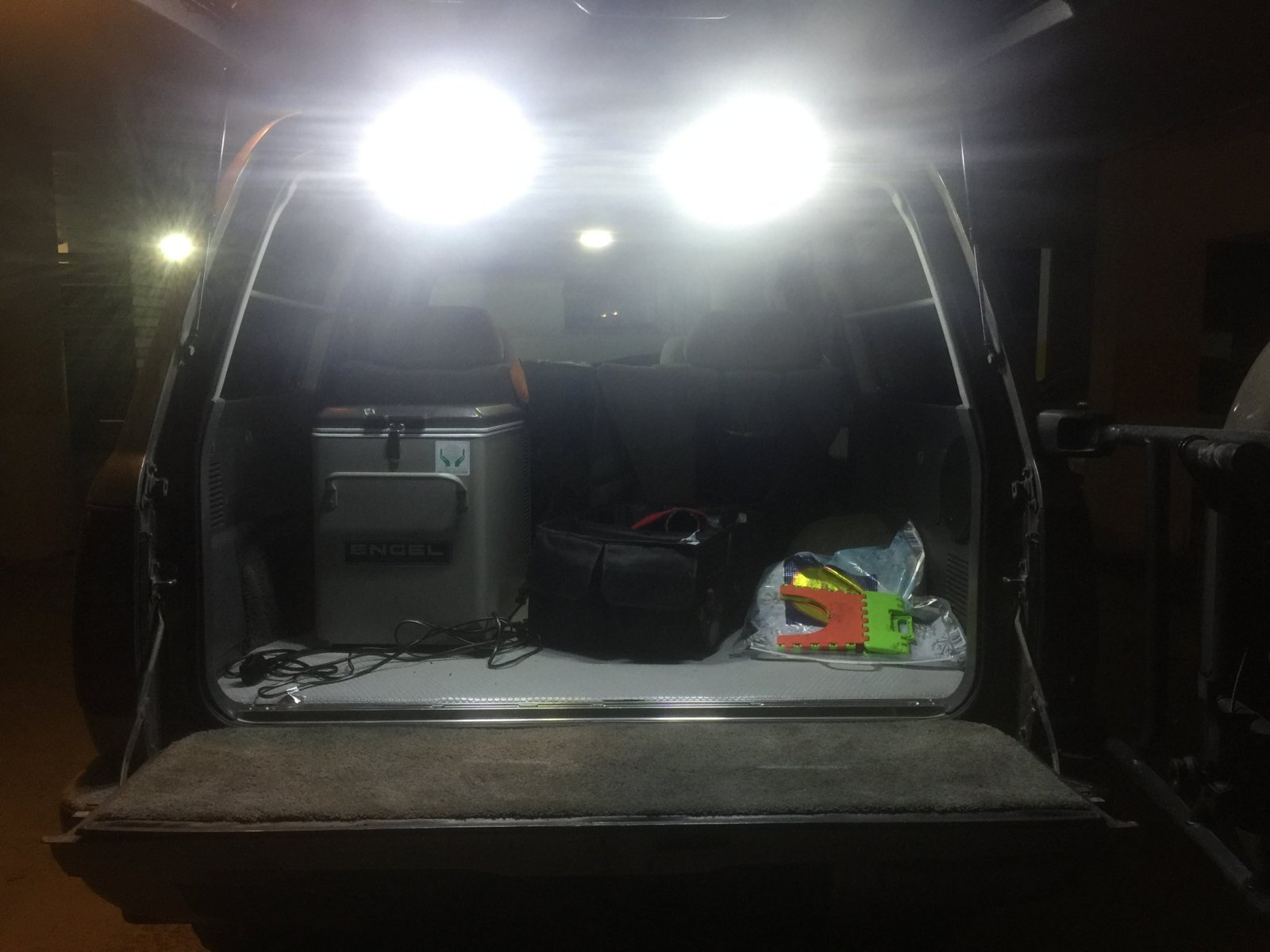

Guys replaced all interior ceiling lights to COB led including addictionally two strips for the tailgate in preparation for the overland build phase one.
Now at night you can call it day....lol

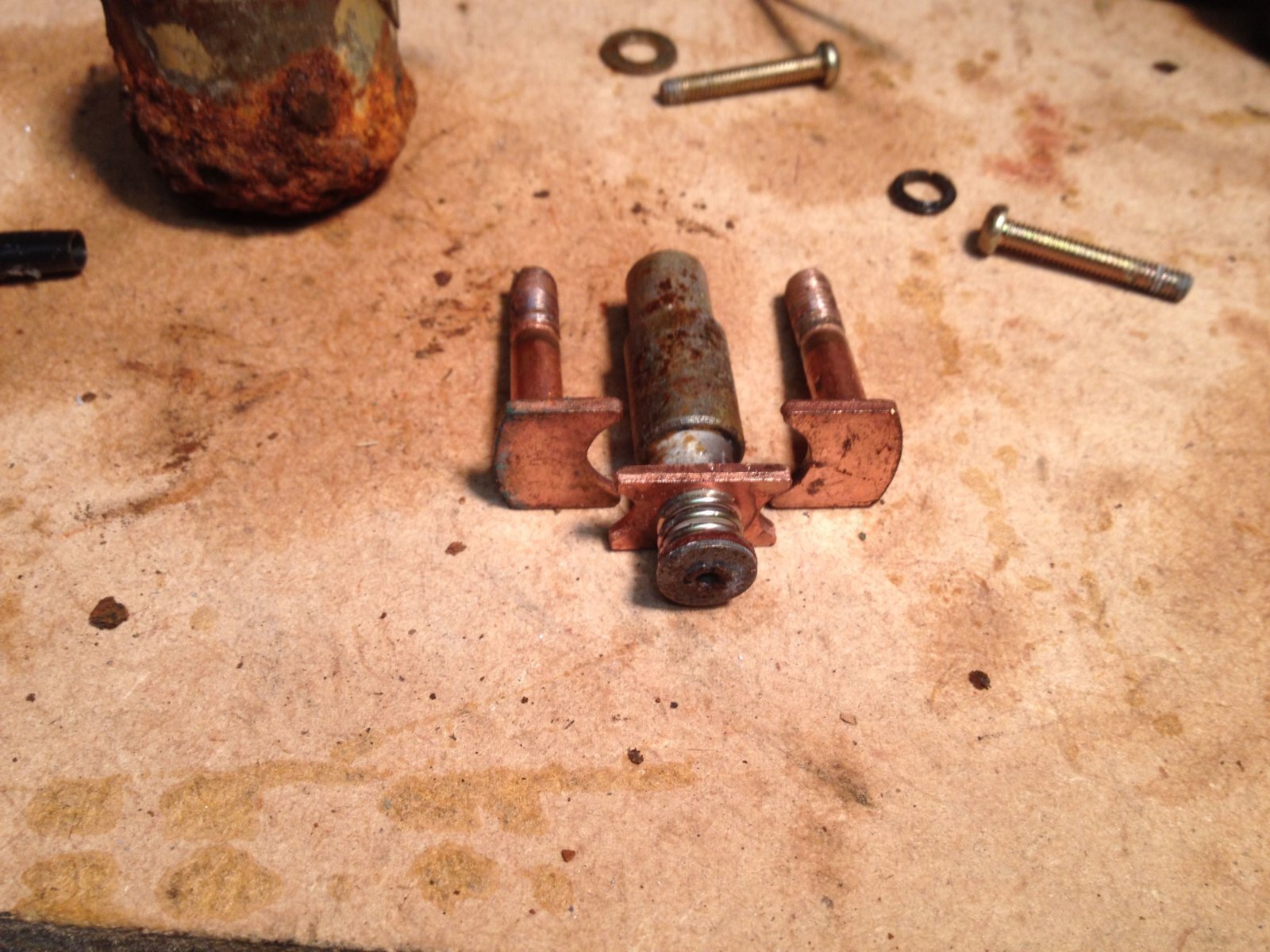

The 80 had been stood all week and came to start it the other day and no working intake heater! It coughed a bit and chugged a bit for the first 30 seconds or so then ran as normal but this could have been more to do with very cold diesel (-9 on the ext thermometer).
Anyhow had a look today and the relay has obviously been steadily rusting away in it's little rubber boot. Picked a new one up at the local bike shop and all good again. The relay contacts were perfect so obviously no problem handing the 45-50A or so current draw.

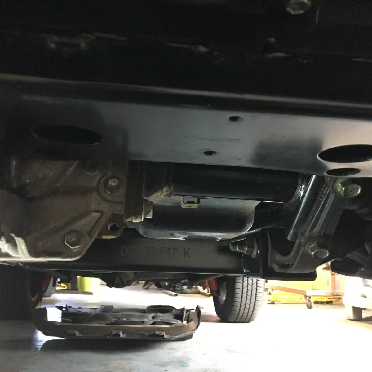

Finally found some time to bin the AHC today, have had the parts sitting around for a while now. The ride quality is fantastic and if I had known I would have done it earlier, the AHC was all in good working order but struggled to keep the rear up whilst towing a boat back from Wales last year. With a repeat trip coming up shortly I thought it was time. Decided to go up a tyre size whilst at it.
View attachment 142243 View attachment 142244 View attachment 142245
Let me get this straight Heaumey, is that a photo of the underside of your 2006 Hundee?
If it is, then jeez, it looks newer than new, still under 50k on the clock?
:clap::clap::clap:

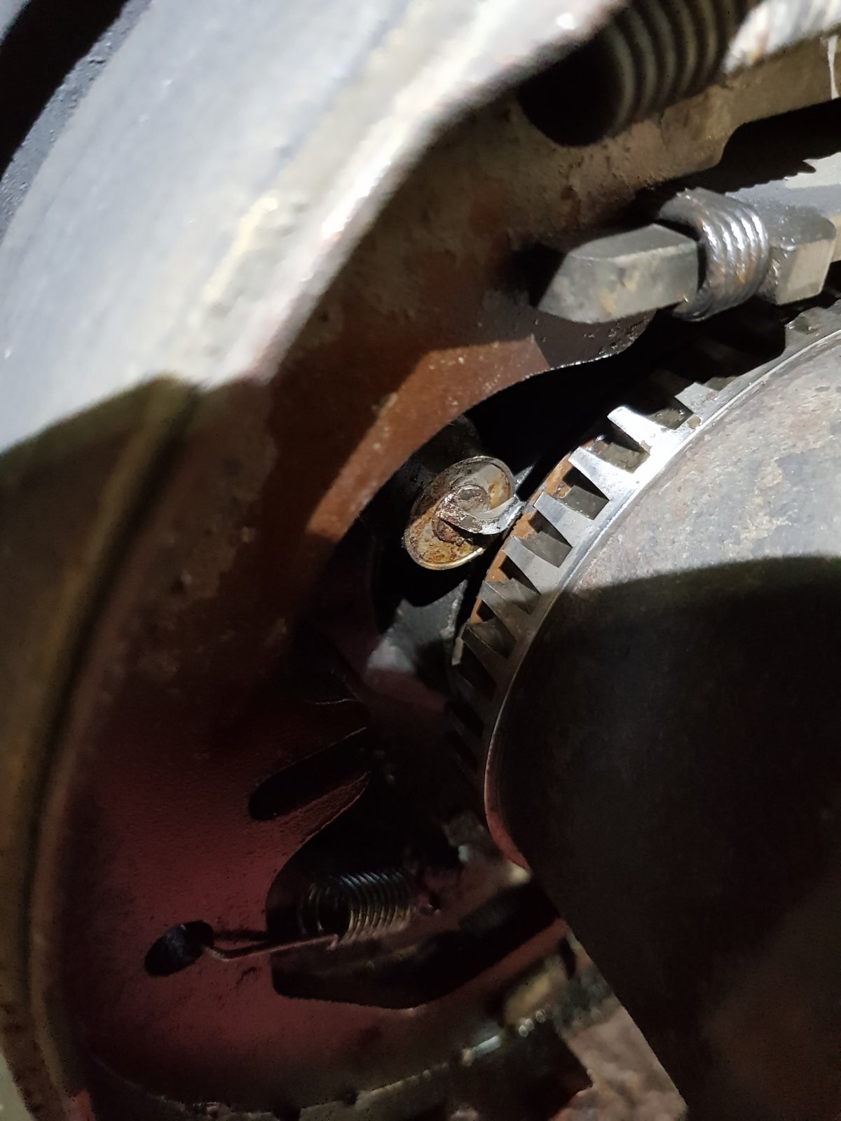

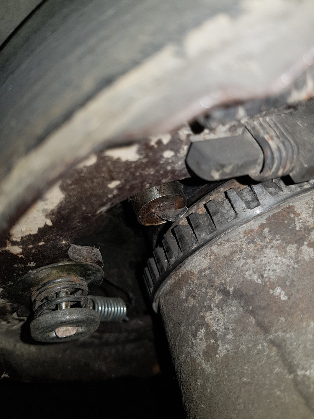

The last few weeks my abs has been kicking in when it shouldn't. Last week I removed and cleaned the front sensors but no difference so with a little direction from Trev I read the codes and that pointed at rear drivers side. I hadn't pulled the back ones as the bolt to take them out looks a little tricky to get to. Today while changing the tyres over for lincomb I thought, ah, I'll take the drum off and have a look.
The do hicky that holds the rear break shoe in had come off. Spring and big washer were sitting in the bottom of the drum and the retaining clip was stuck to the sensor.
The end of the sensor has been mushed, guessing the clip got wedged in there on its journey there.
New sensor ordered.
