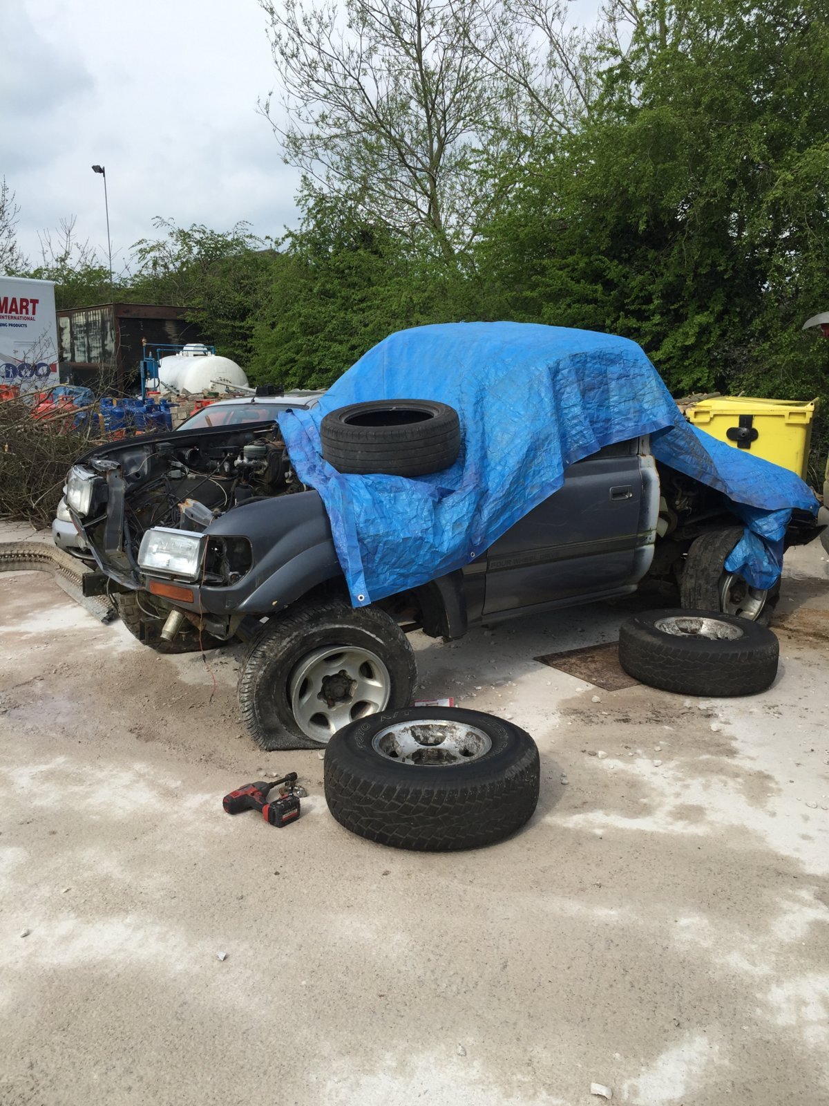

    Busy weekend sorting a guys yard out.
    Time to drag this sorry looking project out to get some more done on it.

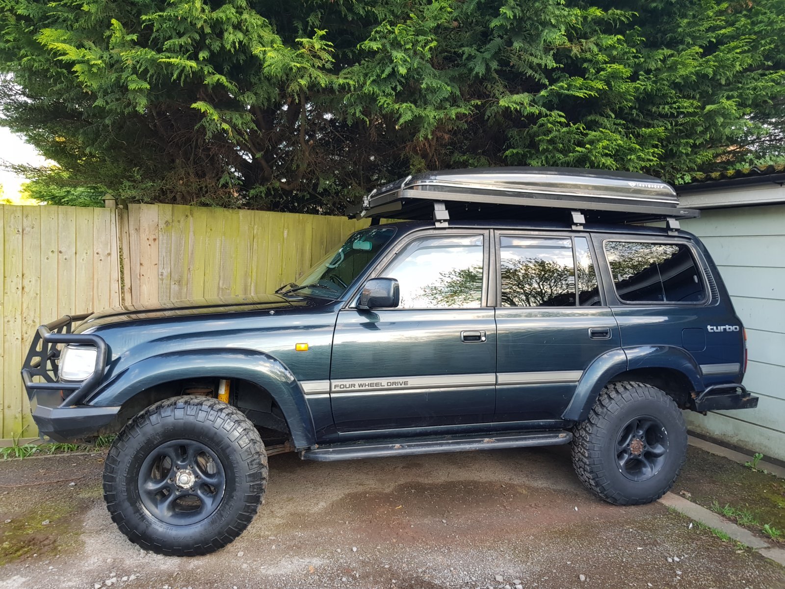

    We like a nice roof tent. Hey, is that the standard size or the MINI?

    Well it's the standard Mini size (which according to the label inside is a small)

    They're a good little roof tent. We've got one propped up on Its side in the valet bay!! I Want it but no one can decide what's happening with it.
    I'll wait for it to 'fall over' and get damaged then Do them a favour and dispose of it.
    Did a few bits to the 80 today, took the roof rack off, fold down table and mount off, fresh coat of paint as looking tired. Need to so the same with the sliders and winch mount.
    Will polish the roof while the rack is off.
    Repaired some rodent damage in the engine bay, re fitted the drawers and gave it a wash. Fallen out of love with it recently tbh and it's been neglected. Interior is a state and the paint rough and dull. We're making up though. Lack of free time hasn't helped.
    Few other jobs to get sorted for a long weekend in the Dales at the end of May.
    It'll be back on top by then.
