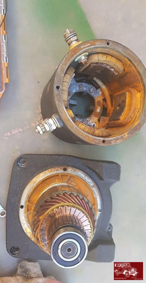

    Went out to tension my winch rope today and she didnt turn. Worked out it was the motor and when I stripped it down there was a lot of rusty sludge in there. Anyone have an ideas on the best way to rectify this mess? Worst part is I have yet to use it in anger!

    Depends how bad the corrosion is and what parts have actually corroded. I rescued a starter motor many years ago from similar circumstances using some alloy wheel cleaner which is very mildly acidic and did a pretty good job of removing the sludge and rust staining. When it’s cleaned out and completely dry I would check the electrical integrity of the windings as well as making sure the whole thing is structurally sound with no bearing damage etc.

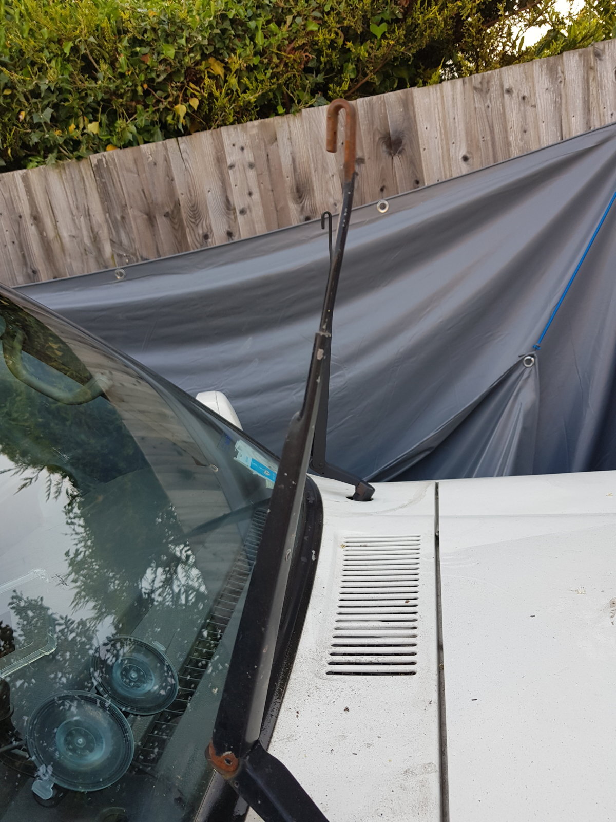

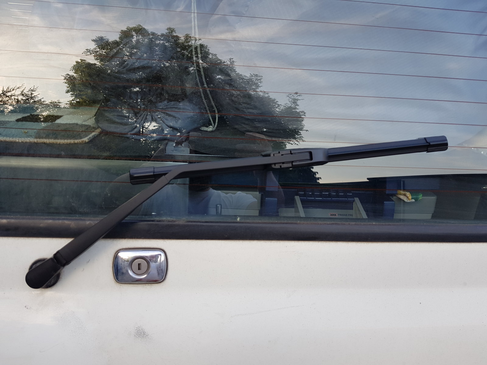

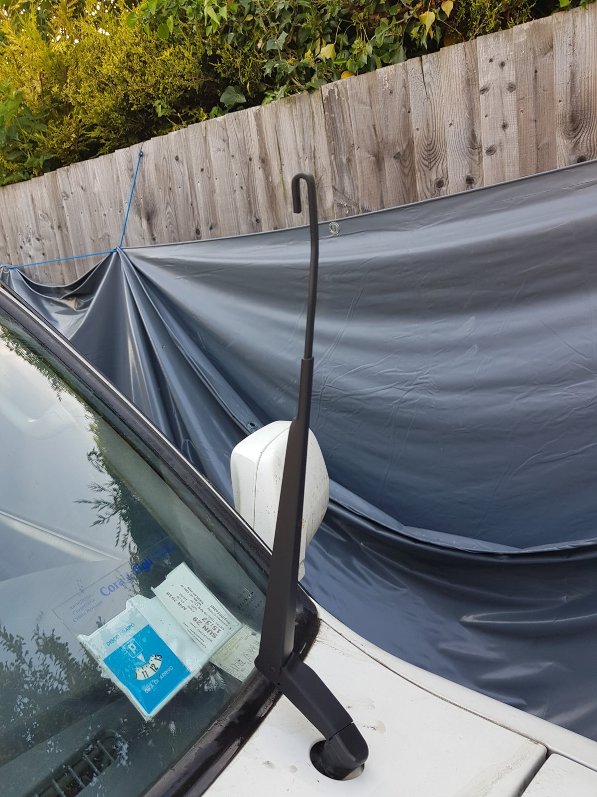

    Wiper replacement...and related corrosion removal!

    Just rubbed down and sprayed :thumbup::thumbup:

    I always put a large cloth on the windshield when the bare wiper arms are tensioned like that.
    I've never broken a windshield but I'm sort of paranoid :doh:.

    That's could be a good excuse to replace it :icon-biggrin::icon-biggrin::icon-biggrin:
    Mah... honestly I never had problem with that...:dance:

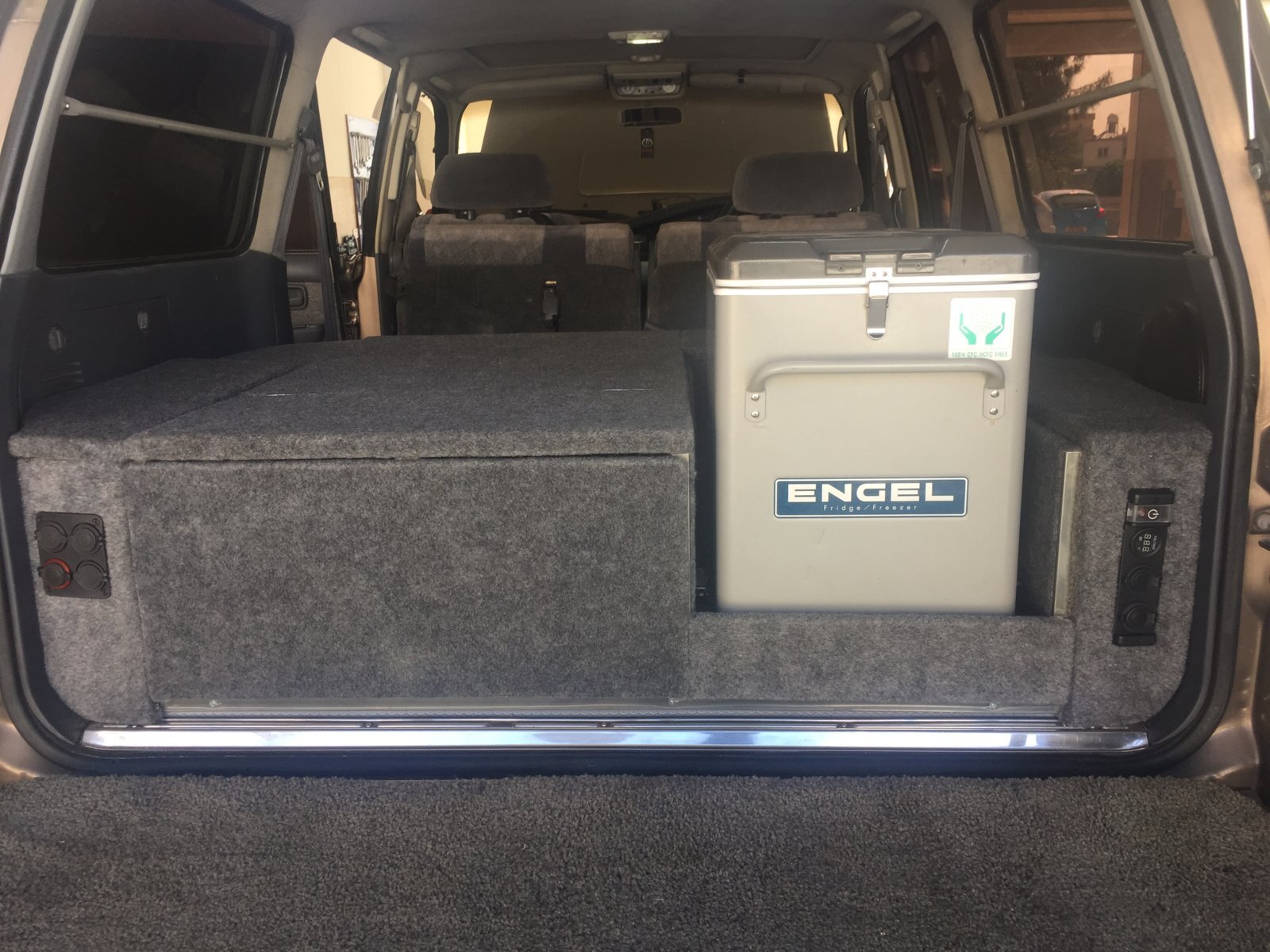

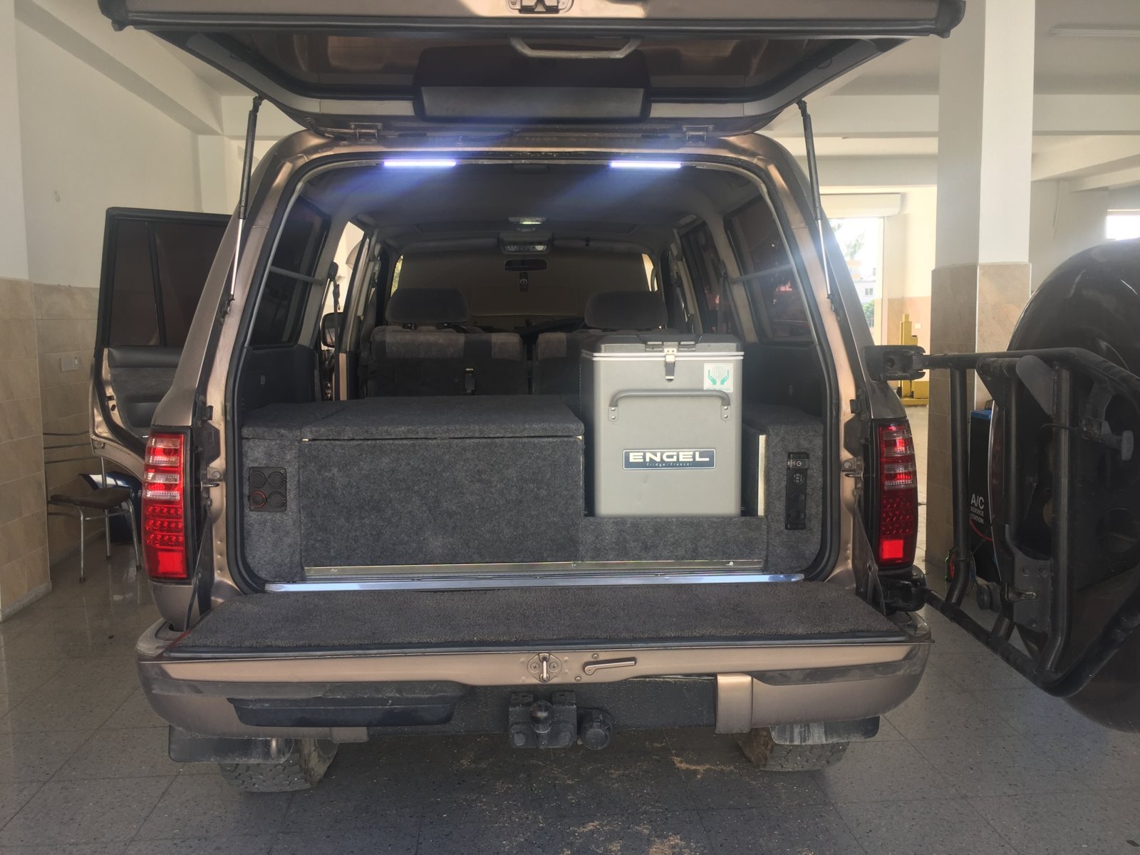

    Guys major step forward towards finishing off the electrical side of the rear draws.
    Fridge up and running. Testing phase has begun.

    Re-installed the winch , works mint! Thanks for the tips. Put her in today for Transmission service, I haven't driven it myself . The wife hasn't noticed any difference.
