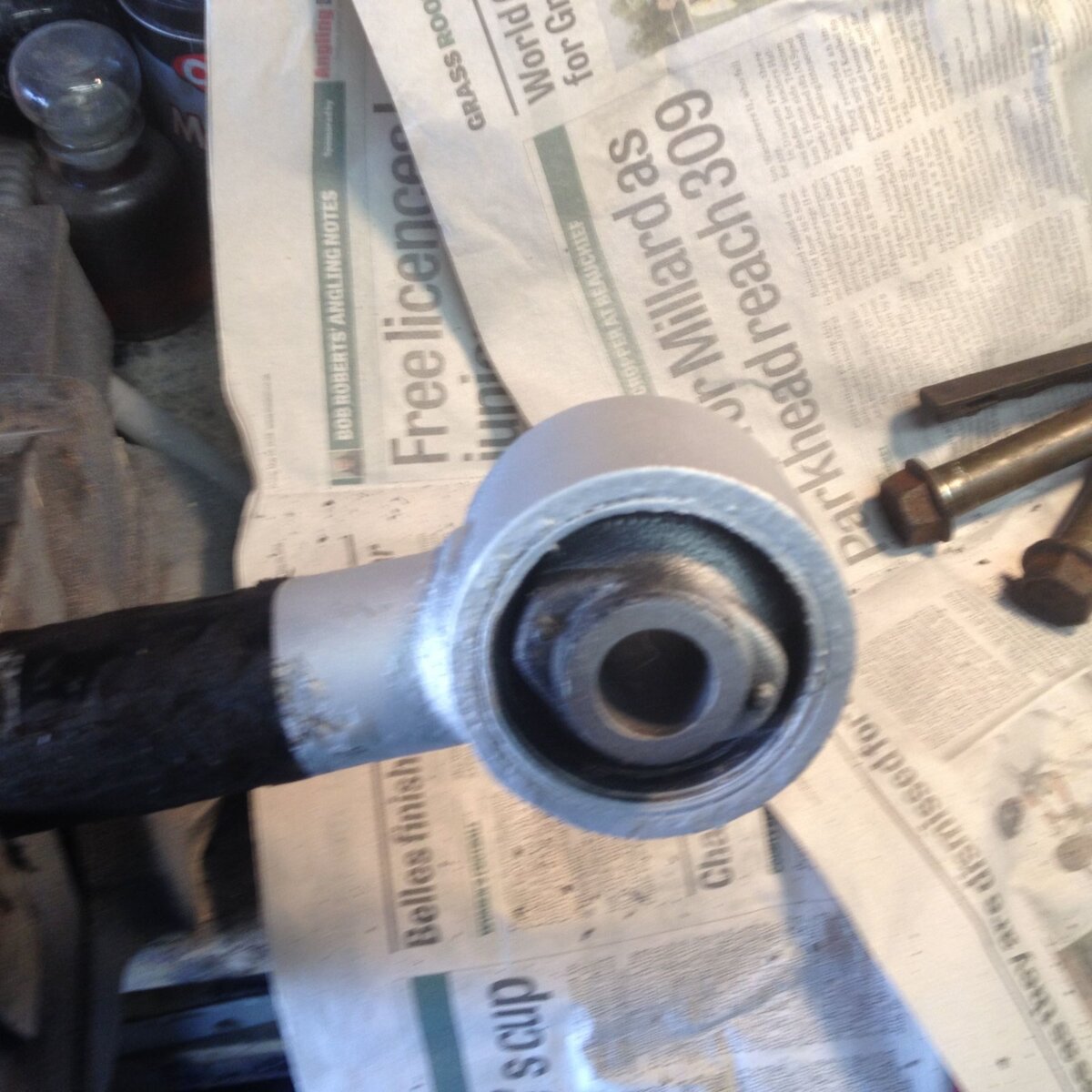

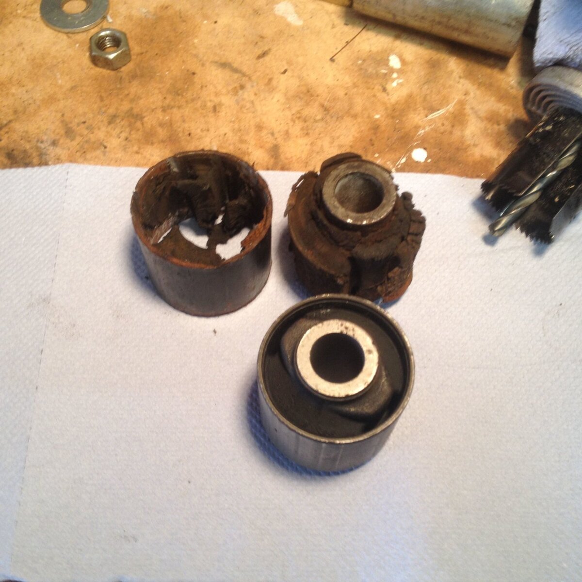

    Rear control arm bushes replaced. What I thought would be the difficult bit, bolt removal, was a breeze. Just a bit of surface rust on the heads and the bolts tapped out easily. The insides of the mounts on the chassis and axle were also virtually rust free, due I think to the oil Ive been squirting in there periodically.
    The rear passenger side bush was shot, the rubber had come unbonded from the steel sleeve and pushed out quite easily. Cut the rest out with a hole saw. Cleaned up the arm ends and a coat of AC90 zinc paint and black stone chip finished the job. Going on the state they were in I think I'll work my way round the whole truck and change the lot. Rear upper arms next. Apologies for the blurred phone pics. Heat haze I think!

    Good job Phil.. one of the next jobs on the cards for mine! May fit the spare arms from the 24v as they seem good..
    Like your method of pulling the new bushes in!
    Will be off to the post office tomorrow when the paints dry!:thumbup:

    The job went easier than I expected Iwan. The recommendation seems to be to use a hydraulic press which would probably be a whole lot quicker/easier but I don’t have one so had to make do. The tricky bit is getting the new bush started while keeping it square.
