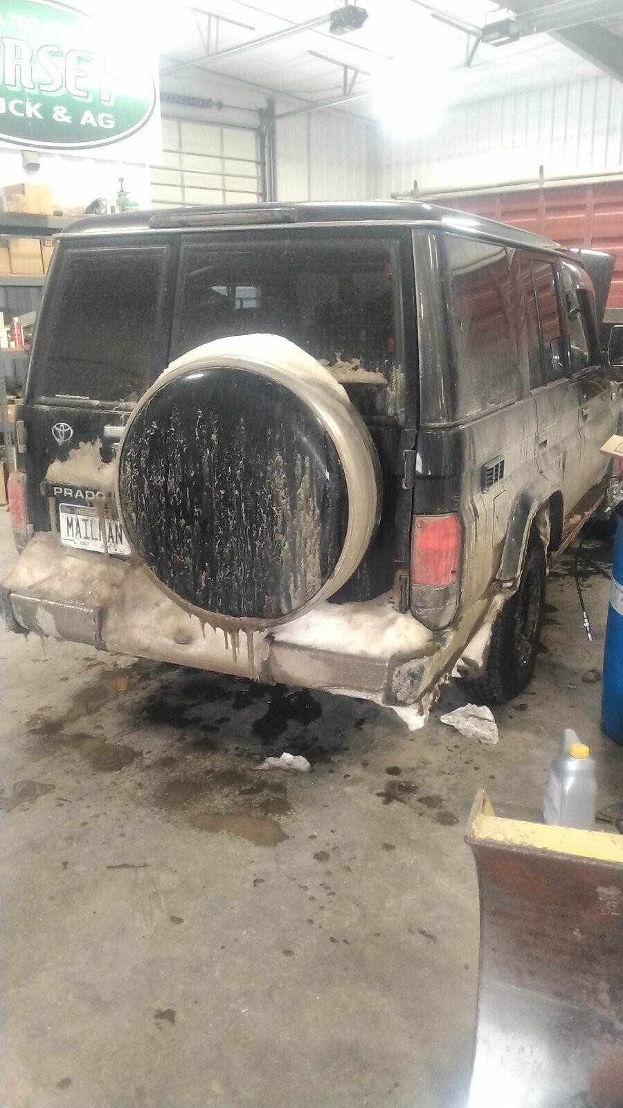

It's been cold here lately, -20 F this morning(not sure what that is in degrees sCience) so my brother took pity and let me park in his heated shop for the night. Gave her a once over checking fluids, tires, etc. Drained the water separator. Now I'm letting it thaw out and make a mess all over the floor!
So far I haven't had any trouble with starting in the cold or with fuel gelling. I've been using Schaeffer's Diesel Treat 2000 curious what others are using and if they have trouble in very cold conditions.
