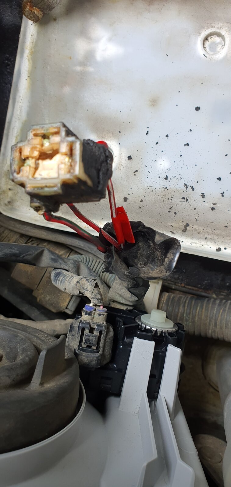

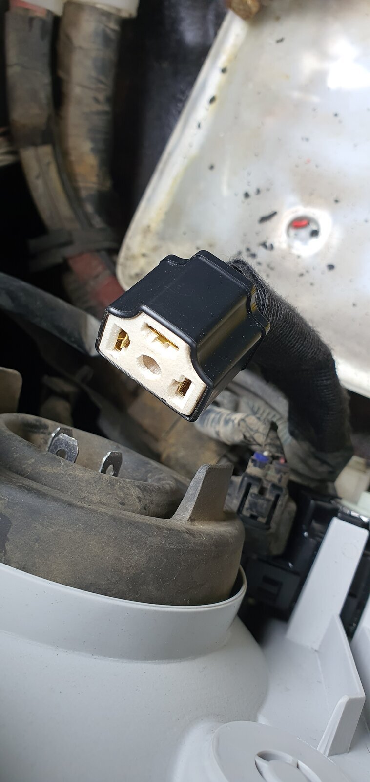

Replaced knackered H4 headlight connectors.
