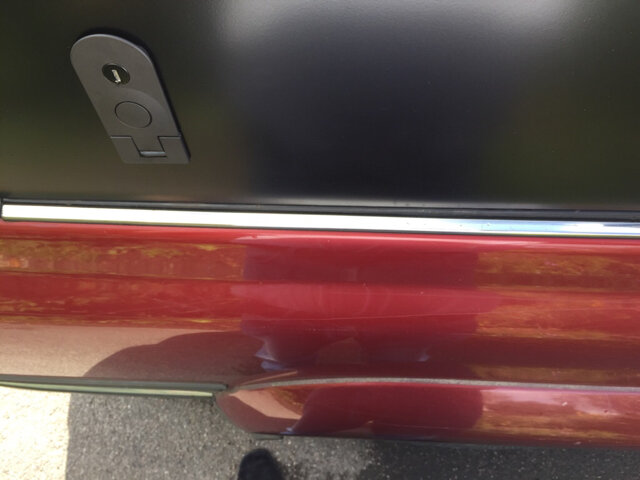

There really isn't a sensible way that a proper fit can be made that isn't better in all respects and more cheaply done by the OE fixed window rubber. This design allows for the flush fitting as shown, whereas even if the sliding system could be made to work, it would offer a gutter for water to collect.
I can happily supply the doors as shown but a rubber will be necessary. This has the benefit of removing the corroding ally section in the sliding windows and being totally reversible.
