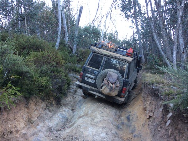

    Great pictures Ben - been a bit lazy getting my pics to you which I will do now as we have good internet access at long last. We really enjoyed the trip with you and lex

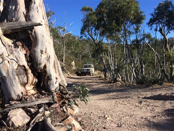

    I went over to the guys in the mud and asked whether they wanted to continue going downwards or needed help . He shouted to the other driver to put the recovery strap around the tow ball.....we retreated to a very safe distance. But they did a good pull at the second attempt and he got out.....Ben saw the doors open a load of stinky mud fall out
    The nice panoramic views were from the fire tower on a beautiful day.
    It was a great w/e -loved it!

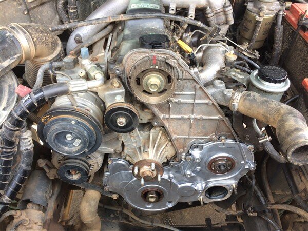

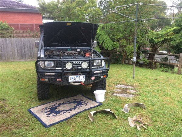

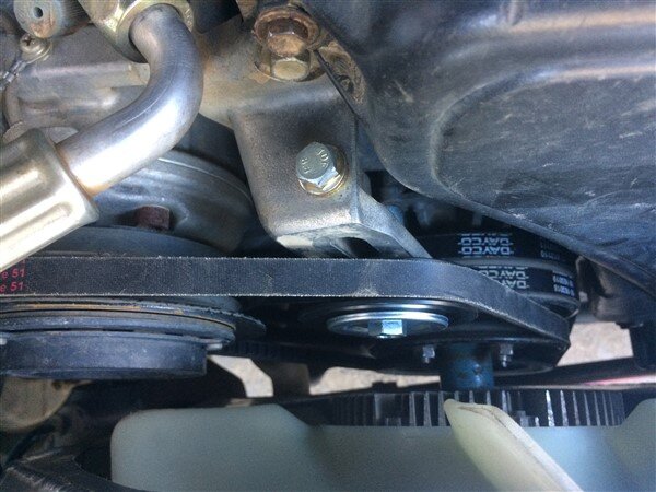

    Time for an update......................

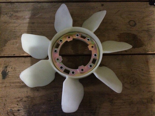

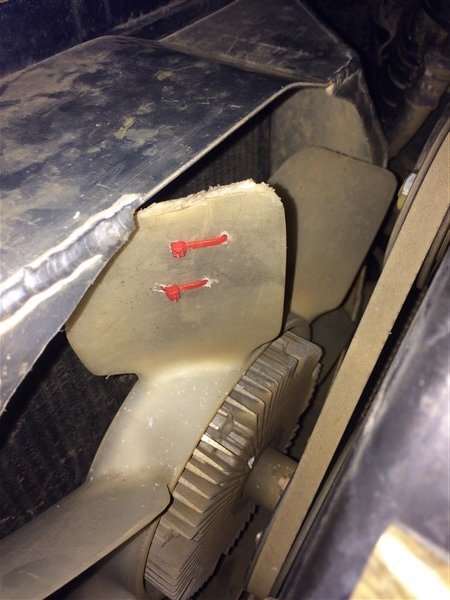

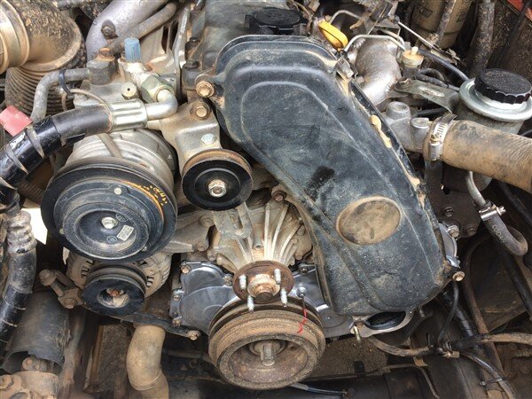

    Just before my last trip I had noticed my visous fan was cracked and had a few bits missing. :thumbdown:
    Obviously from hitting water crossings a bit fast in order to make a big splash for the camera. :icon-redface:
    So I had made a temporary repair using cable ties. :shifty:
    Then while on that trip I was intermittently loosing power steering and the steering would go very heavy. :wtf:
    It made the trip and kept its record of being a 100% reliable vehicle but obviously needed fixing.
    So I decided it was time I spent some dollars and show it some love. :icon-cool:
    I bought a new fan and a timing bet kit as the last time I changed the timing belt was 7 years ago.
    And just before Christmas I made a start stripping it all down.

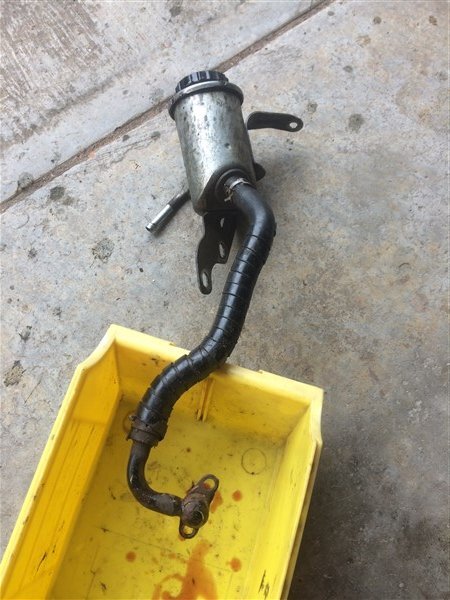

    I was expecting to have to rebuild the power steering pump, but the issue proved much simpler than that and had I diagnosed the cause on the trip I could have fixed it.
    One of the bolts that holds the hose fitting to the pump had been lost and the other one was loose.
    So I bought a genuine O ring and found a suitable length M6 bolt and that was that fixed. :dance:
    From that point on things didnt go to plan..................

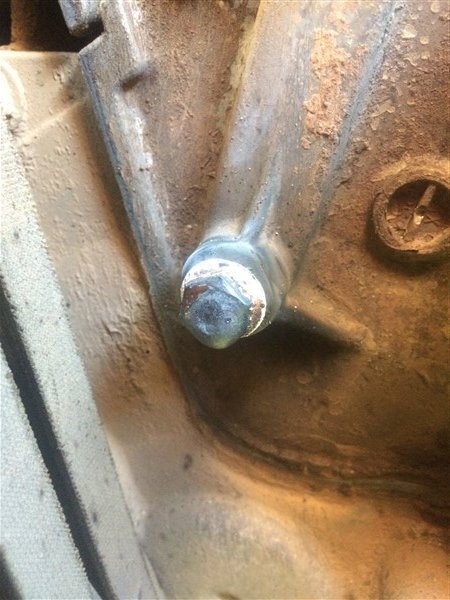

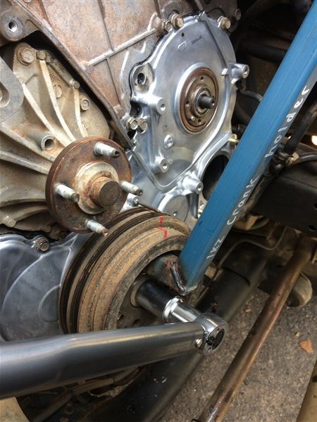

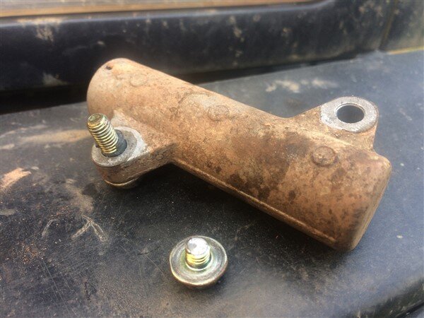

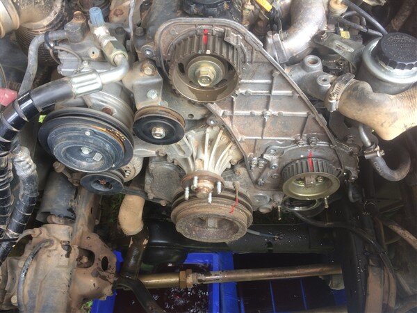

    Whilst changing the timing belt one of the M6 bolts that hold the hydraulic tensioner on sheared off in the engine. :angry-screaming:
    When I last changed the timing belt I foolishly drowned all the bolts in locktight. :icon-redface:
    I tried turning it with vice grips but that didnt work so then I resorted to welding a nut on.
    Sadly that just resulted in it shearing off flush. :icon-mad

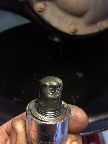

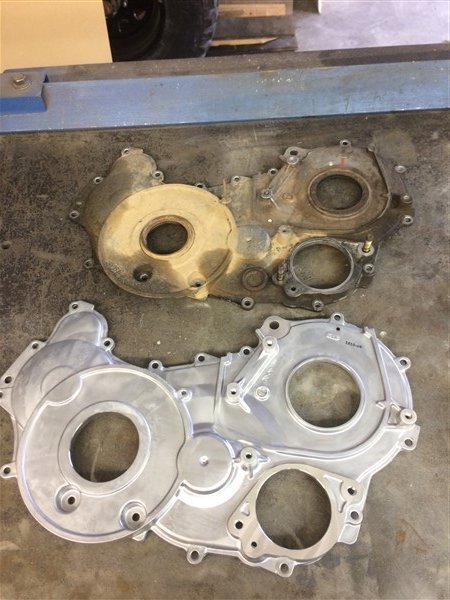

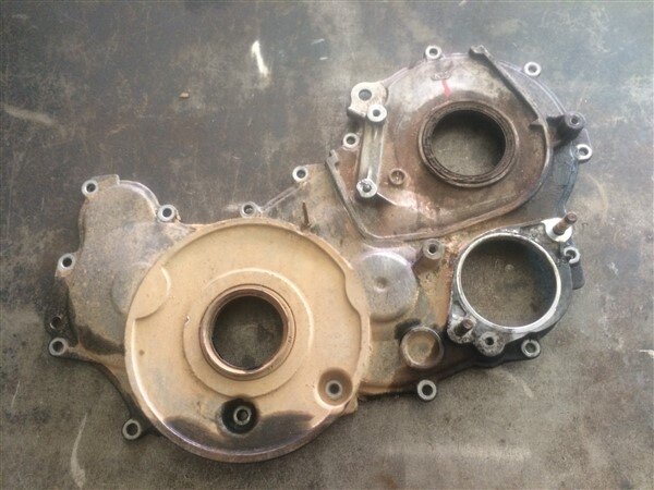

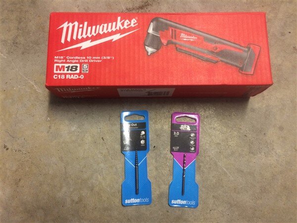

    So not wanting to remove the grill, radiator and all those bits I went out and bought a right angle drill and an easy out (damaged bolt remover).
    Annoyingly the evil out snapped off leaving a piece of its hardened steel in the bolt. :angry-banghead:

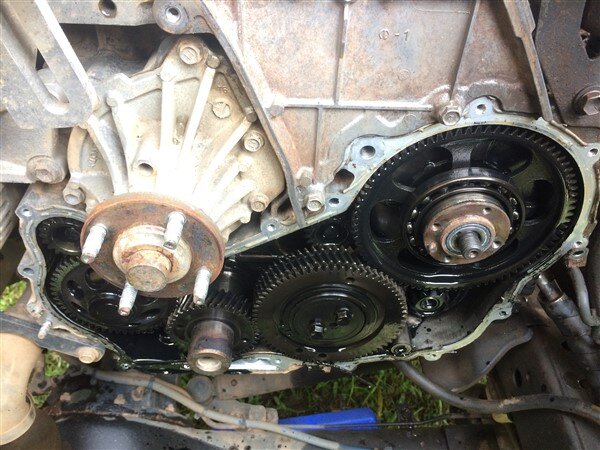

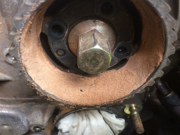

    So then I had no choice but to strip it all down in order to remove that section of engine casing in order to replace it.
    Found some Lincomb sand in one of the pulleys from when I drowned LJ 8 years ago!

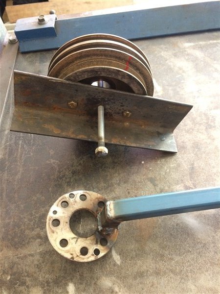

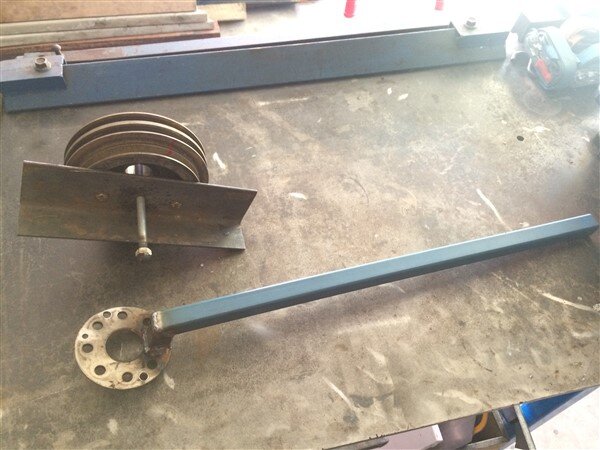

    I had to make some tools like the ones in the FSM, one to hold the bottom pulley while removing the nut and another to pull it off.

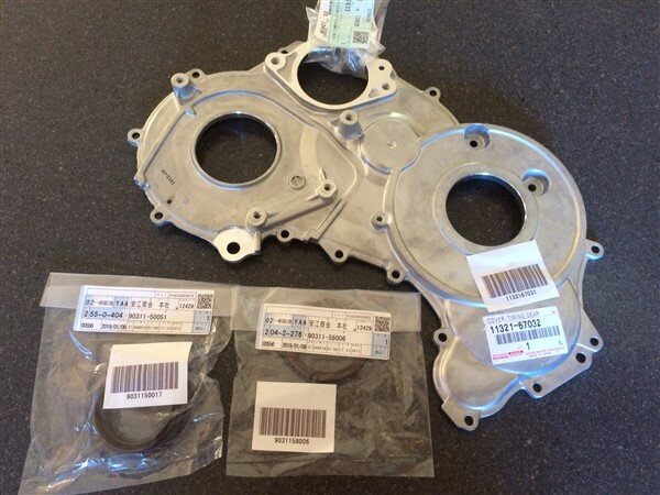

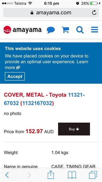

    Normally I use Amayama when importing genuine parts, but as I was desperate for the replacement casing section I used Megazip as in the past I found them to be a lot quicker.
    Well that was a mistake. :|
    I ordered just before Christmas and it took a month to get here when they estimated it would take 10 days. :angry-screaming:
    I should have saved some money and gone with Ama. :shifty:
    So anyway.....................eventually it arrived complete with new seals! :dance:

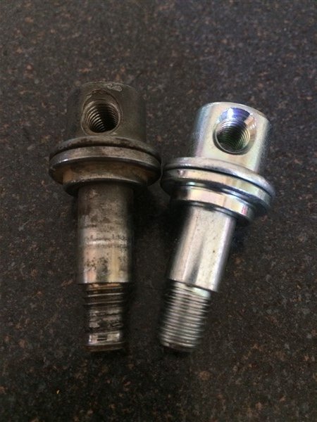

    Comparing the 2.

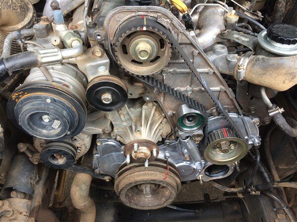

    Bolted it on.

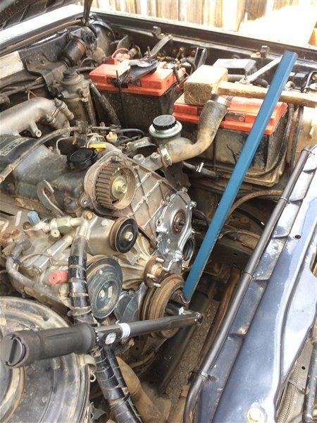

    Torqued the crank pulley bolt up.
    Timing belt went on next.
    Followed by the cover.

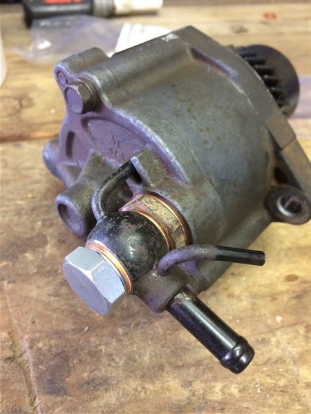

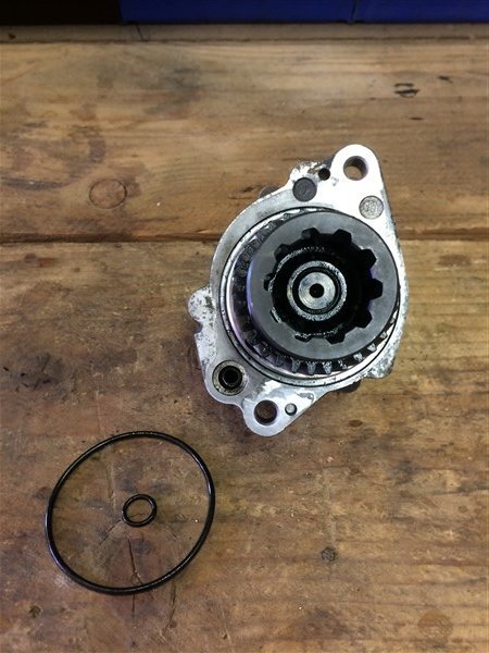

    Next the vacuum pump needed to go on, but it would need new O rings, which I'd forgotten to order. :doh:
    Got new O rings from my local bearing shop, not genuine but very cheap and exactly the right size.

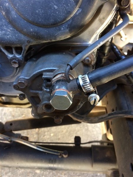

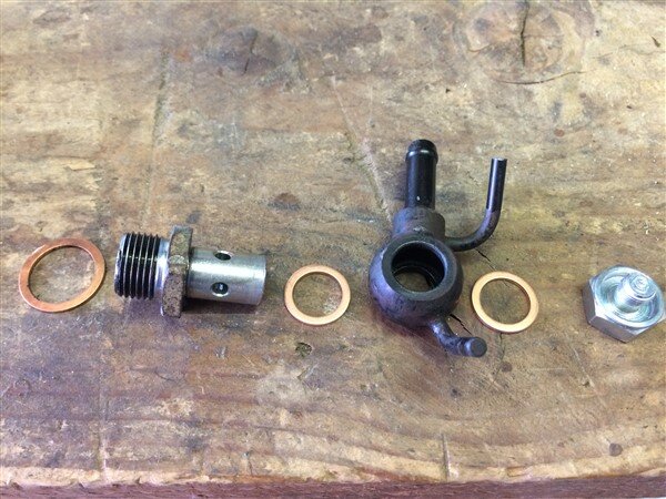

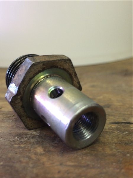

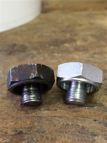

    Went to do the power steering hose fitting up only to find the nut wouldnt go tight and had cross threaded! :icon-rolleyes:
    I couldnt find a part number for the fitting the bolt screws into but I could find the part number for the bolt so I ordered a new one of those and hoped it would screw in.
    Unfortunately the thread in the fitting was too damaged and I didnt want to force it.
    Not a problem I will buy a tap and re-cut the thread.
    Well I knew it was an obscure size as I measured it as 9mm and my local engineering suppliers confirmed it was M9 x 0.75.
    A very odd size and one they didnt carry a tap for. :doh:
    I went to see my local hydraulic hose shop to see if they had any sort of fitting that would work, even if I had to TIG weld it on.
    The guy serving me didnt have a tap that size and was struggling to find a fitting that would work, when one of the other guys who works there came in and by shear fluke he had an M9 x 0.75 tap! :dance:
    He said hed bought a big random assortment of taps from China off ebay for $100 and it had pretty much every size tap available! :icon-cool:
    The guy wouldnt even take any money from me for re-tapping the thread and supplying me with 3 new copper washers! :shock: :clap:
    That all bolted up beautifully! :character-beavisbu:
    And along with the new O rings could be bolted back onto the engine.

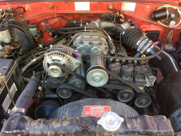

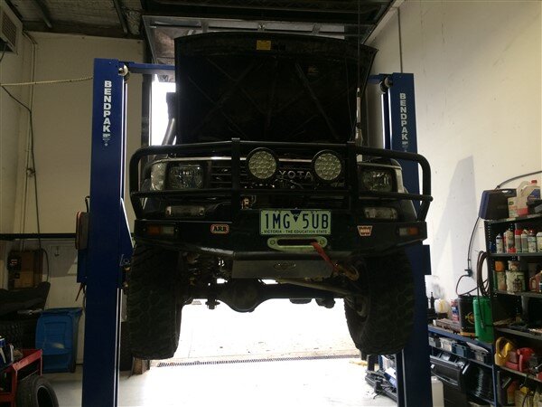

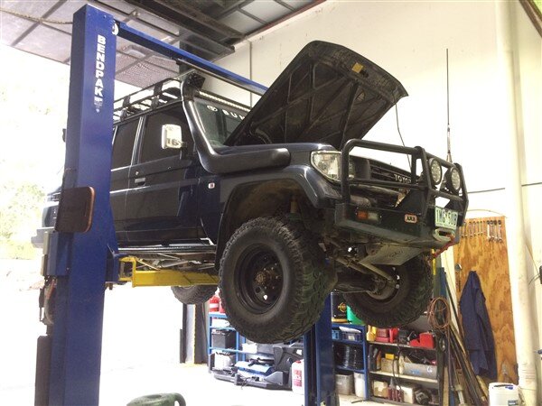

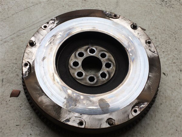

    I put the old fan/ac belts on and drove it around for a few days and it became apparent that the clutch badly needed replacing. :doh:
    So I got it on the hoist at work the Friday before last.

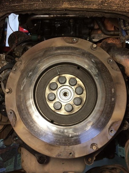

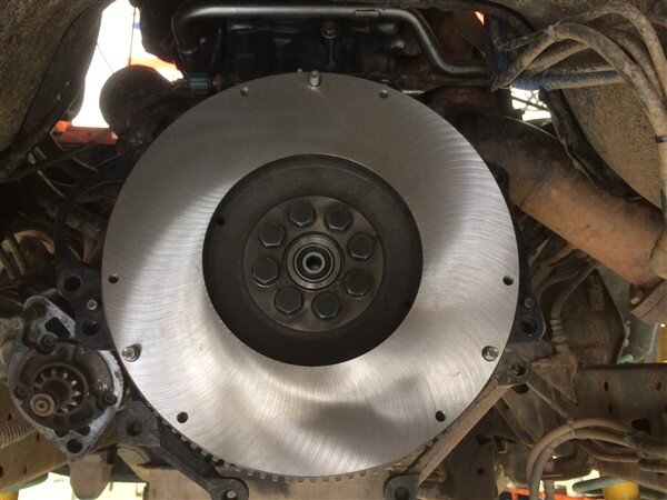

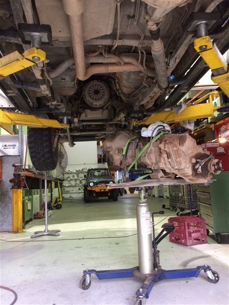

    And one hour later the transmission was out and clutch off! :shifty:
    Much easier and faster than doing it on the driveway!

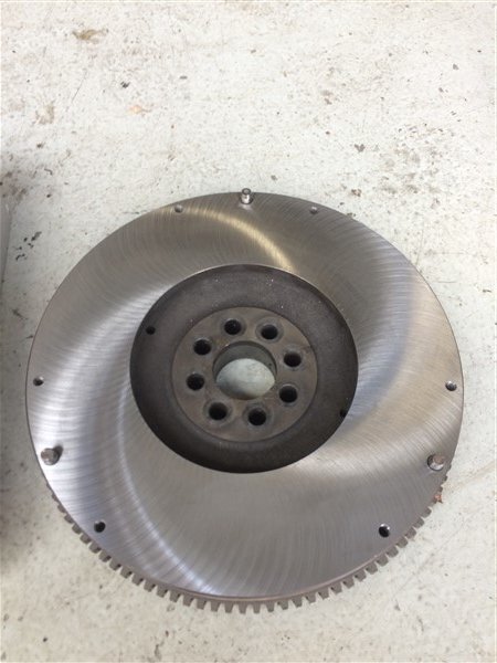

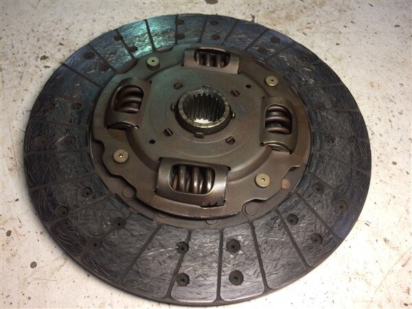

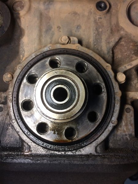

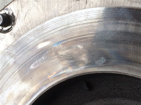

    Flywheel had a few hot spots.
    The rear main oil seal looked like it had been weeping slightly.
    So at great expense I bought one from my local main stealer.
    Fitted it.

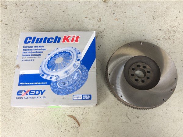

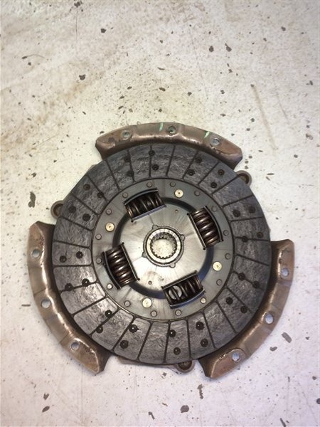

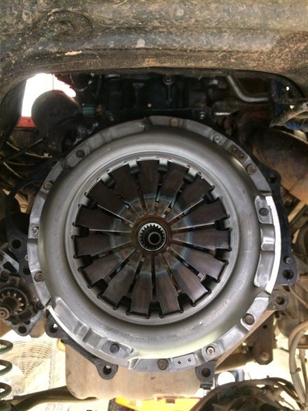

    New clutch kit and nicely machined flywheel.
    Its 8 years since I last changed the clutch and that was when I originally fitted the 1Kz engine into LJ! :think:
    And that was an Exedy clutch so I figured if it can take 8 years of heavy off road use and abuse then I will fit the same again! :icon-twisted:
    Every component in the box was made in Japan. :clap:
    Bolted the flywheel on.
    Followed by the new clutch.
    And then got the transmission back on.

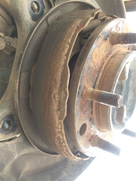

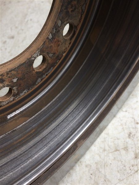

    While it was on the hoist I also investigated the poor handbrake and discovered one side was not healthy at all! :doh:
    The shoes were destroyed.
    As was the inside of the rear disc brakes which they run in. :icon-evil:
    Drum brakes are absolute bull shit they really are, I hate them! :angry-cussingblack:
    So I'm going to fit some proper hydraulic rear brake calipers that have a cable handbrake mechanism on them! :icon-twisted:

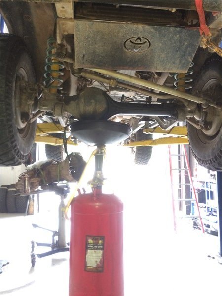

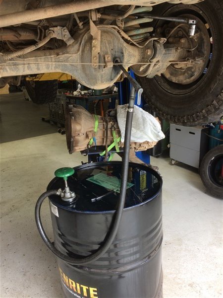

    While it was on the hoist I also took the opportunity to grease all the UJ's on the props and change the diff oils.
    Very fine swarf but thankfully no lumps of metal.

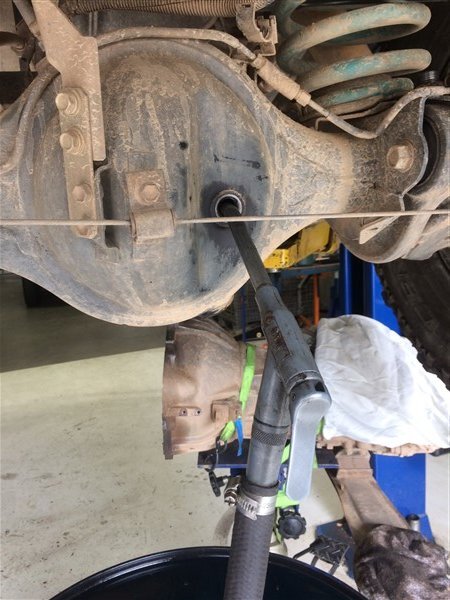

    The diff gears have run in beautifully since I got the diffs rebuilt and front locker fitted.
    So quick and easy to when you can just pump the new oil in.

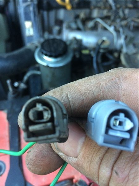

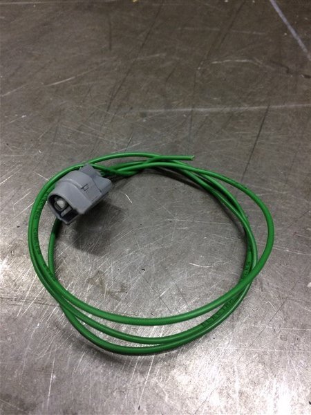

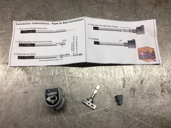

    The plug that plugs onto my temp gauge sender on my engine had seen better days and was no longer making a good connection, resulting in my temp gauge not working.
    So I bought a new pug off ebay.
    Fitted it to a piece of 2mm wire.
    Quick comparison with my old one while fitting it.
    Soldered the wire on to my loom.
    And now my temp gauge is working again! :dance:

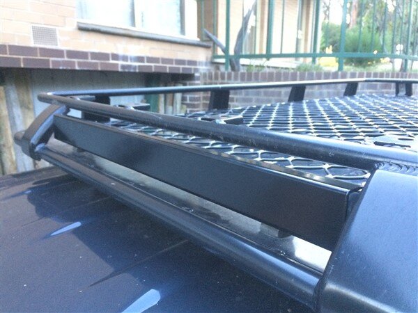

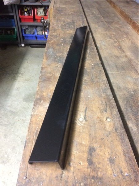

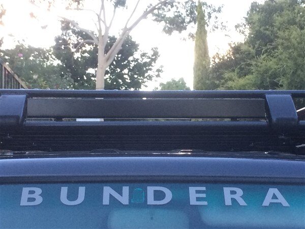

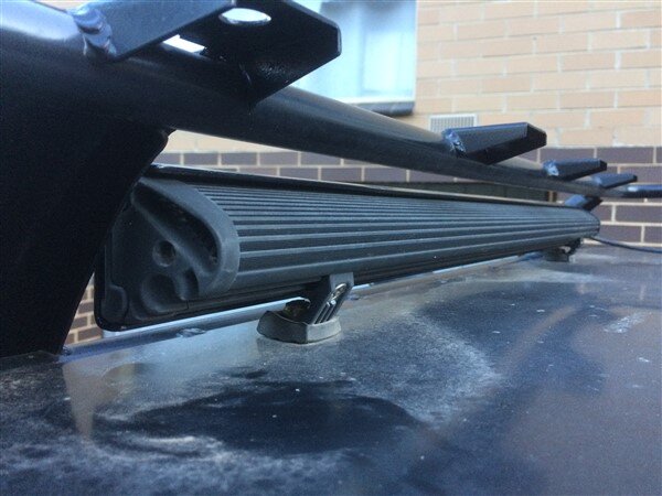

    I folded some 2.5mm alluminium and got it powder coated.
    As roof mounted lights/light bars are currently illegal in my state, its best to have them covered to keep the vehicle legal and avoid any attention from the police.
    It pushes on easily and is a nice snug fit.
    When I do my off road trips I will just remove the cover prior to doing any night time driving.

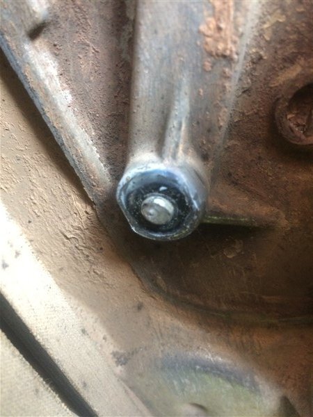

    I went to fit new fan and ac belts, got them on, tensioned all up lovely then found the idler pulley nut wouldnt go tight. :doh:
    I couldnt find the part number for the bolt so had to order a complete unit and for once I was actually surprised by how reasonable the price was for a genuine part from my local main dealer! :wtf:
    It was only this bit I really needed but for the price I was happy to replace everything.
    All fitted! :dance:

    I have to say you’ve been rather unlucky with that bolt Ben. I bet you kicked yourself right to the bottom of your garden and back for that one. You probably know this by now but there two strengths of Loctite, one that can be undone and the other that has to be heated to break the bond. If your luck hadn’t run out that day I’d have thought the heat from welding the nut on would have been enough to break the studlock. I’ve never had any luck with ‘easy outs’ so haven’t used them in years. Drilling out has been most successful but it has to be done dead centre followed by a tap. I’m not sure how this would go on a steel thread studlocked into ally. Difficulty factor 11 I’d say.
    I must say I was a bit alarmed to see the Lincomb sand in that pulley. That means it got into all sorts of places, particularly the timing belt cover, that you’d rather not have something abrasive. So on balance, I’d say changing those seals with the plate was no bad thing. I don’t suppose that bottom pulley gave up the fight easily.
    You learned a lot that day.

    Nightmare with the stripped and snapped bolts,
    I have never had luck with darn Ezi outs either, they always snap and leave even harder bit of steel stuck in place....
