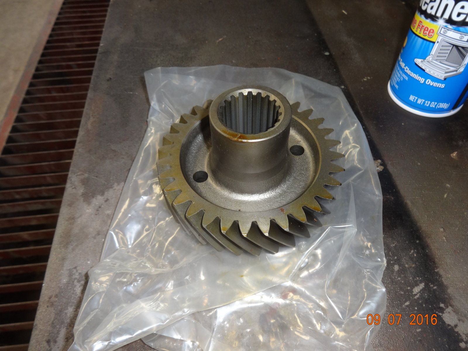

The transfer case input gear has a spacer in between the PTO gear. The fix eliminated the spacer and combined it with the gear. So the spline where the spacer seats is good as new and will help in reducing the play back to normal. I don't know how long or how strong it will be. But that is the alternative to removing the transmission output shaft.
One I saw was a welded gear and the spacer together with the PTO gear.
This came in from the land down under. The transfer input gear. Got the transfer case parts ordered and still waiting for the others to arrive.

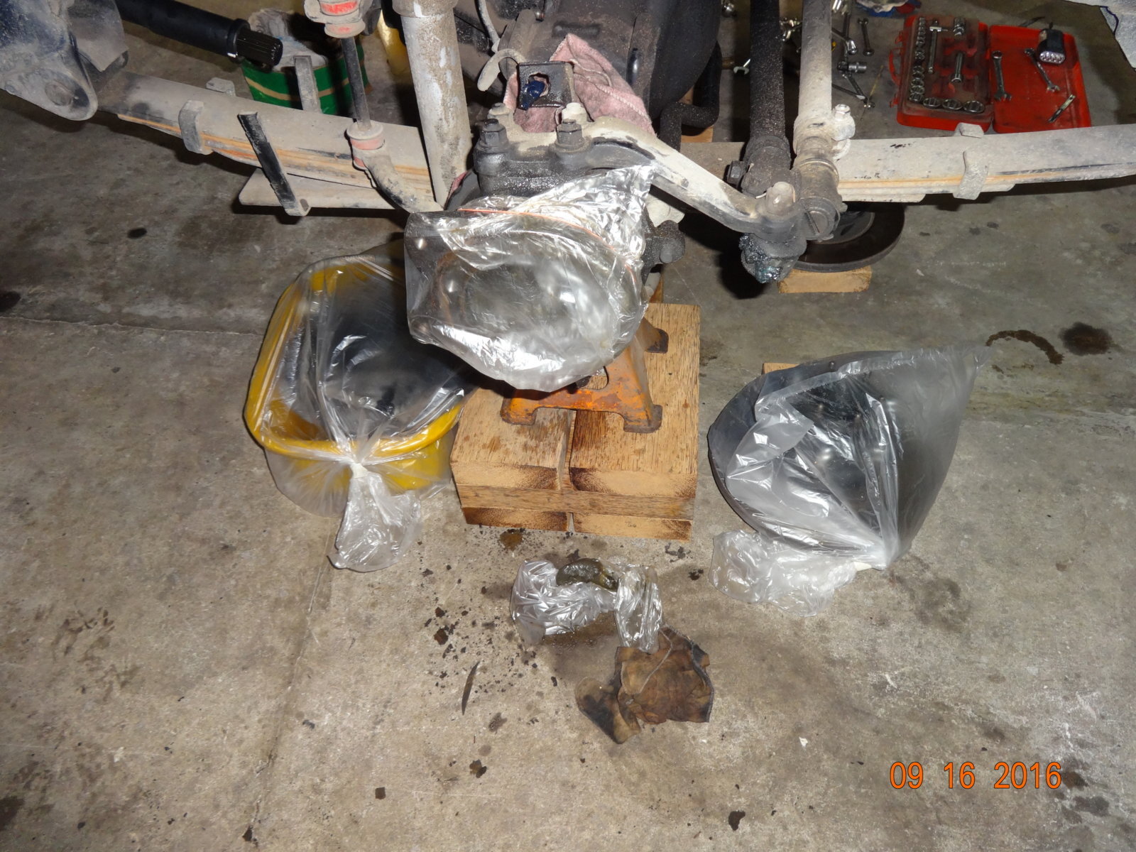

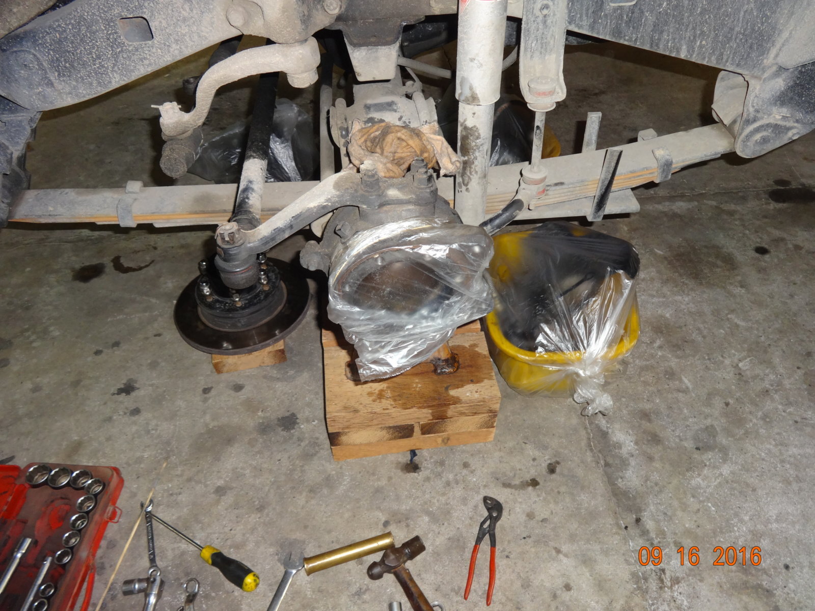

I just had to check on the front differential again as I am not satisfied on the performance.
Interested to see the findings of the front diff investigation.
As for the rest, everything to your usual high standards, very nicely done Oding. :thumbup:
I got the front differential in, finalizing front axle.
I think the previous owner swapped the front differential to the rear and vise versa. The play was way off specs. The only problem was the side gear thrust washer. since I am not setup for off road but more on the overland, I just replaced the thrust washer with an old one I had. Got the play within specs now. By the way, both front and rear differential are Limited Slip or LSD.
