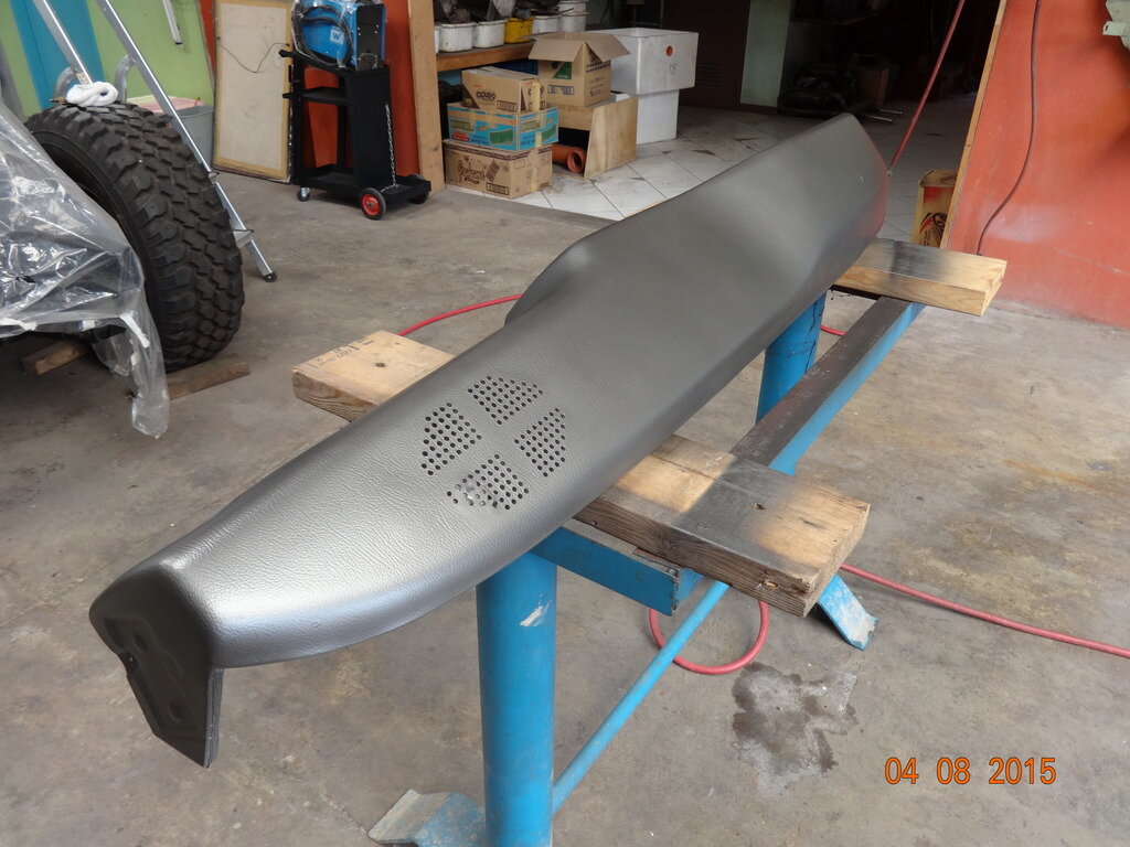

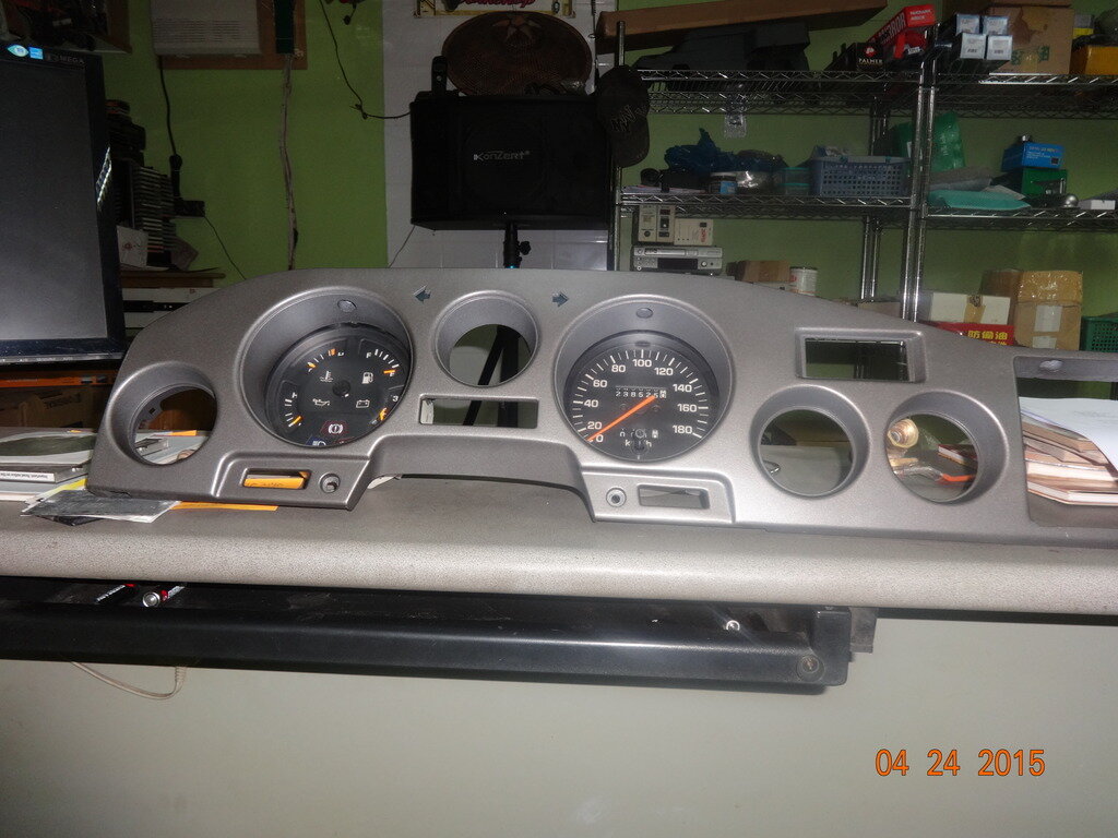

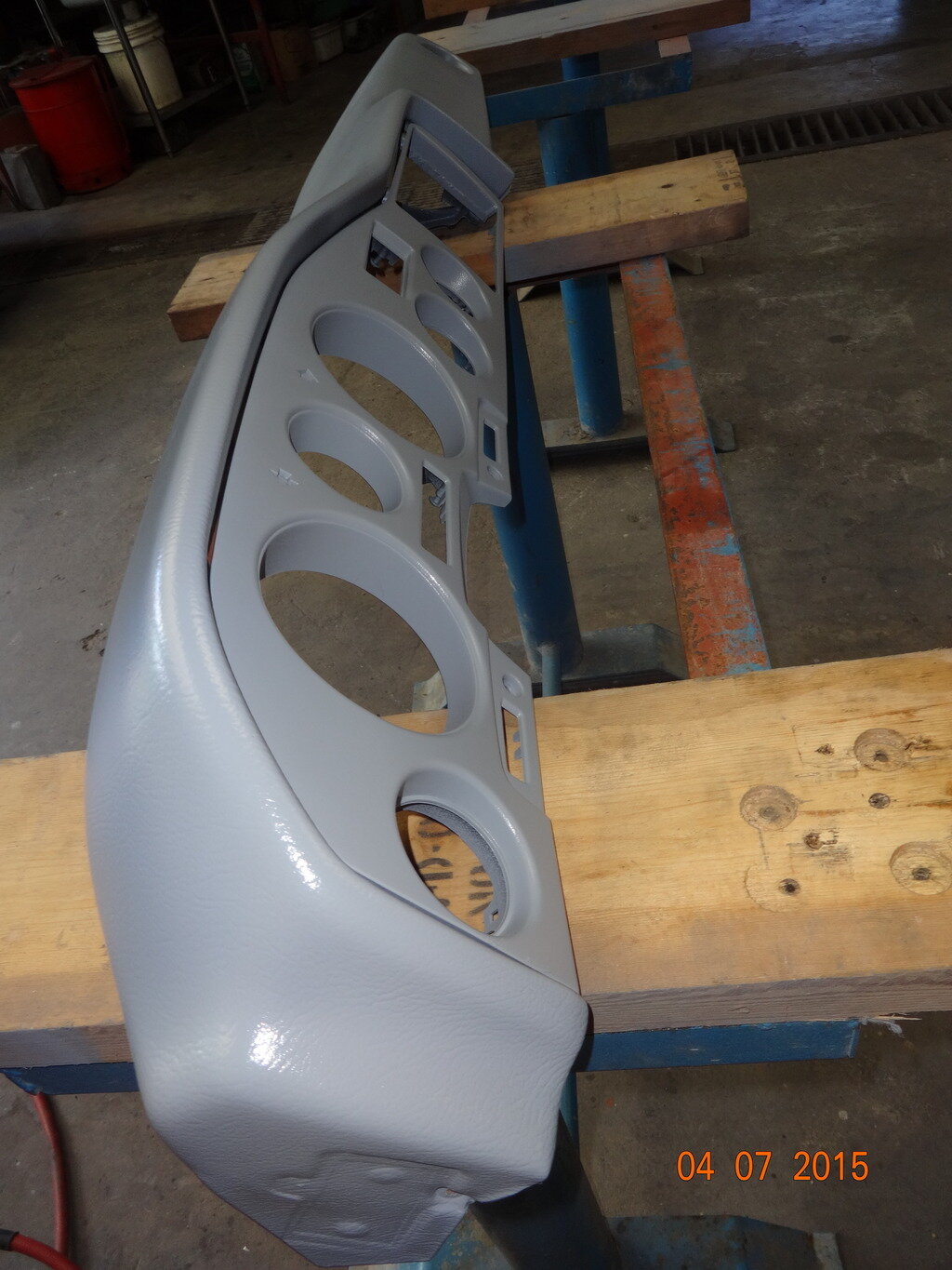

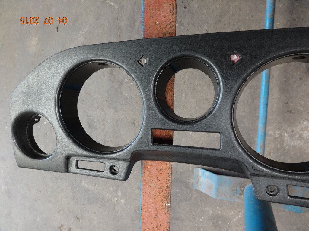

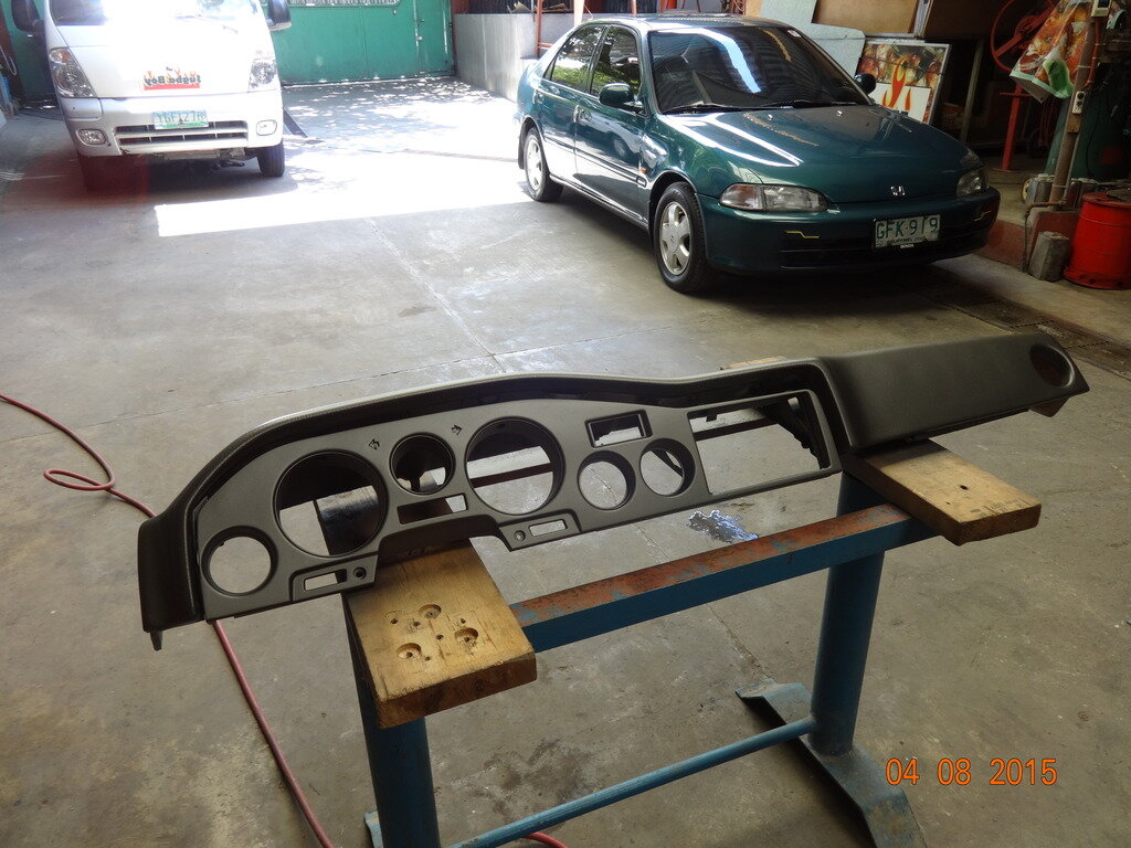

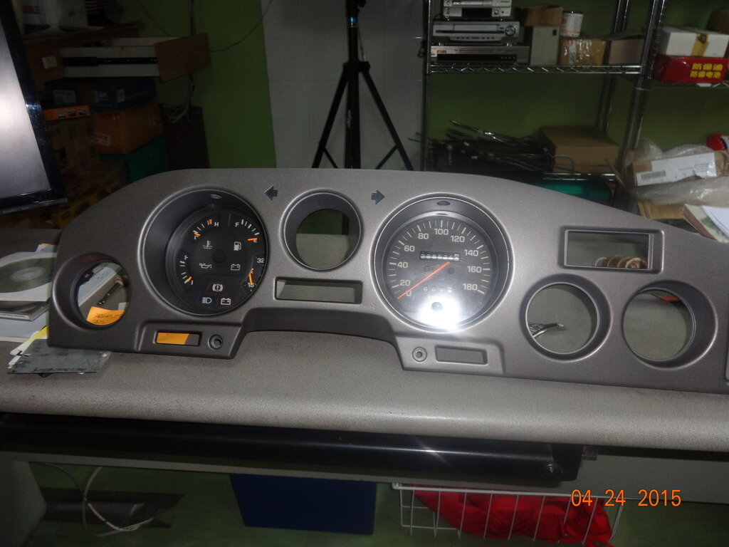

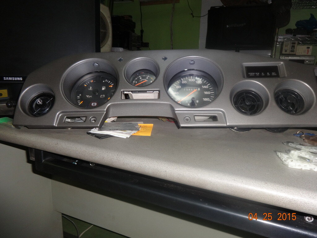

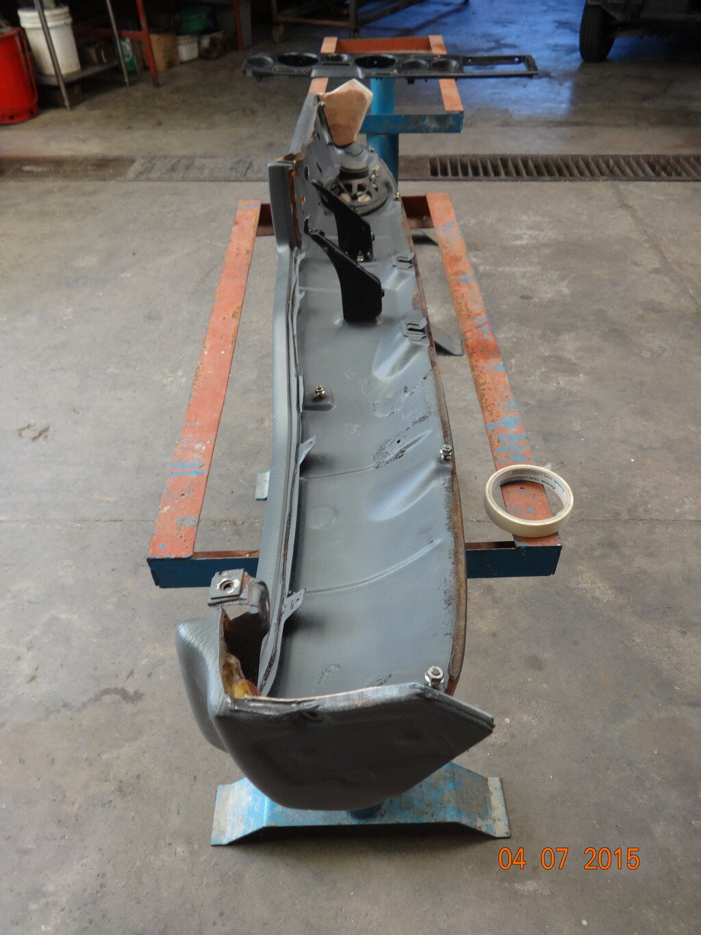

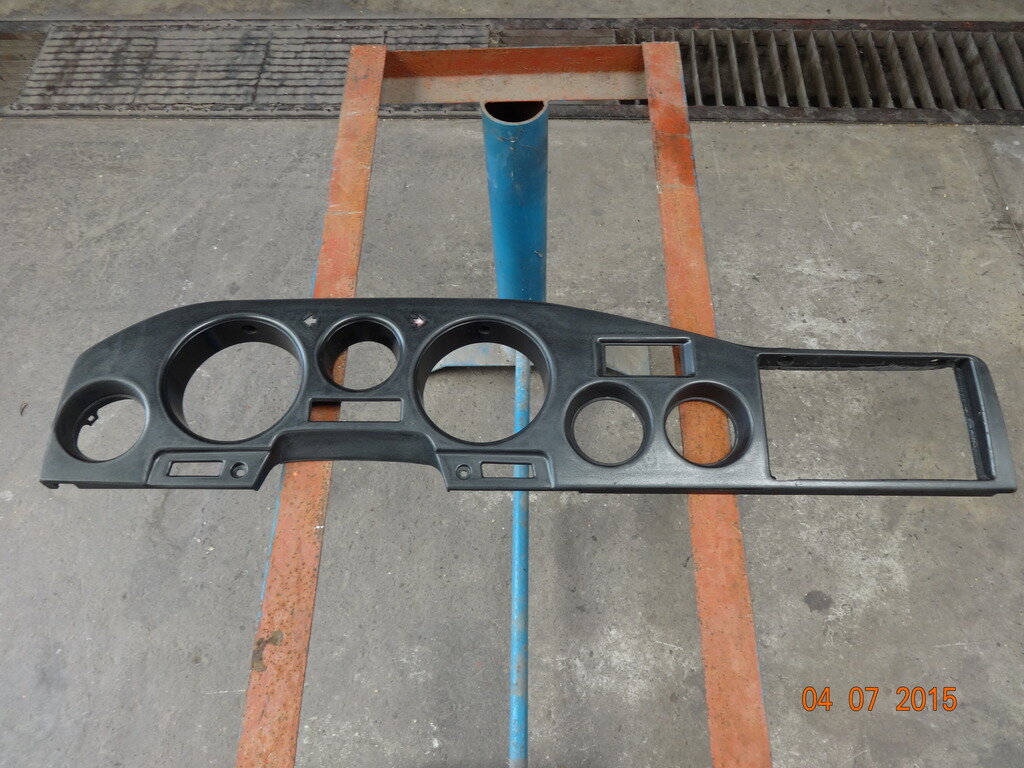

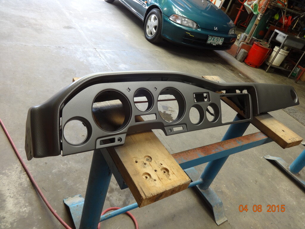

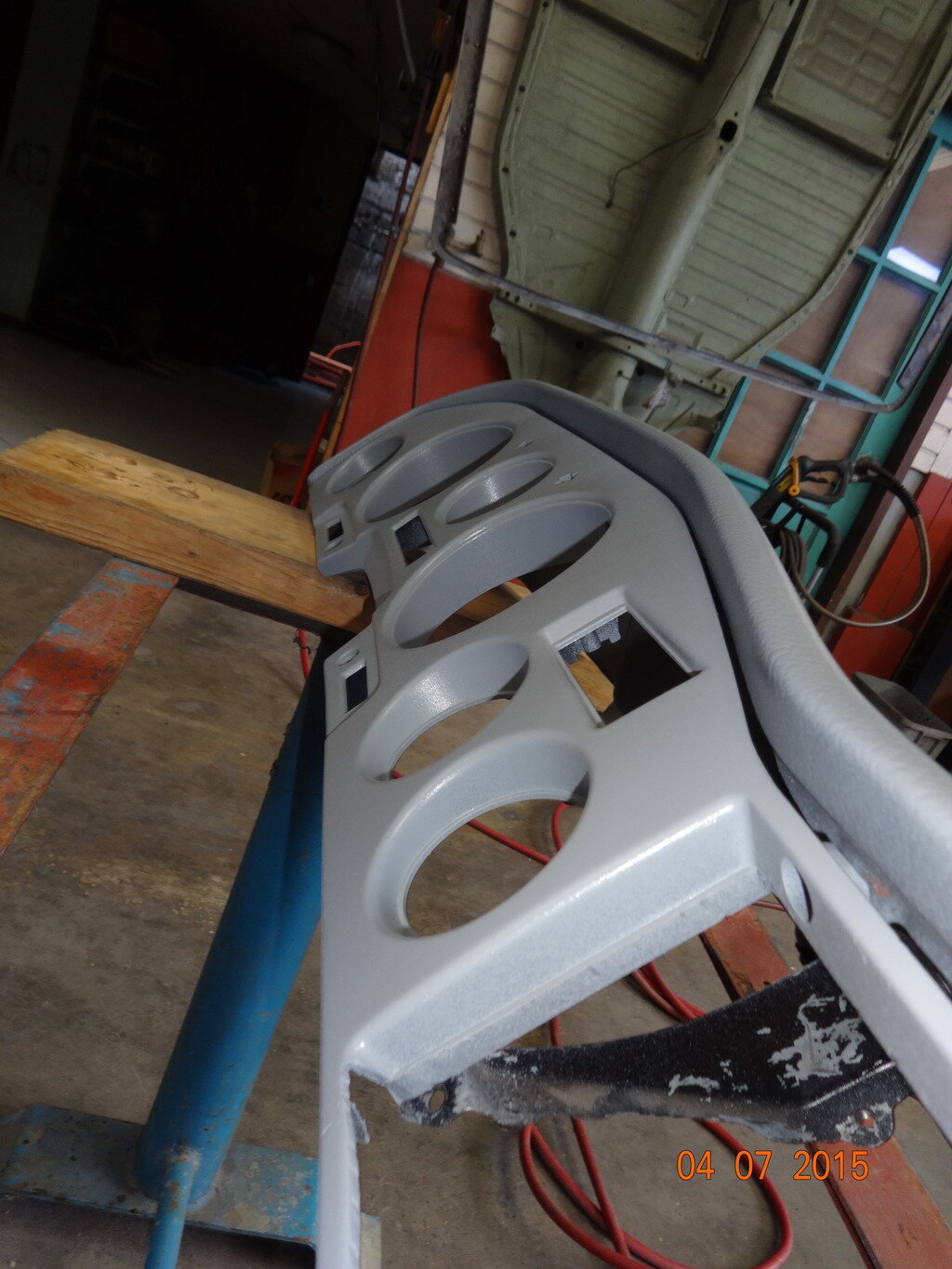

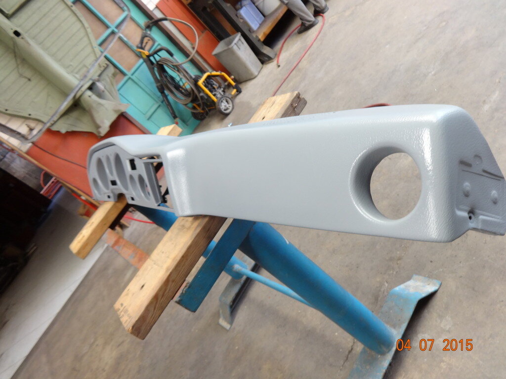

Prepping up the dash for a coat of primer.
Great thread and great work on you're 60! :clap: :thumbup:

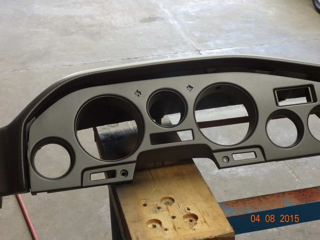

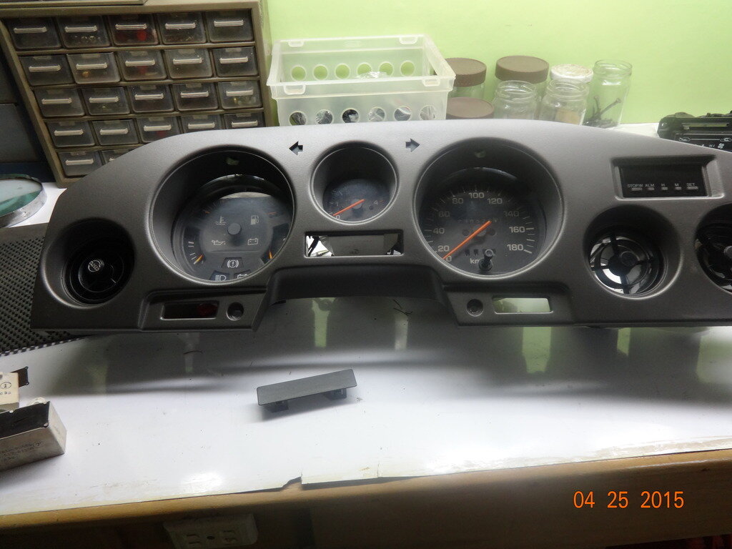

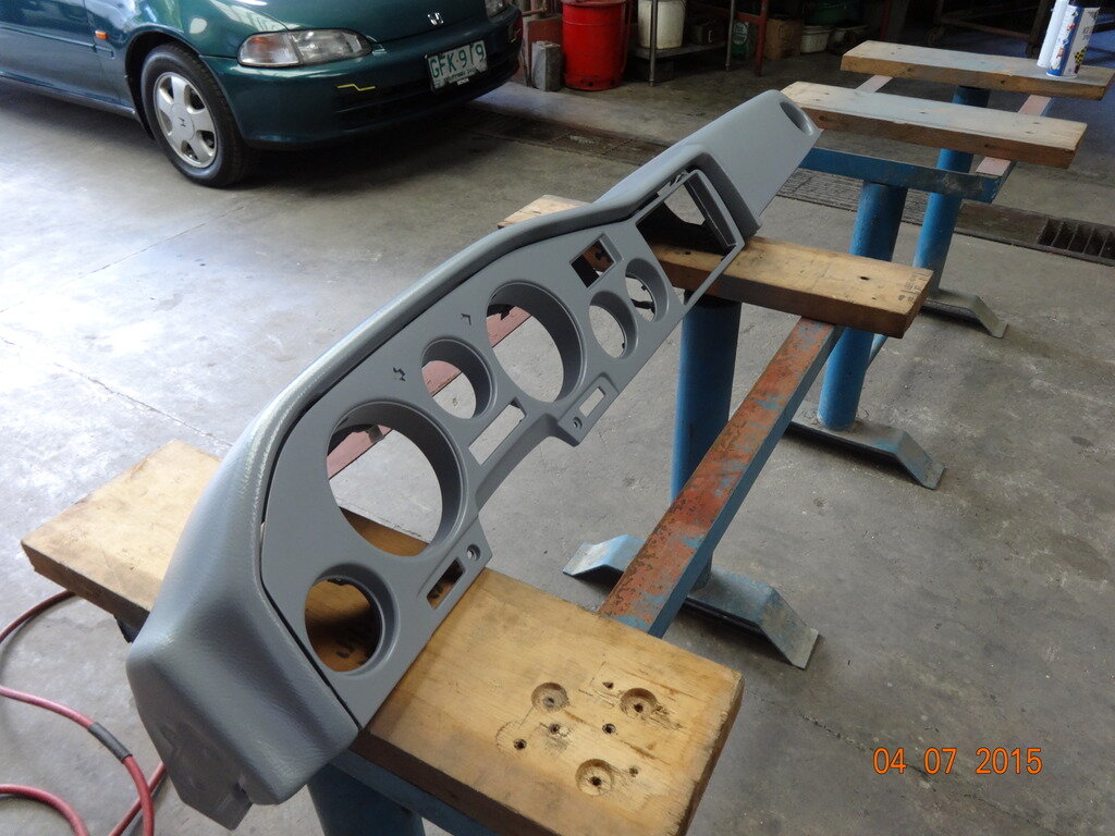

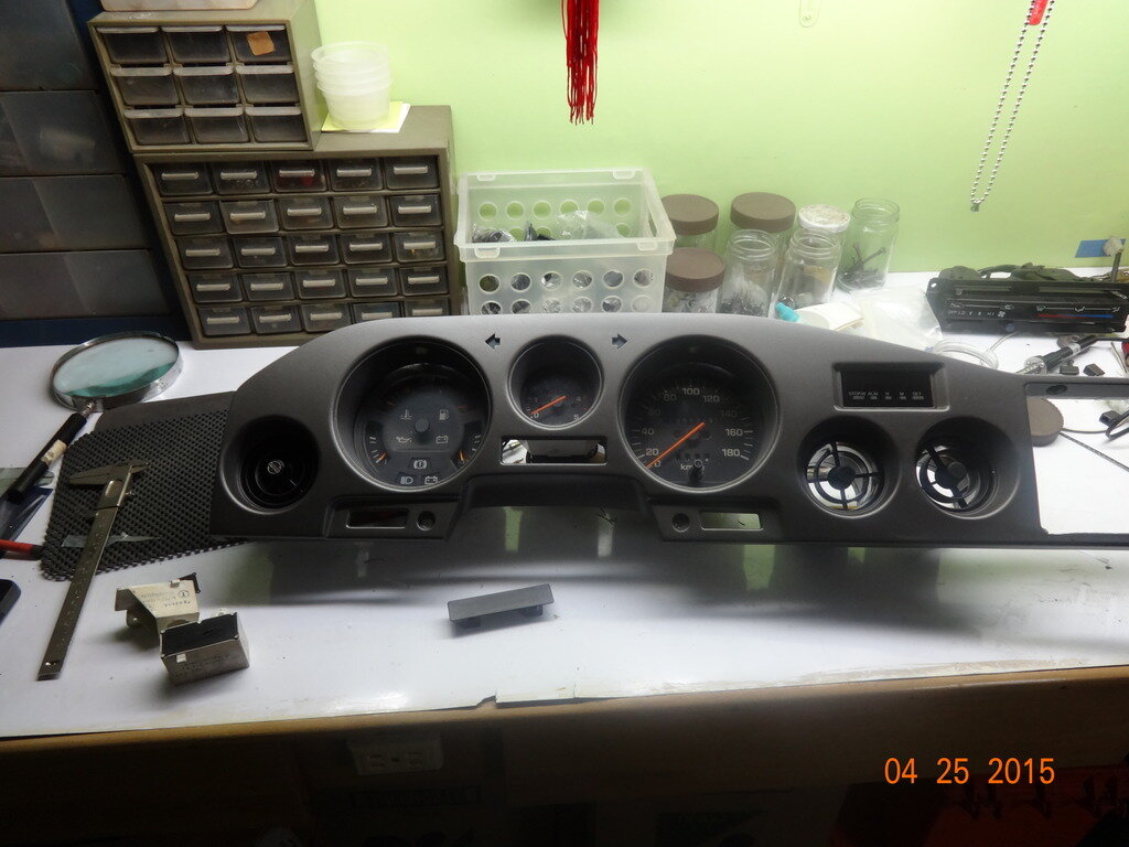

Final coat to the dash. A mixture of 60% metallic silver, 40% jet black and 30% to volume of flattening paste. Came out a bit darker to the body color.

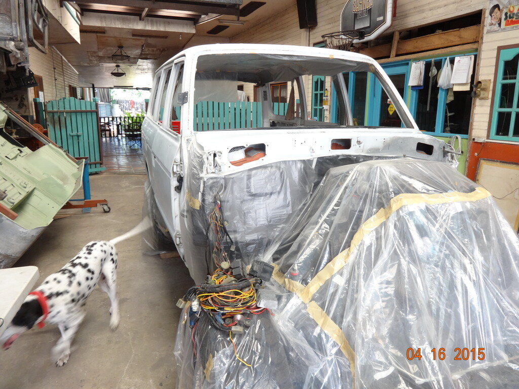

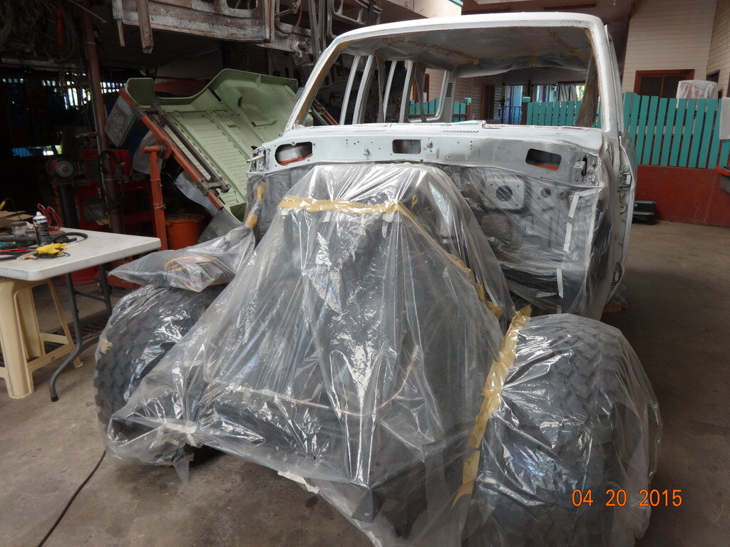

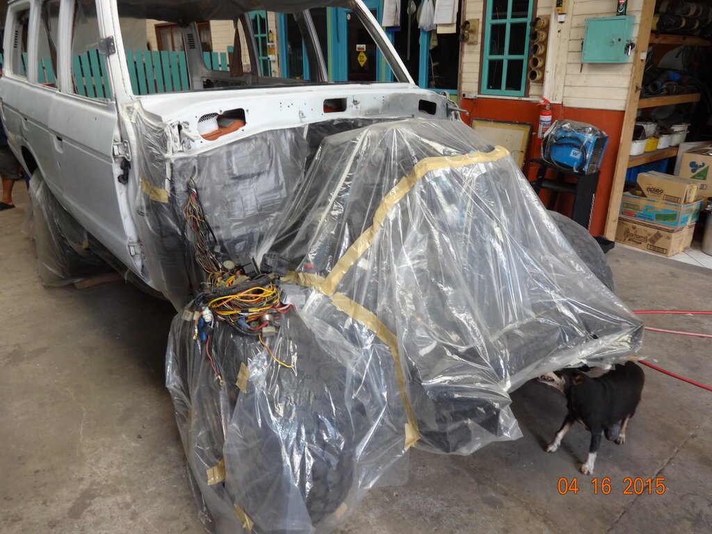

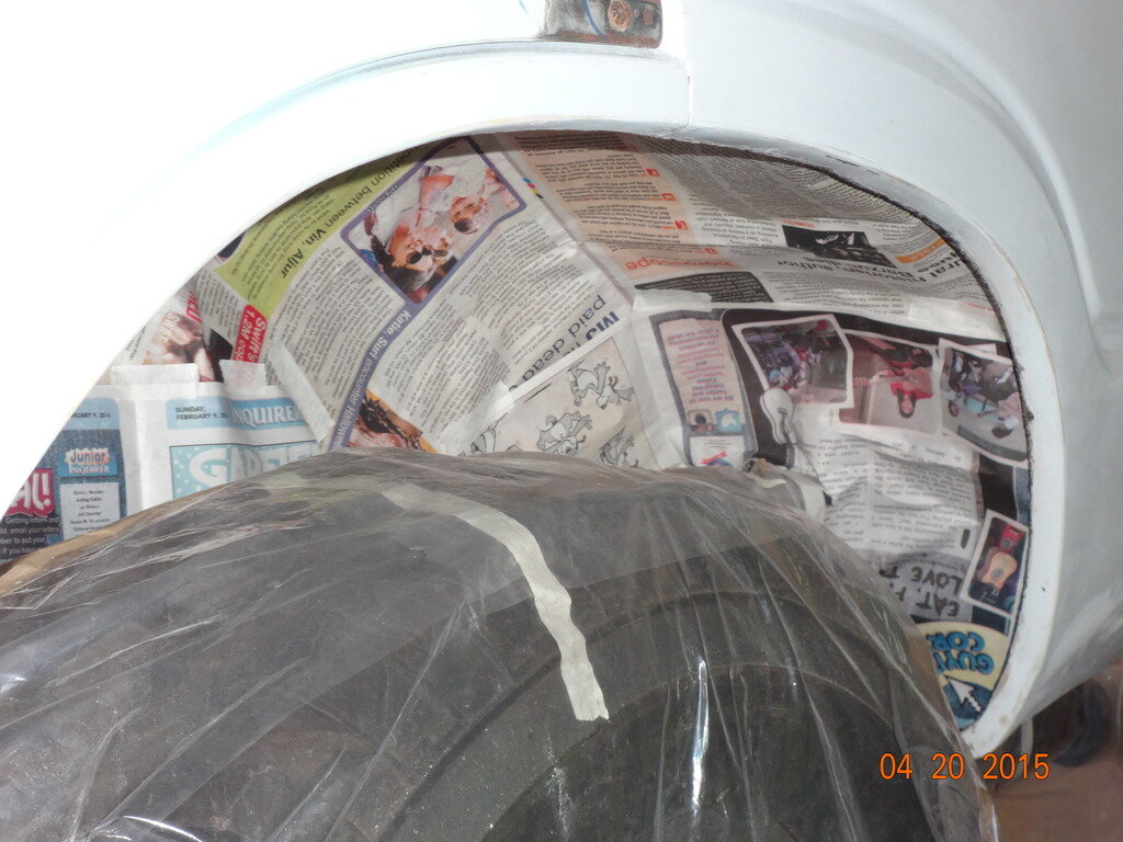

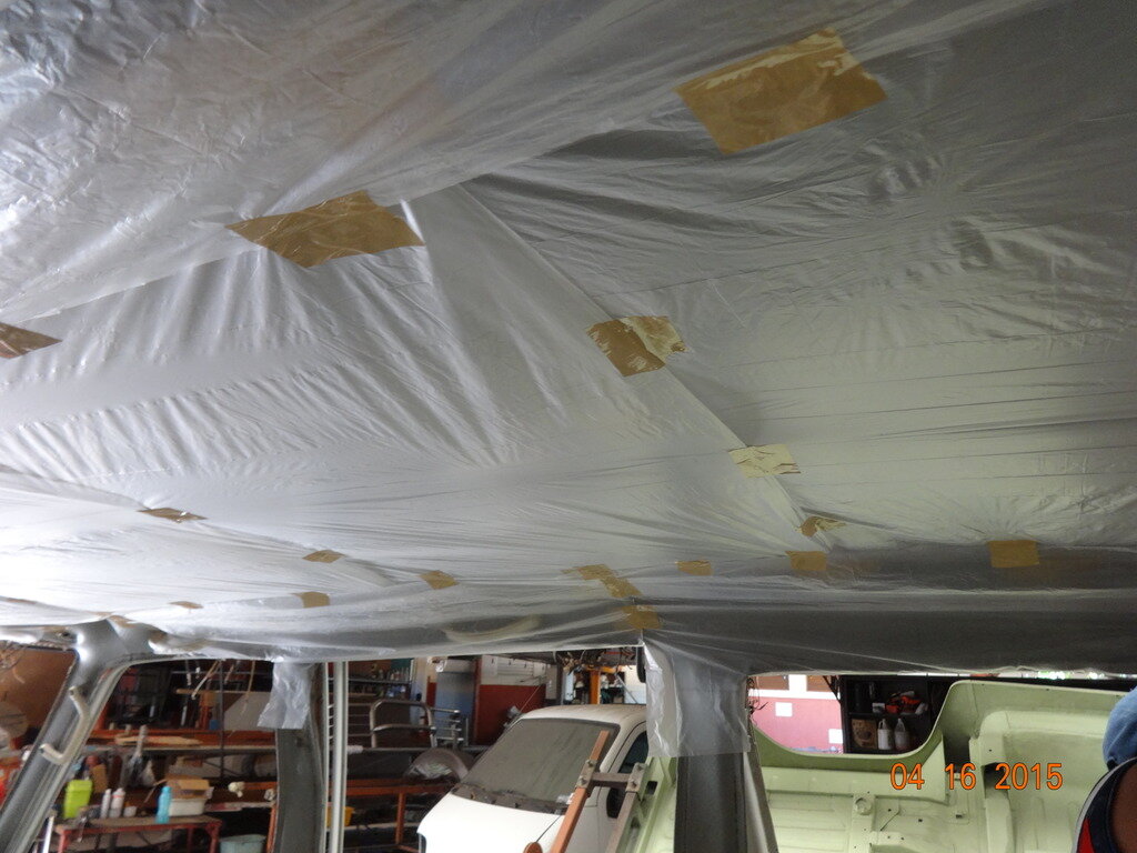

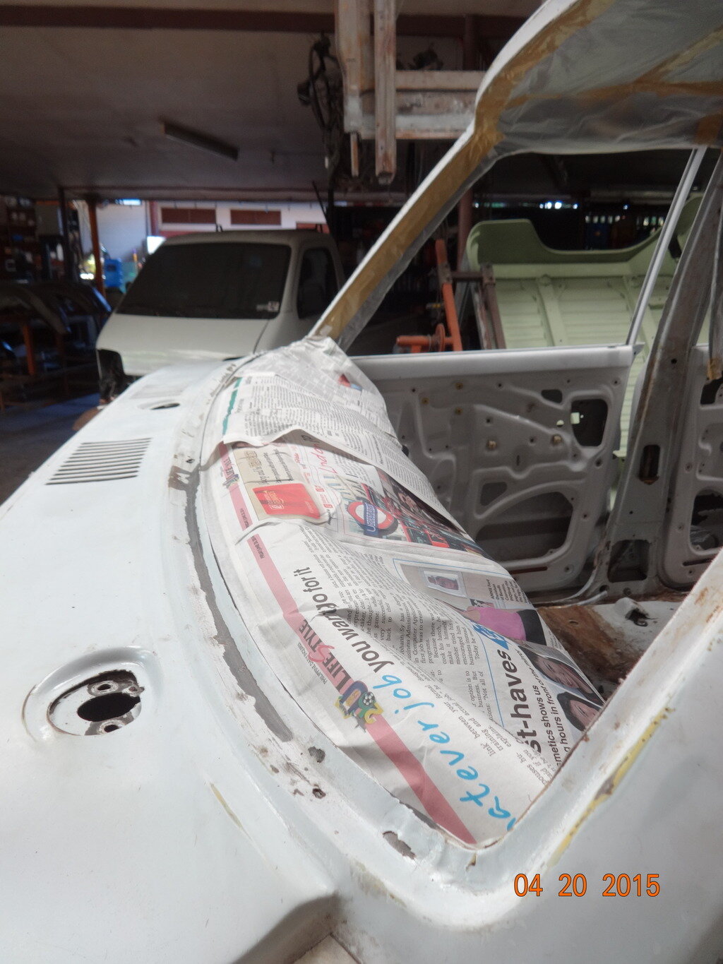

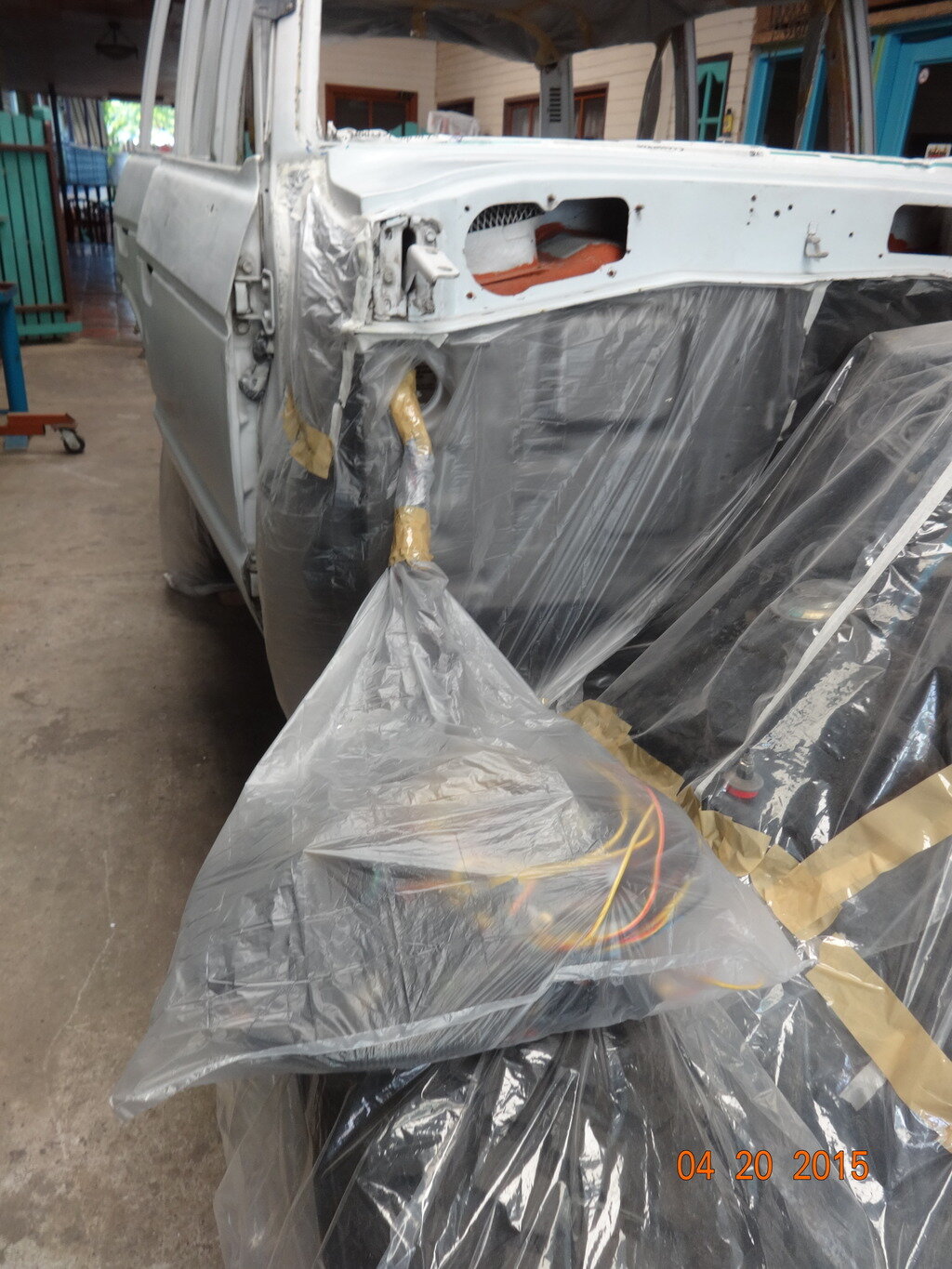

Wrapping up for painting
That is some fantastic work you are doing :thumbup:

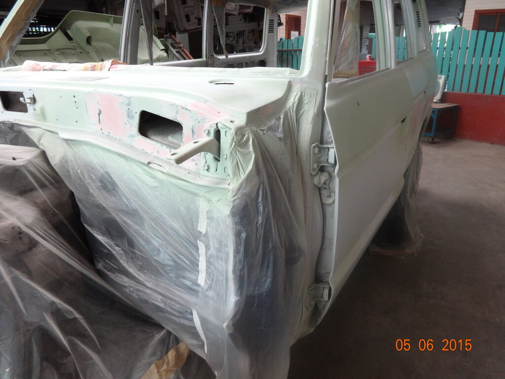

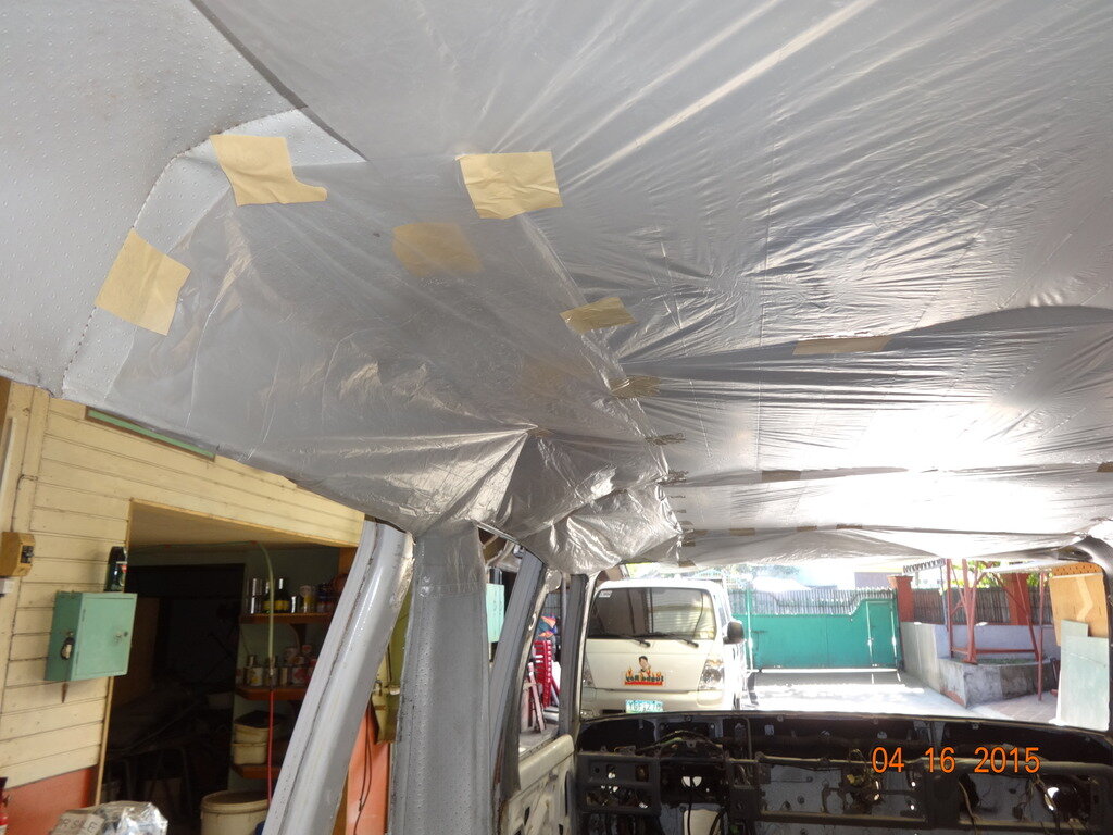

Done wrapping and ready for the primer.

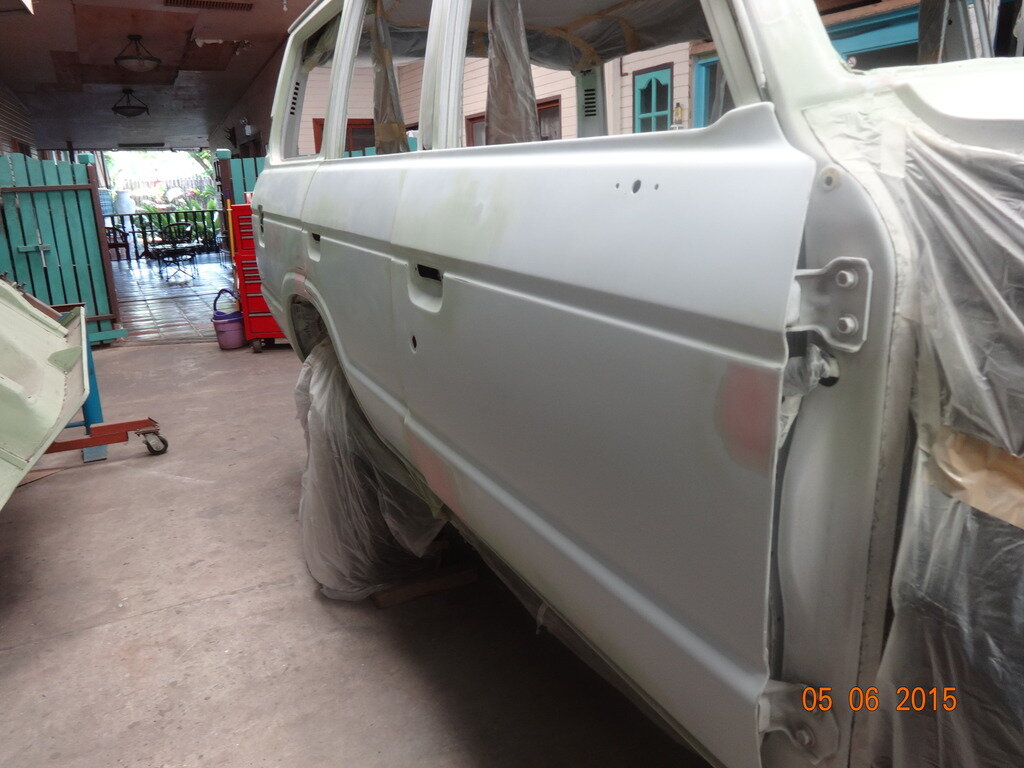

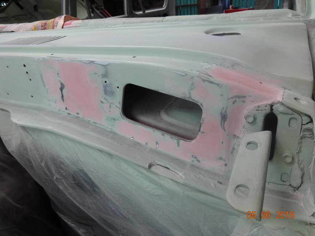

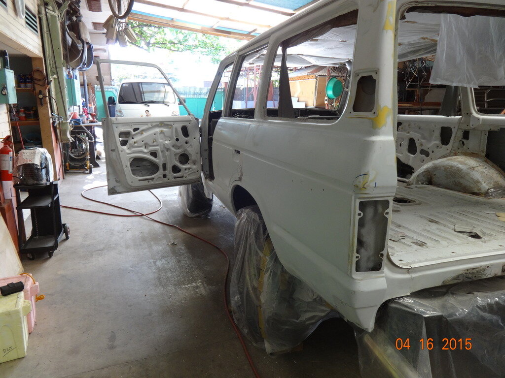

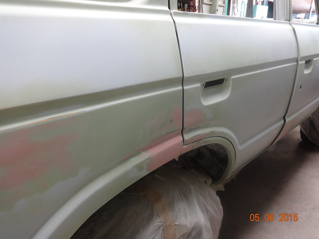

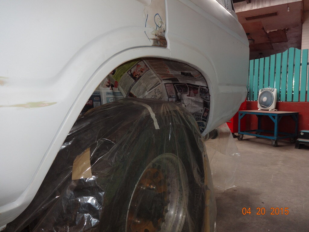

Started the body filling process for repaired rusty panels and dented walls.

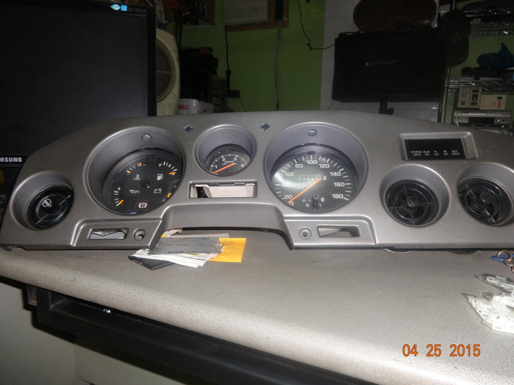

The dash panel is being assembled and really looks good.

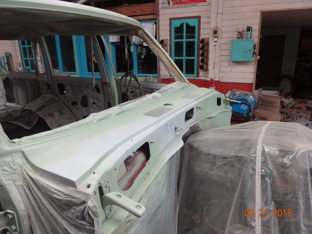

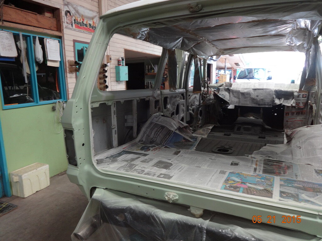

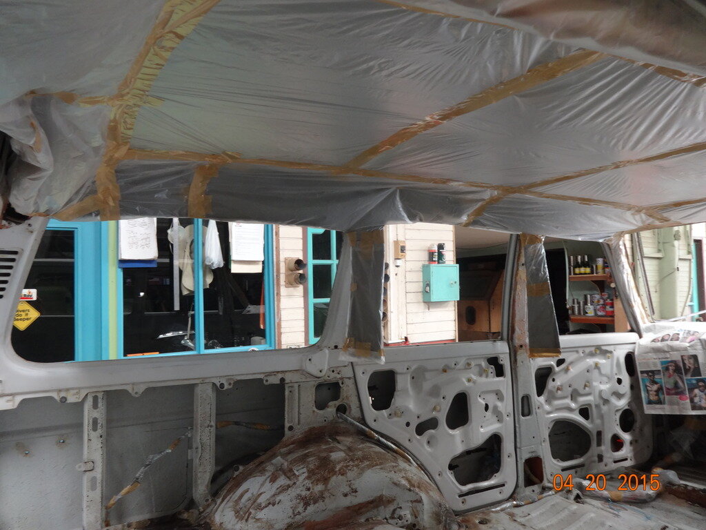

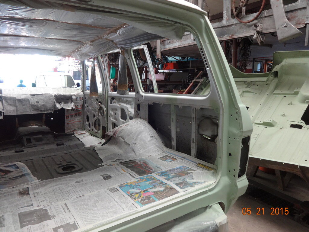

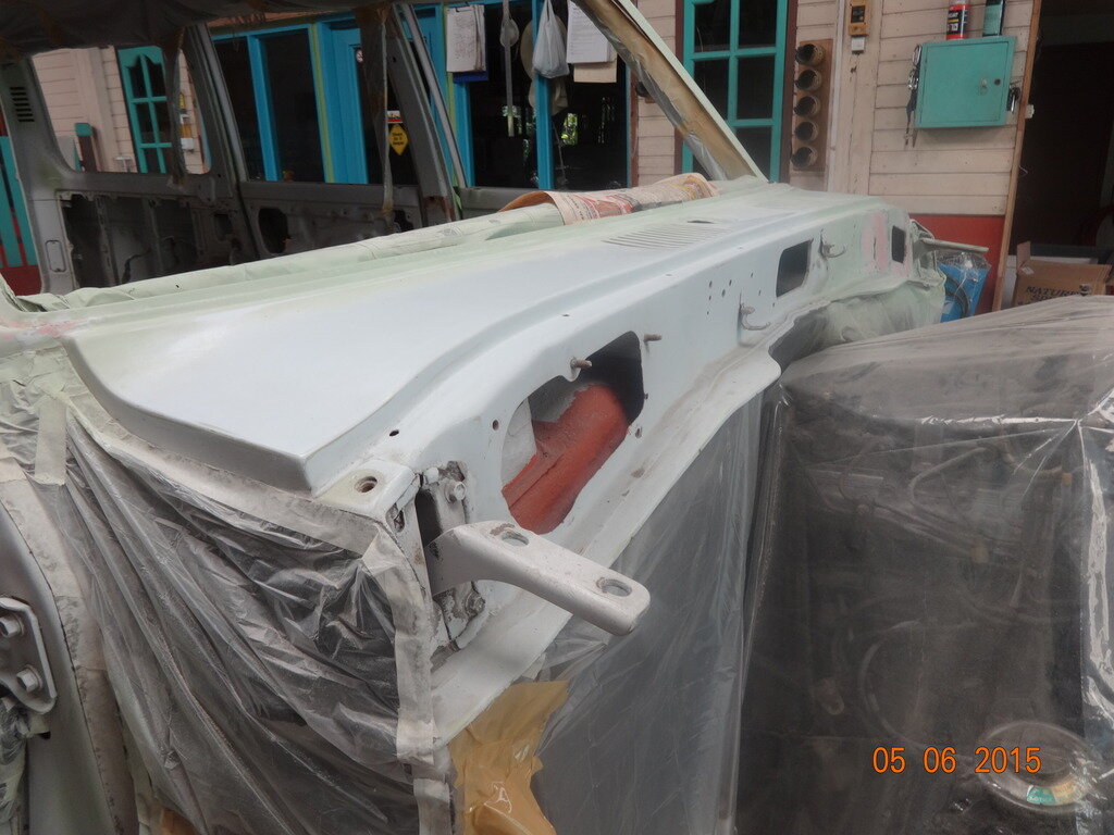

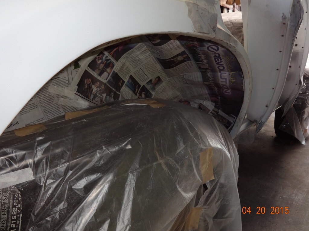

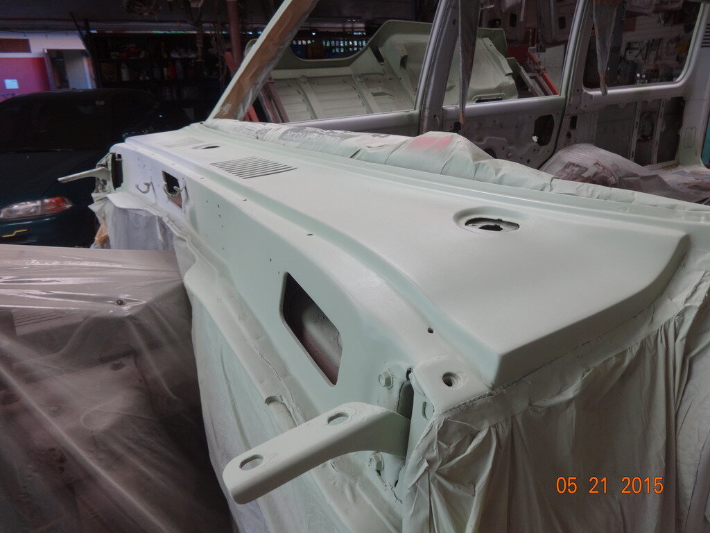

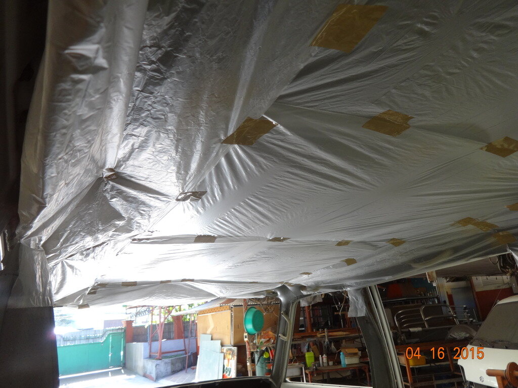

Preparation for painting is almost done and hopefully I can spray this week.

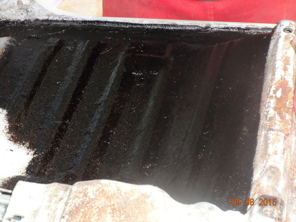

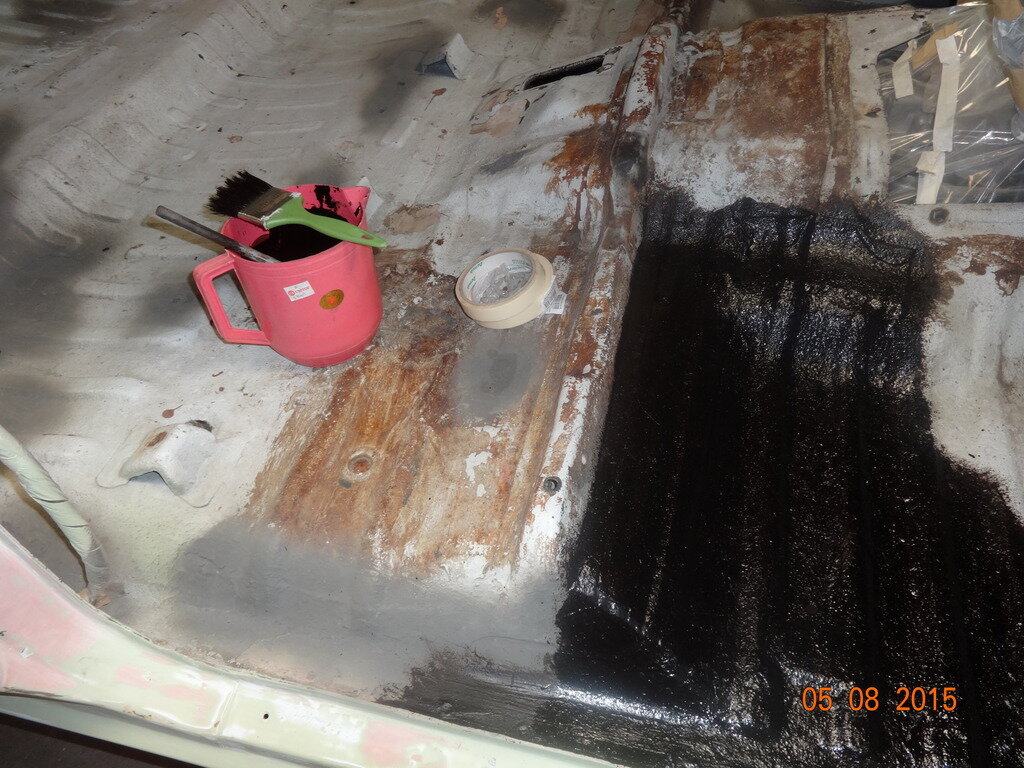

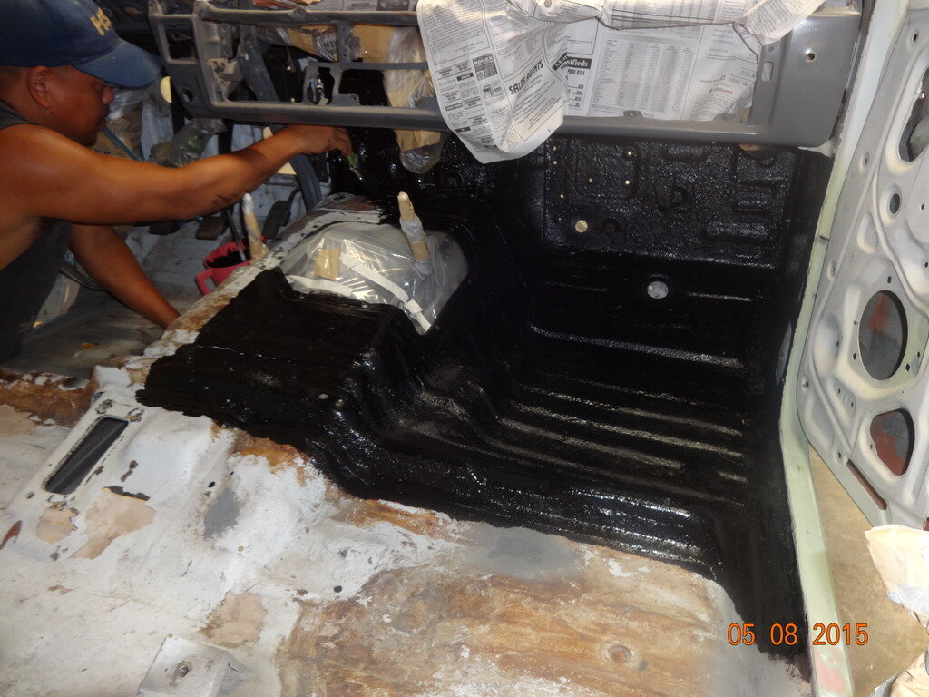

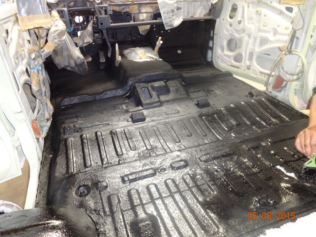

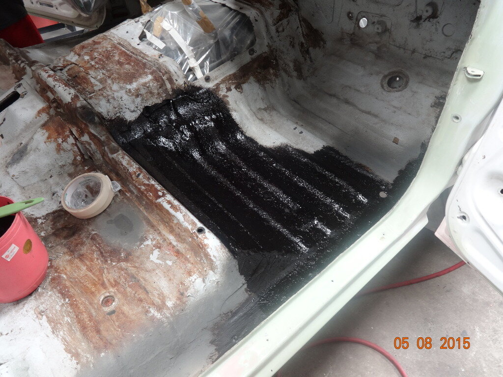

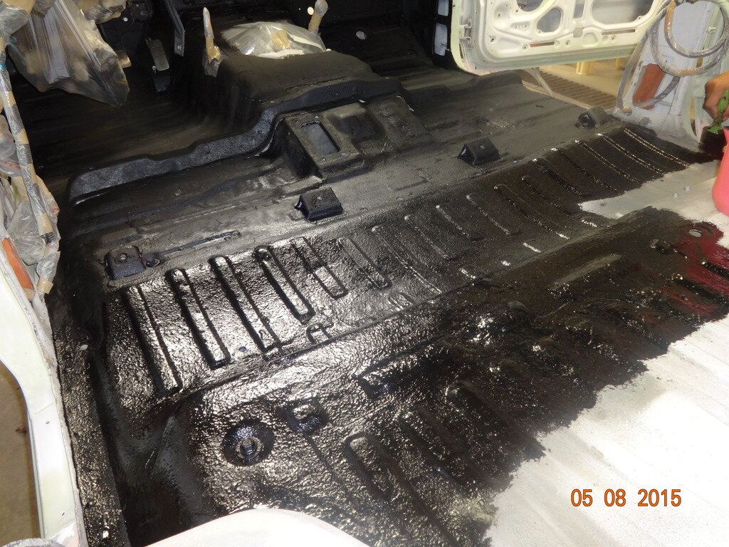

We decided to do the interior first before spraying paint on the outer part. A rubberized coating was applied for looks, anti-rust and sound insulation.
It's great to watch this progress in real time and contemplate and appreciate the many hours of work that each update involves :thumbup:

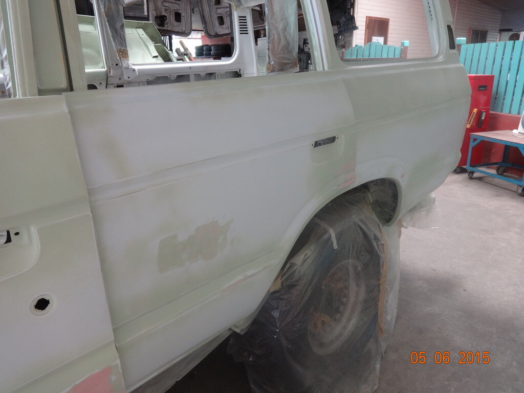

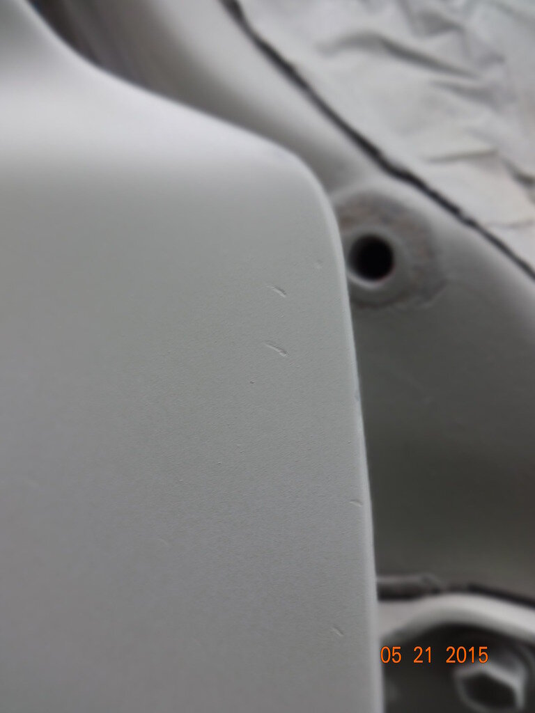

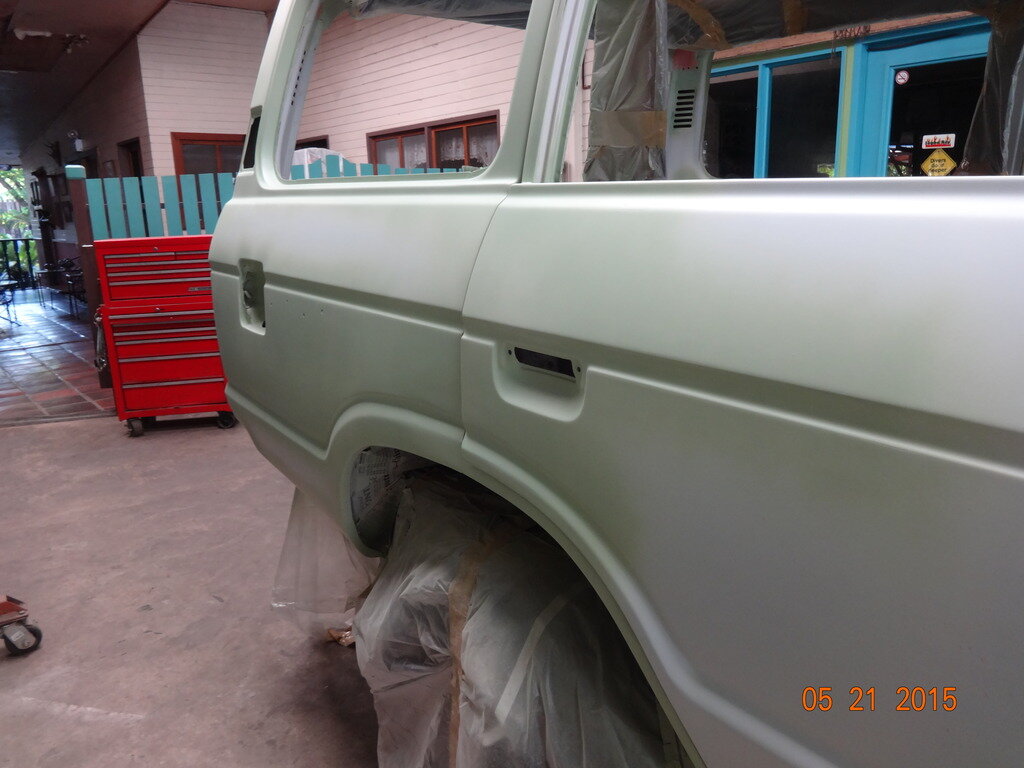

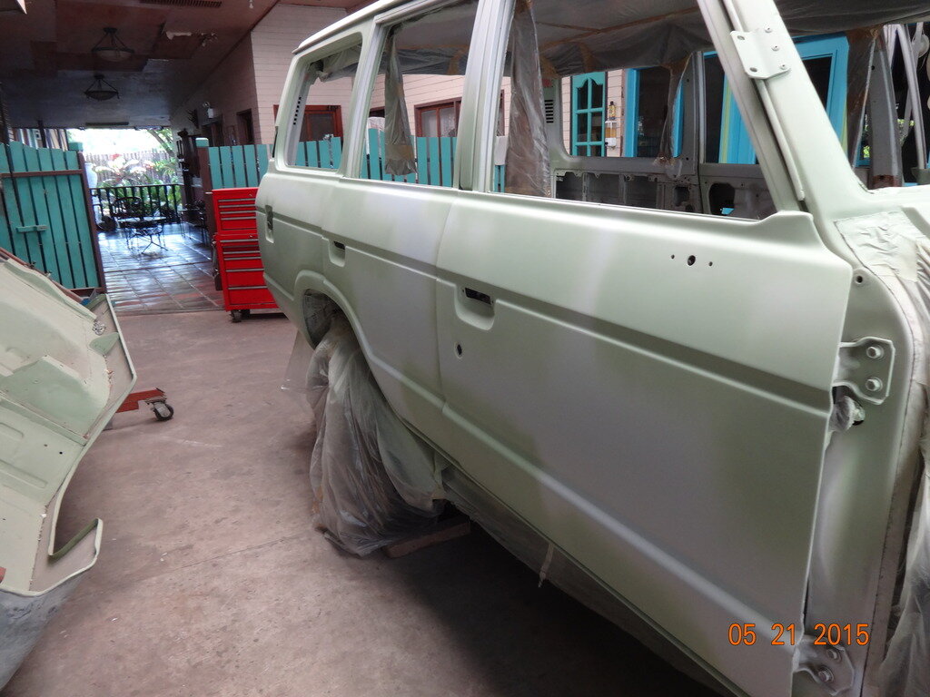

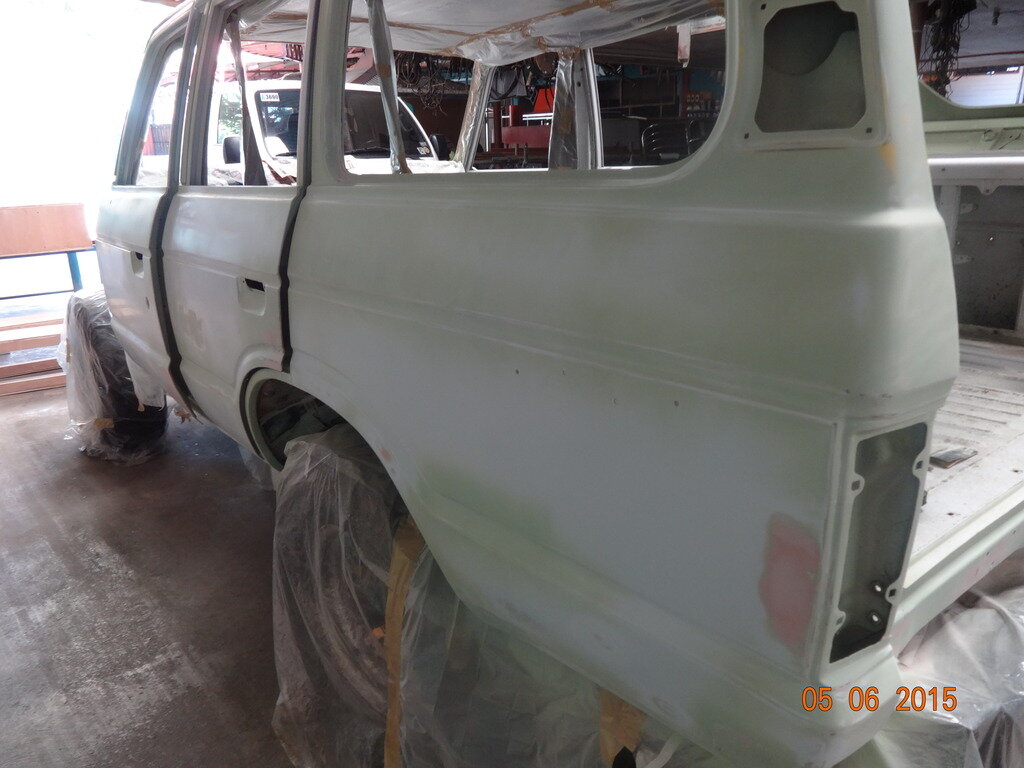

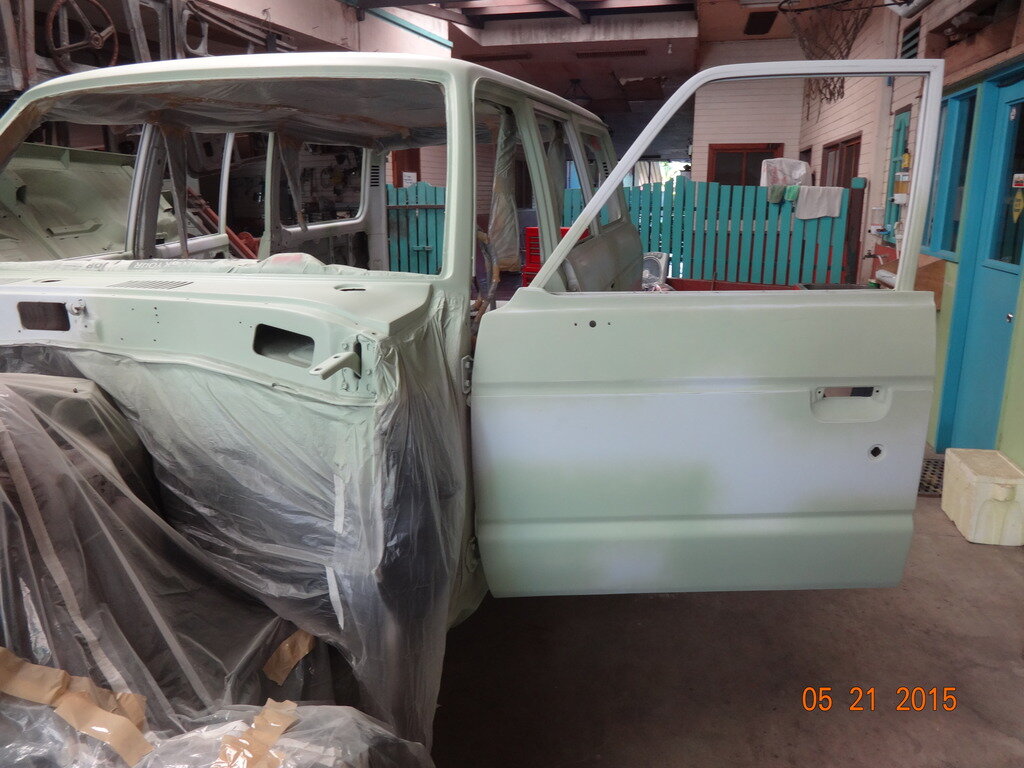

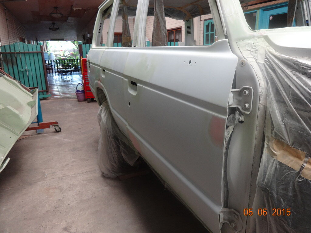

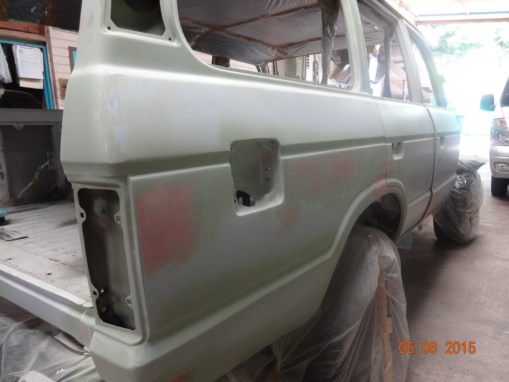

Getting the body ready for a coat of Glasurit primer-surfacer. This is a meticulous job that needs continues checking and re-checking for dents, uneveness, and fine scratches. Although the primer-sufacer does a good job filling up the shallow and thin marks, Care is given with visual inspection and the sense of touch.
Its coming on well for you Oding. There's a lot of surface area to cover on the 60.

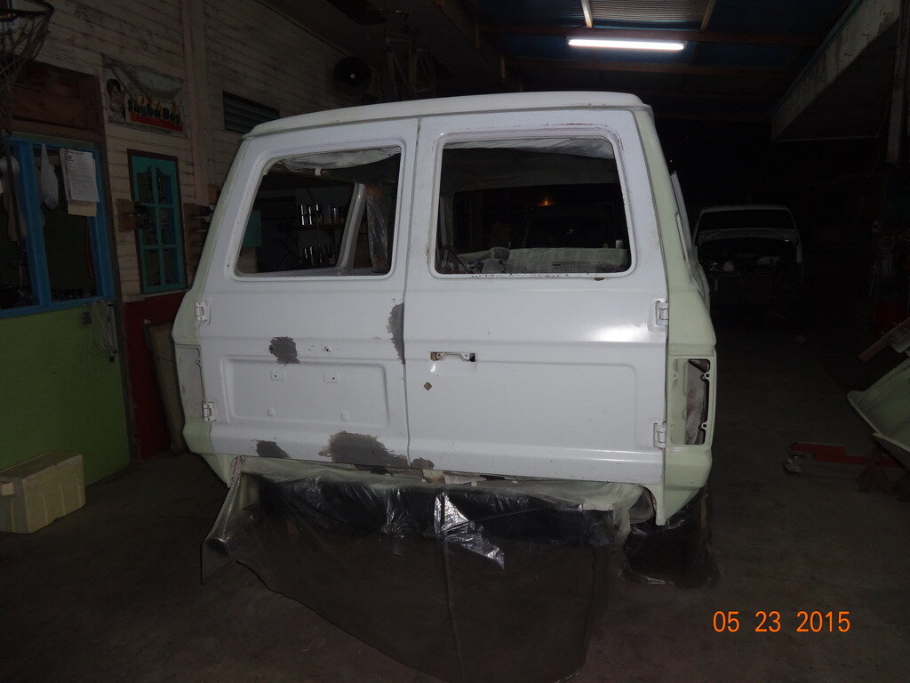

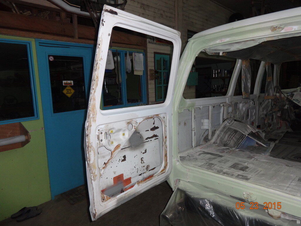

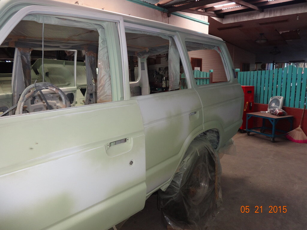

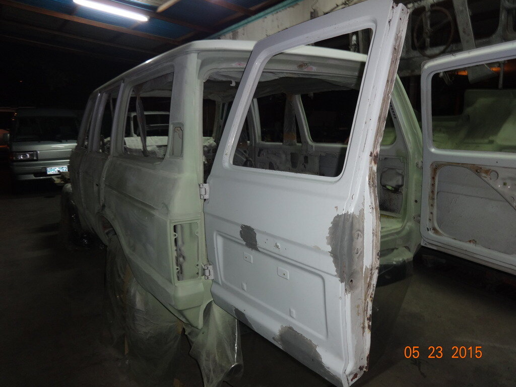

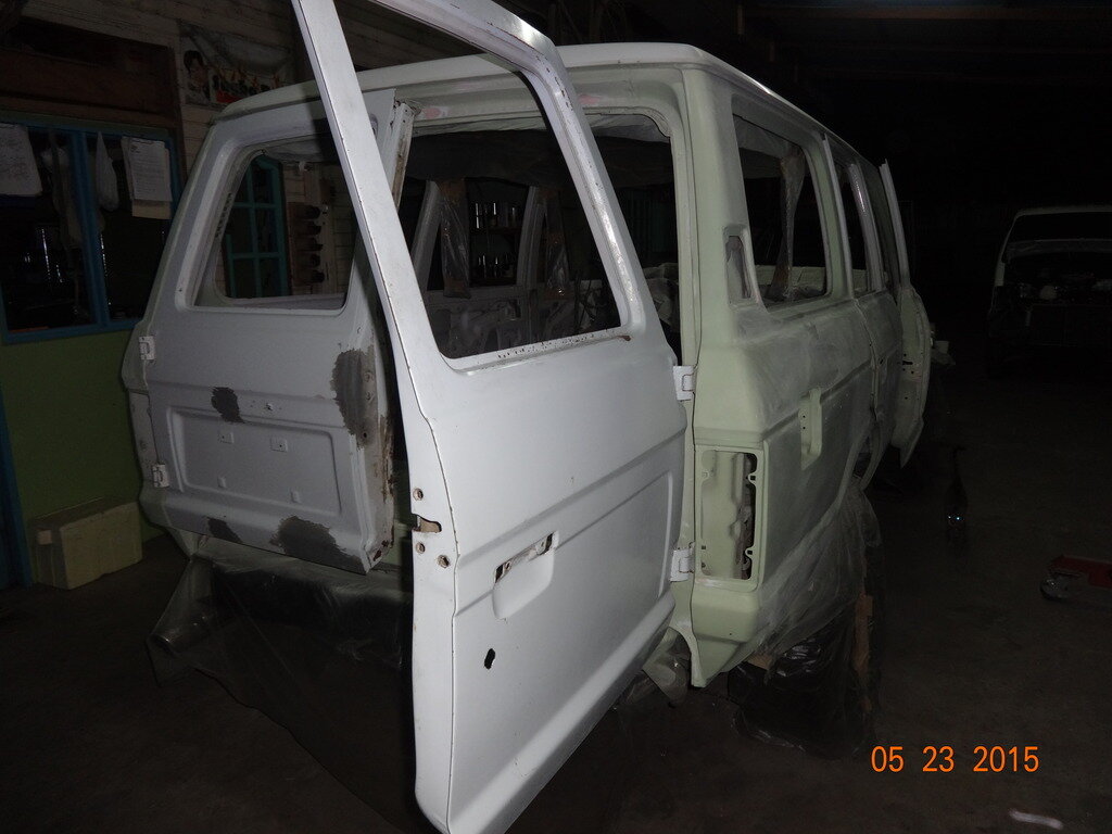

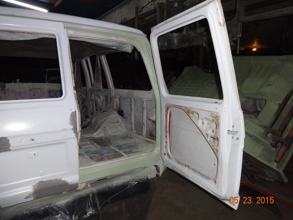

Installed the ambulance door (Barn door) for alignment before painting the body.
Aligned the rear door and prepping up for a coat of Glasurit primer/surfacer.
