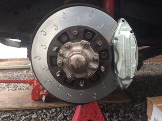

Fitted new disks and calipers.
Well pleased with them so far.
My old brake disks were in a crap state. Amazed didn't get advisory on them at last MOT.
Parting them from the hub took some serious wacks with BFH. Started to think welded on.
