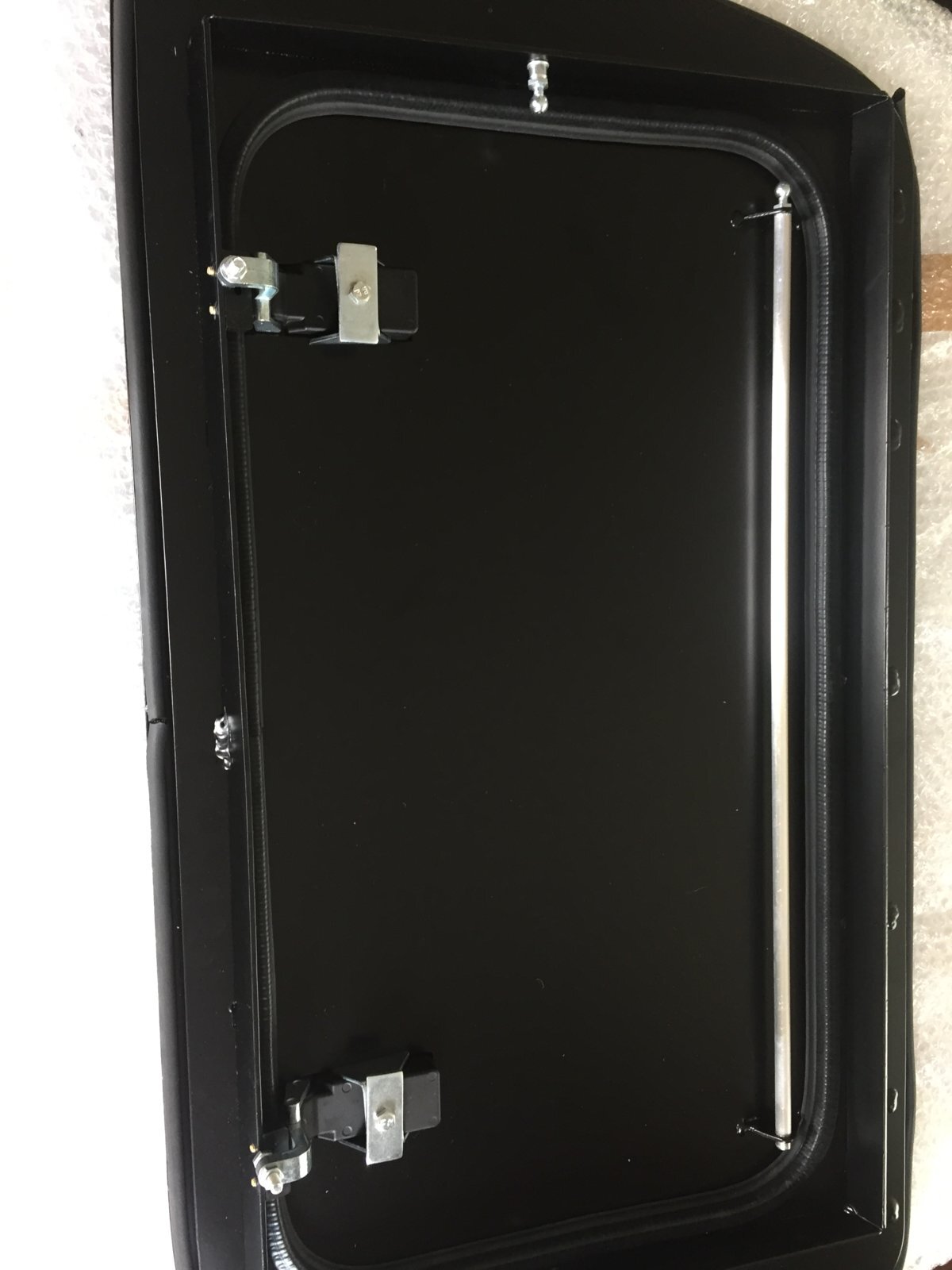

One thing that was highlighted over last weekend is that the tabs for the gas struts are bending slightly under the force of the gas strut. It looks like this is down to the grade of Ally used so next batch these will be stronger like the first batch. In the meantime those with Molle panels aren't affected as the Molle panels stiffen them up so they don't move. Those without on the other hand will be supplied with a 10mm Ally bar between the two tabs inside the doors. Like this:-IMG_1283.JPG
This will be on this batch only as I will ensure the material is as per my original design and drawings for the next batch. Meanwhile this can be used for all sorts of things, hanging rail, lighting attachment, that sort of thing.
Hope this is ok with everyone. :-)
